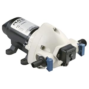

No Pics, but i worked on my OBHS (on board hot shower) last night, specifically the curtain enclosure. It will be 3 sides and but up against the passenger side of the truck. Instead of a curtain i am building a freestanding colapasable privacy screen from copper and sunbrella. I was going to use PVC because it is cheapeer, but it is more flimsy.
My water pump should be here tomorrow, i have to figure out where to mount it, not sure if i can fit it in the sunken trunk.
The pump Flojet 03526 144A
