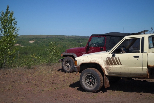

About a month ago, I picked up this little fine piece of machinery for $460 at a garage sale. It's an 88 pickup. It looks like crap and the frame is all rotted beyond repair. Someone previously threw some scrap metal on there with some crappy welding work and that's pretty much all thats holding it together, but the engine and drivetrain are good.

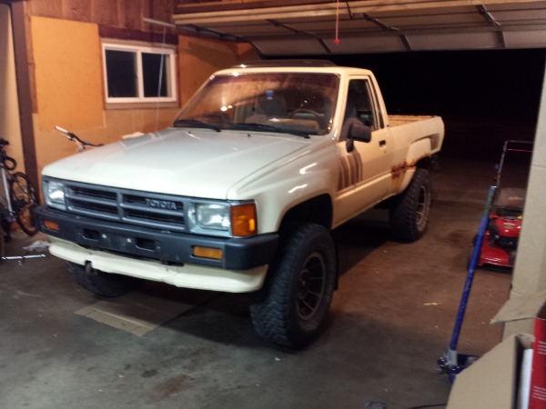

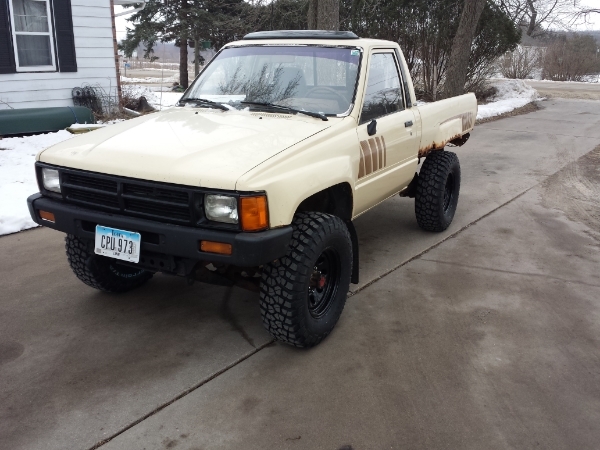

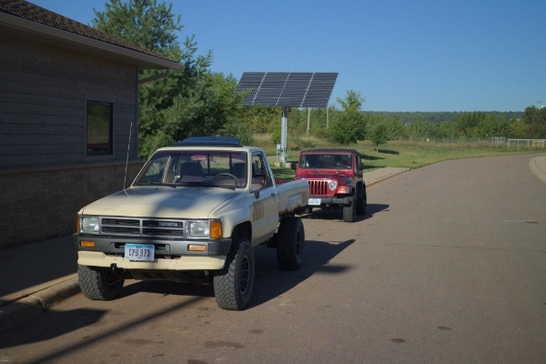

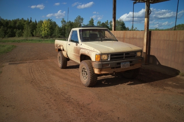

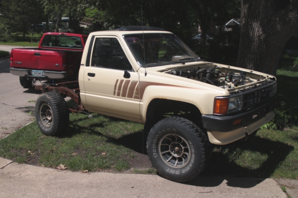

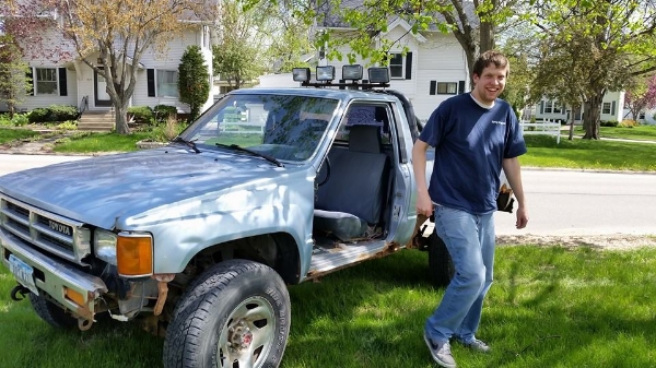

It was time to start looking for a good chassis to use. This week I found an 87 toyota pickup with a good frame, but the engine had a nasty rod knock. Not exactly what I wanted since I would've liked to have the strait axle, but that can always be changed down the road. The box was also rusted and a bit bent up, but that can be fixed too. I ended up talking the guy down to $600 and trailered it home.

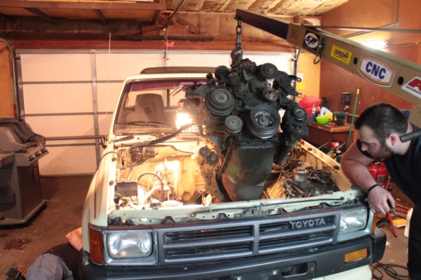

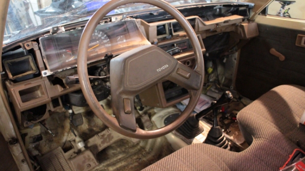

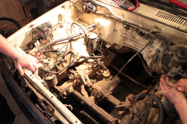

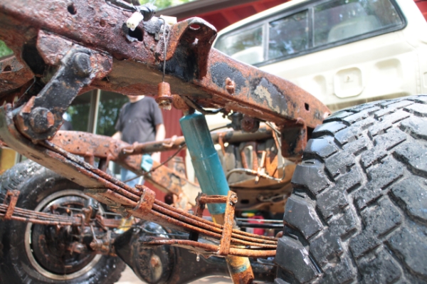

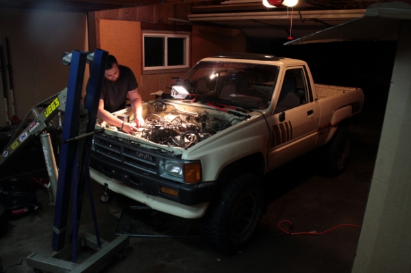

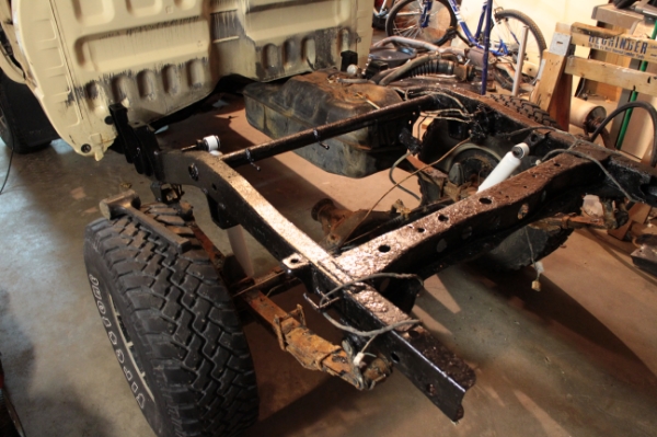

At this point, I have a lot of work ahead of me. I need pull the engine from the blue truck to put in the tan one. The tan truck also has a busted windshield which I'm going to try pulling from the blue one as well as a few other misc pieces. It's nice having your own parts truck. In the process it's also going to be converted to fuel injection since the blue one is EFI and the bad engine was carburated.
After work tonight I started tearing into the new truck and pulled the bad engine out. After draining out the fluids, it looks like the rod knock was the result of a blown head gasket that wasn't attended to.

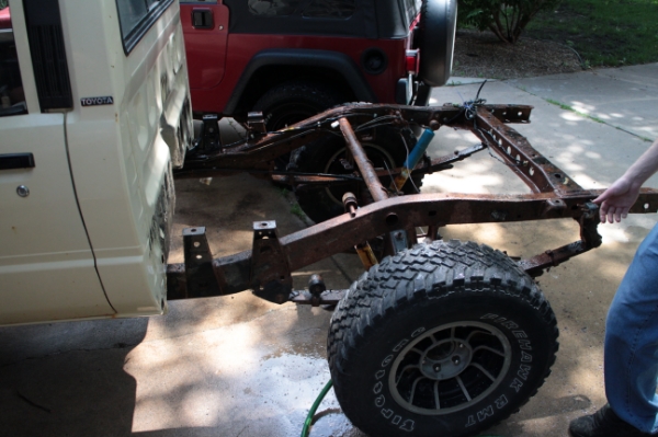

I have some progress to post since I've last been on here. Over the weekend I pulled the box and gas tank, then gave it a good pressure wash to clean it all up. The frame looks great for an Iowa truck, just surface rust. I'm going to clean it up with some por-15.

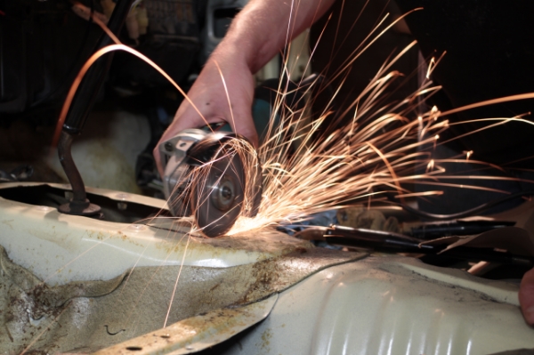

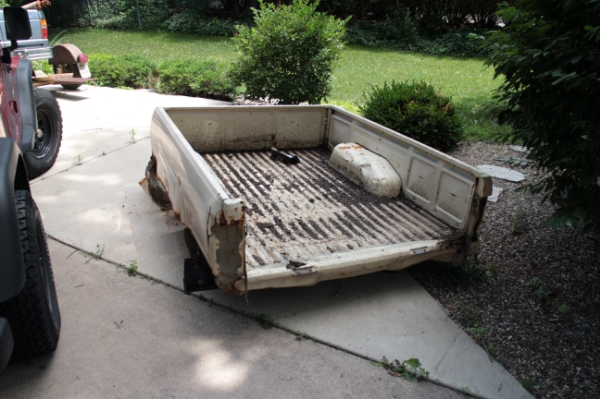

I was originally thinking I would put new fiberglass sides on the box, but it's pretty bent up where it was hit and I don't think it would ever look right. I'm just going to flatbed the truck as a temporary solution to at least make it legal and keep an eye out for a clean box next time I travel south.

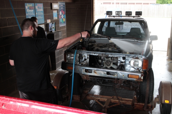

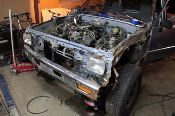

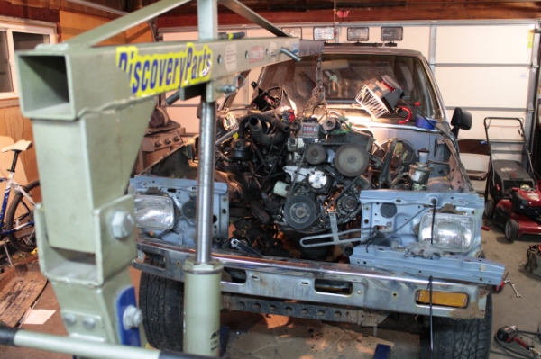

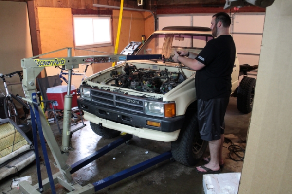

Next, we pulled the donor truck to the wash to clean up the engine. It's had a bad crank shaft seal for quite some time and was caked with oil.
Tonight I got the engine ready to be pulled. It's ready to go next time I'm in the garage. On a side note; If there's anything you could use off this truck, PM me with an offer and I'll let you know if I have it. It'll be going to the junk yard soon. (I'm keeping the wheels, tires, and locking hubs)

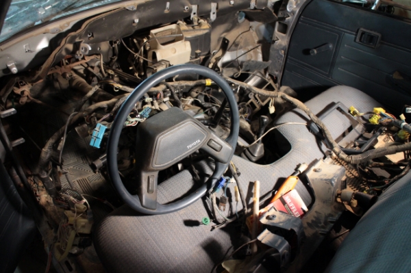

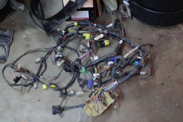

We decided that the best route to take with the wiring for the EFI swap is to just move all the wiring over. The way this harness is set up would be an pain in the ass to splice together. The only thing I'll need to deal with at that point is wiring for A/C since the EFI harness wasn't set up for it.
And that's where I left tonight. The only thing holding up the harness from coming out is a branch of wire that goes along the bottom of the drivers side door, then feeds under the carpet below the seat. I can't figure out where it goes and the bolts for the seat are too rusted to move. Does anyone know where it leads to so I can unplug it at the source and see if I can pull it through under the carpet?
I was also wondering about the front hubs. The tan truck doesn't have manual lockers and seems to just be locked all the time. It doesn't look like my truck has the vacuum operated system which looks like it wasn't introduced until 89. Can I just throw the manual hubs on here from the blue truck and call it good? I want to switch it over because I think I'm going to put lock right up front.
Any input or suggestions for the build is appreciated

The wire goes to your seat belt and it will have a plastic clip that will keep your from just pulling it thru along with some tar like material that is on the floor and it is really sticky. I think if you jut try pulling it, it will break the wire.
I think you can just move the hubs over and call it good but not sure on that one. Here is a link for coverting for 22r to 22re https://www.yotatech.com/forums/f116...4-88-a-278925/
As I understand it, these trucks did not come with AC but was added at the dealer. I beleive the wiring is there and just not hooked up. I added AC to one of my trucks but still need a compressor and to get it running to see if it works. It will have dimples in the firewall as to where to drill out to add the condenser.
Welcome to Yotatech. I like seeing some in depth builds.

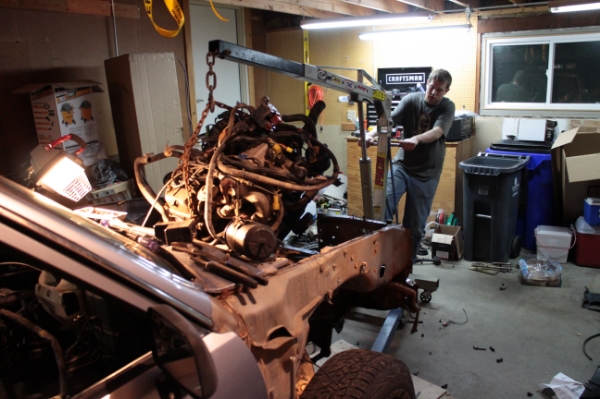

Got the motor pulled out of the donor truck and started working on tuning it up a bit and replacing some gaskets. We decided to cut out the radiator support to make it a little easier on us since it's going to the junk yard anyway.

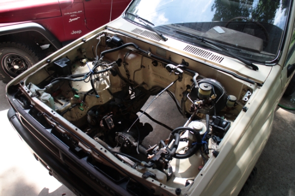

Once the engine was out, we started cleaning up the tan one to get it ready for it's new engine and wiring harness. It looks like it hasn't been cleaned out in ages.

Couple hours later
Ready for the new EFI wiring harness

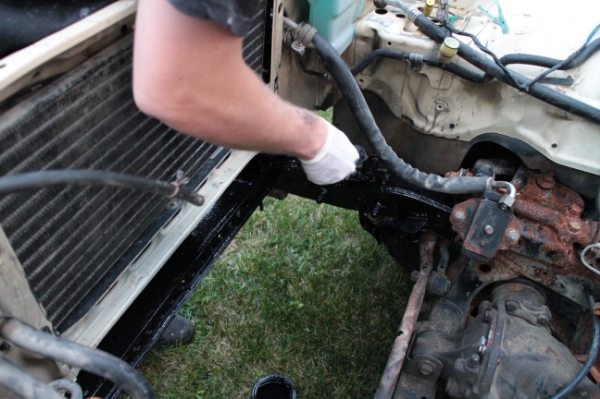

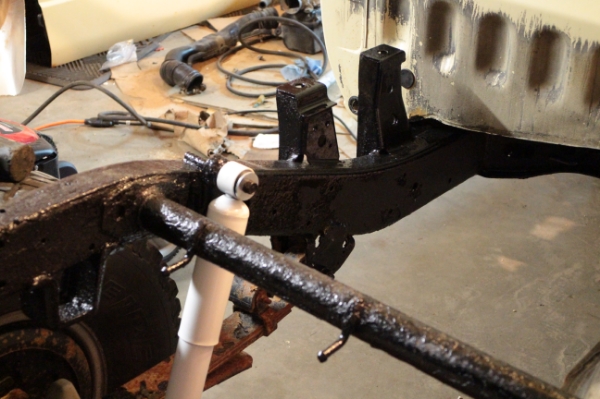

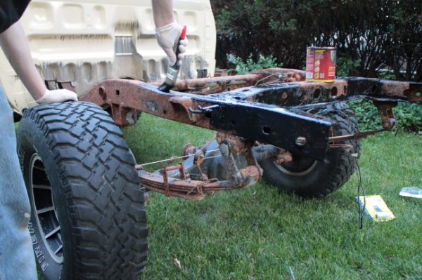

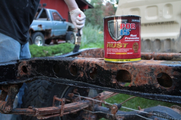

I coated the frame with POR-15. I was really impressed with how easily this stuff applied and spread on the frame. The truck looks so much better after coating it.

It started raining part way through, which made for a great excuse to sit back and have a beer

This crap was on my arm for two weeks

After mounting the fuel tank back up. I was going to coat that too, but I found that it had a big wet spot on the back where it's leaking so I'm just going to order a new one once the truck is running.

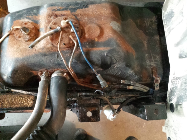

I was trying to figure out how I wanted to give power to the fuel pump, and decided the easiest/best way is to just take the rear harness off the blue truck and just swap that in. This means that every single wire that was in the blue truck is in the tan one now. I never would have thought I would have to move over all the wiring to make it work, but I guess that's why I've read the swap from carb to EFI is a wiring nightmare.
I'm a little confused when it comes to connecting the fuel lines. I'm used to my Nissan which is just a simple feed and return, and just connects to either side of the fuel rail and fuel filter and that's it. I can see where the return comes off the fuel pressure regulator, but I don't see where the feed connects on the engine. I'm also unsure of where the third line needs to go. From what i've read it's just a vent, but I don't know where it needs go in the engine bay

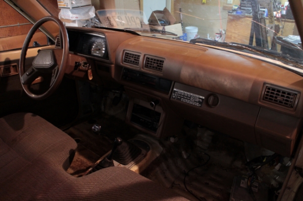

Looks like you are making some progress. While you have the harness out, now is a good time to clean the ventilation system out. It will have dusty vents and the AC and Heater core is most likely got a bunch of junk in there as well.
It is easy to pull the Blower Assembly and AC Evaporator out and reinstall them. Just above the blower, there is a stove pipe that goes up to the windshield cowl and lit may have a bunch of debris up there as well.
On the fuel line, you will need to take the bottom line off of the fuel injected truck and move it over to the project truck. You were correct in needing all of the wiring harness. Don't skip the headlight harness as well. I have seen one wire connector in the fuse box that is different and you will not be able to get your blower motor to your heater/ac system to work. I forget which year that was on that I seen it and it may not apply to all years, but it does exist. It may look the same but is not always wired the same.
The fuel line which is under a lot of pressure connects to the fuel pump assembly can be rusted sometimes. Be careful when trying to separate the line from the pump assembly. The rubber end will have a banjo fitting that goes up to the fuel filter. It will connect to the front of the fuel filter closest to the core support. The fuel filter will have an arrow or be marked "In" or "Out" on the ends of the filter. The "In" should be closest to the core support, and the "Out will be closest to the firewall. From the Out of the filter, it will go up to your fuel rail. The arrow should be facing the firewall as it is showing fuel flow.
While you are working on the fuel system, this is a good time to fill the fuel lines with PB Blaster or Marvel Mystery Oil and let them soak a few days and blow them out with and air hose. I have seen several Return lines clogged and a lot of nasty stuff comes out of those lines.
On your fuel tank, I have cleaned them out with white vinegar and then coated them with Red Kote. I have listed in my builds in the link below. These tanks get nasty as well. Red Kote will seal up several leaks. This is if you don't replace the tank.

I found the line feeding into the fuel filter. That sucker is tucked up in there like I can't believe. I'm disappointed I didn't replace it while the engine was out. I didn't realize that was mounted to the engine block
Im having a hard time telling which line is which coming off the gas tank. I'm assuming the larger line is the vent, and the two smaller ones are the feed and return?

That fuel filter on the frame in the above picture is for the carbed motor. You will need to do away with it. Also you are going to need to swap tanks. That looks like you installed the fuel injected tank to me but cant really tell in the pictures. I will try and get a picture of my tank as the bed is off of it and post some picture with some info later when I get home.
I installed my canister just to keep it from having in vacuum issues and not to throw any codes.

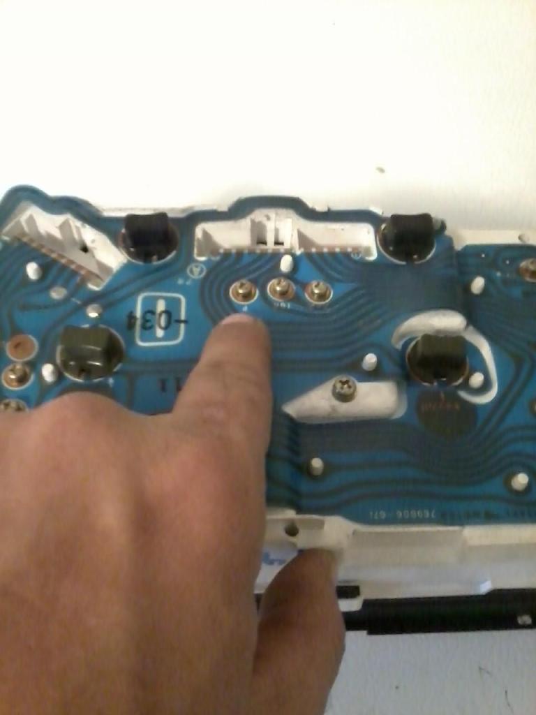

Here is what you do to make the tach work. Run a wire from the negative side of the distributor to the "P" on the back of the cluster. No way of telling which trucks are prewired for the tach that I know of. Just have to plug it in and see. If it doesn't work, adding this wire will make it work.
Copied...
I am starting on getting the tach working. I found this on getting the tach wired up if it doesn't have the factory wiring. I will post good pics if this works.
LINK>>>> I found http://www.siestaoffroad.com/clustertech.html
Back of gauge is marked with a "p".

Unfortunately, neither of my clusters have a tach, which is something I would like to change out some day. It's good to know everything else is the same though.
I ended up figuring out the fuel lines through trial and error end finally fired up the engine. This victory ended up being short lived when I discovered that I can't put the transfer case shifter in. I kept the transmission that was on the EFI engine, and the shifters are about 3 inches further back than the one that was in originally in there. I had no idea they would be different. Which is the better transmission and what are the differences? I feel committed to using the transmission that's in there at this point and just cutting and patching the floor to make it work. It'll be covered up by a vinyl floor mat anyway.

I did some wrenching on the yota tonight. Connected up the drive shafts as well as a few other necessities for it to go down the road.
I cut out a small part of the floor so the transfer case shifter would fit. I figure I'll be cutting it out more down the road some day if I decide to upgrade to dual cases, so it's no biggie

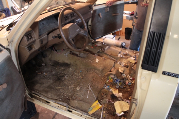

Today, I worked on putting the interior together. I still need to order a vinyl floor for it and I would like to replace the factory bench seat with some nicer bucket seats when I find some I like
It had been a few weeks since I tore out the interior, so it was a bit of a puzzle figuring how the hvac system and dash board went together
All finished up.

I haven't posted anything in here for a while. I did break in the truck on the trails in the fall and it did great. We went to the Iron Range ORV in Gilbert MN.
I drove the truck the 6 hour drive out there and back, which unfortunately meant putting the rusted crap box back on there. Didn't want to get a ticket for uncovered tires and I needed room to store stuff. The tires on it were dried out and cracking, so I brought two spares off the parts truck to be safe.
Check in at the Iron Range. I was there wheeling with my brother in his Jeep
Starting off
A lot of these trails were a good challenge for the stock yota. I unfortunately couldn't make this little hill. The deep ruts were a challenge for my worn 31" tires and kept bottoming out on my skid plate and axle. Unfortunately, the Jeep made it... time for upgrades! I can't let that happen!
The rut threw the rear of the truck into a tree, barely missing my tail light. Thankfully I didn't get a new box before this haha

The truck sat for a while at this point. It's winter and I didn't want to drive it in the sludge. I feel like it absorbs salt like a sponge.
Finally got a good deal on some new wheels and tires from Discount Tire in town. They're still just 31x10.5, but I'm sure they'll perform much better on the trails. I'm going to be wheeling at Southern Missouri Offroad Range in April. I'm thinking about getting a lock-rite in the rear before then. I'll have to see if it'll fit in the budget before I go.

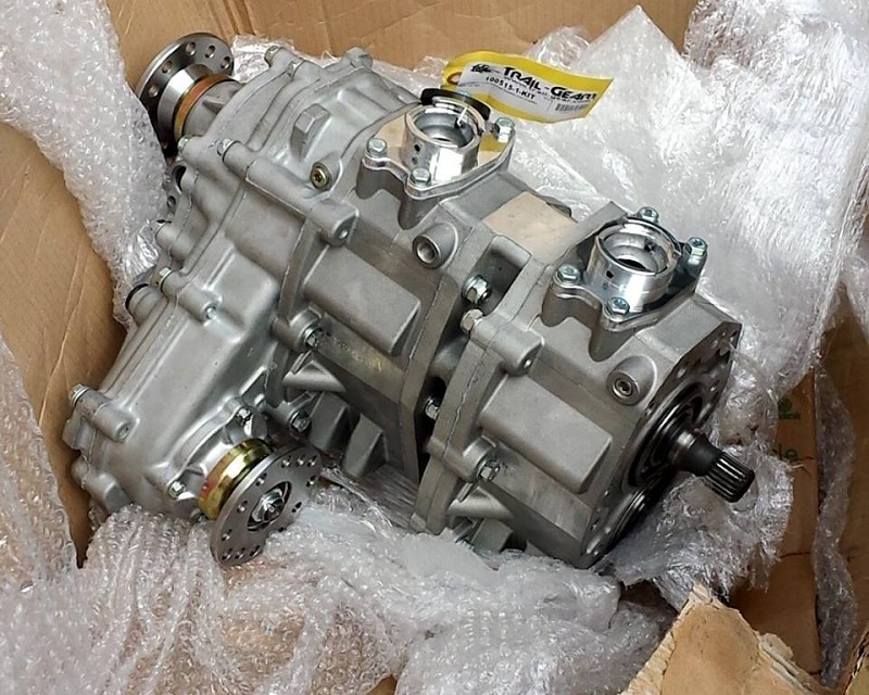

Brown Santa came today and he brought crawler parts. The stock low range gearing on this truck is one of the biggest problems Ive had to deal with on some of the more technical trails that we've been doing. I'm always finding myself having to ride the clutch. Next comes lockers, which i'll probably do in the spring. I was going to do dual cases in the spring, however Trail-Gear had their end of summer sale so I bought it while it was discounted. I picked up the standard 2.28 front case and 4.70 rear case setup. I'll post back up when I get everything installed - I'm still waiting on more parts to arrive.
