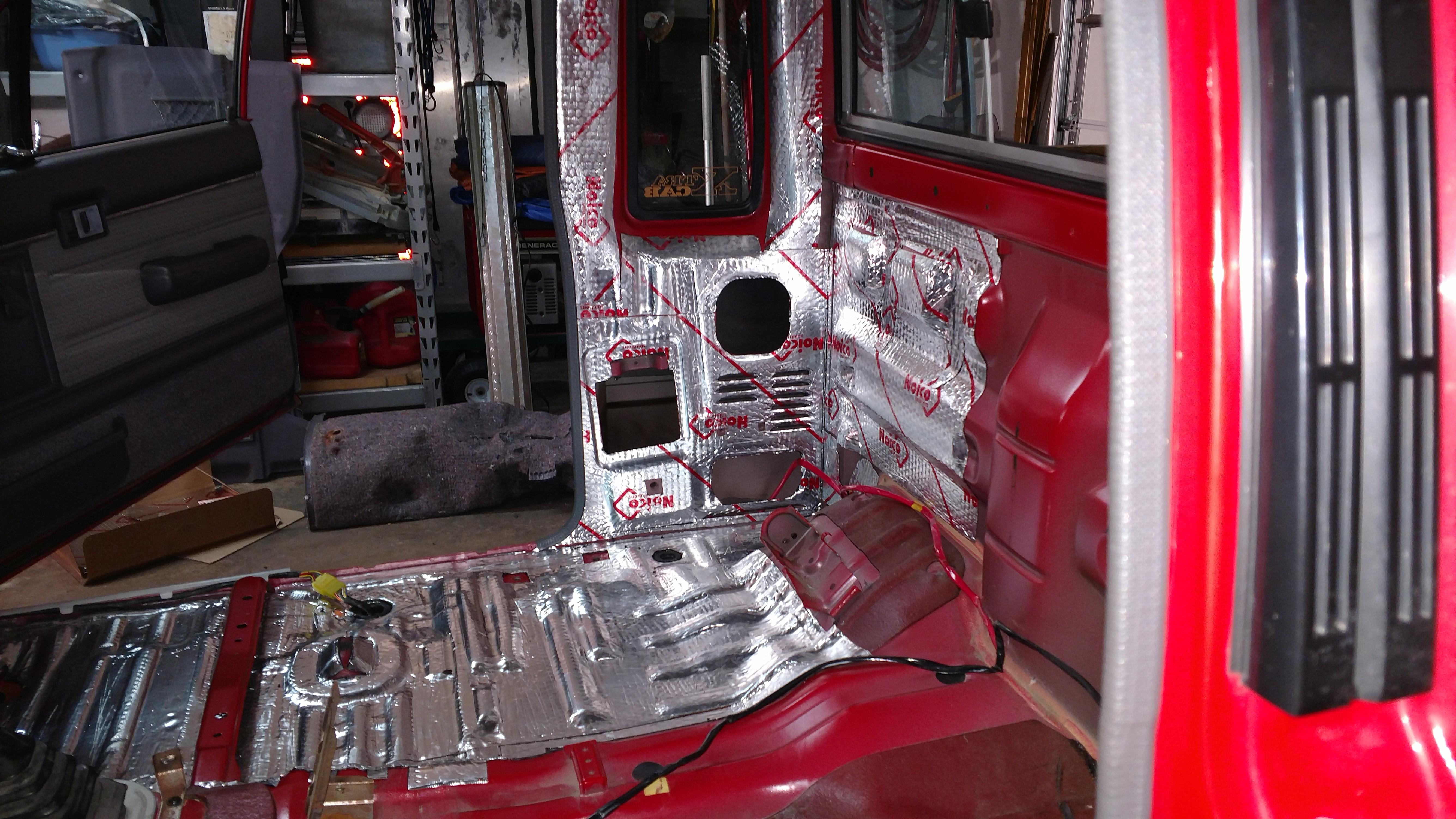

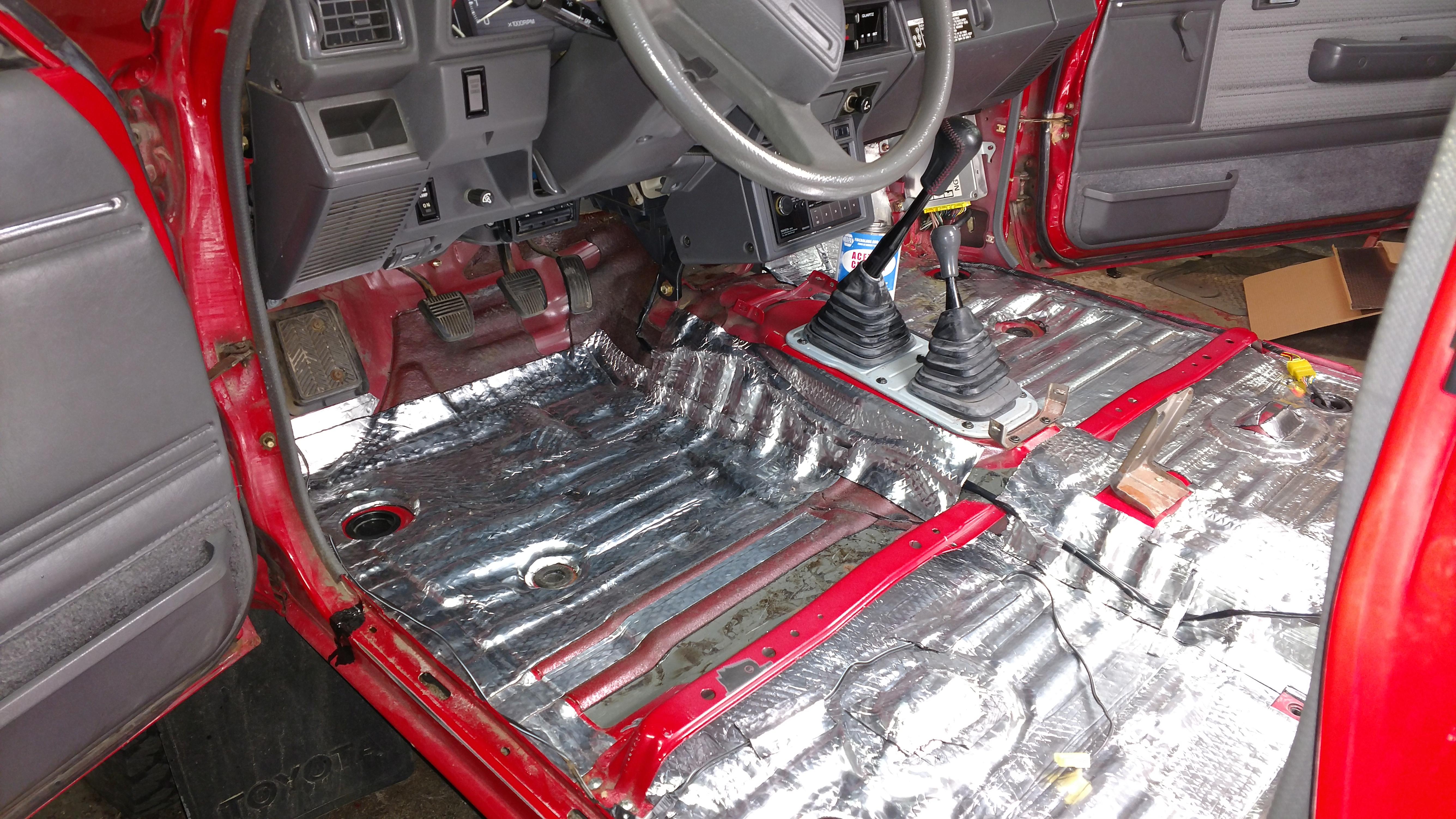

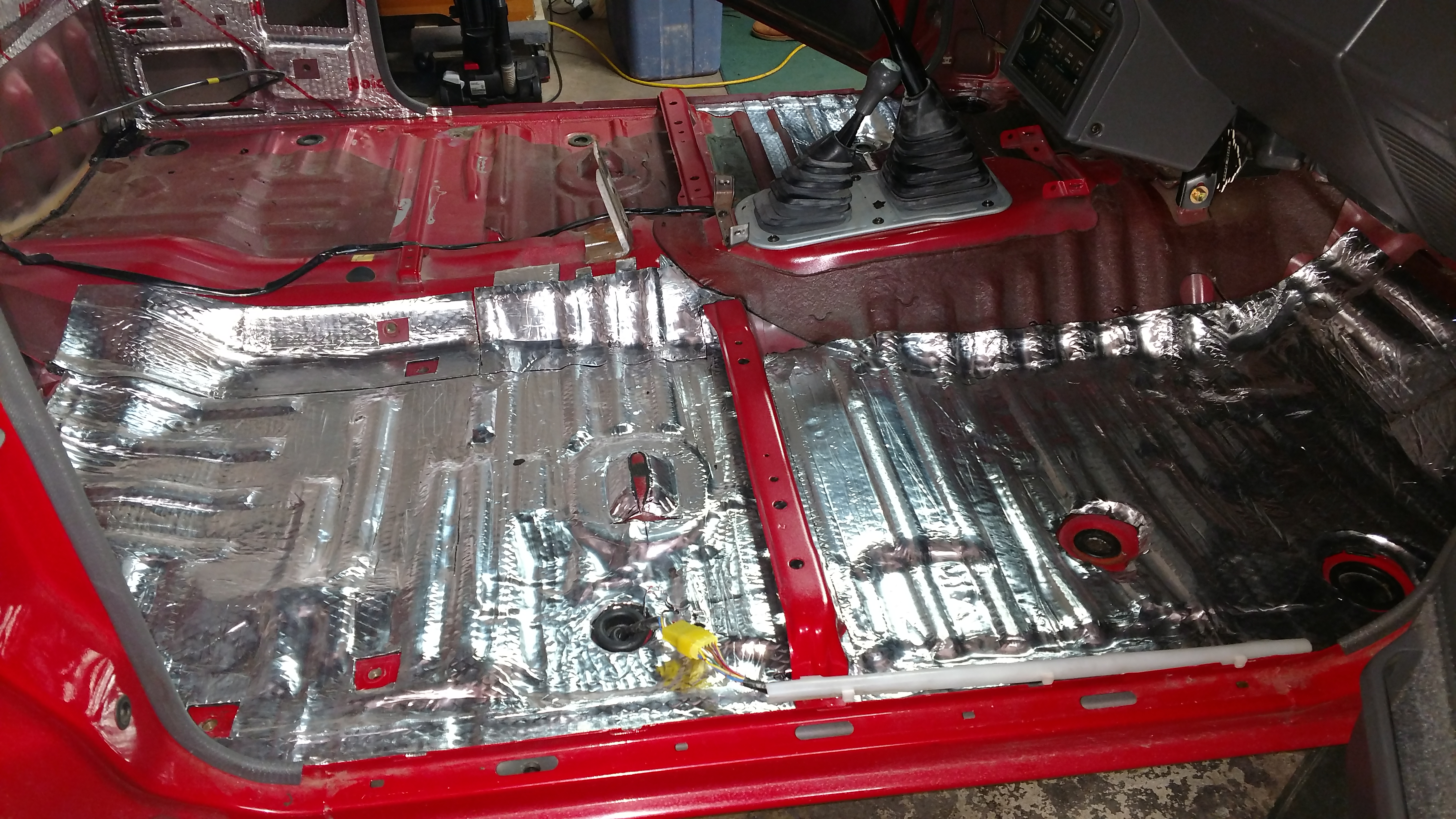

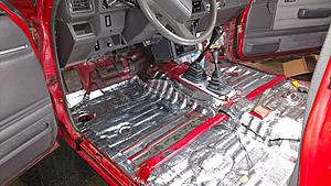

Nice idea putting that strip down between the floor ribs, wish I had done that. Is that peel n seal or dynamat or what?

I put 2 layers on the whole floor. It is an 80 mil thickness material I got off Amazon. I only did one layer of 50 mil on the back of the cab.

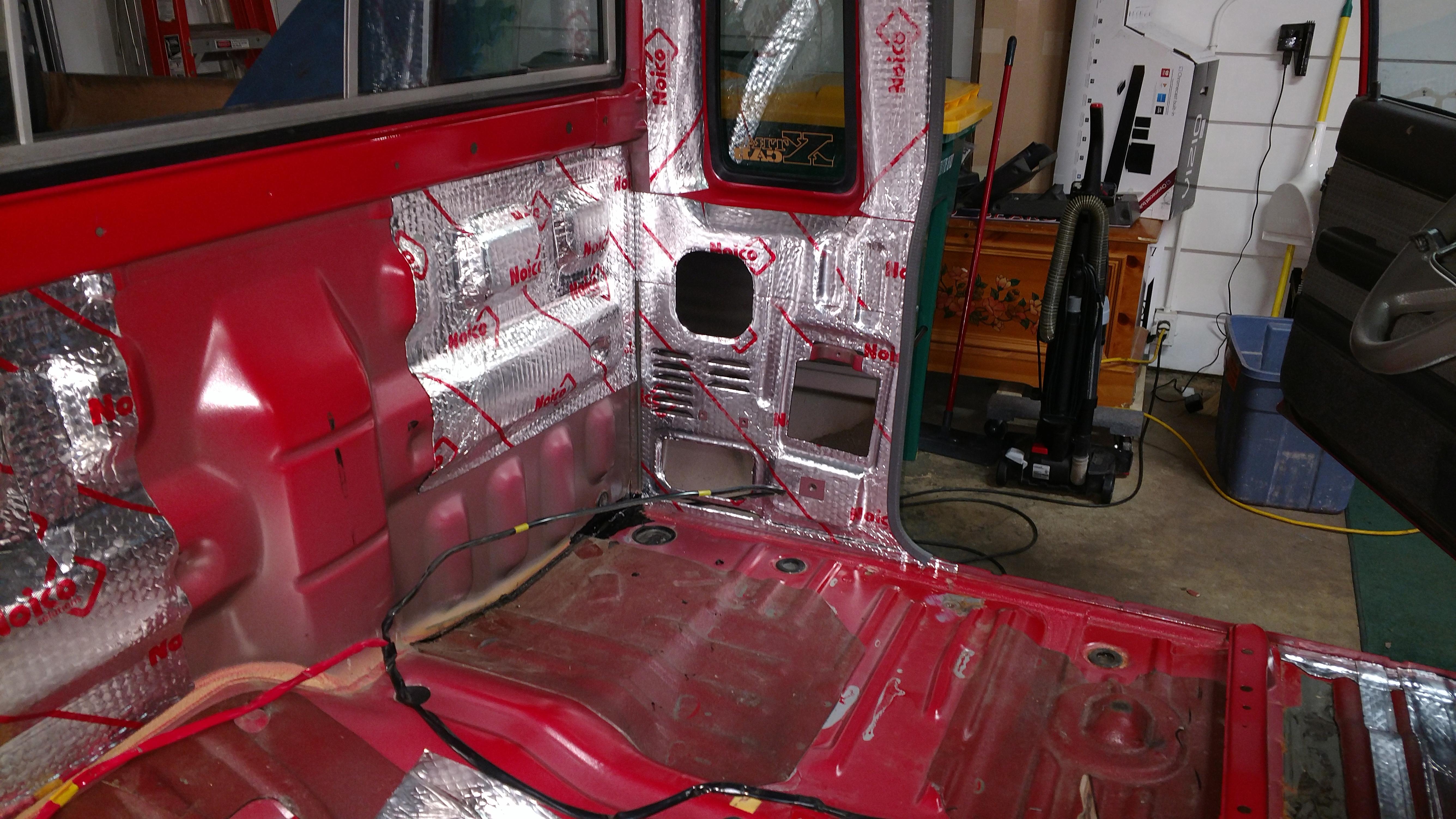

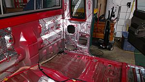

the complete floor

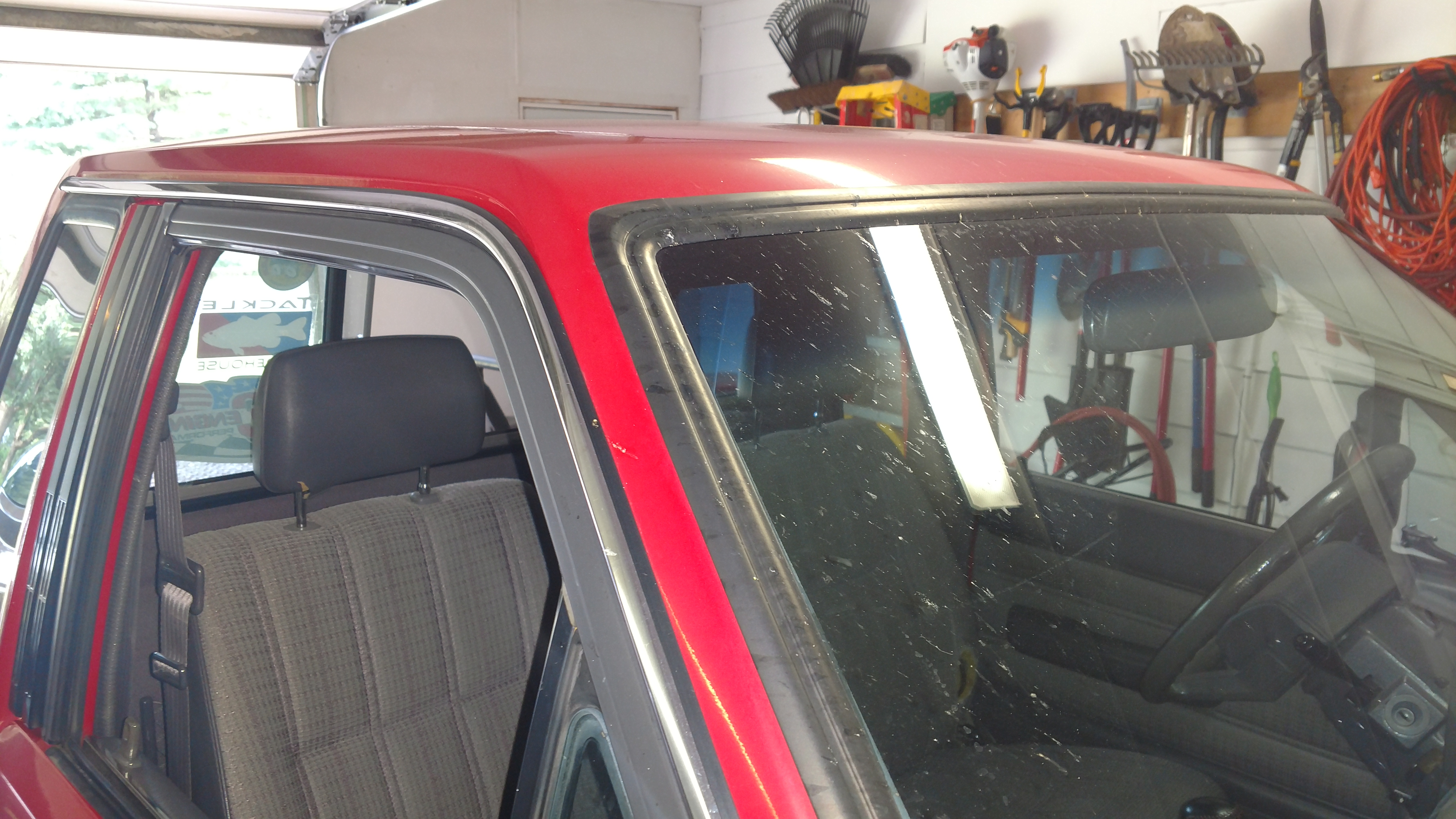

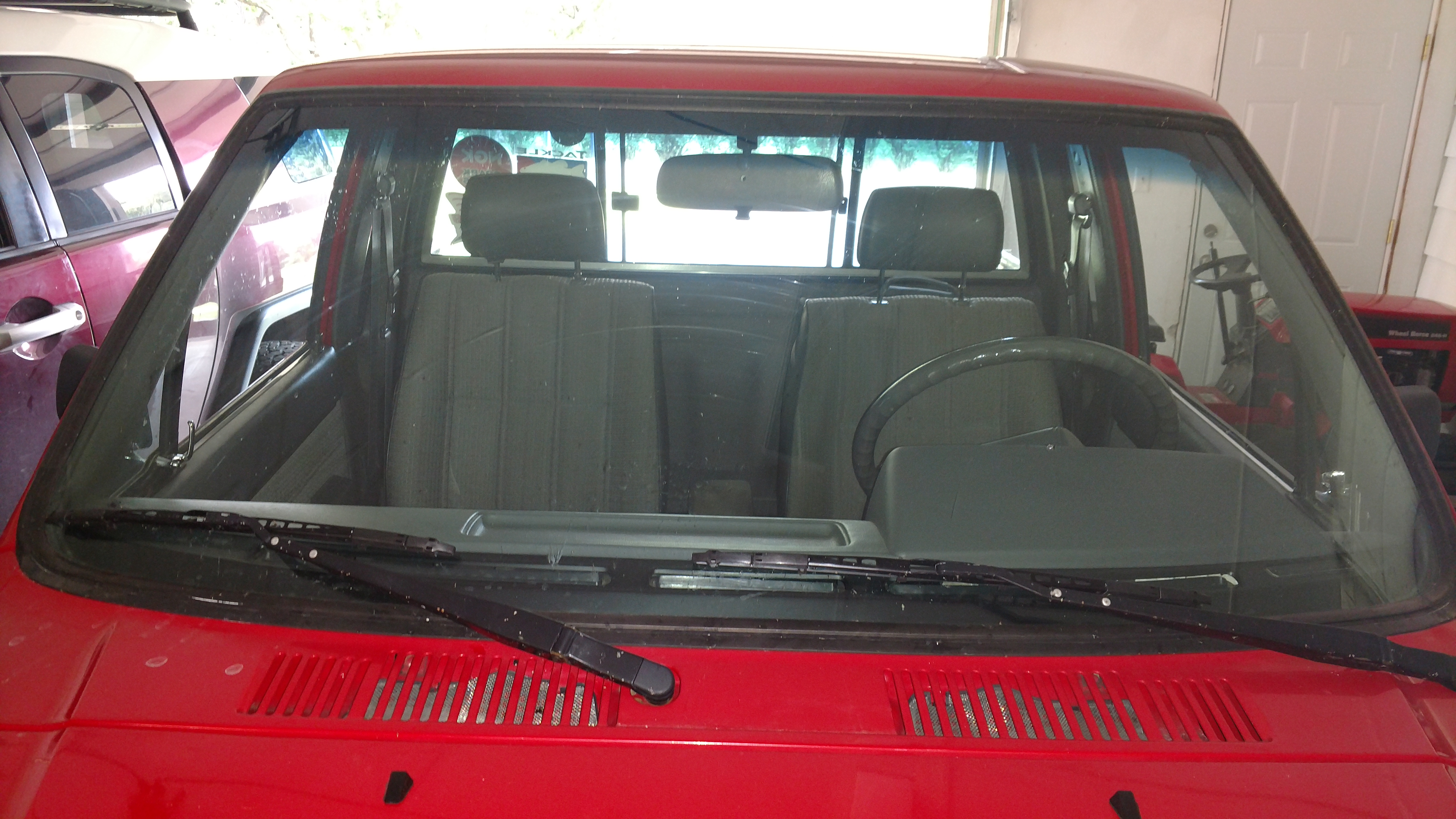

Here are a few pics of the windshield gasket I got from Corey at Toyota Fiberglass. Much better than the crappy trim. I think with shipping it was about 250.00. The glass installer did have to grind about a 1/4" off the bottom to make it work with the gasket. I had that done last fall and zero leaks thru the winter, spring, and summer. I don't know if you can see it the full pic but about a week after having my brand new windshield installed I got a rock chip!! Drivers side about 3 inches below eye level! but still annoying
And the wiper arms are off a newer 4-Runner. I did have to drill the arms so I could push the hook in a little farther. But it worked very well. Newer style hook arms give you many more options for blades. I run a 16 in on the passenger and a 17 in on the drivers side

Cory, I'm not sure what the difference is between the 2. this stuff had diamonds on the foil side you had to smooth out. Like a butyl rubber adhesive. it stuck down very well. Amazon. 18" x 36" sheets. Noico is the company.

Thanks for the window gasket pics!
On a different note, there are "hook adapter kits" - often they come with the hook type wipers. I bolted on adapters eons ago (like 1990) and have been running Bosch wipers...

i just didn't think they worked that well and i got the set on E-bay for like 20.00

The windshield gasket was 250? Or was that price for new glass?

yep converted to R134 on a 90* day i can get 46-48 degrees coming out of the vents. And yes it was 250 just for the gasket. It was 200 for the gasket and i think 50 for the shipping. A little pricey but i think its worth it. I like the look allot better then the windshield trim. So if you need any trim for the glass I have almost 3 complete sets
