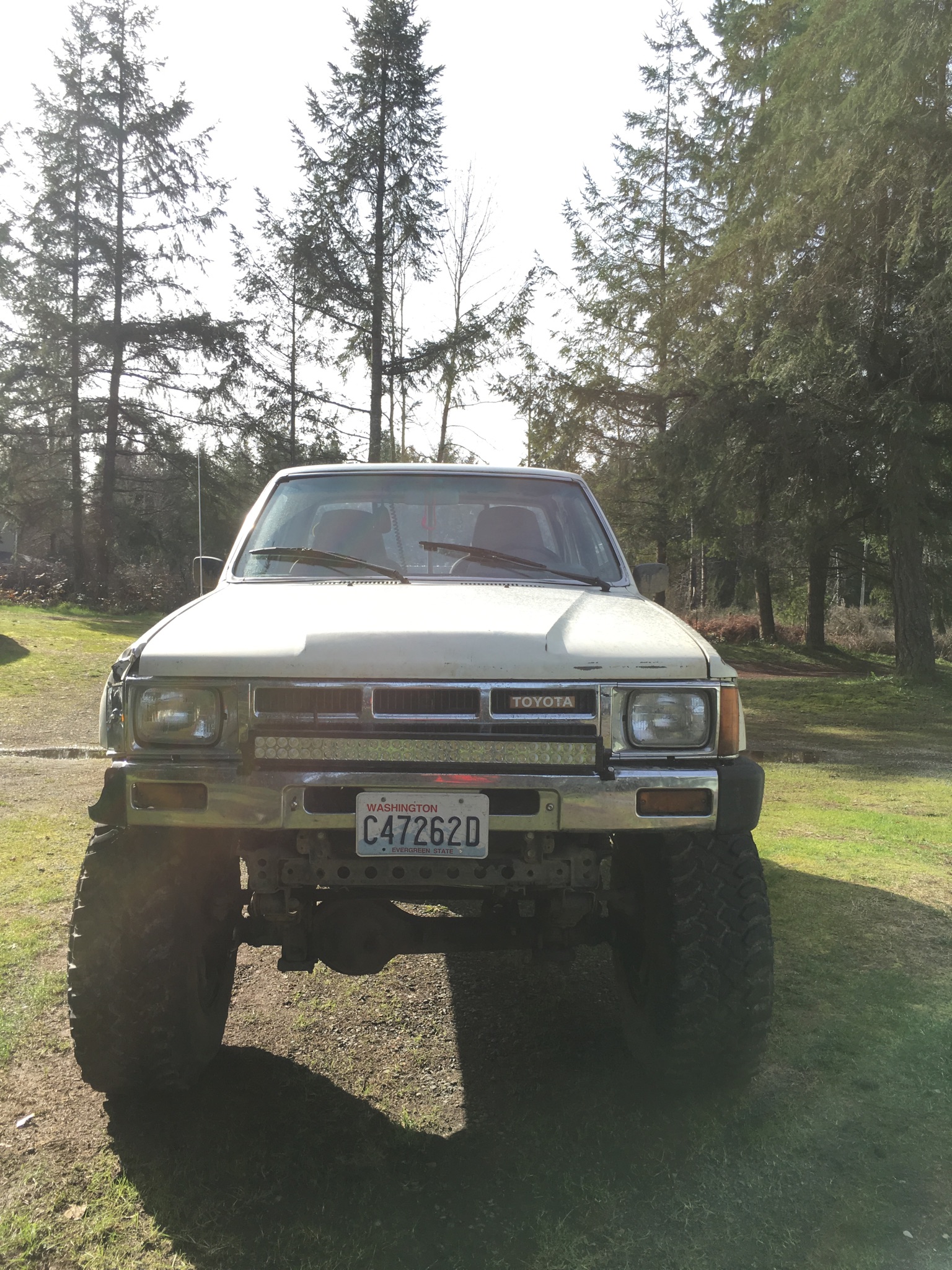

bumper time
well i got the old light bar and bumper off. here are some before / after pictures of it. i ordered the stinger and it should be here in a week. i also took off the old amber running lights and ordered amber led pods to replace them. As well as a new light bar. Sold the old light bar.

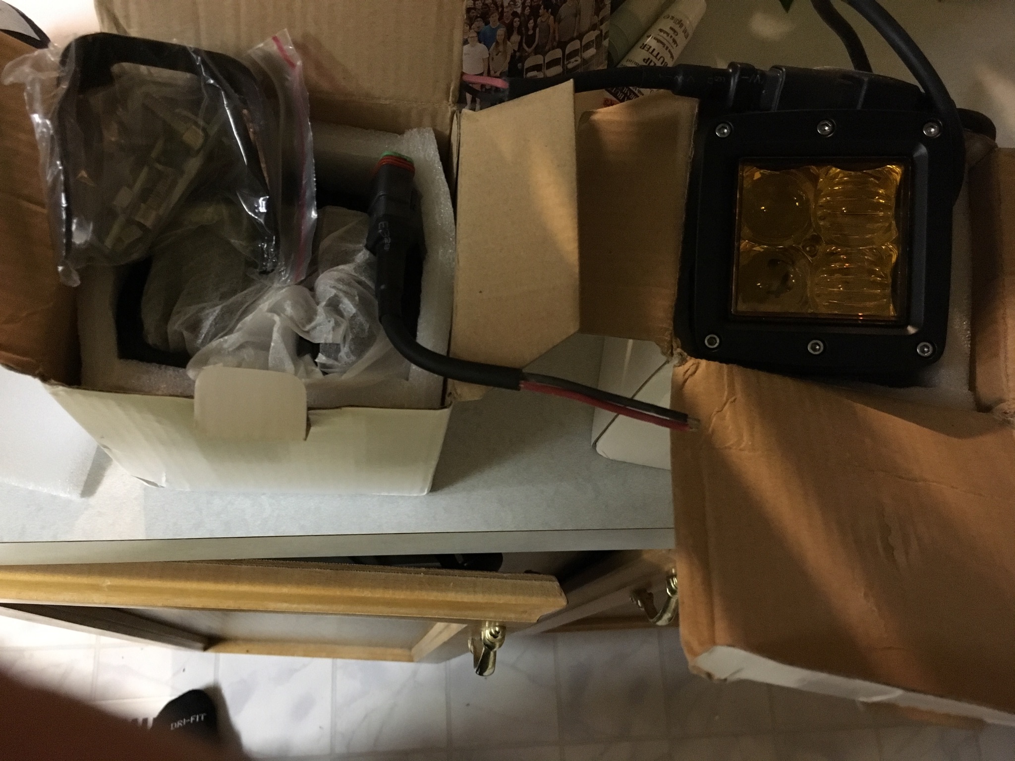

here are the amber led pods. thinking ill use them for turn signals, think it'll be sweet if i have my hazards on, like a strobe. what do y'all think?

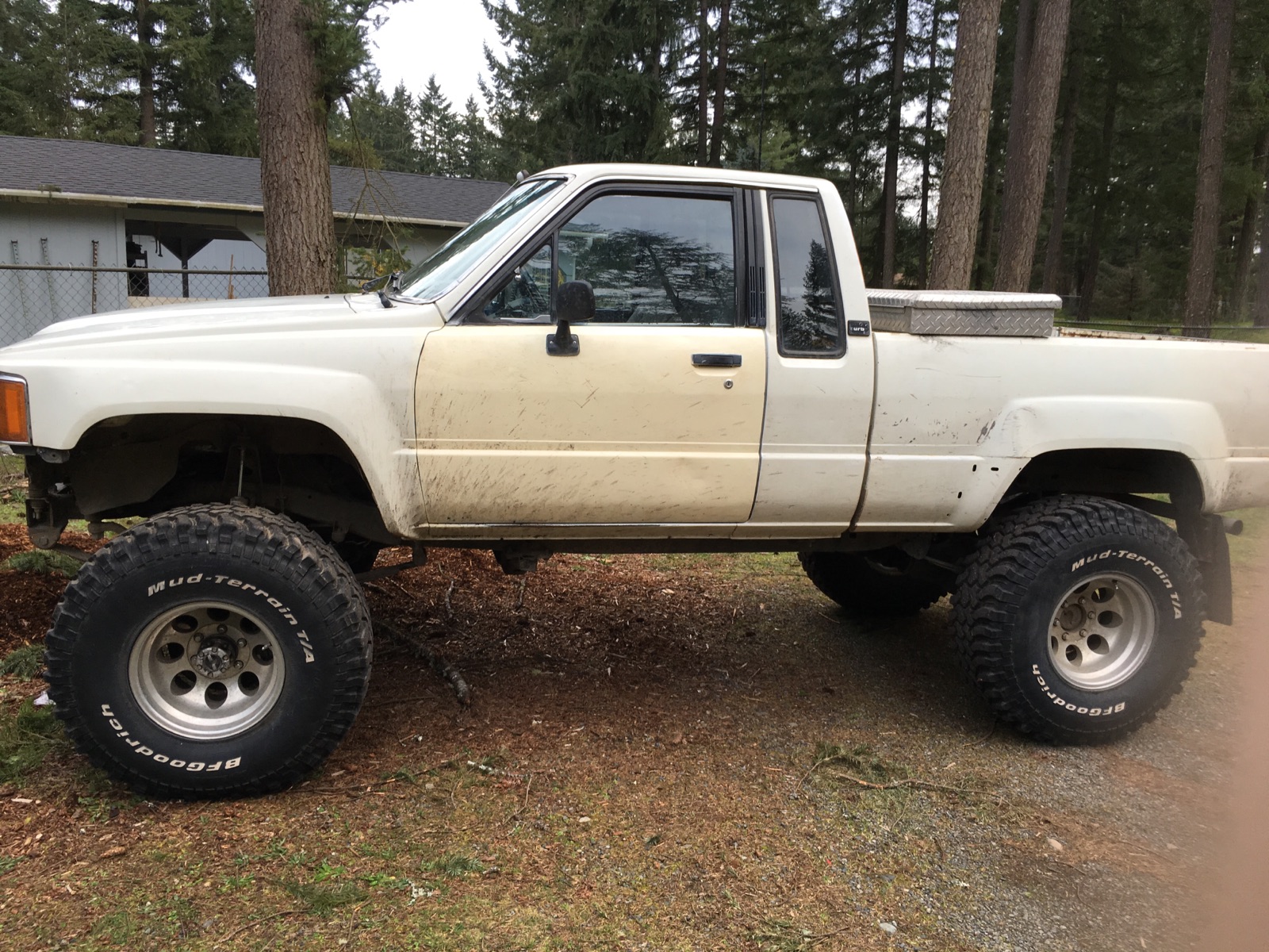

also here are more pictures i just took. i have the rock sliders ready to be welded and the stinger should be here any day!

here are the pics, they didn't upload to my last post.
Attached Thumbnails 85 Yota Build-img_0972.jpg   85 Yota Build-img_0967.jpg   85 Yota Build-img_0969.jpg

Man that's a nice looking x-cab! I got to get me some LED lights, how do you like your light bar?

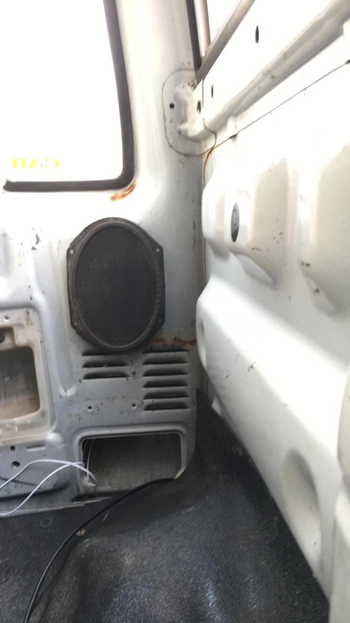

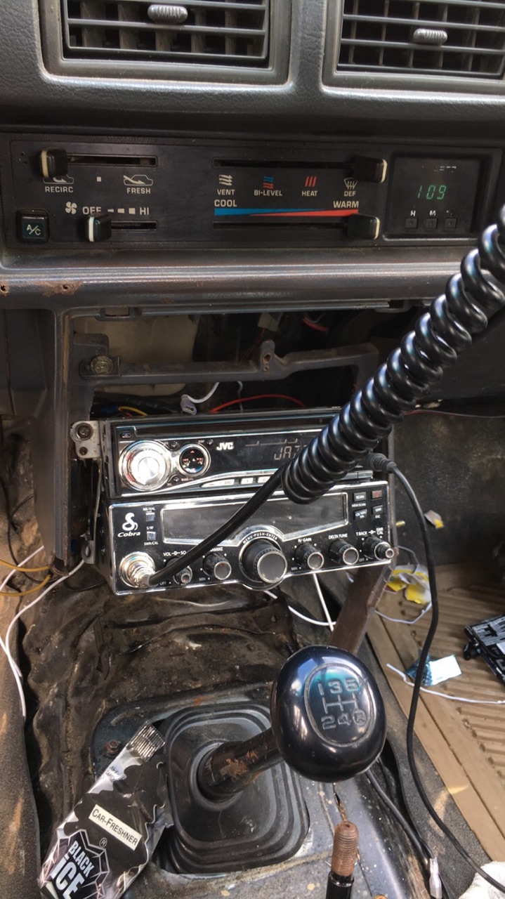

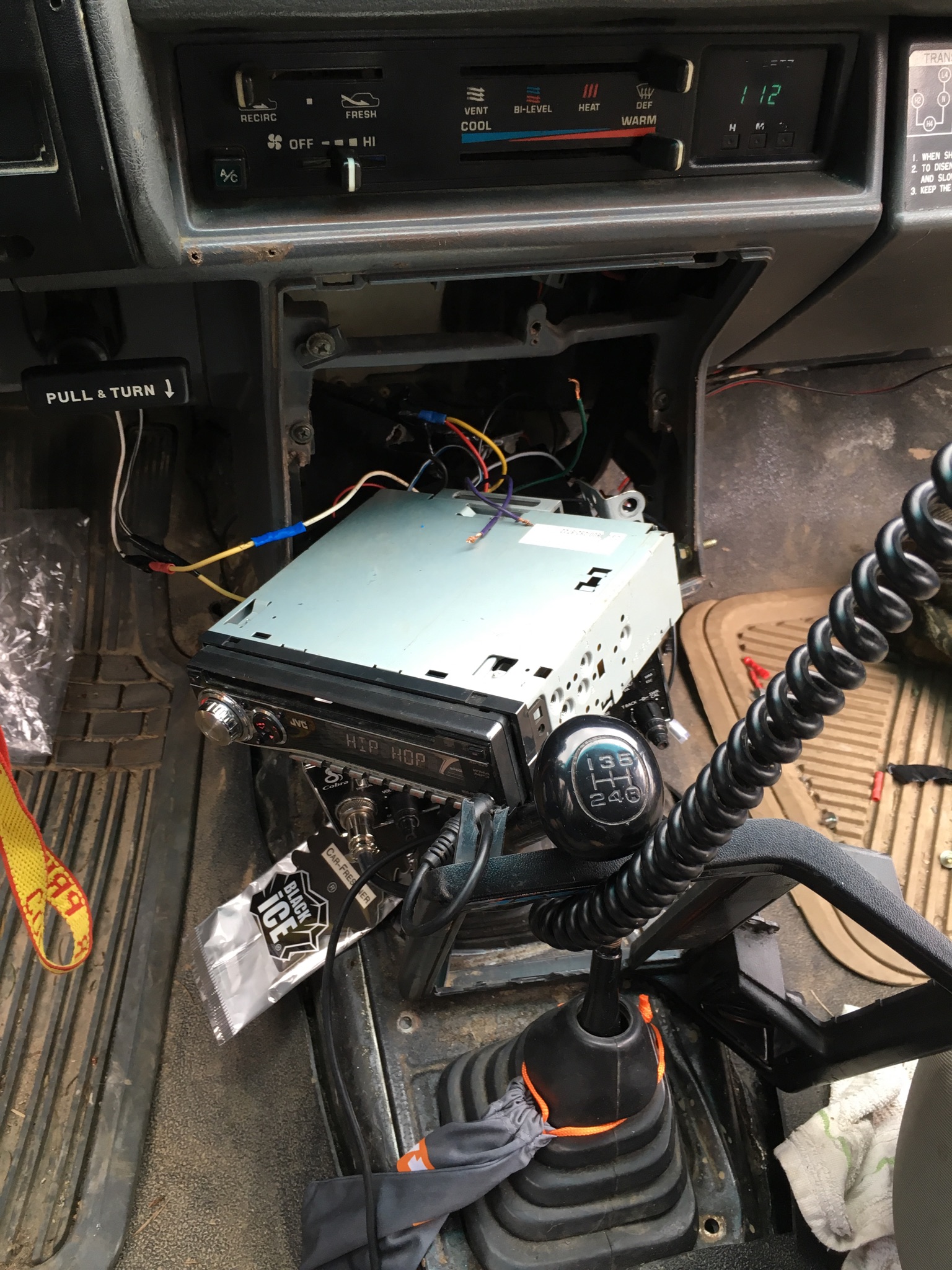

well i got bored today and took the Toyota for a drive around town and realized i need some more speakers in it!
So, i gathered up two Ford 6x9's that i have from my F-250 (i put Kicker speakers in the Ford) and wired them into the Toyota. and holy crap it's loud now!
Altogether it's only two 6x9's and two Alpine 4's but it sounds great. I also re-mounted my CB and radio to the dash because they kept coming loose in the old setup. I also had to rewire all the speakers because the dude before me used duck tape instead of butt connectors. It's all looking solid now though!
I took some pictures during the install and will attach them to this post.
(the pics were before the wire clean up & tucking)
Attached Thumbnails 85 Yota Build-img_0989.jpg   85 Yota Build-img_0991.jpg   85 Yota Build-img_0992.jpg   85 Yota Build-img_0993.jpg

Sounds like you got a killer deal on the new woofer and amp! I noticed on your stereo/CB instal you didn't have the bezel, are you missing it or just didn't have it put on yet when you took the pic? If you need one, I think I might have a spare stashed somewhere.

i have a bezel, i had it off for the picture because the CB and stereo push it out and don't let it clip all the way in, so i plan to cut it and re mount it. I have my light bar switch where the cigarette lighter would usually go.
