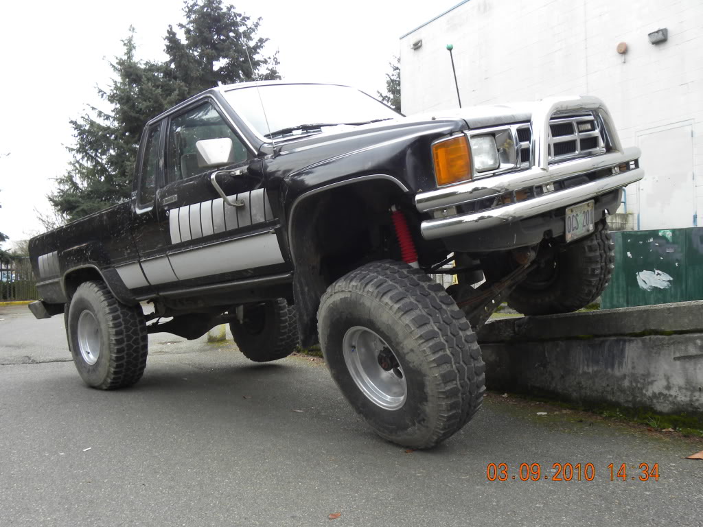

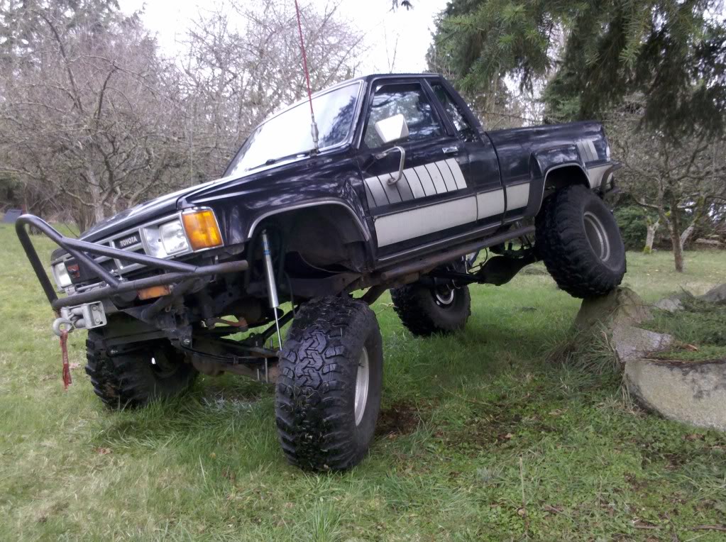

Fast forward a couple of months I am on craigslist looking for yota parts and I happen upon my unicorn. A Black 1985 SR5 5spd EFI Extended cab 4x4 with 116k on the clock almost no rust with a lift 35's 5.29's and lockers about 160 miles from me actually in Oregon. His asking price was $4300 i think... I talked with him for over an hour on the phone and feeling confident I decided to travel down there to see it. It came with way too many spare parts to list And i got it for $3800. I drove it home loaded down with way to many parts only 3 shocks and a broken center pin on the rear axle. Halfway home it was getting kinda warm and the oil pressure dropping. So I pulled over and let it cool down we got a new radiator cap and away we went no more issues. The next day i drain the oil to change it only to find it half empty I drove it for a while adding a quart every 1000 miles or so until i finally decided to rebuild the head and timing chain guides. Big mistake the new head increased compression and made me burn twice as much oil... So after living with this for a while I went for the whole rebuild no expense spared. Including my 4runner i took the bumpers off and sold it to a friend to fund this. Here it is the first two pics i snapped of herName:  backup427.jpg

Ever since that I went nuts First I put my bumpers on it and got 36in Iroks. That was good for a while i did all the little stuff like stereo and luxury items as well, Then it was time to get rid of my old suspension I had stiff as heck allpro springs up front and frankenyota aal/shackle lift in back. Sold it on craigslist and got my wallet out for Trail gear 4in springs front and rear, Bilstein 5125 shocks, IFS steering box, crossover steering, v6 front brakes, Trail gear rear disc conversion, a Trail gear front spring hanger, Big master cylinder, a Trail gear front driveline, and custom one piece rear drivline. all at once man what a different truck I built lol, but still wasn't enough so I dual cased it with everything Trail gear and got new drivlines again lol. So here my truck sits the truck of my dreams and then bam it happens 15,361 miles since the motor was rebuilt it develops a small Head gasket leak... It took about 10 months to get it fixed (under warranty) It seems long still but i guarantee you its the short version by a whole lot. Name:  IMG_20110213_141319.jpg
Heres my truck 850 miles since the most recent rebuild hopefully i have good luck for a while. Only things i really want to do to my truck in the future is replace my rear detroit with an e-locker, a hydro assist, bedline the whole thing while retaining the SR5 stripes, and some point swap in an OM617.Name:  2013-02-18_16-52-44_715_zps58ea3829.jpg

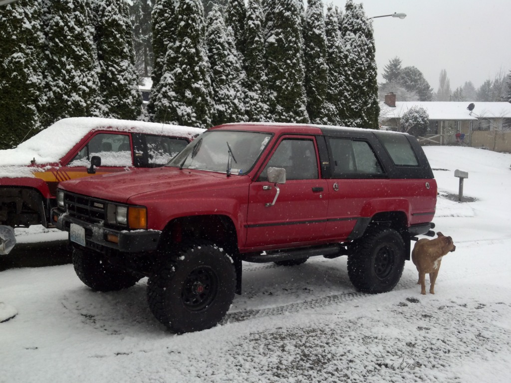

Here is a pic of the 1985 4runner I had for about a year it was an auto and couldn't afford two toyotas so i traded it for a rifle after the flexplate broke and pissed me off it had 249k on it a newer engine and everything else wearing out lol i decided a pick up with canopy is better than a 4runner cause you can just bolt a seat in the bed if you need passenger room and you don't have to listen to themName:  2012-01-16_12-14-01_52.jpg

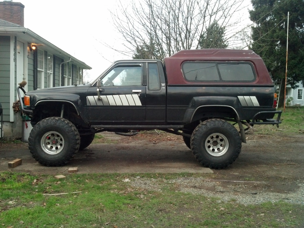

And here is the most recent pic of my pickup when i sealed the window up on saturday

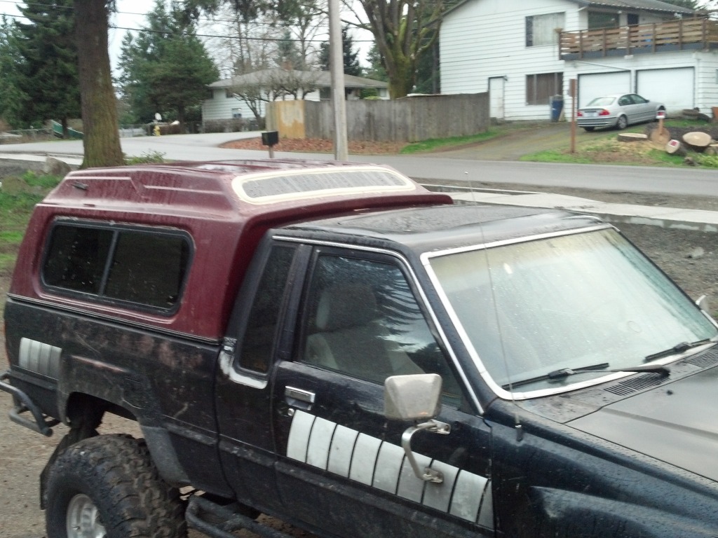

I really want to paint my canopy soon i did this on photobucketName:  3b6d973c-9626-46e5-9eab-753180de69cf_zpsd4fae321.jpg

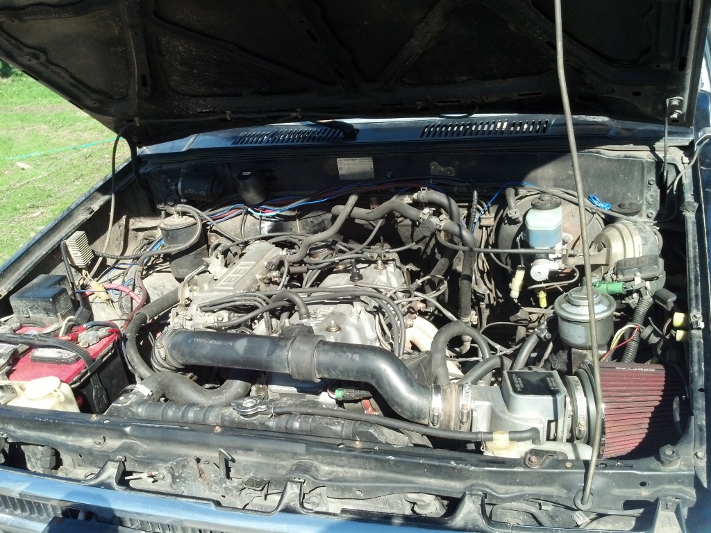

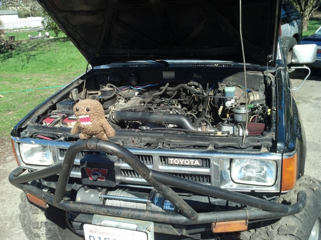

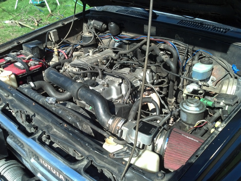

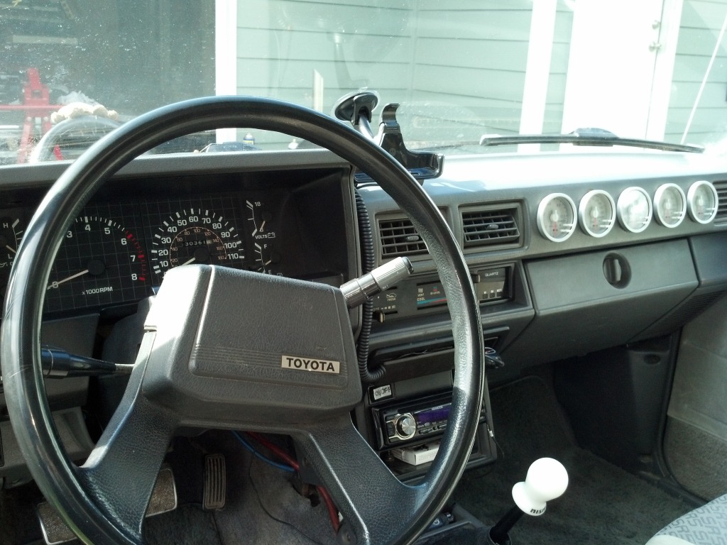

Did some cleaning today and checked its bodily fluids. There was some really old mud on my dash and gauges. Also here is a couple of pics of the engine

I really like your rig man. That gauge setup above the glove box is really cool. I never would have thought it would look that good like that.

Thanks man! yeah it was an interesting process cutting 5 60mm holes in my dash. I did it with the dash installed and just kind of eyeballed if there was enough space behind them and i got lucky they fit with the control boxes and all. The fact that these gauges cost more than some peoples rigs prompted me to immediately get an alarm for the truck...

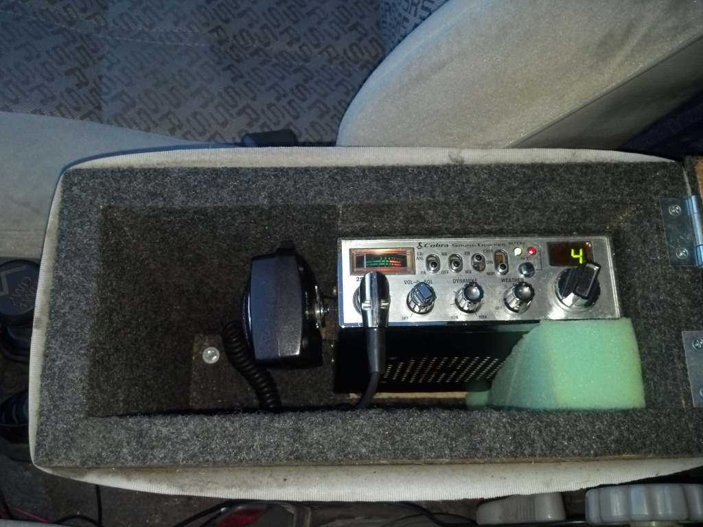

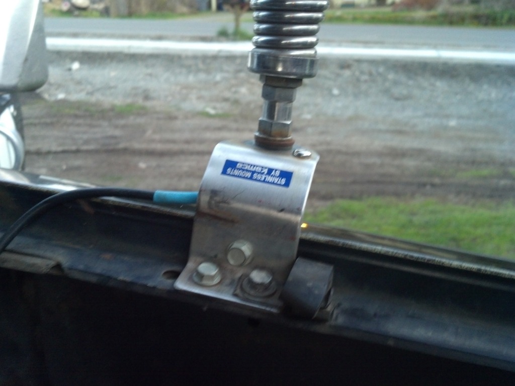

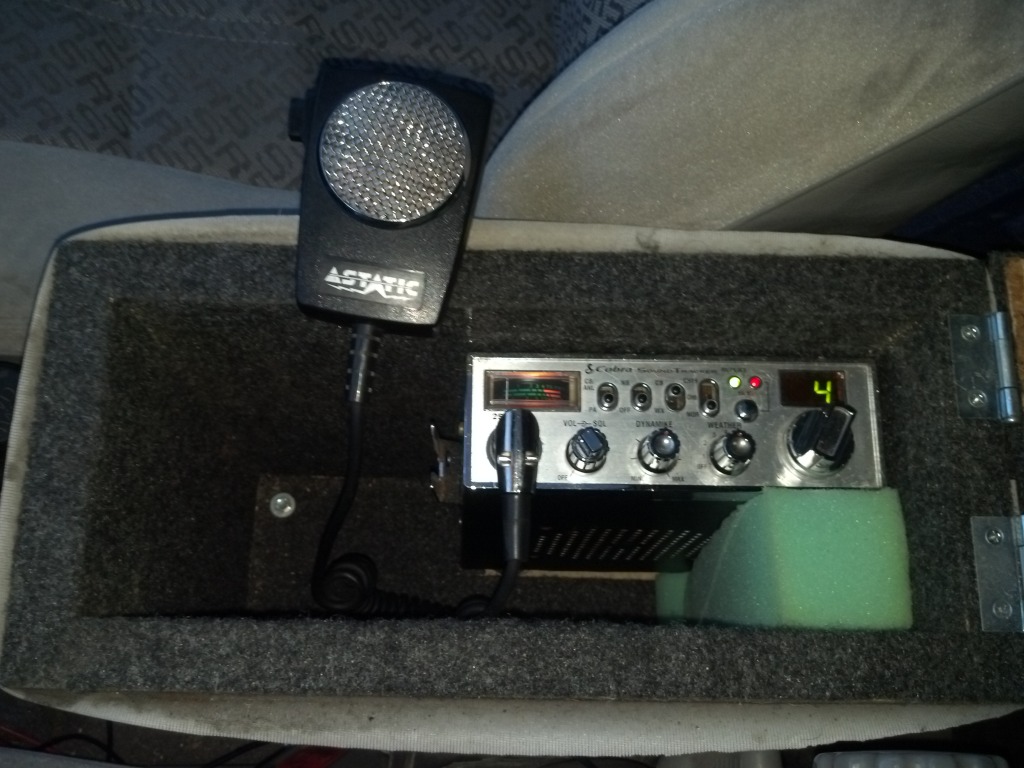

So I remounted and re-wired my antenna for the CB today and put an angled plug on the radio so it fits nice in the center console. I don't think these bolts will budge.

Nice rig. where you get that cb mic?? and whats a fecalpheliac!!?? haha!!

Thanks, I got the mic at Truck City CB a few years back and I love it.

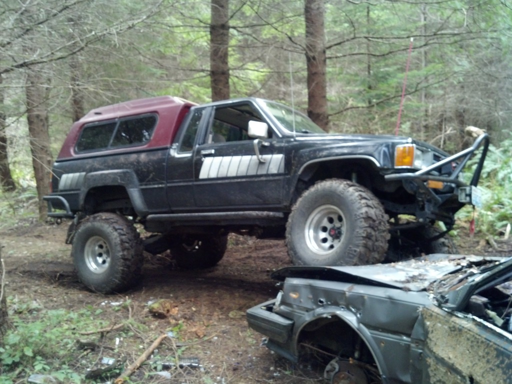

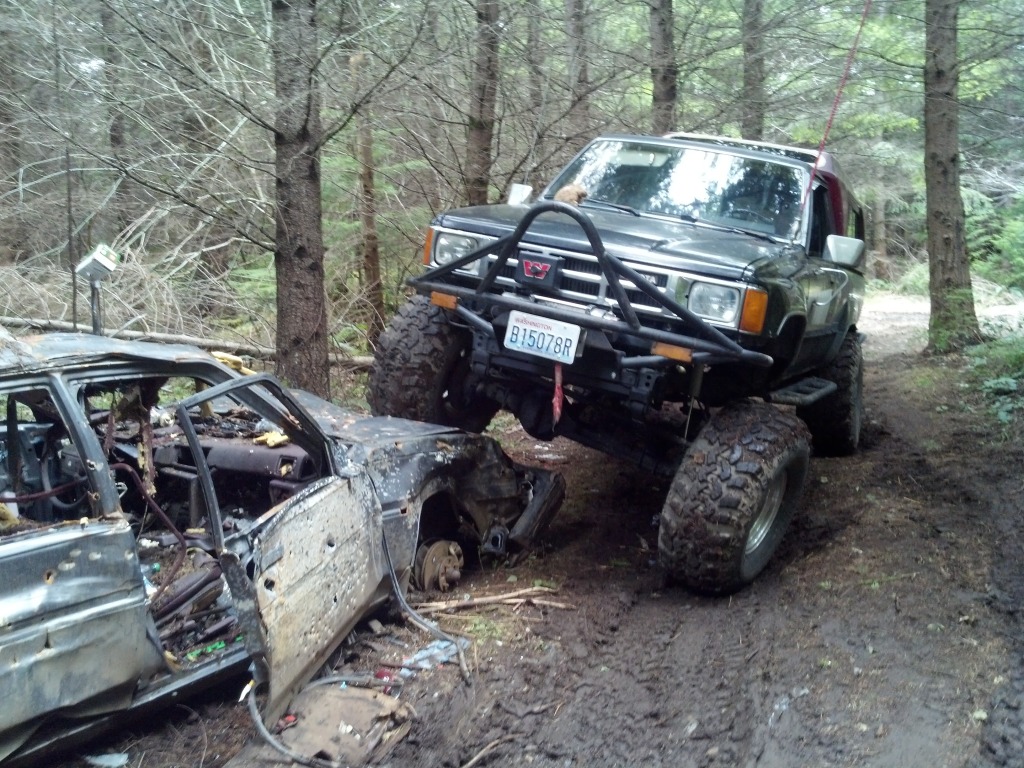

Took her out for to some forest service roads for some light wheeling and exploration found a Cressida way out in the woods shot all to hell. I drove up it higher just don't have an e-brake so this was the shot I took posin on the poor Cressida. Funny even with the condition it was in I was still looking for usable parts... there were none

Good to see she's running well. Sad to see the Cressida in such sad shape though...made a nice "rock" though.
