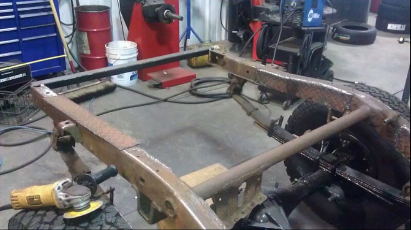

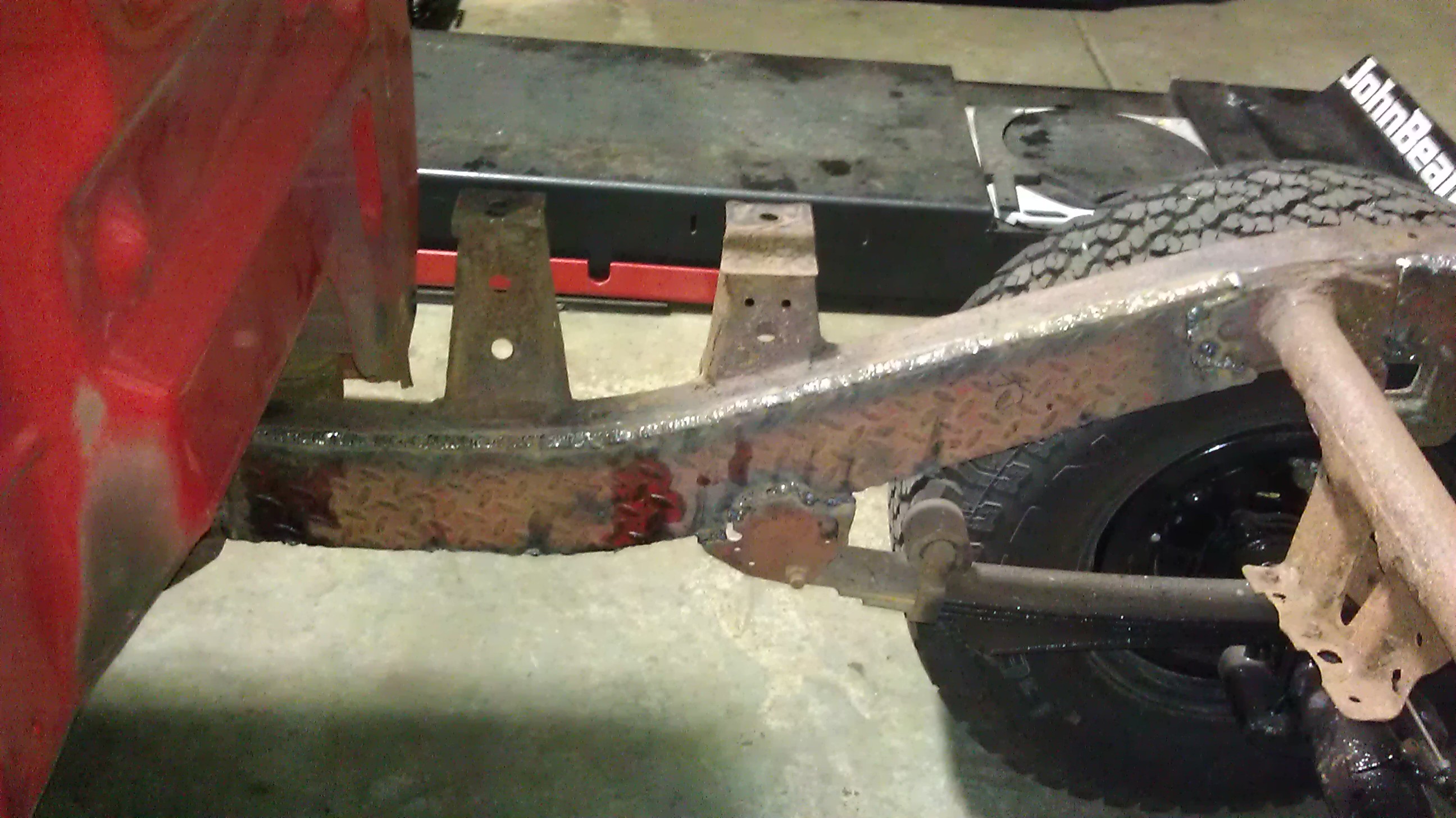

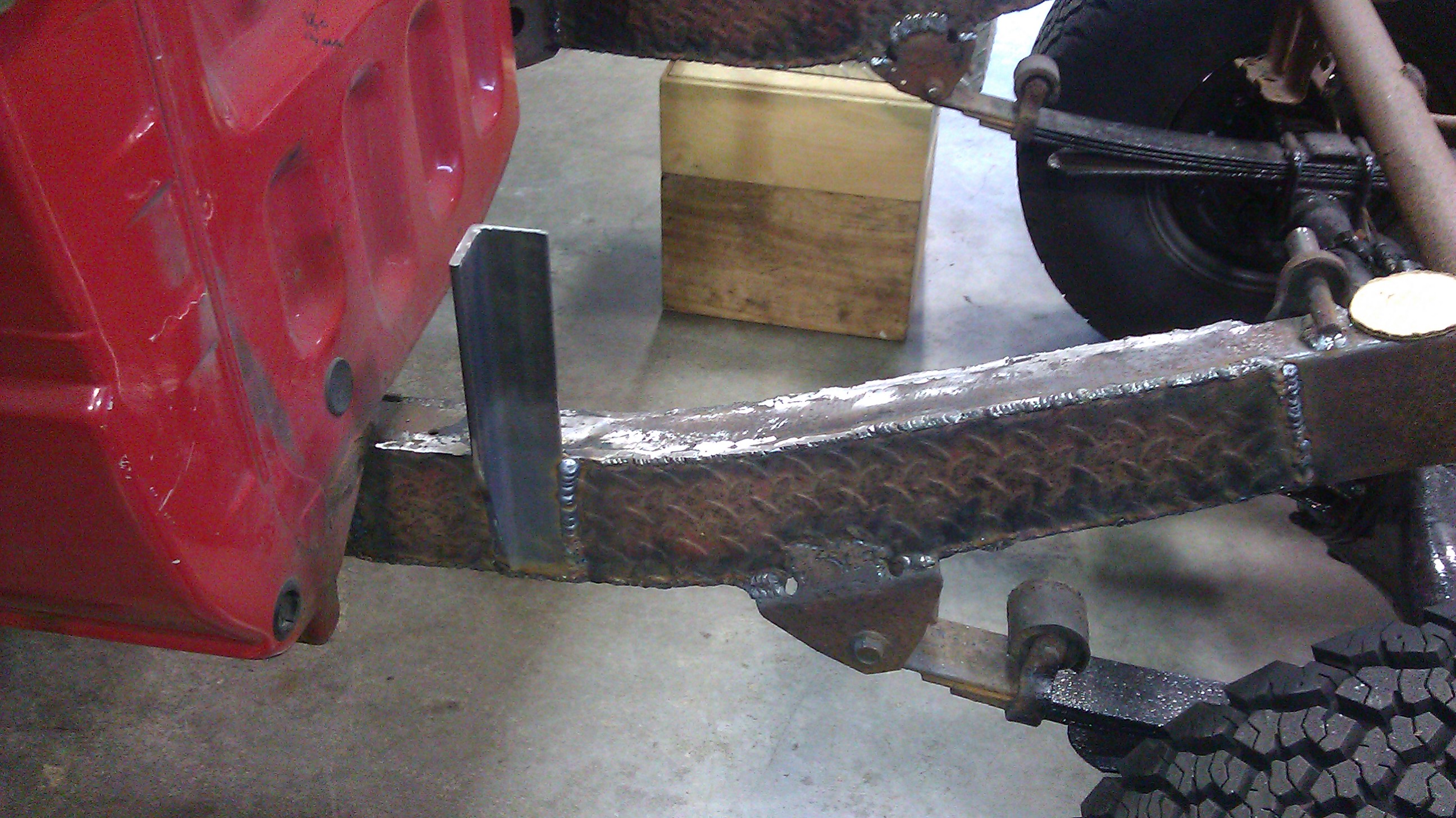

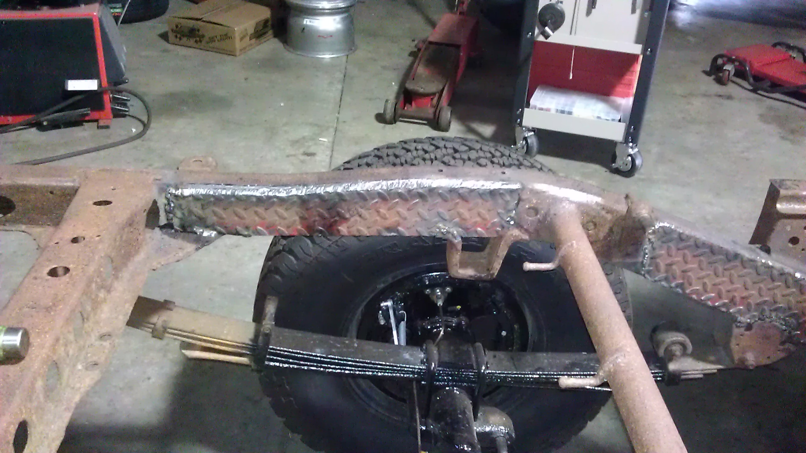

Interior is near mint, frame needs some welding. Truck will get about everything new, already have most parts.

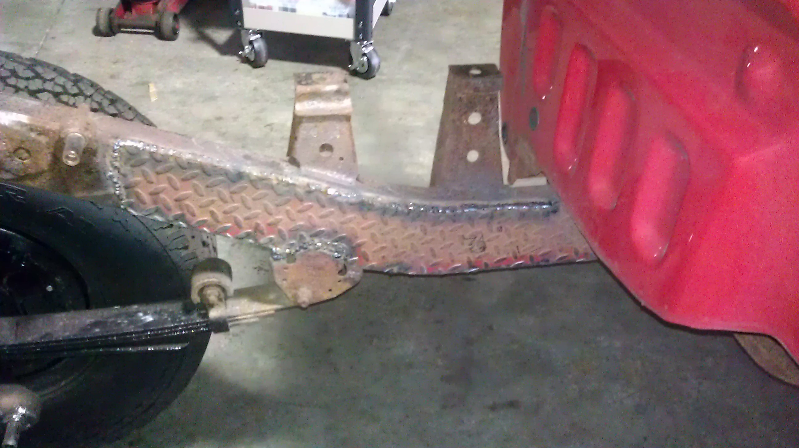

Here is what I have patched so far. The frame was not that bad, I probably went over board with the plating bit i wanted it strong. I still need to replace the bed mounts and the cross member.

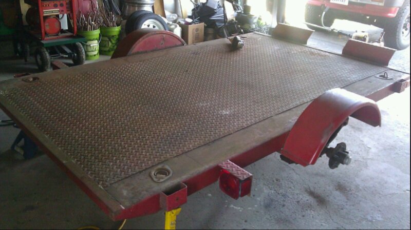

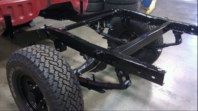

Here is the new bed mounts and the replacement cross member.
I am going to flatbed it.
I bought an old steel trailer 5x8 should work out well. And thats where I got my patch material from!

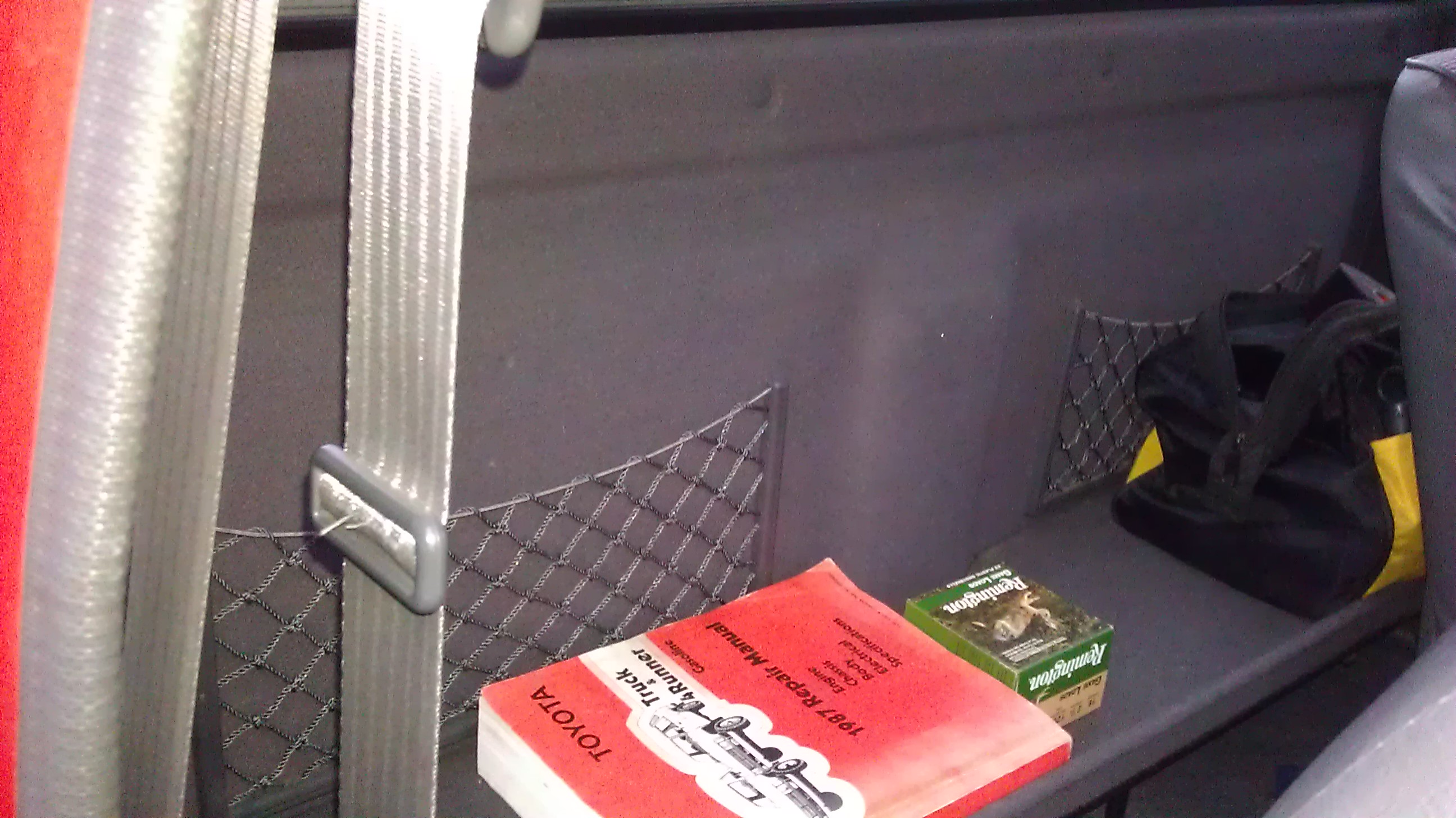

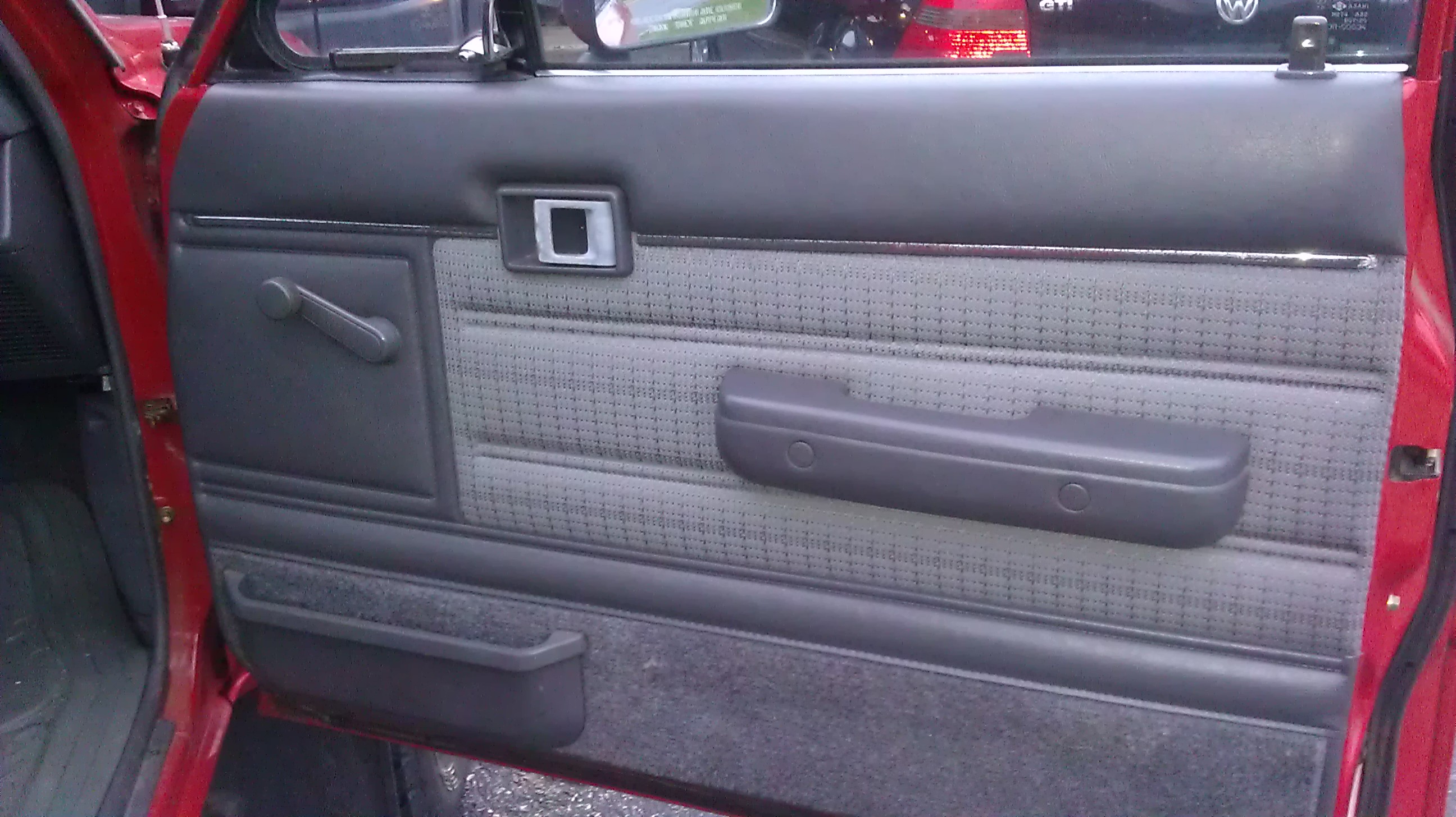

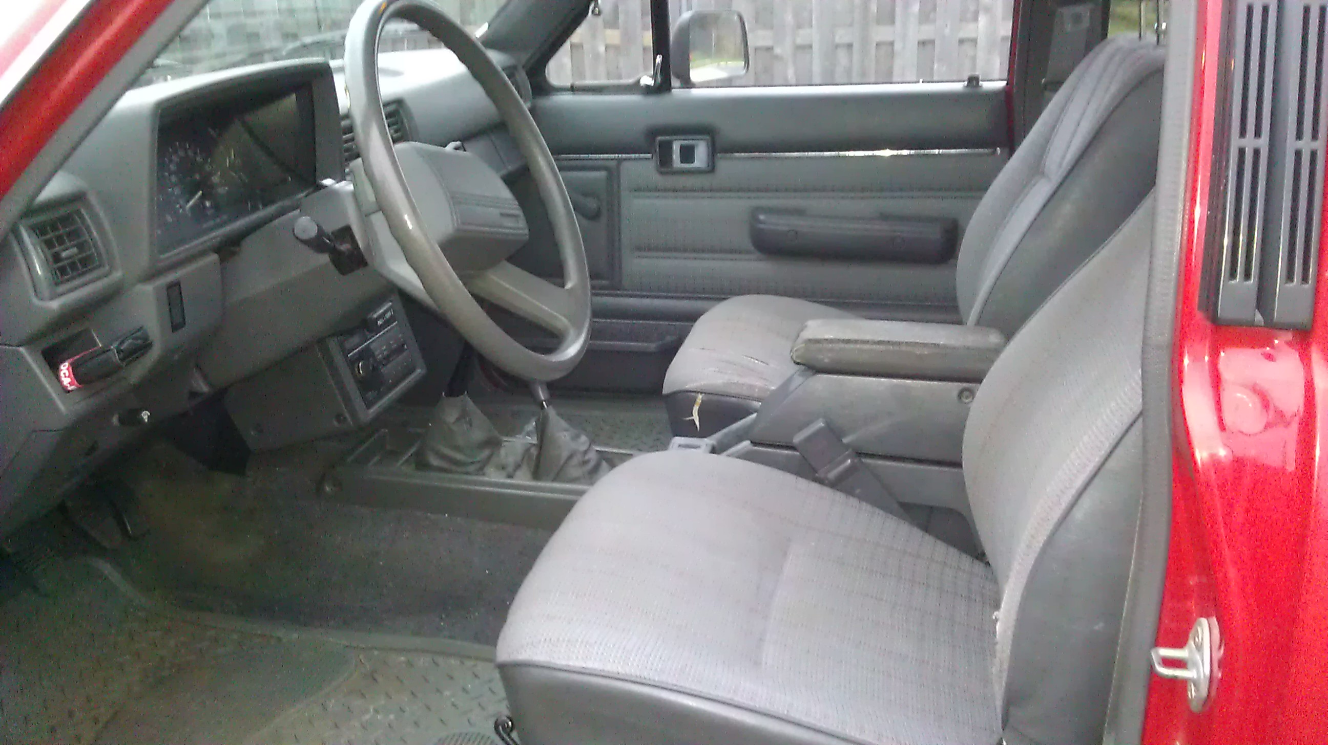

Some interior pics, excellent condition. I have already pulled the dash and added the evaporator box and wiring I pulled from another parts truck. so this summer will be much cooler!

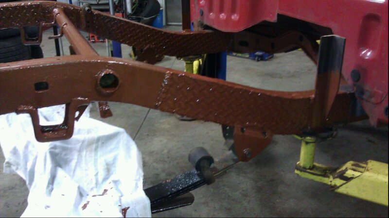

primer and paint.

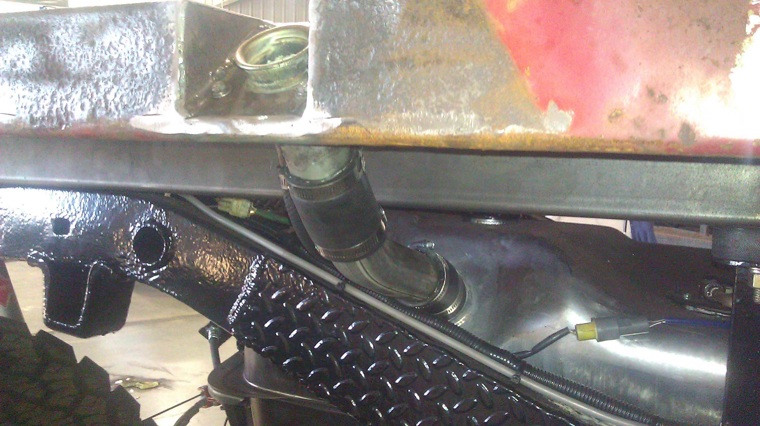

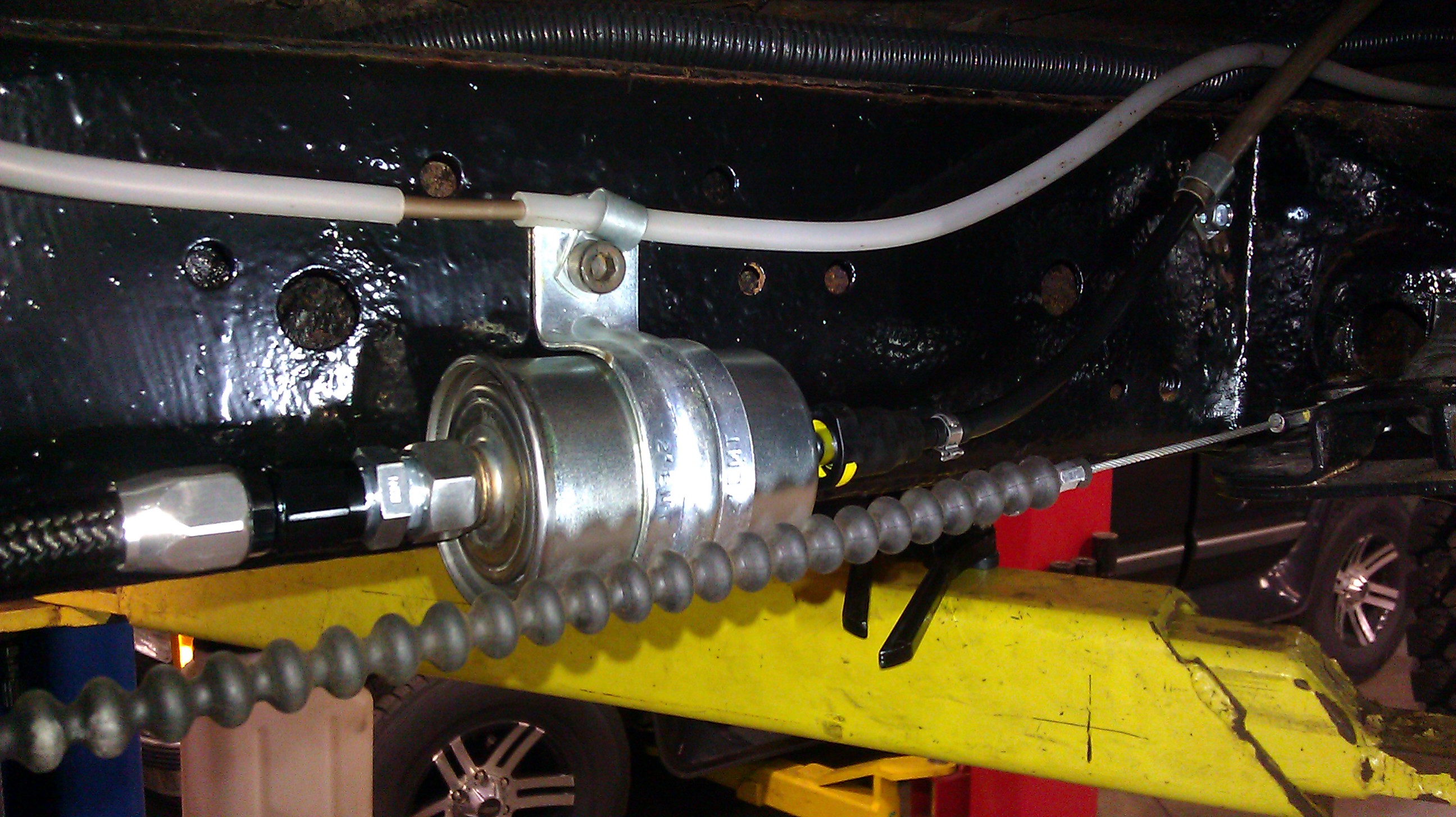

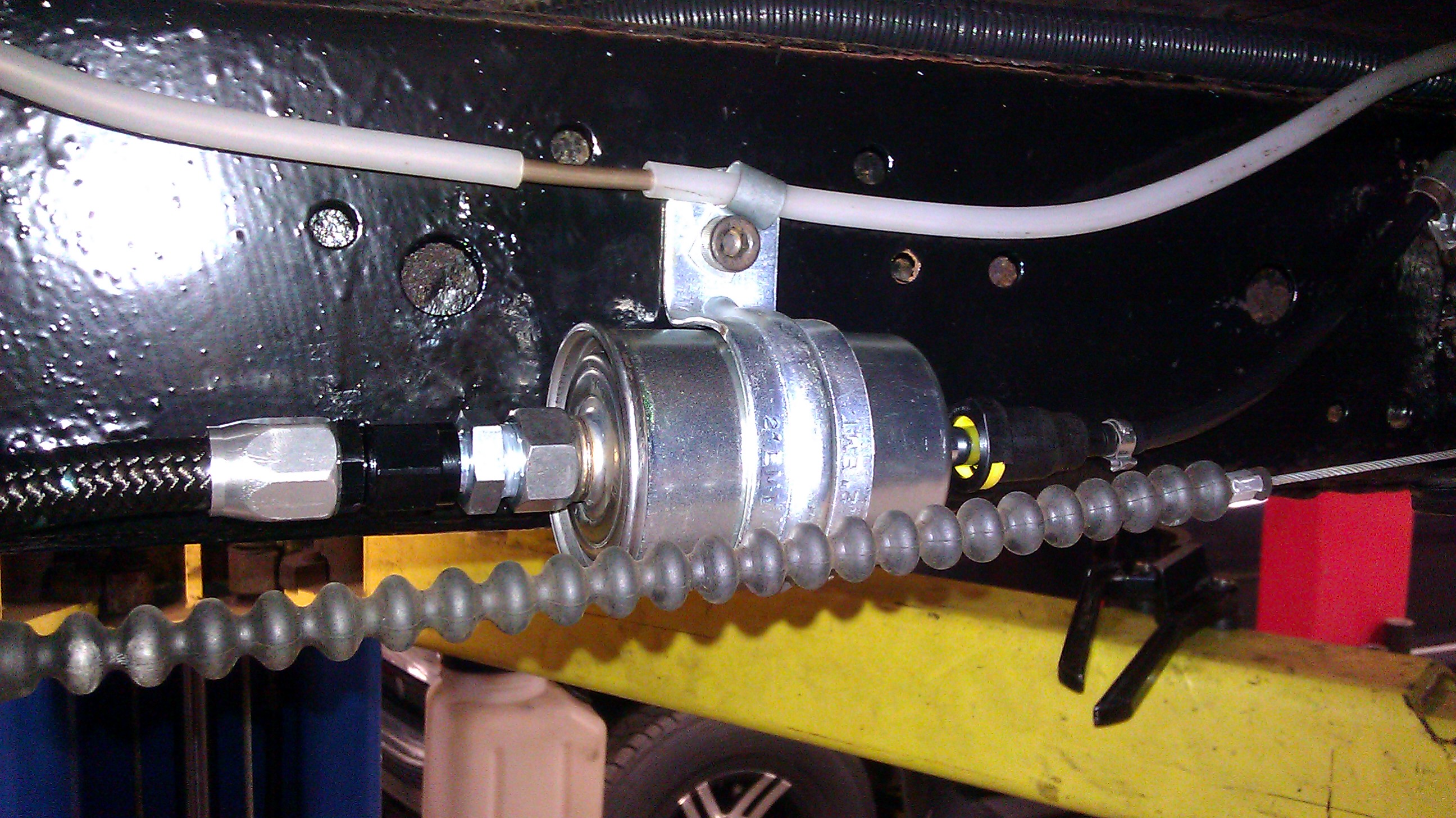

Here is the new tank mounted. I also replaced the OE Toyota filter with a GM quick disconnect. I couldn't get the plastic line to stay where I wanted it so I made a sleeve out of an alloy tube to keep it the shape I needed. The line to the fuel rail is a Russell with an adapter from An to 14mm at the fuel rail. So in the future it should be cheaper and easier to change.
and a pic of the completed motor

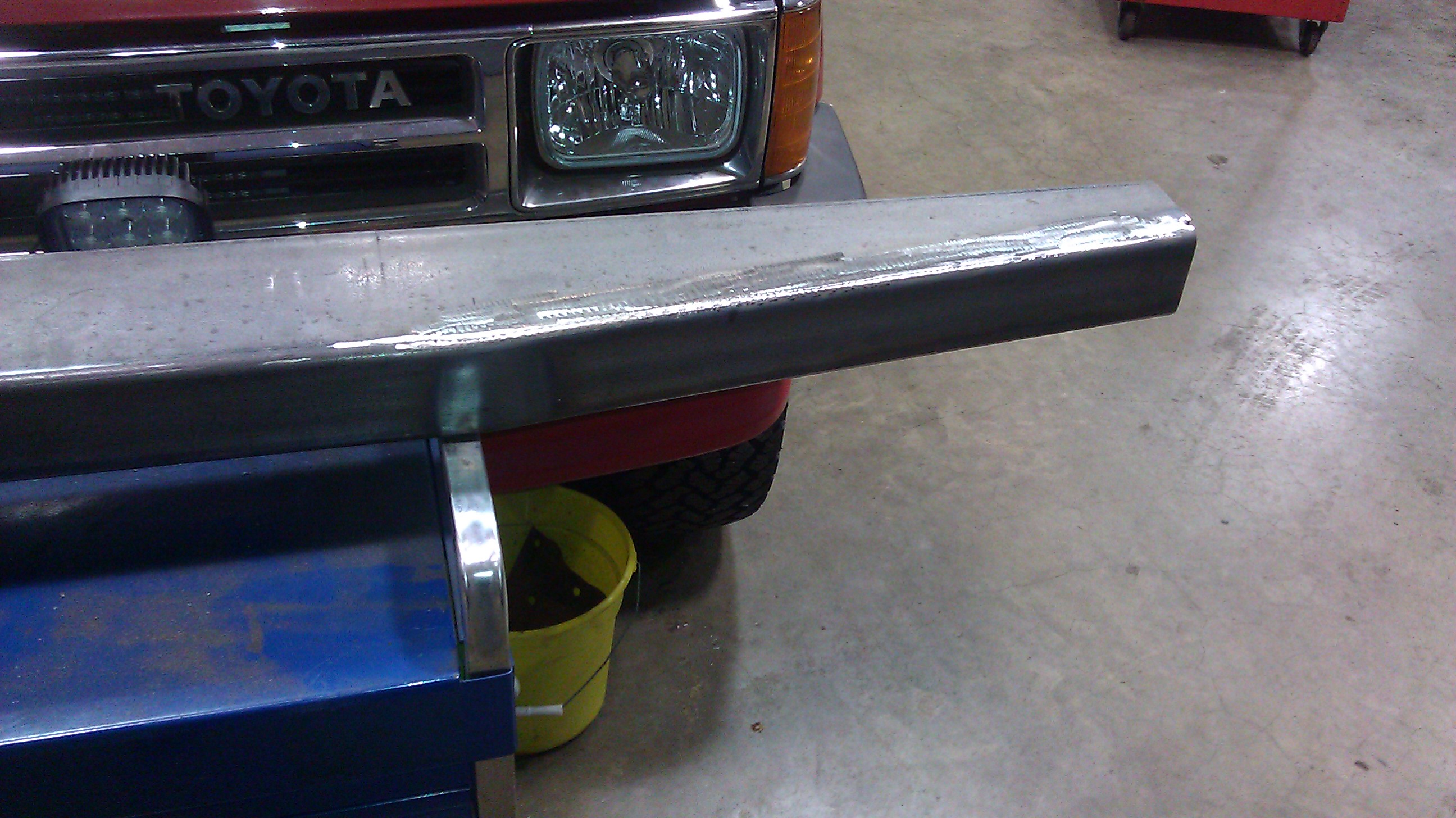

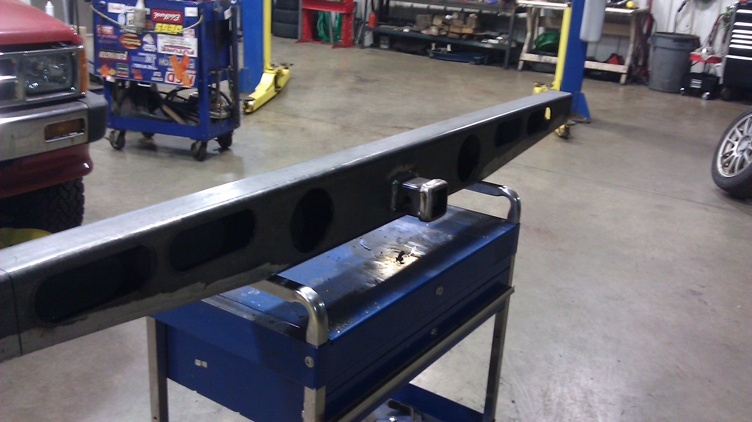

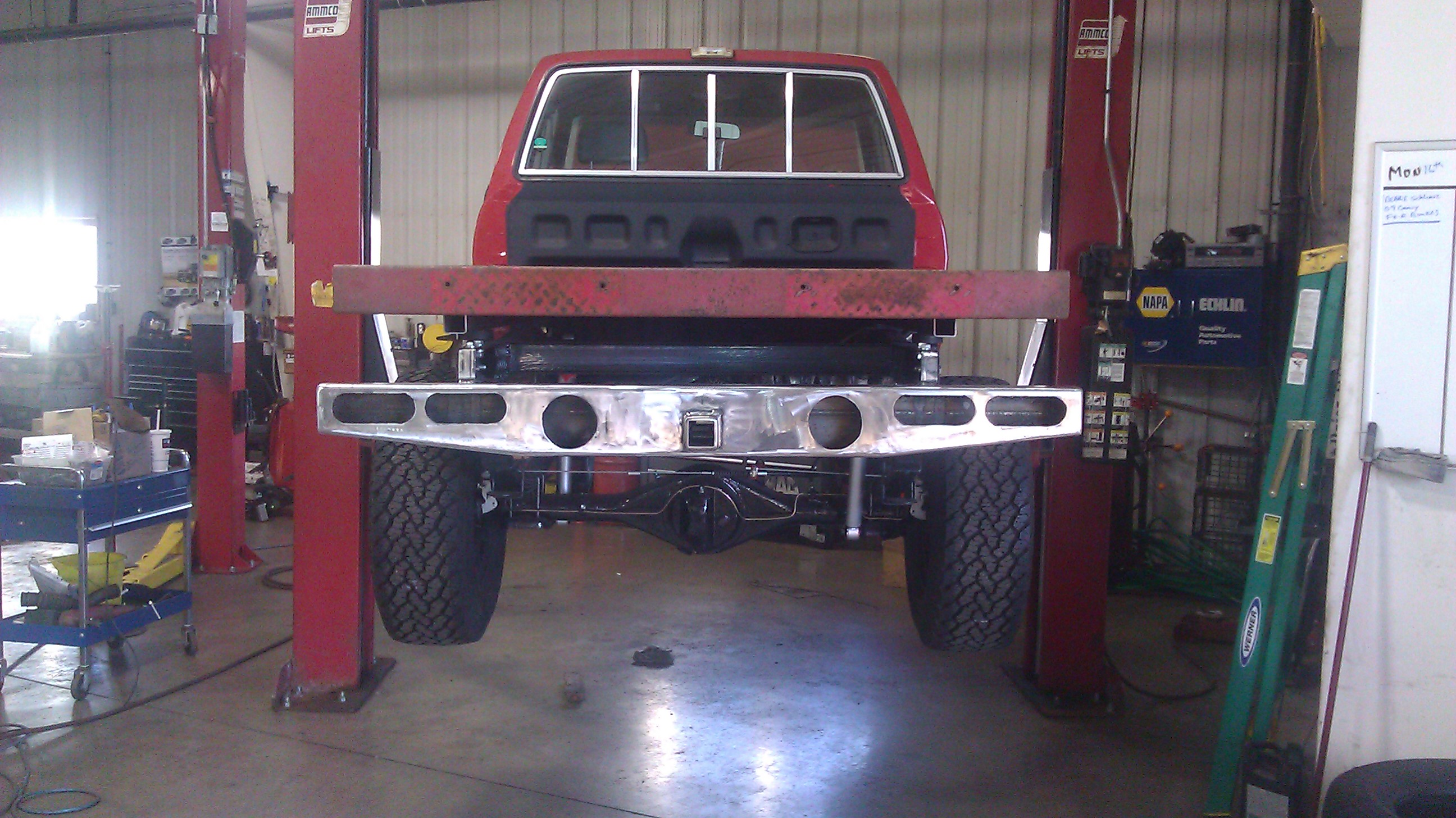

Motor Is in. And the bumper I have been working on from a piece of 3x6 tubing

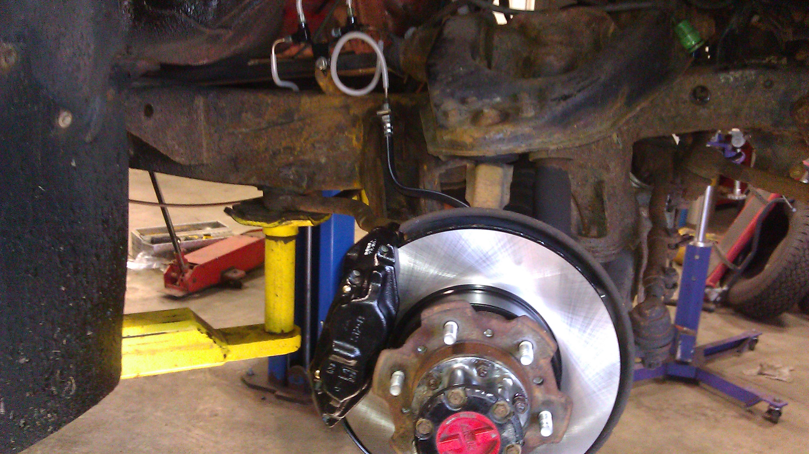

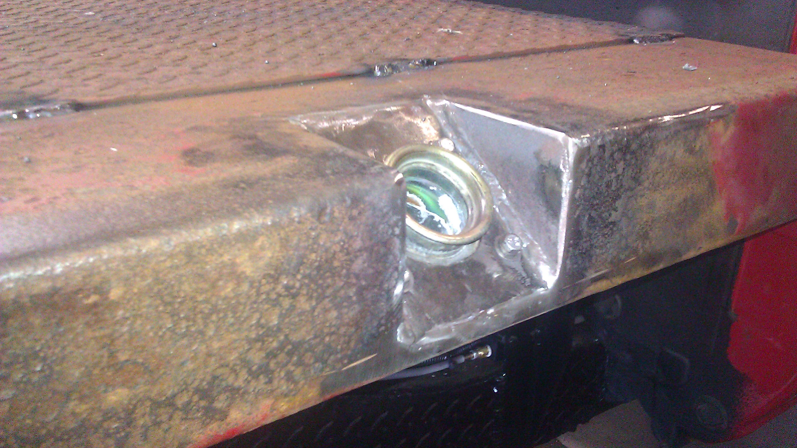

Flatbed mounted and fuel tank hooked up. I wanted to recess the fill. No real reason just thought it would be cool. Also got the front brakes done

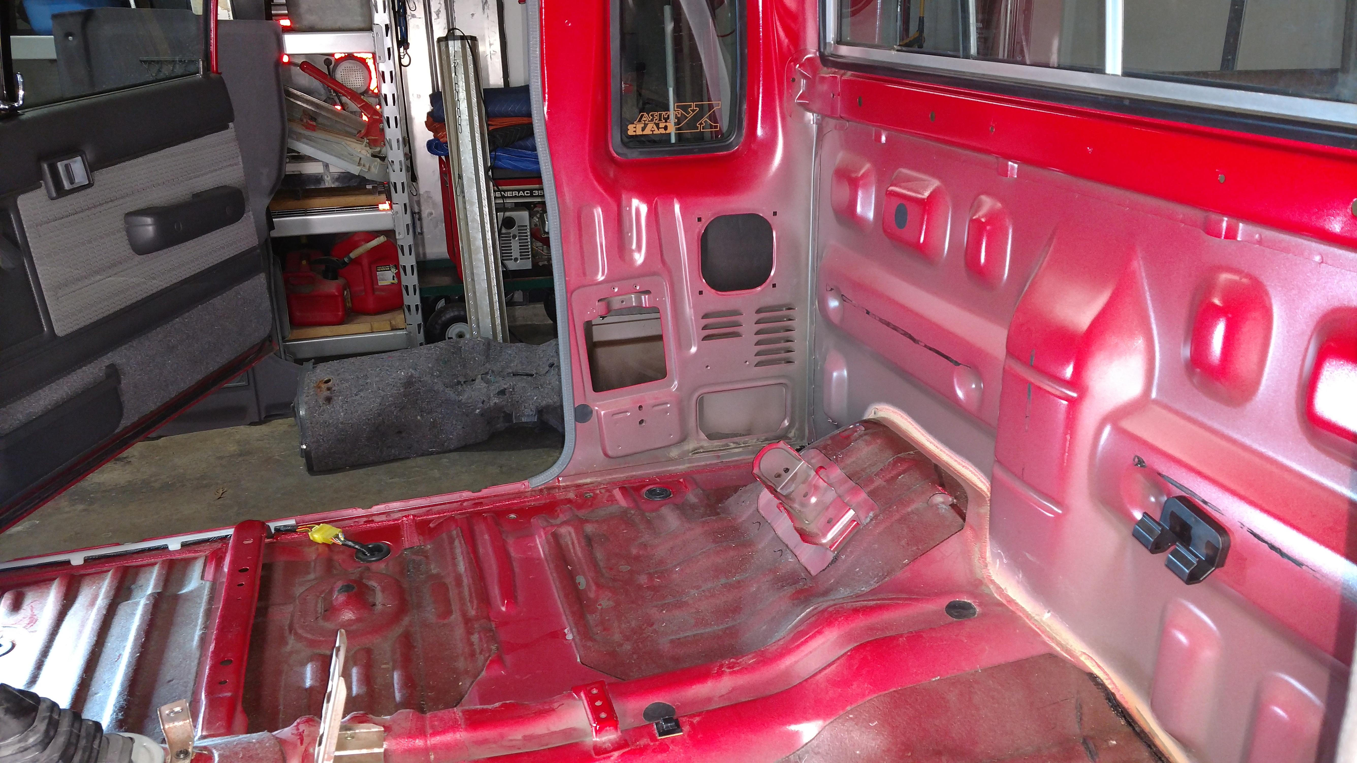

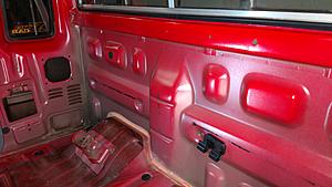

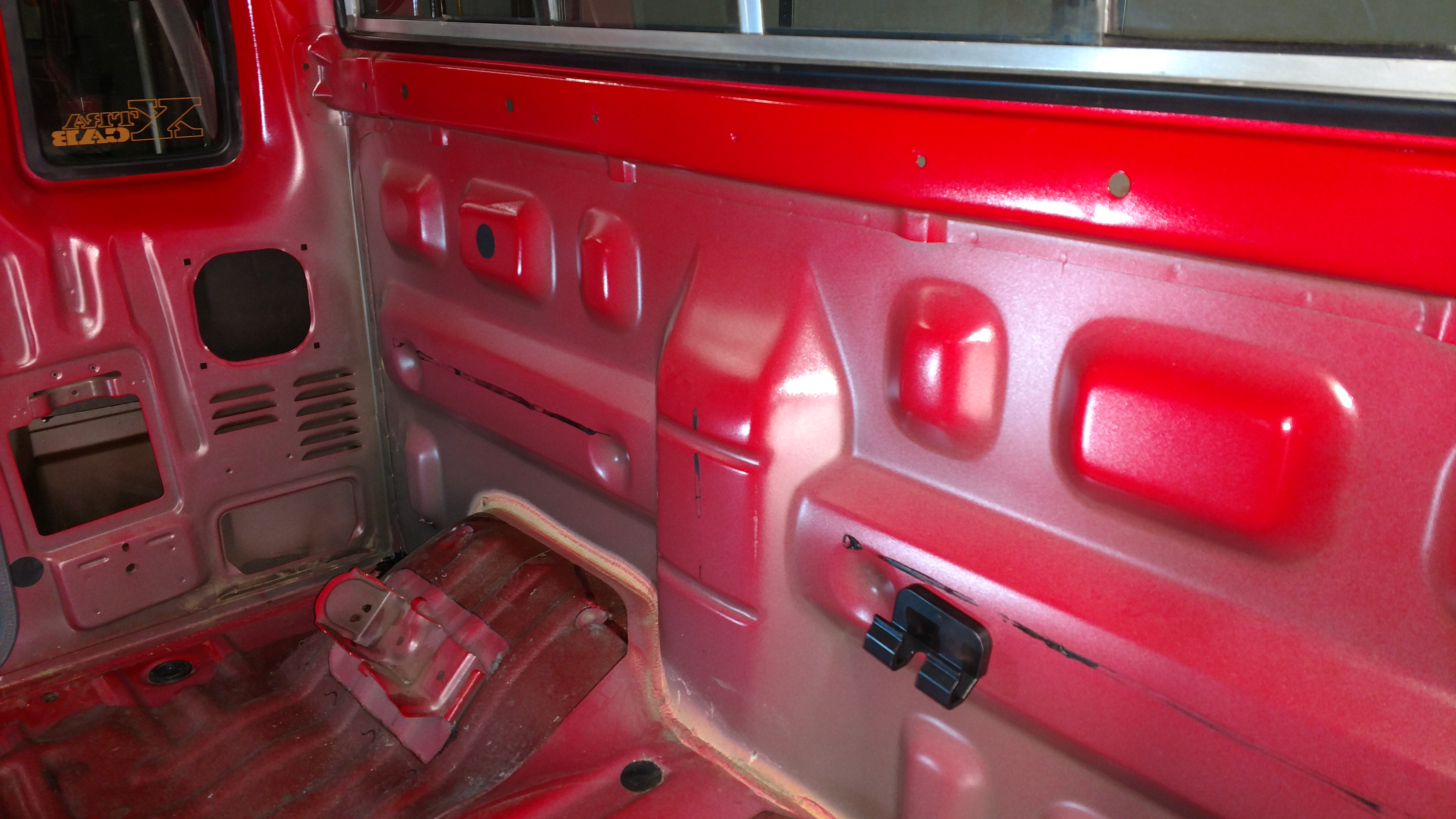

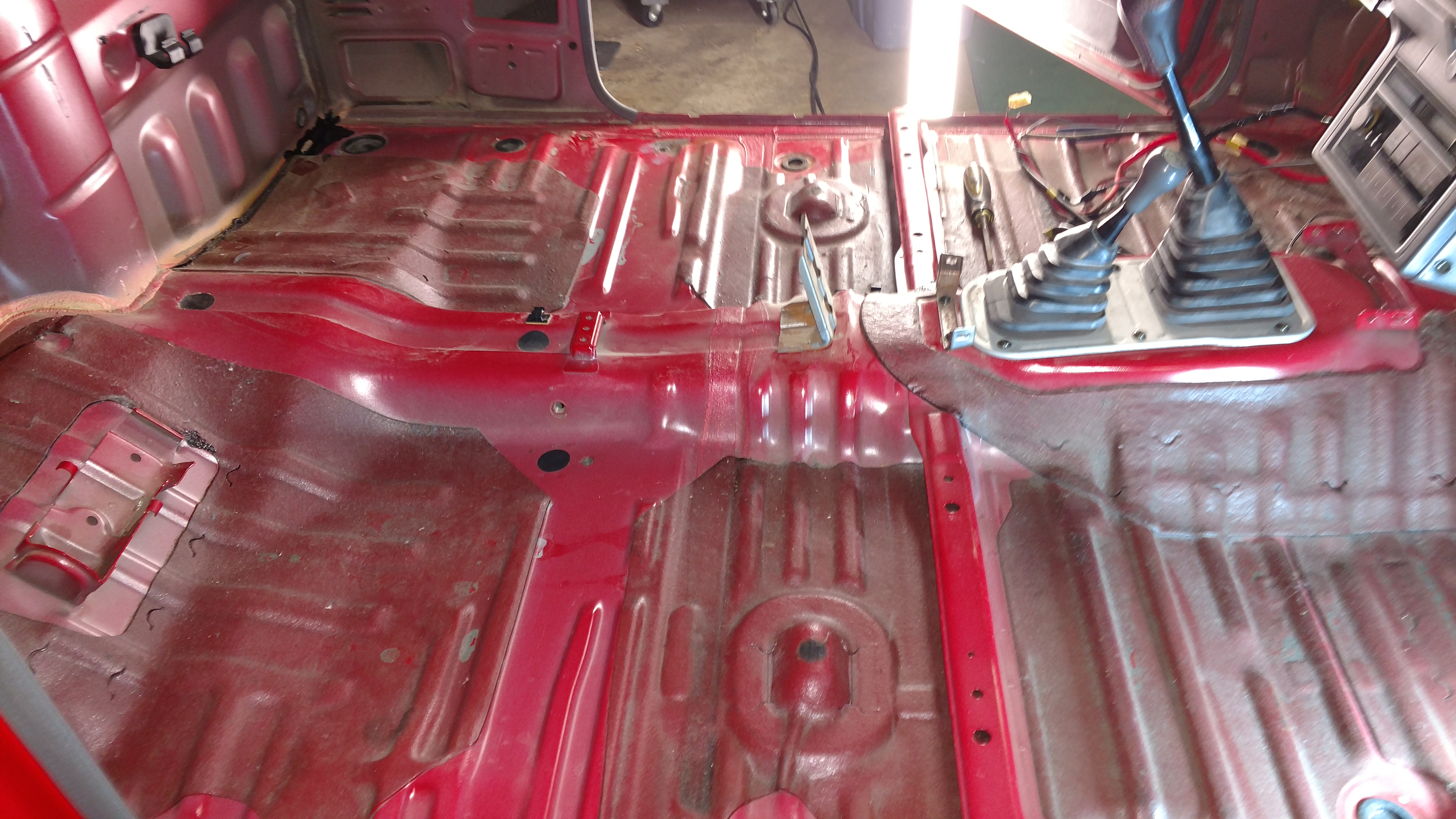

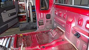

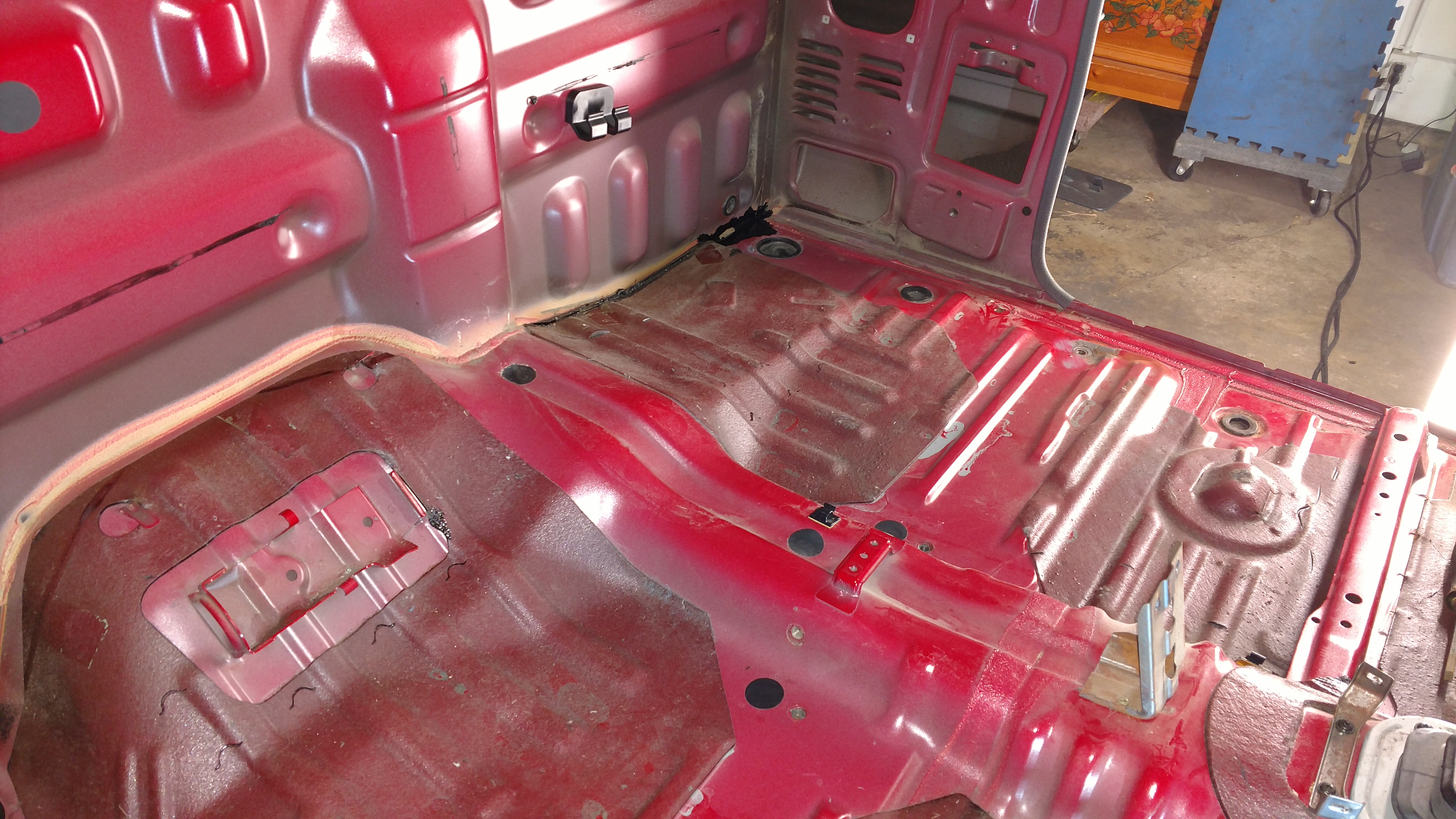

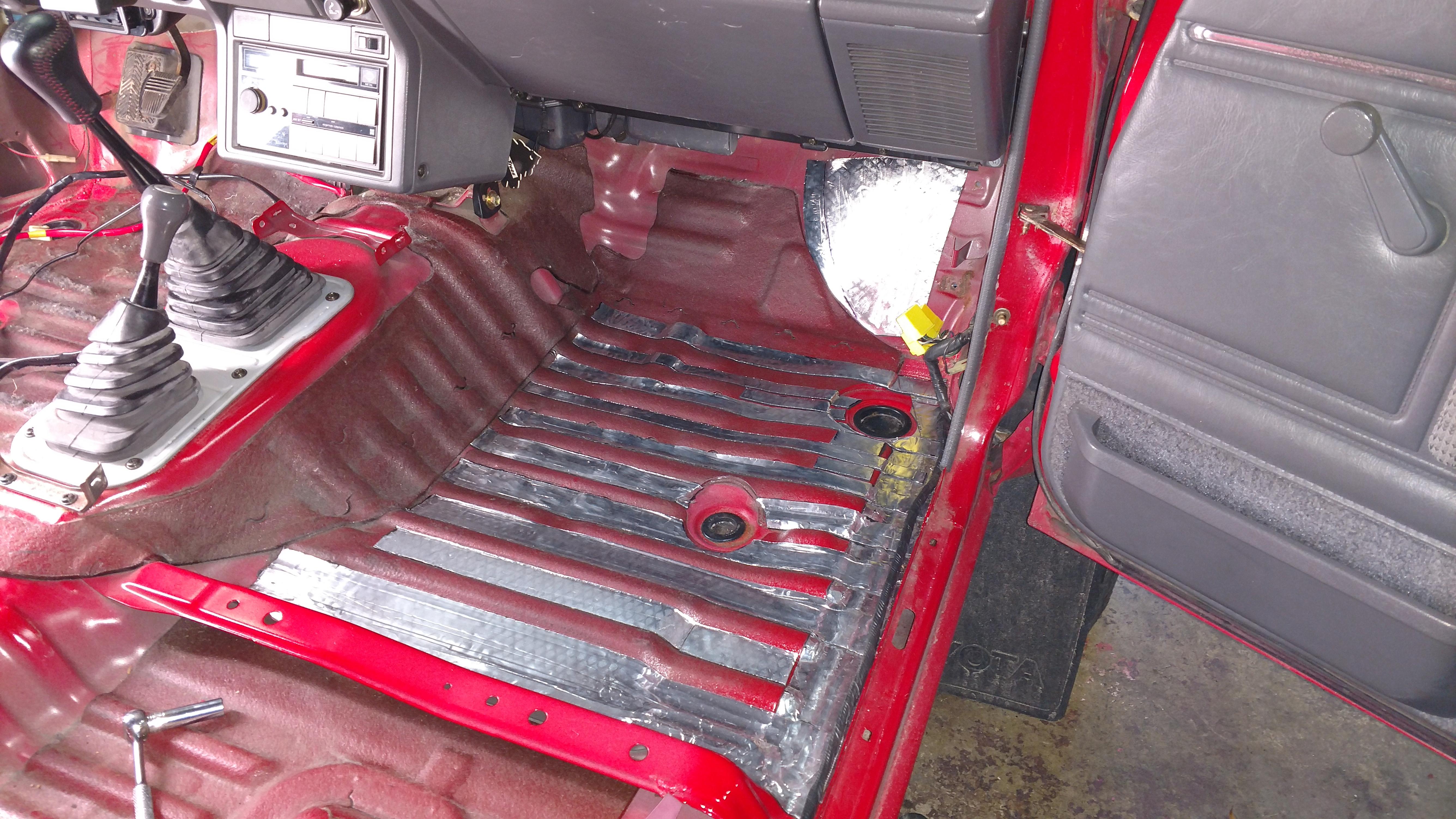

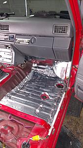

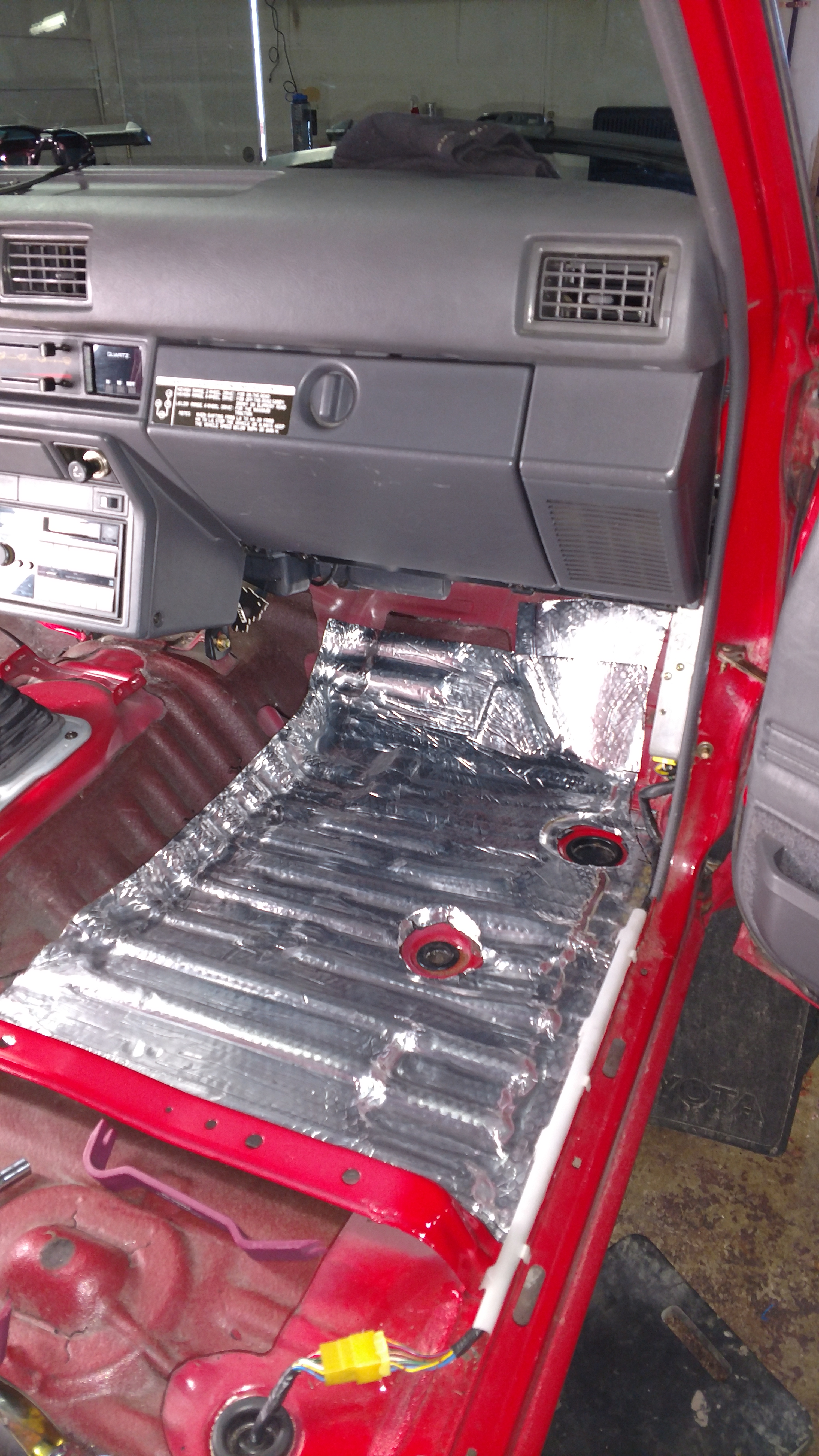

I was able to find some pics of when I pulled the interior and sound proofed the cab. I think I did this back in April
Attached Thumbnails ozzir70's 87 pu build-img_20170318_112743586.jpg   ozzir70's 87 pu build-img_20170318_112749554.jpg   ozzir70's 87 pu build-img_20170318_112806831.jpg   ozzir70's 87 pu build-img_20170318_112815444.jpg
Old Aug 15, 2017 | 03:35 PM
ozzir70's Avatar
Joined: Jun 2014
Posts: 122
From: Lake In The Hills, IL

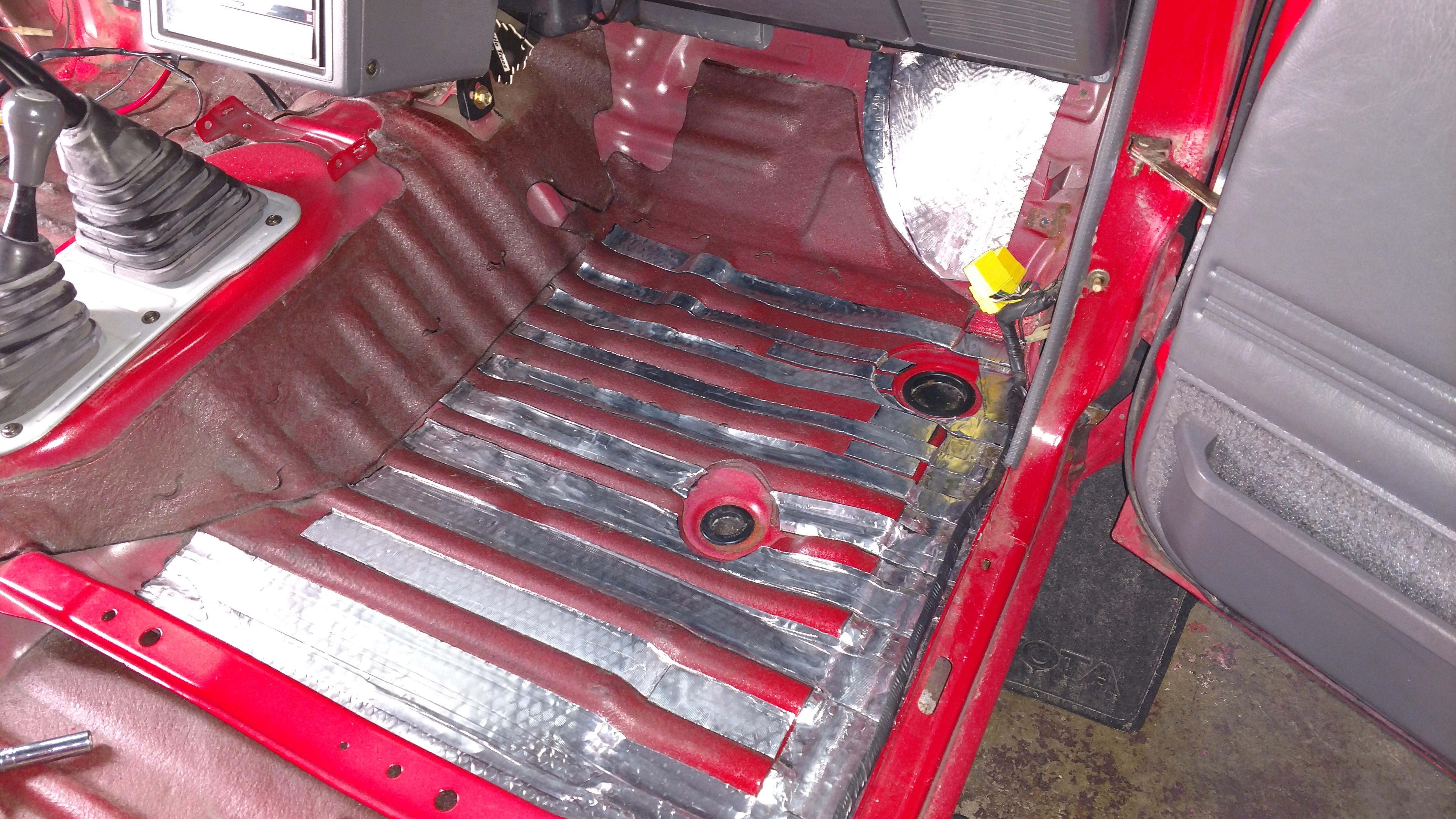

I cut the material into strips to fill in between the ridges in the floor. Then put a second layer over it. It took a long time to get the foil smoothed over
Attached Thumbnails ozzir70's 87 pu build-img_20170318_150043868.jpg   ozzir70's 87 pu build-img_20170318_150052879.jpg   ozzir70's 87 pu build-img_20170318_153712836.jpg
