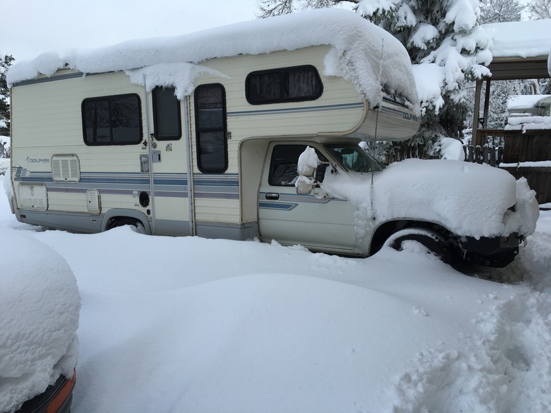

Yes I could go out and tear it apart and count myself. as I said I would like to have the part before I do that. Though if it was something someone here knew off the top of their head, it would be helpful. thats what these boards are for right? helpful?

So they are all the same across the years ??
I have a steering column floating around from a mid eighties truck I would be glad to look if your sure it will be the same.
I had quite a run of wrong measurements over the years from customers

Thanks!! I have no idea either if they are the same. hum. looks like I will just have to dig it out and pull the shaft. guess it can just sit in the drive for a while.
