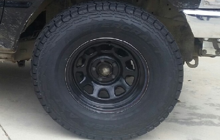

You can just use a grinder with a thin cutting wheel and grind/cut it off slowly. We only had to cut the front and the back side of the fender, not the top. I dont have anymore problems with rubbing.
My trucks a 2wd with 31s and a 3" body lift
Attached Thumbnails 90 truck fender cut and fender flare question.-fendercut.png
