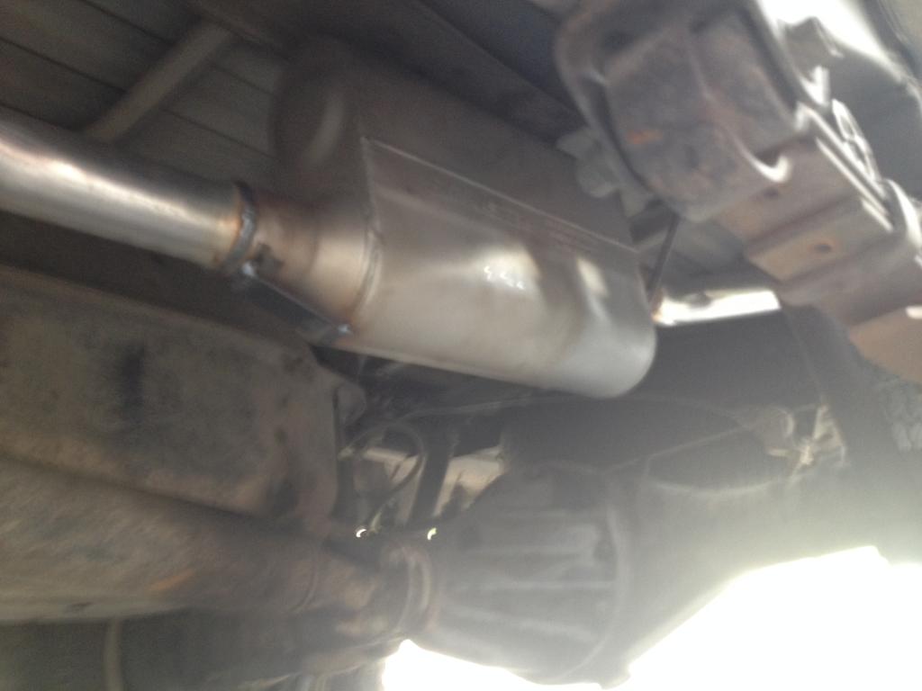

New Flowmaster, still need to find a nice tip.

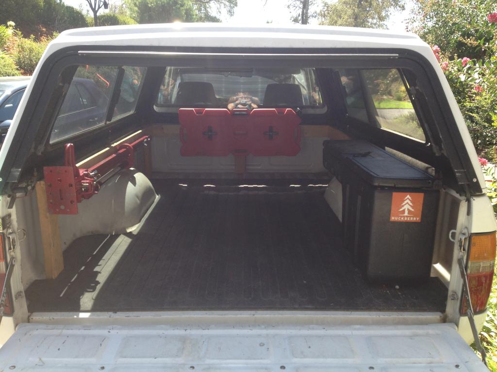

Made a storage rack for my bed.

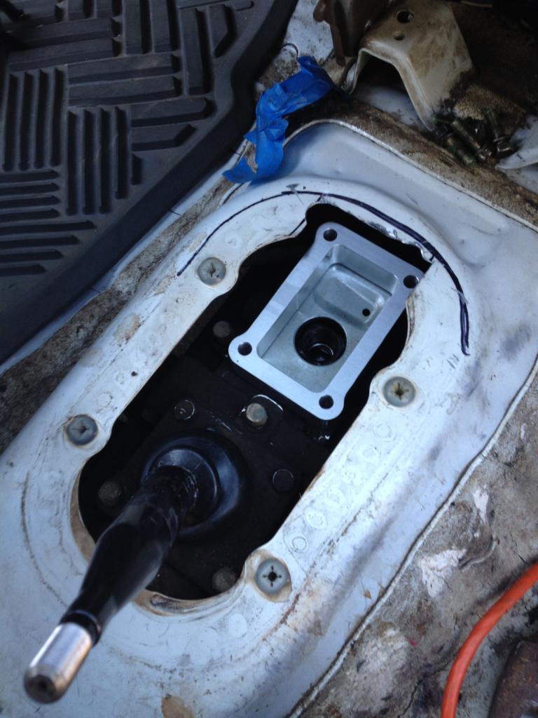

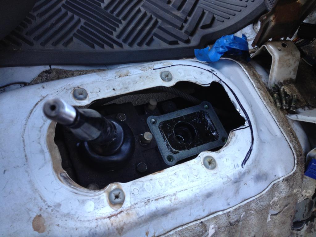

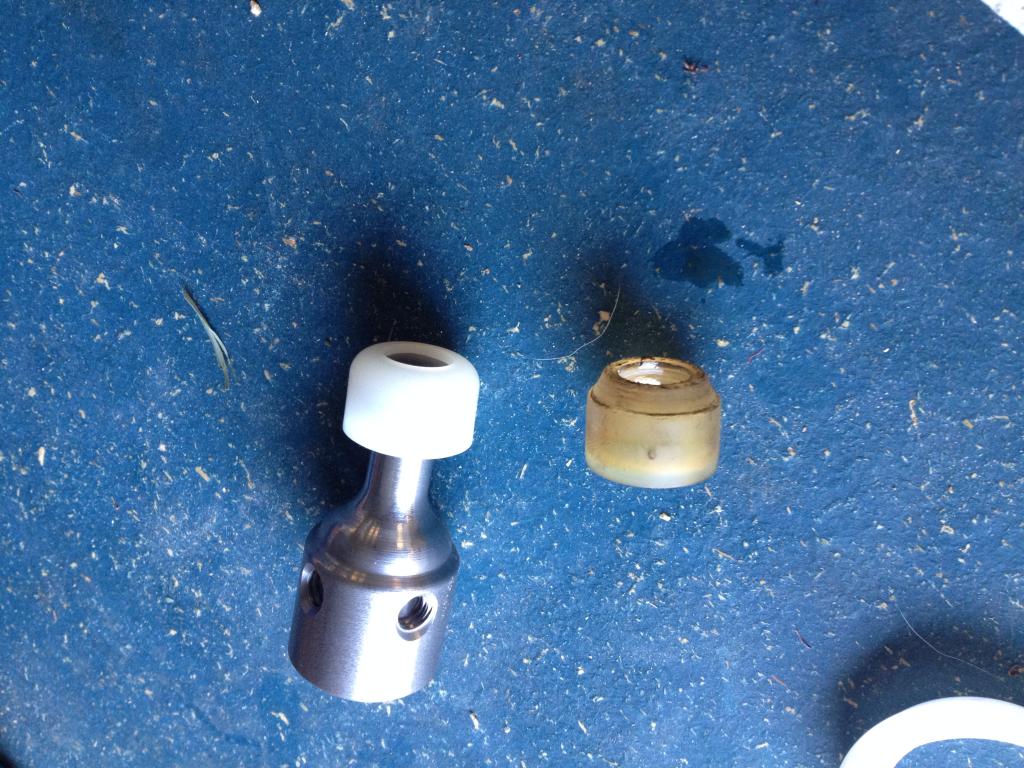

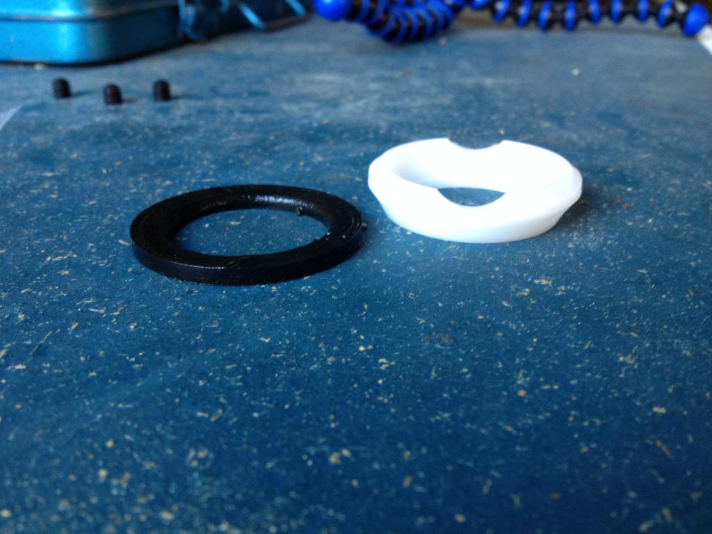

In other news, decided to troubleshoot my tranny tonight. Felt like it was starting to slip in some gears. Took the shifter out and my shifter seat was pretty much gone . Decided to make use of the problem and ordered a LC Engineering short shifter kit. Can't wait for it to come in! Headed to Toyota tomorrow to pick up some new gaskets, thermostat (for the radiator swap), and some other random bits.

Holt crap! Just finished installing the short shifter. I freaking love it, it drives like a brand new truck!
Before I had trouble going into first, a lot of trouble going into reverse, and noticeable slop in the gears. Now...very easy to get into first/reverse, and zero play in the gears. What a difference, I would have gladly paid three times as much to get these results.

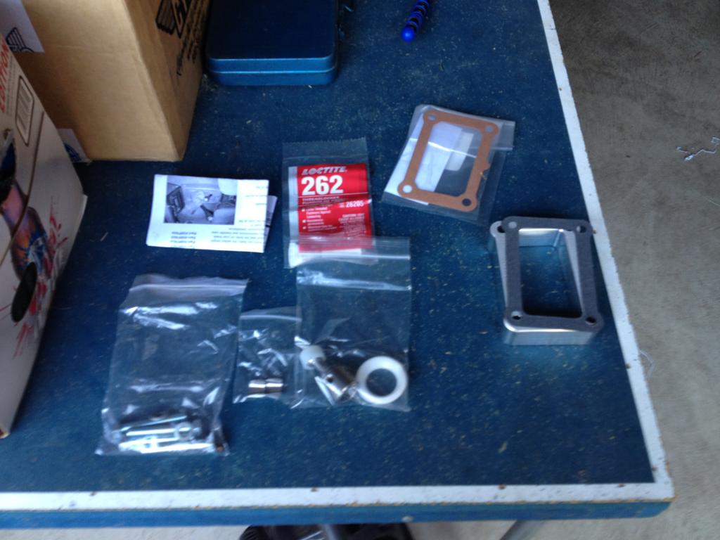

Here is everything included (plus a replacement gasket from Toyota)
From LCE: Shifter extension, spacer, longer bolts and washers, gasket, new seat and socket, red loctite, half moon keepers, extension pins... I believe that is it.

Comparison of new/old parts:

I want to go back and clean up my cuts in the cab floor (just got a dremel, it'll make it a lot easier), but I was in a time crunch and had to leave it like it is till the weekend.

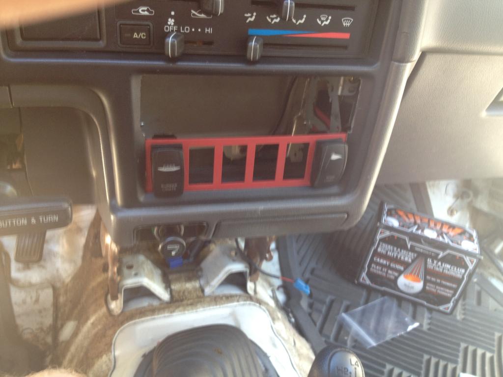

Installed a switch plate in place of the the single din storage. Oh and ripped out my old stereo. It finally bit the dust so I'm in the market for a new one.
Plan to wire lights only to this panel.
Bumper, roof, left/right sides, reverse, whip.
Should probably mention I swapped my lower radio bezel out for a new one. I will be relocating my cb once I get my bucket seats installed and decided to clean it up.
