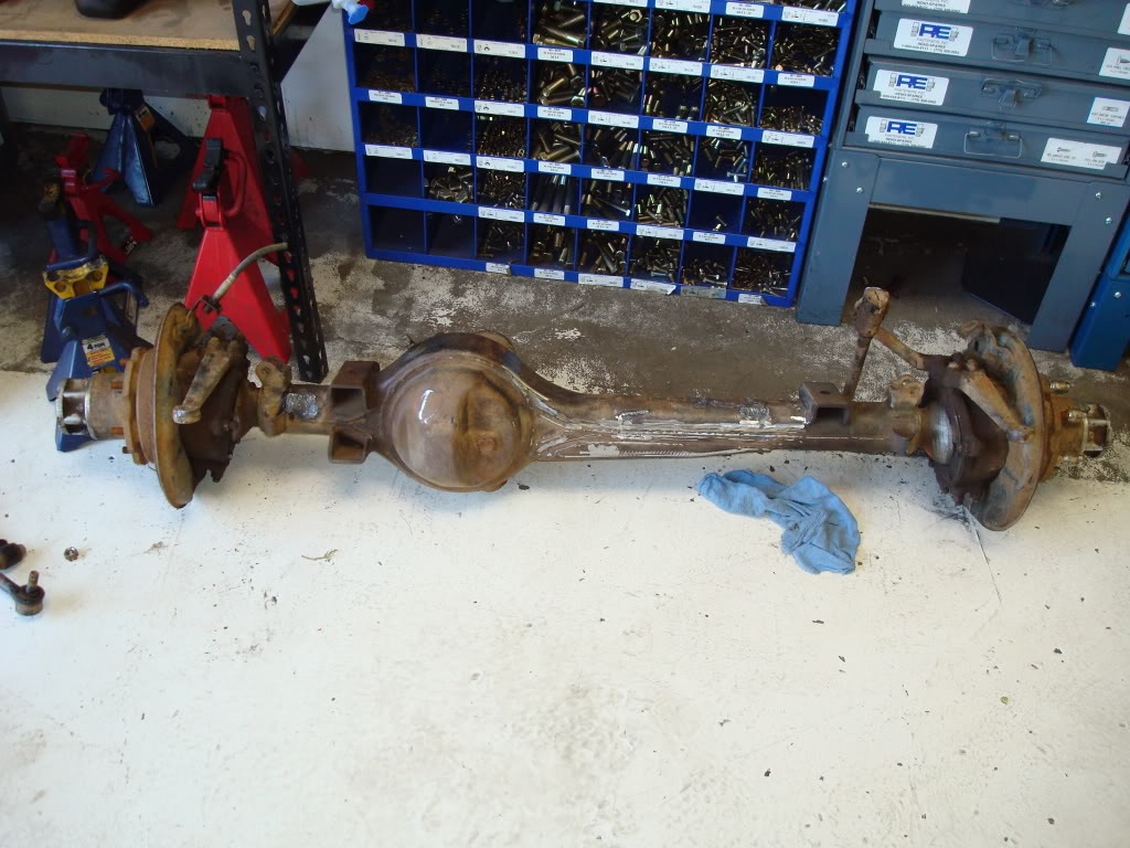

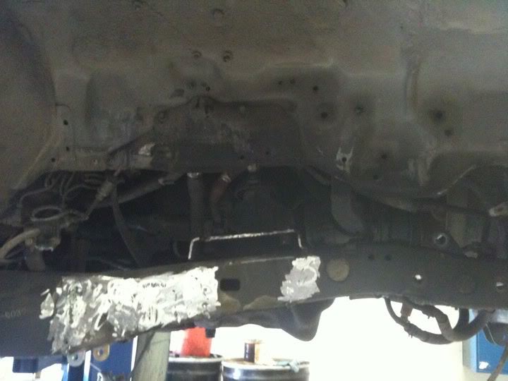

Started of as a bone stock 1991 toy 3.0 auto with 165k miles a blown head gasket and 2 leaking valve cover gaskets.
Went out and picked up a few things for it... 82ish toy front with 3 something gears
trail gear sas kit
the teardown begins

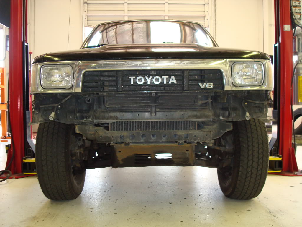

Front mostly done....

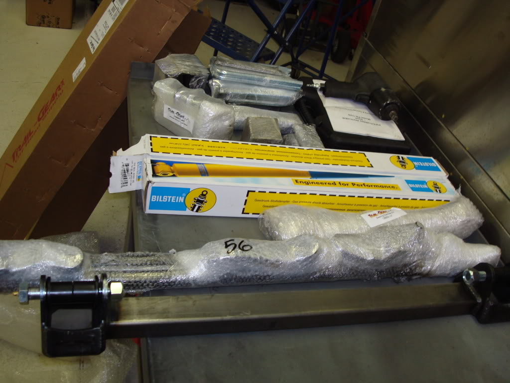

In the rear I also used trail gear springs and bilstein shocks. No pics of rear progress...

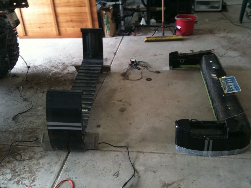

Small update...

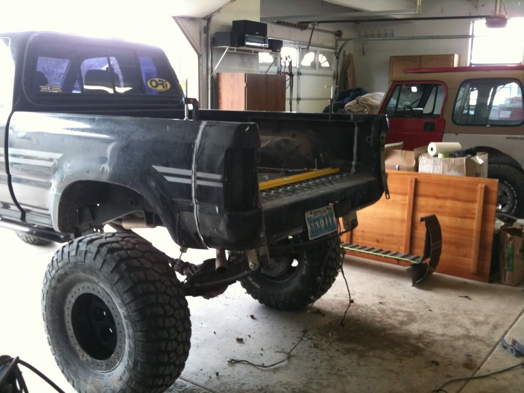

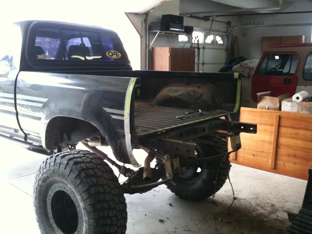

Also bobbed it 10"

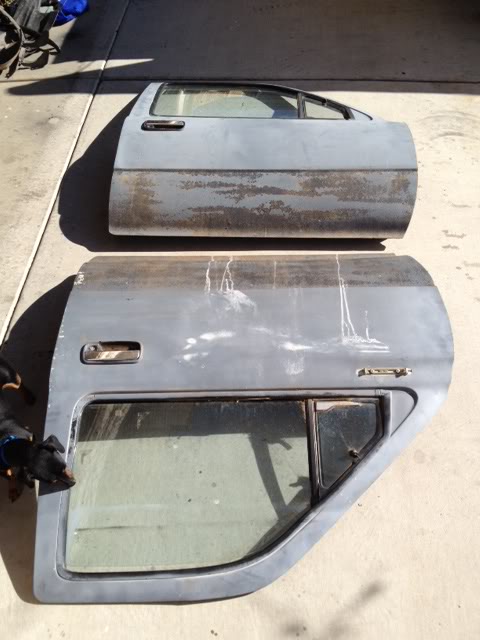

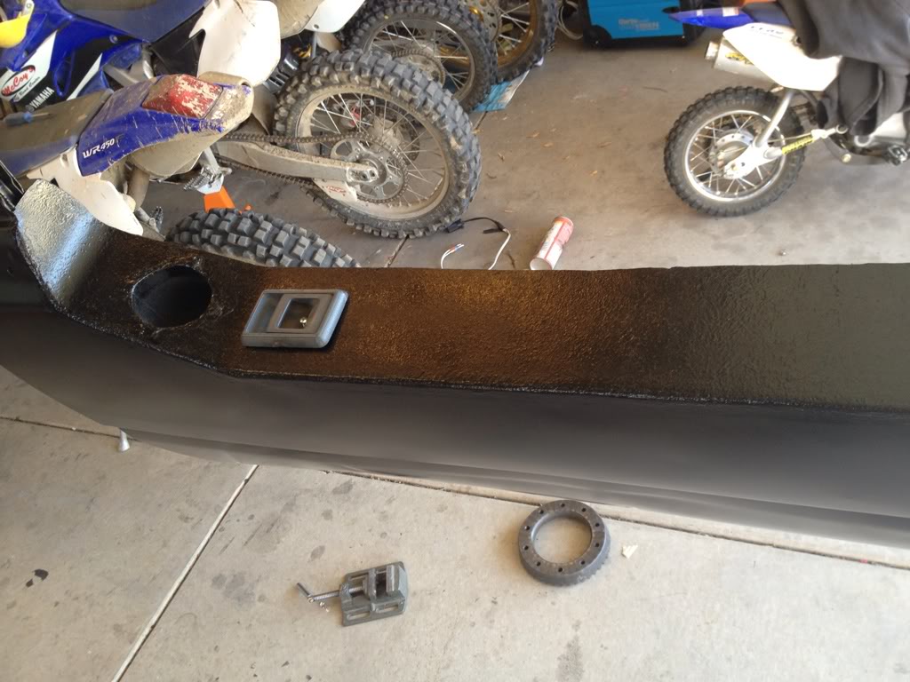

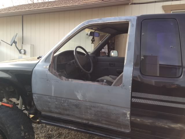

picked up some spare doors...
quick scribble...
....and bam!
still need some sheet metal to finish them..

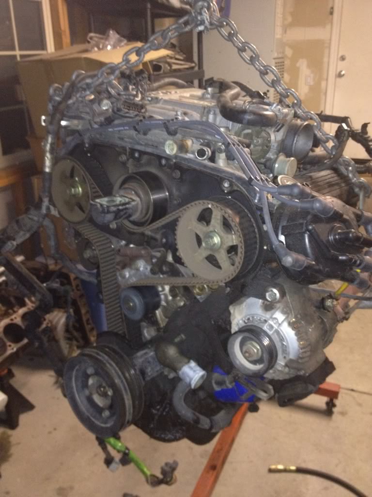

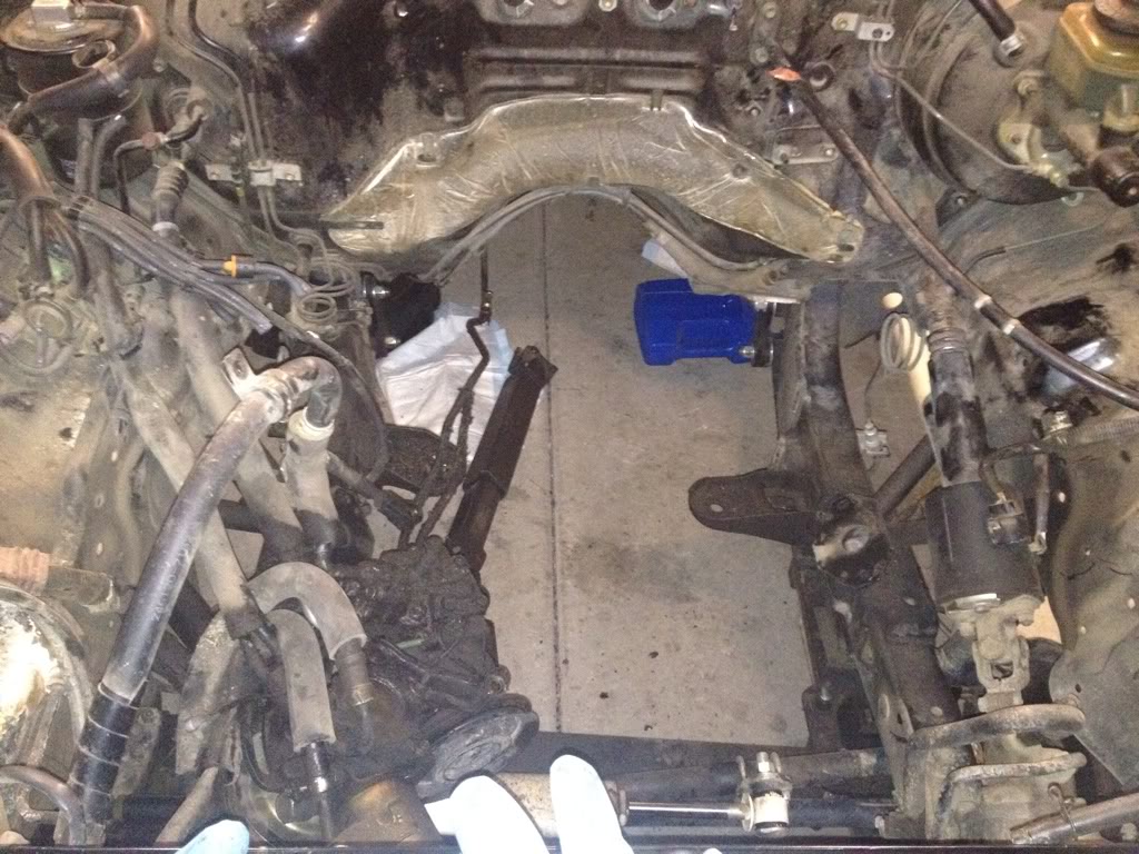

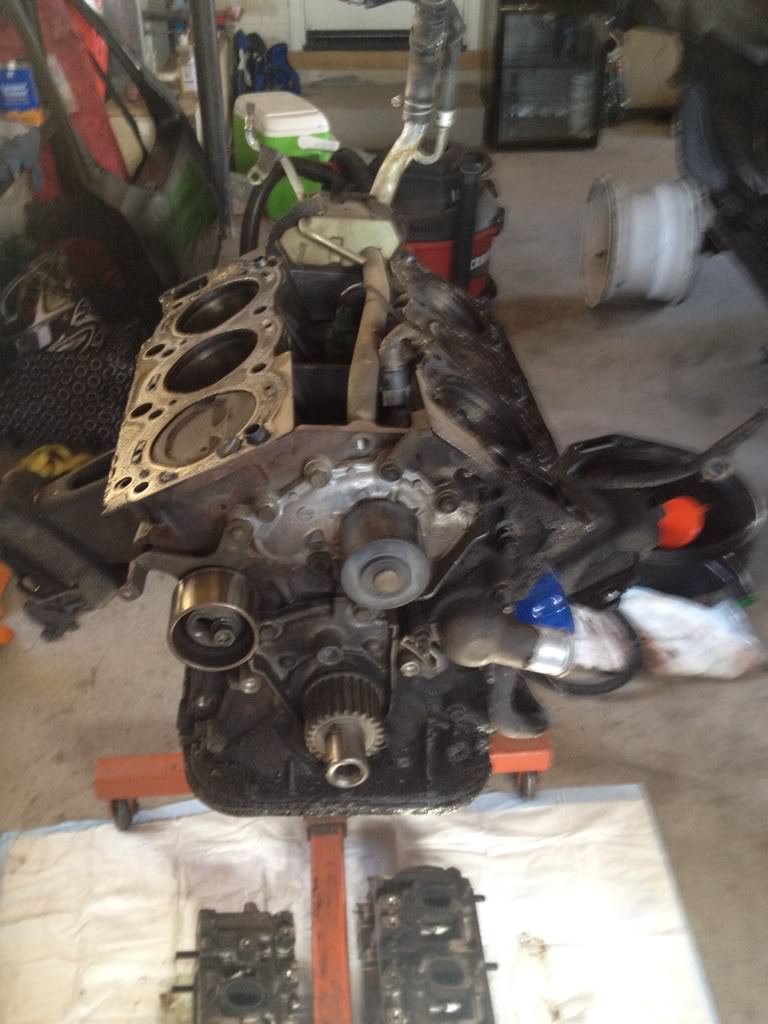

Oh yeah, truck blew a head gasket on the way to bronco last weekend so I'm just going to pull the motor and trans together and setup the box 4 rocks while its all apart..
Got the engine pulled and tore down. Heads went to the machine shop today.

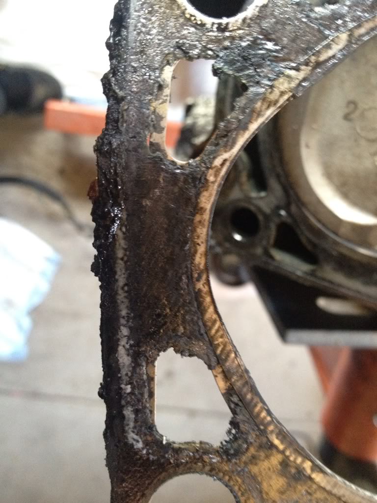

Smoked head gasket..

Completed door

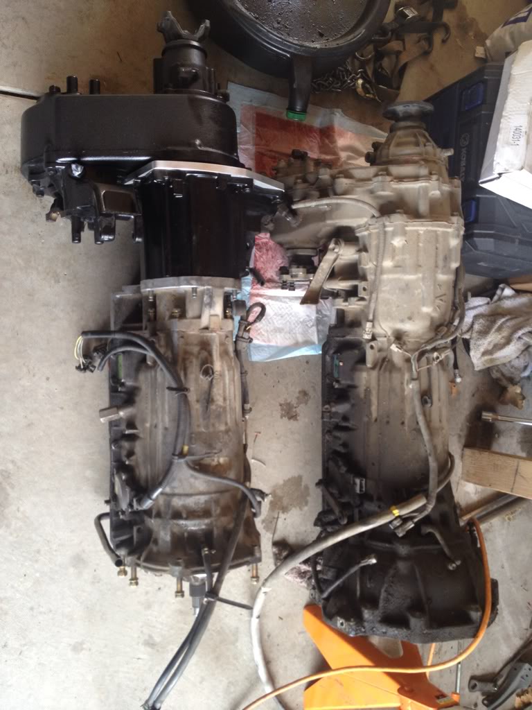

And almost complete engine
A340h toy trans/tcase next to the jeep aw4/box 4 rocks/ d 300
