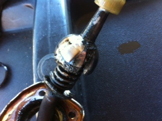

Posts: 52
Shifter bushing
Here are some pics. What do you guys think. Clutch master looks new and so does the slave. Gonna order one from Marlin Crawler regardless.

Old Oct 30, 2014 | 07:09 AM
  #45
rumdumb's Avatar
Joined: Dec 2013
Posts: 52
Couple more...it's only letting me do one pic per post

Update...
Well I installed the MC shifter bushing and it didnt fix the problem. So I decided to adjust my clutch pedal and it seem to let me shift gears except onocasion. Meaning it seems like I have to force it in or i push pass a notch and then it goes in? Does that make any sense? Let me do a little back story that might help. A few months ago my clutch cancel switch stopped working. I didn't pay much attention as I thought it was the little rubber peice fell out and I was fine using my clutch cancel switch on my dash. I checked for that grommet yesterday and it was still there. I pressed the clutch down and it would not hit the switch? I have heard of broken brackets but I didnt see anything or movement. Then the hard to get in gear started. Now all the gears where difficult to get into except reverse wich would just grind. Things I have checked:
1. Fuild leak - None
2. Still need to check fluid in tranny.
3. Adjusted pedal and clutch cancel button under dash.
What could be the issue?
Synchroes?
Worn out forks?
It does not pop out of gear or grind except when I was trying to put it in reverse (before adjusted).
