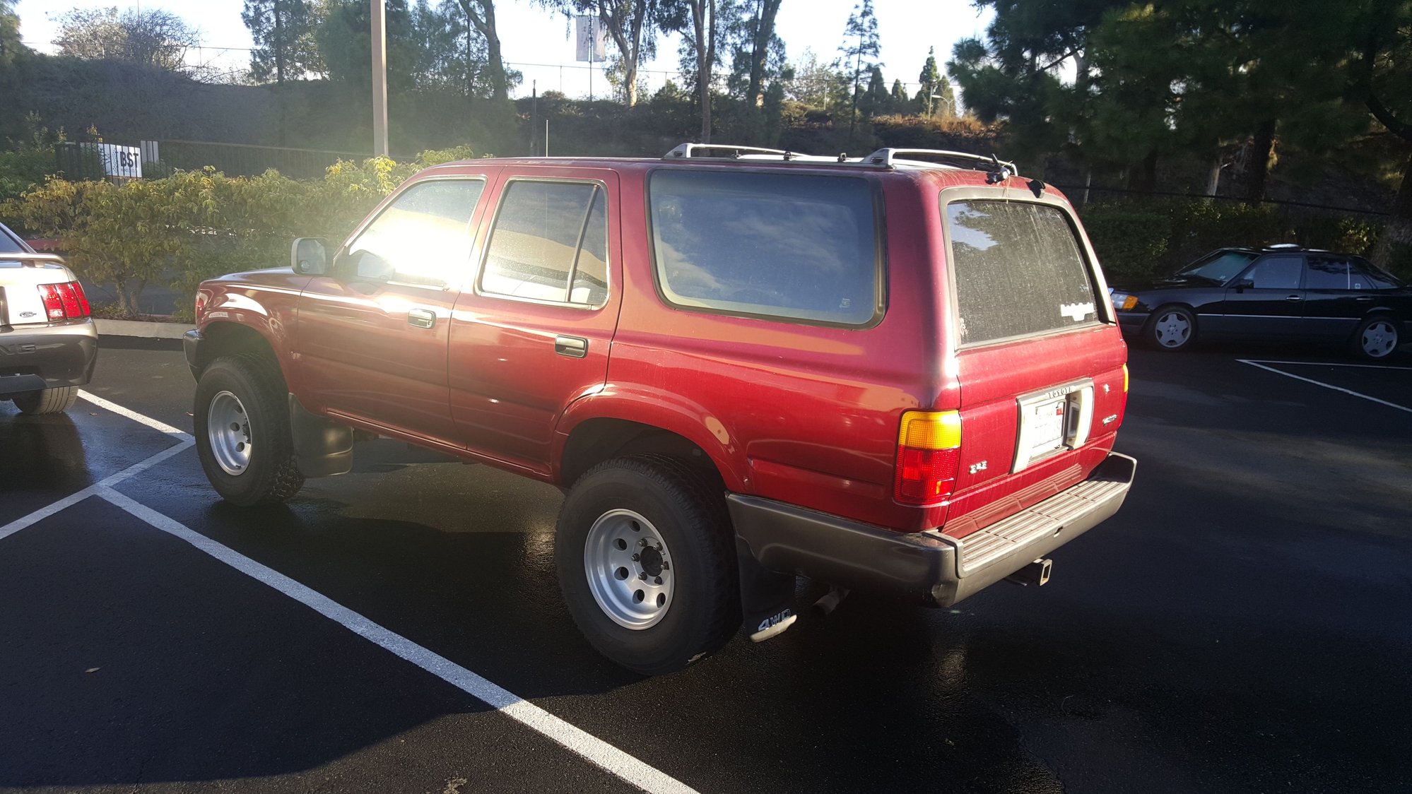

So, I just purchased my first 4runner. She is a 1991, 22RE powered, 4x4, 4 door that I bought off of a friends parents. They were the original owners as, the dad worked at the Toyota dealership when it was purchased. It seems to have a fair amount of factory options. Factory hitch, alarm, roof rack and some others.
Now here is why I came here. I have my prerunner still ( https://www.yotatech.com/forums/f199...pickup-287148/ ) and, I am thinking about a SAS for the front and 62" long leafs for the rear but, more about that later. The motor is TIRED. I have a stock 1992 22RE in the garage however, I have been reading a lot of things about 22reperformance.com and, considering buying a rebuilt longblock. anyone delt with them before? 5 months seems like a long time to wait..... I used to buy LC Engineering products but, I no longer have a Scrooge McDuck vault of cash so, that's a no go for me. Here is a pic>>>
I'll keep this thread updated as, I work on it.
Thanks for looking!
Old Nov 4, 2015 | 12:32 PM
84 yota dude's Avatar
Joined: Mar 2013
Posts: 1,060
Likes: 48
That thing is CLean! I've heard great things about 22reperformance...just a long wait

Nice! Clean lines (AND 4 doors!) of the second-gen with 22R-Eliable! Can't beat that. I would hold off on the mods and focus on reliability/power. I was also considering 22RE Performance because of the rave reviews but because of the long wait (during winter in So Cal - BRRR! LOL! - when my HG blew), I opted for a local shop, instead.
