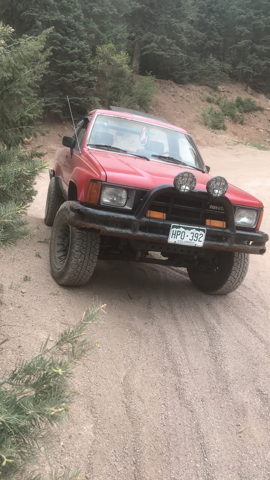

So I figured this would be a decent place to start of, I live currently in Colorado Springs so if any of you are local I’d love to meet up. I got my 86 runner in a trade and I am the third owner now (and probably the last). When I got it it was leaking oil pretty bad and there is a awful exhaust leak. 30 Inch tires stock bumpers stock everything, since then I have sourced and done a lot of work to it since I got in in trade in FEB2018.
Some info on it is it’s a 86 DLX IFS 22re. 295k running well
Some o me of my goals are a motor swap/ rebuild it is pretty gutless and it is leaking a good amount of oil.
3-4 inch lift, repaint, stinger type bumper, regear to 5:13s or 5:29s, do a complete rust elimination, rock sliders, some type of roof rack, and a visor are some of my biggest. Wants.
id like to go through and rebuild everything on it and I figured I’d take pics and videos of everything to show you guys and also ask for advice.

What the front end looks like as of today
