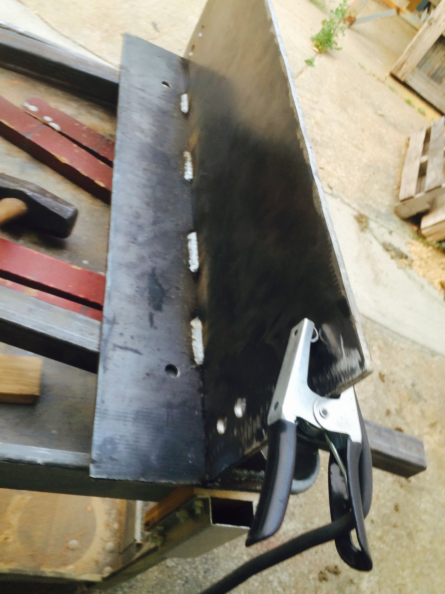

Unfortunately I didn't get any pictures of how I marked it all out and cutting it out with a plasma cutter but at least I got something I thought I would share. This is a view of the bottom that would be facing the back. It will all make sense once we reach the end.

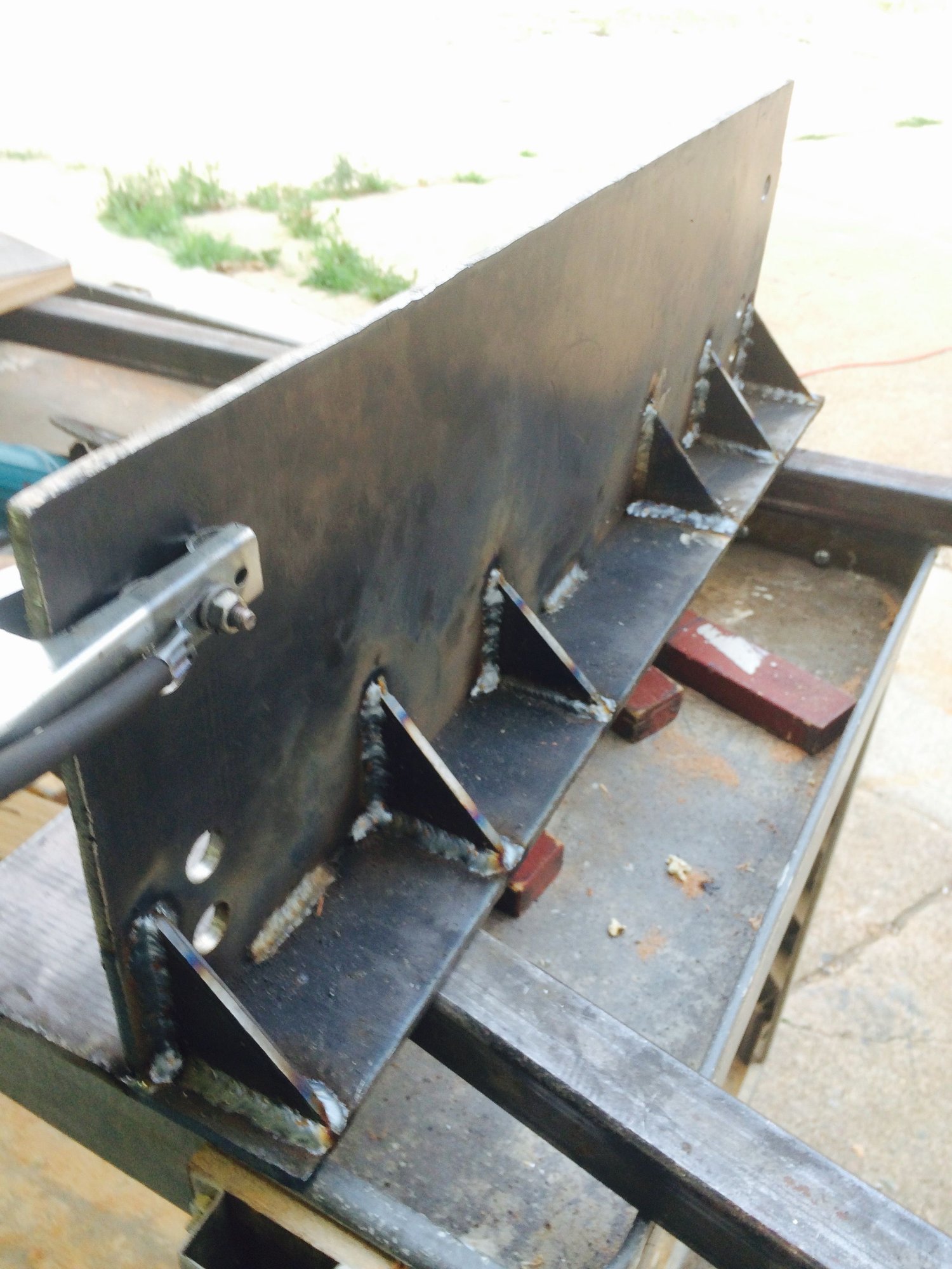

Here's a view of top side but upside down. The plate with the holes will be bolted up underneath the truck into the frame using stock locations. I finished the welds once I knew everything lined up.

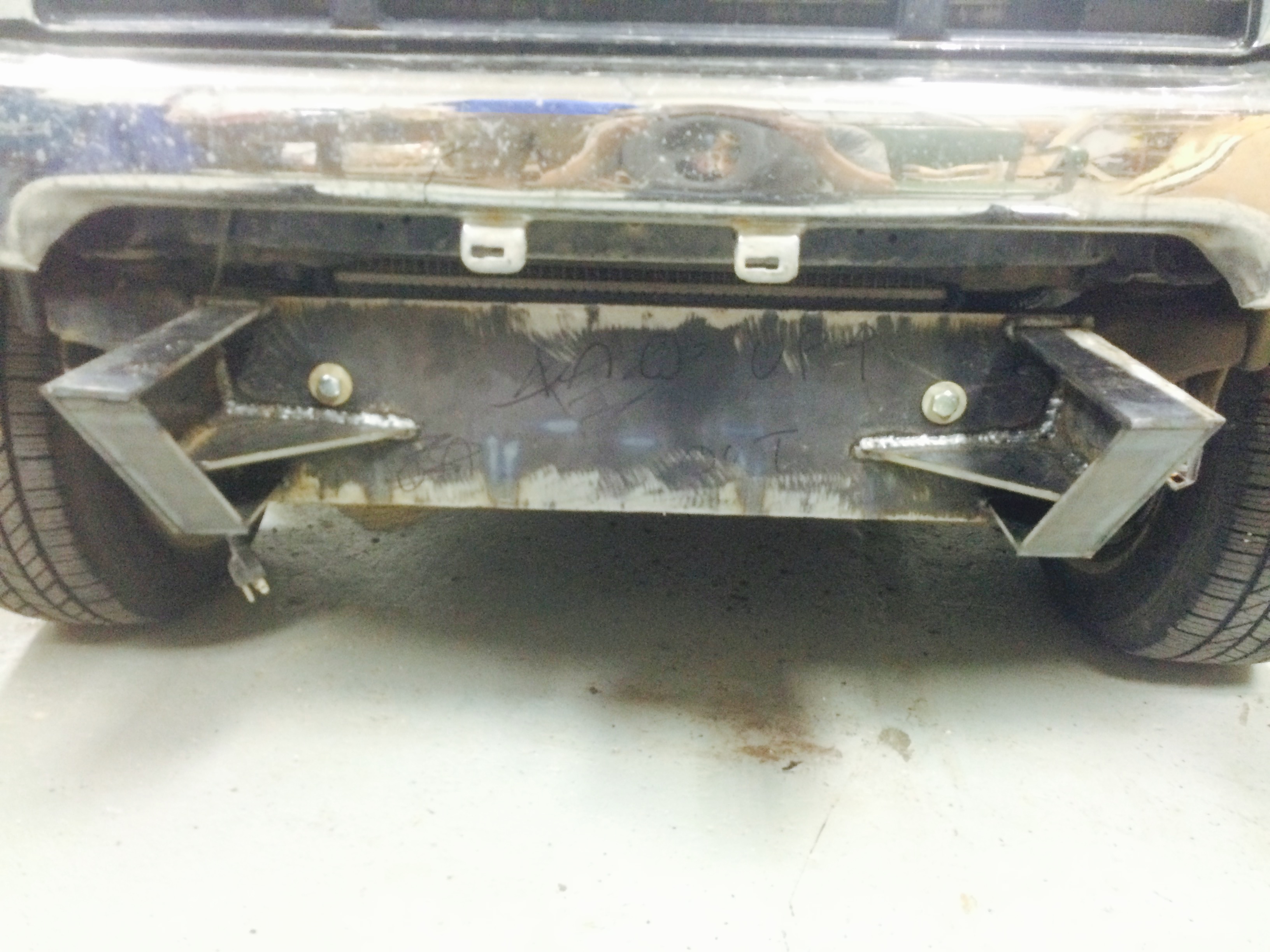

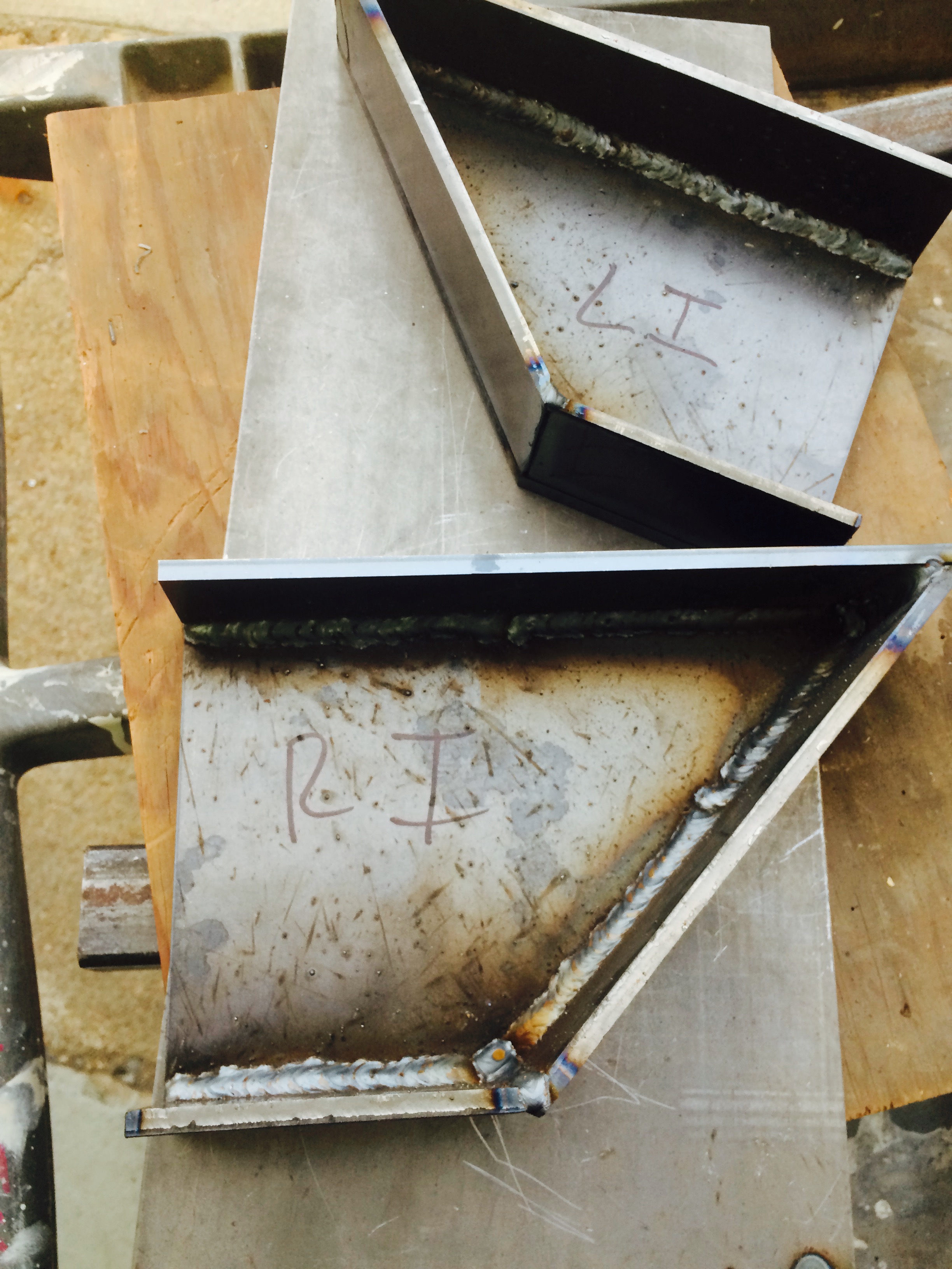

And here are these bad boys. These are welded onto the plate of the mount. These hold the "universal" winch mount from Harbor Freight. I had to get something with little time!

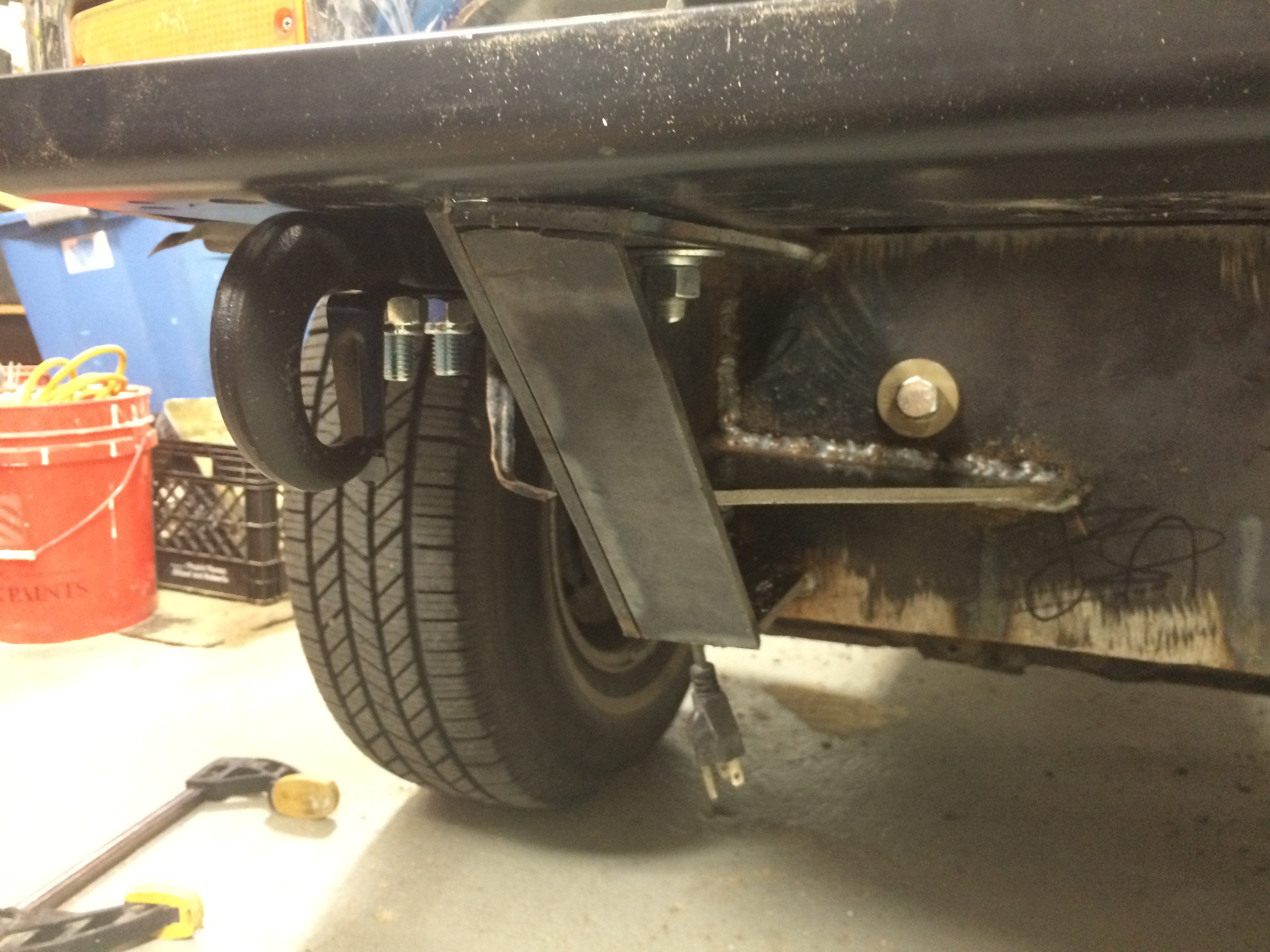

Here you can see it all come together. I used a gusset on each side of those brackets to support it. I don't think this is going anywhere!
More of a close up here. You can see that 2 holes were drilled from the universal mount to my brackets on each side. Once I knew everything lined up I took it off and painted it. That sucker is heavy, I wouldn't want to be hit by that thing.
