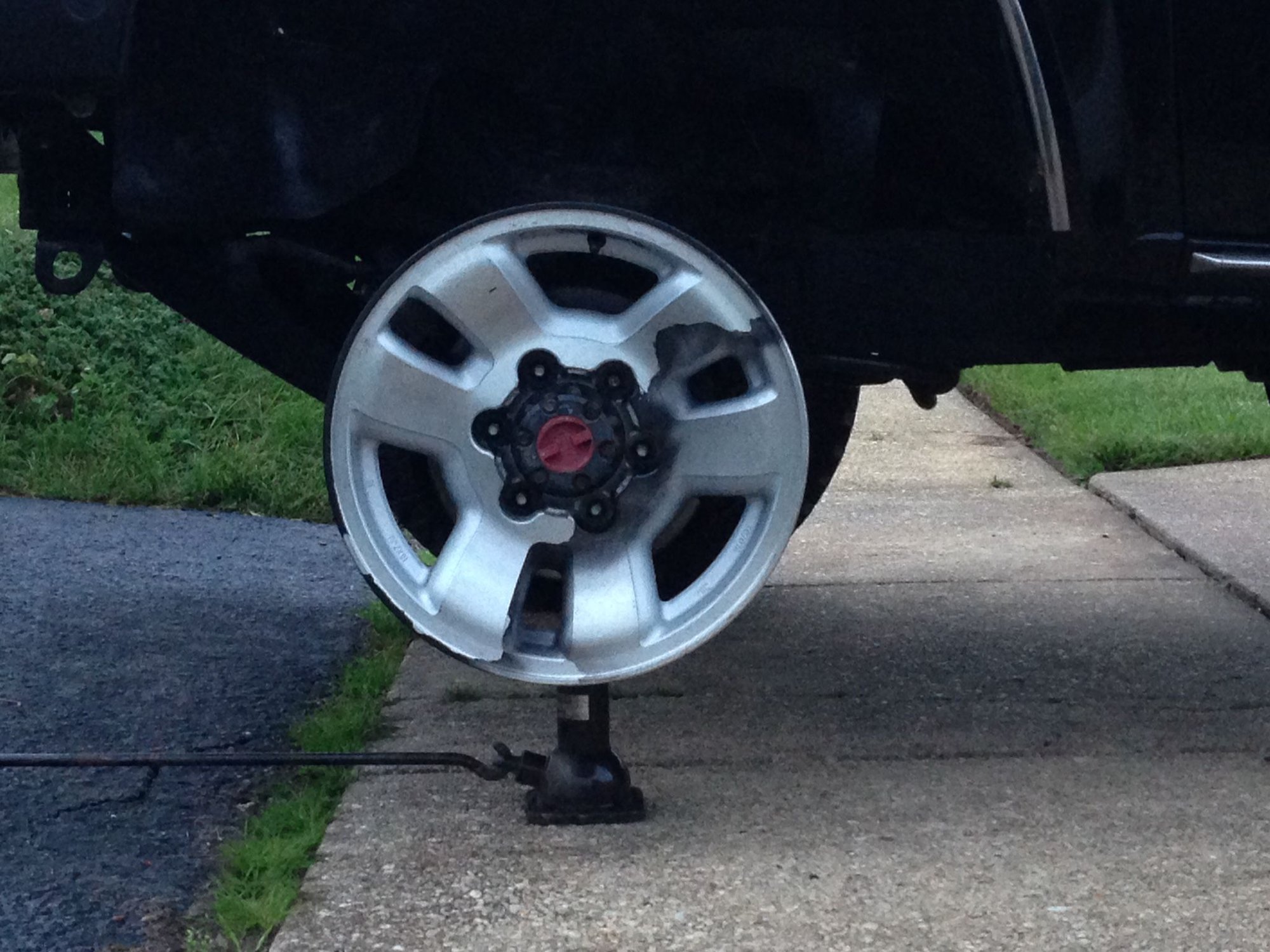

I had some work done to my truck, new rotors, bearings, wheel cylinders, shoes, drums, bearings, seals... but i still get a pulsating feeling when I brake. I returned the truck to Toyota because the work and parts are under warranty. They said that my tie rods and pitman arm are causing the pulsating. I call BS. The mechanic is saying that because there is "slop" in the steering, that the tires' toe is constantly changing during the braking causing the "pulsating" feeling. There is no way that the tires are wobbling that much when breaking at 25mph and I still the sensation in the brake pedal. Has anyone ever had OEM Toyota Rotors cause this issue? I can't think of any other possible issue that might be causing this.

Update: I replaced the inner/outer TREs, idler arm and got the truck aligned. I still have the sensation in the brakes. I might have a SLIGHTLY out of balance tire, and I know that my "camber and caster are MAXED OUT" according to the tech at Firestone, but still within spec. I am still getting that sensation.. the only thing I can deduce is that the rotors are warped... what else could cause the sensation like I'm riding a wave as I brake? On a good note, I got 20 mph with a bike on the roof rack, the truck is super quiet now so I'm stoked with that. I'm looking forward to doing the SUPRA AFM swap mod... but I'm going to keep the intake and airbox in the same location.
