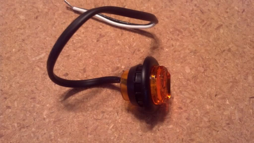

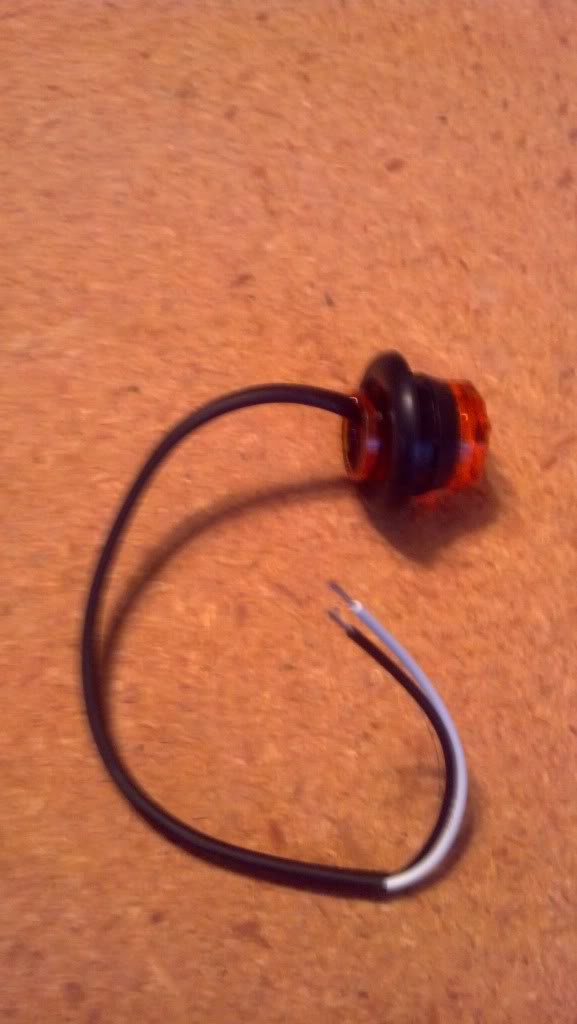

The lights

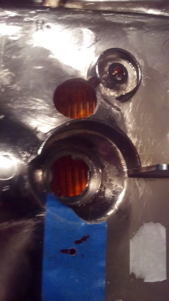

I centered the tape and measure a 1/2" above the lip of outer lip of where the corner light goes. Used blue tape and red sharpie, what I had but found it worked good.

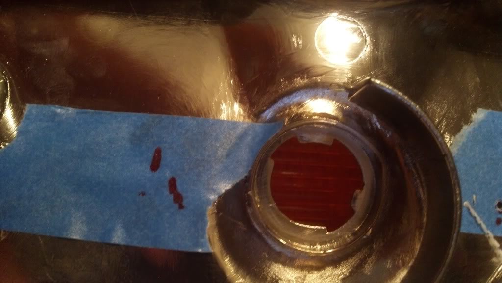

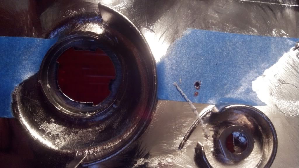

Drilled pilot then a second a little bigger, just to be safe so I didnt crack the plastic with the big bit
. Theres a section, not sure what its for next to where I mounted mine, the plastic comes up, so I trimmed it. Name:  IMG_20130929_184347_012_zps7e4b6884.jpg
Hole drilled

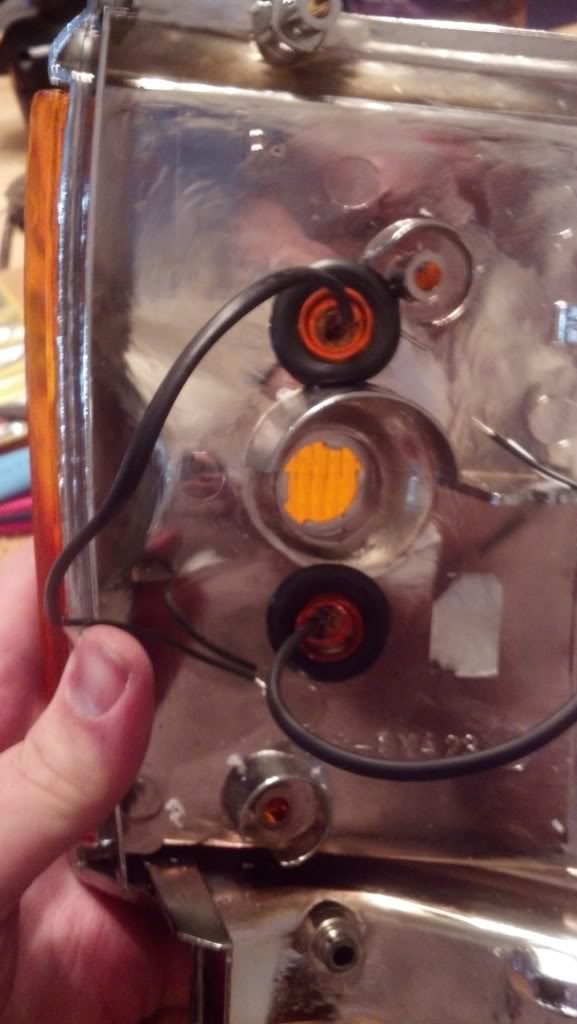

The lights come with a black gromet, take it off and flip it around.
How it should be for install
I used a small flat head screw driver to help press the the gromets it, It helped and be gentle. This is plastic. But once there in Name:  IMG_20130929_190405_616_zpscbfbf021.jpg

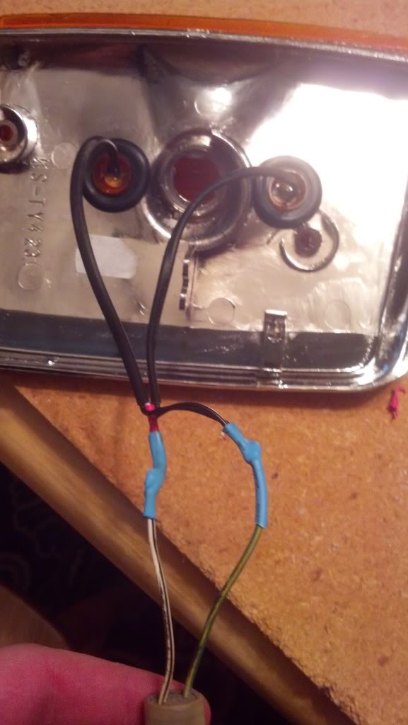

Now our favorite part, the wiring, which wasnt hard, if you have installed aux lights , then this should be easy. Just clip the wire from the connecter(the turn signal one, the side that has the light) give your self at least half the lenght, I did little over half. then connect the wires, the color wire will differ from from years, models. but I went green to neg-black(on the led) and the yellow with black light to pos-white(on the led) put a little bit of soder and shrink wrapped them.
Now I havent tested mine yet, my truck is still a work in progress( check my build thread and you will see) But will try to put the battary in and test them soon.

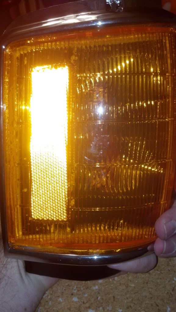

Final product, cant see them that good but I will test soon, I hope to, as long as the wife doesnt make a bigger honey do list for me since winter is coming up haha. And yes I did do this to 2 brand new corner lights I got off Amazon. My originals were busted in the wreck. If your looking for new corners I do still have the link on Amazon for them, I think I paid less the $40 for both, maybe $30 cant remember.
There it is, If you wanna try it go for it. Its a better alternative to Bumper turn signals, less chance of braking while wheeling and it adds a custom look. I will find out where the fuse is that you have to modify so you dont get the quick flashing and add it to here. I believe it a big green box one but not 100% but I will find out and add.

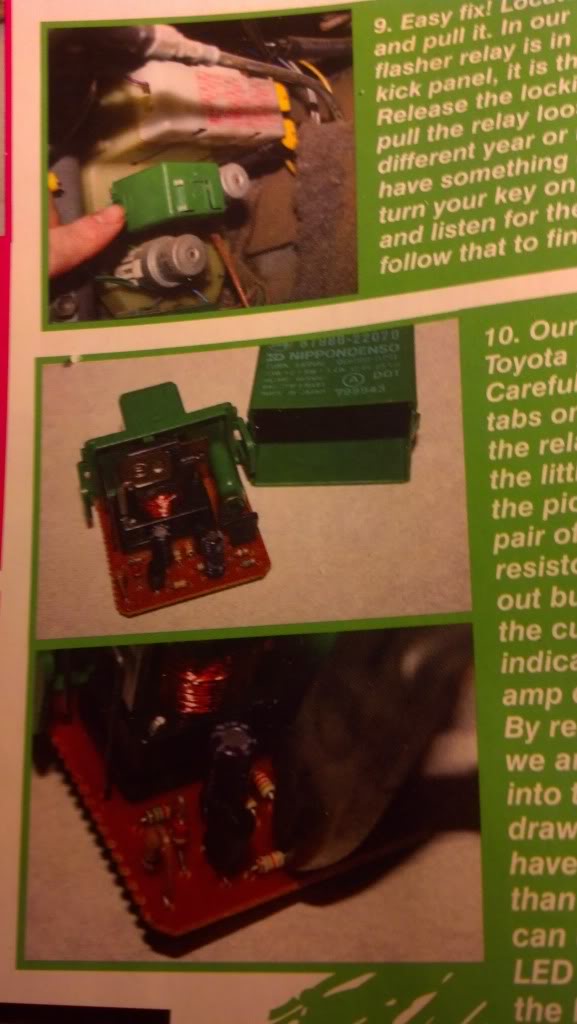

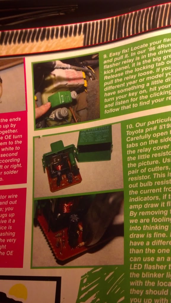

Heres the pic I found in the magazine on which spot to cut.

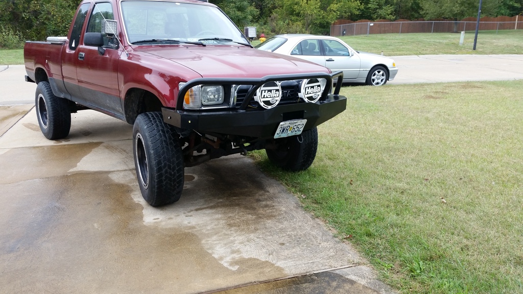

I did something similar, although I integrated it into my winch bumper. Used both amber and white versions of these
" target="_blank" title="Amazon.com: 2 Pair 12V 3W Amber LED Eagle Eye Bumper Lamp DRL License Plate Running Fog Light: Automotive">Amazon.com: 2 Pair 12V 3W Amber LED Eagle Eye Bumper Lamp DRL License Plate Running Fog Light: Automotive " target="_blank" title="Amazon.com: 2 Pair 12V 3W Amber LED Eagle Eye Bumper Lamp DRL License Plate Running Fog Light: Automotive">Amazon.com: 2 Pair 12V 3W Amber LED Eagle Eye Bumper Lamp DRL License Plate Running Fog Light: Automotive
Old Oct 8, 2015 | 04:19 PM
HotNotch's Avatar
Joined: Aug 2012
Posts: 64
You can kind of see them in this pic
