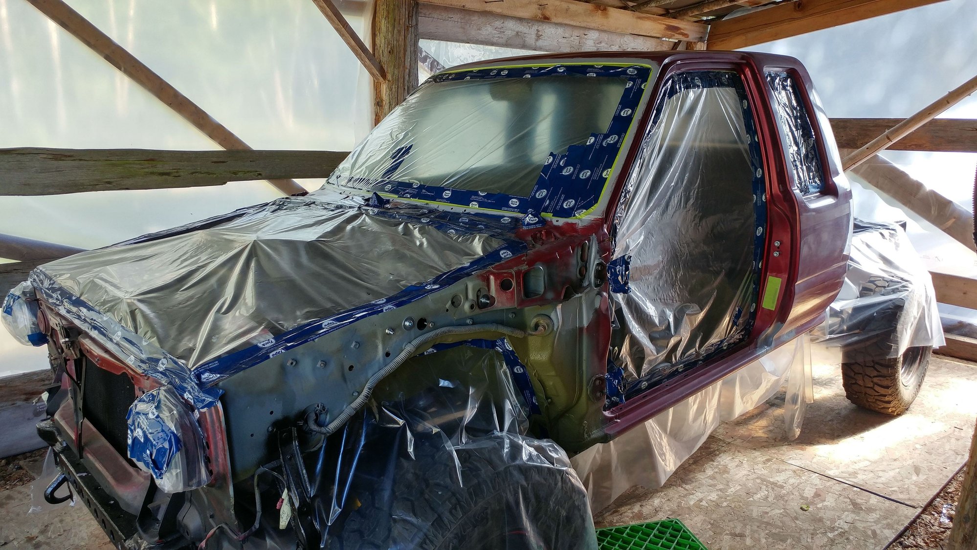

Alrighty, lots to report since the last update, i found more rot, learned how to weld, put the new windshield in, and sprayed the cab, tailgate and one fender.
Let's start at the beginning, rust.
This actually came as quite a surprise, i was just doing some preliminary surface prep on the bottom edge, saw a couple small bubbles, hit it with the wire brush and two big holes appear.
A neighbor had a welder he was willing to lend, but was too busy to actually weld for me, so it was high time to learn.
Behold my first ever weld
Hah! Ugly for sure but it's solid. Which got me thinking about my doors, sure enough the 'minor surface rust' i remember is actually through and through rot there as well...back to the welder.
It's amazing what you can do with a welder, some sheet steel, a grinder and some hammering, I'm hooked.
On to painting, wait. Back up, surface prep. Alll the surface prep.
I wasn't sure exactly how far one gallon would go so i wanted to have a couple over flow pieces prepped to use up any extra. Tail gate shell and rh fender got dibs.
On to spraying, wait, back up....cutting in.
The spraying went pretty good, except part way through doing the second coat the trigger pin flew out of the gun and shot across the shed, I momentarily panicked, then by some fluke found it on the ground within seconds, it's a brass pin about the size of a toothpick, anyway! Continued.

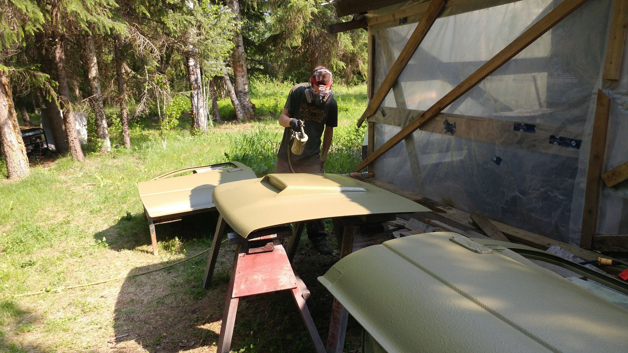

Looked pretty comical to have most of the truck strung up from the forest, like some sort of vehicular Christmas ornaments.
Had mocked up the hood scoop and cut the hole the night before.
Spray!
Managed to get everything painted and put away before the rains started in the week.
During the week i worked on a grill for the hood scoop.
Got some expanded metal from work, ground it down to shape, primed and painted it, jb welded it to the scoop.

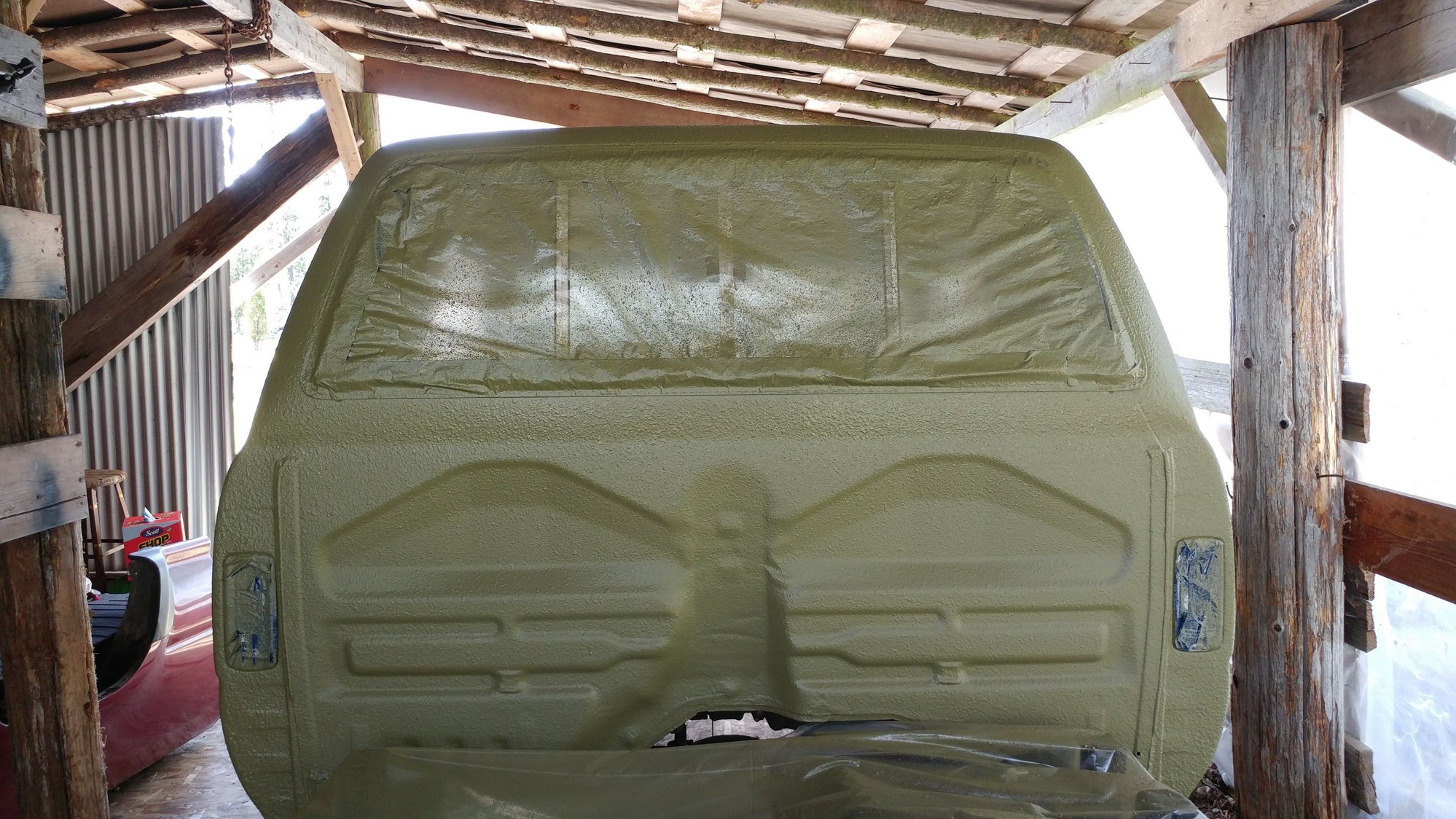

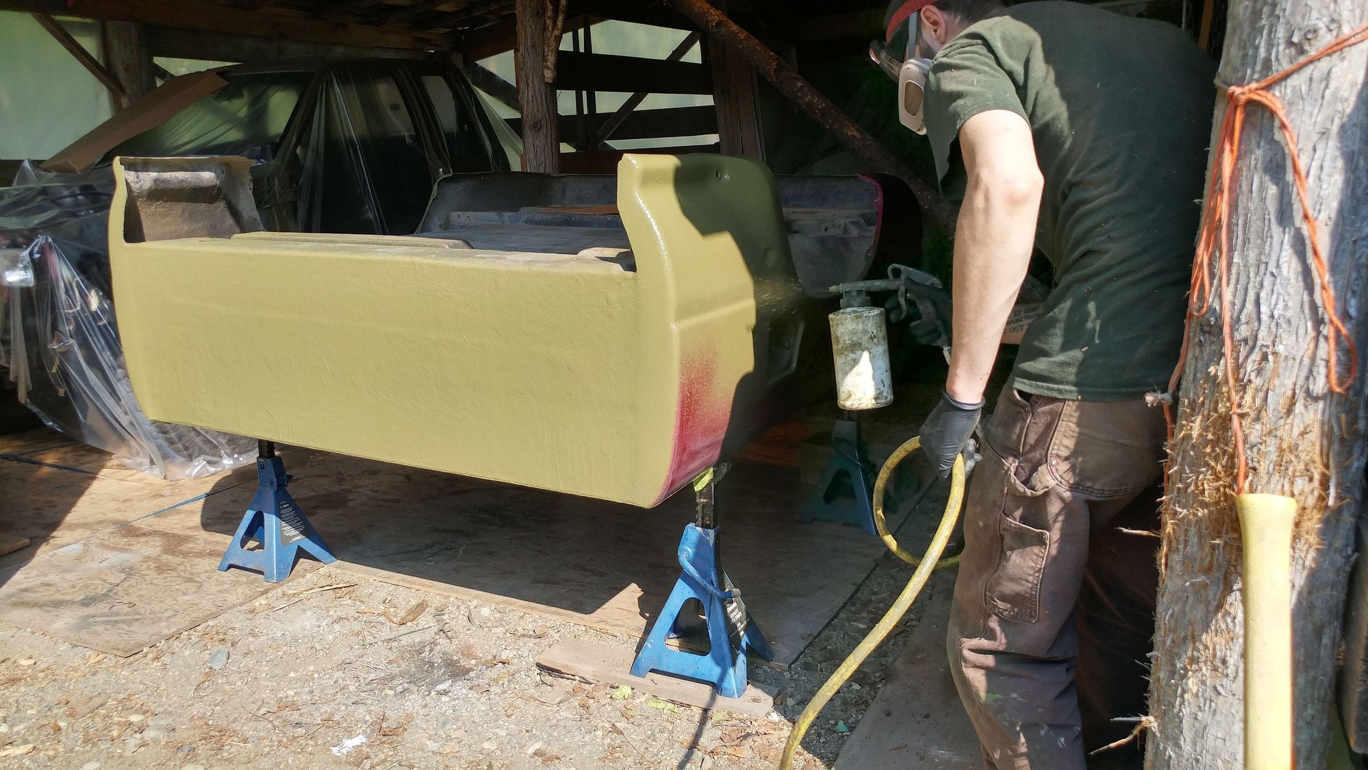

Fast forward to this weekend, we started by prepping the box and remaining bits.
Spray!!!
Really happy with how the hood turned out
