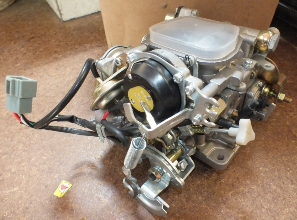

I love my parcel post lady !!!
Just delivered my new Carburettor, which means I have some work to do today !!
Probably a bit of a waste replacing the Carburettor, but I need the Car running properly for its Registration Inspection, the new carb is allegedly pre-tuned & should be a straight bolt on turn key VROOOOM..... we'll see

Originally Posted by rworegon
The workshop is getting the axle and bearing all fixed up properly?
Shiny carb. Hmmmm, it's been so long, I think I've forgotten how to work on them.
Hopefully picking the axle up after lunch today, if all goes well and Izabella co-operates by having a sleep this afternoon, might get both carb & axles in & done, assembly of brakes might get done tonight as long as it doesn't get too cold, the weather has turned and winter is definitely on the way, last few morning we've had minus temps...... been going non stop for the last week
Carb's.... simple mechanicals, its the fuel injected & circuit board driven systems that scare the crap out of me, if they go wrong its game over on the side of the road........
