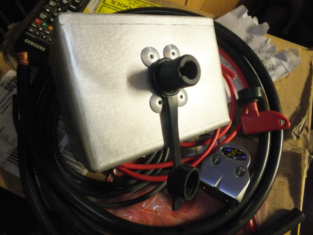

I fab'd an Isolation Switch Box that I'll install tomorrow morning if I get a chance

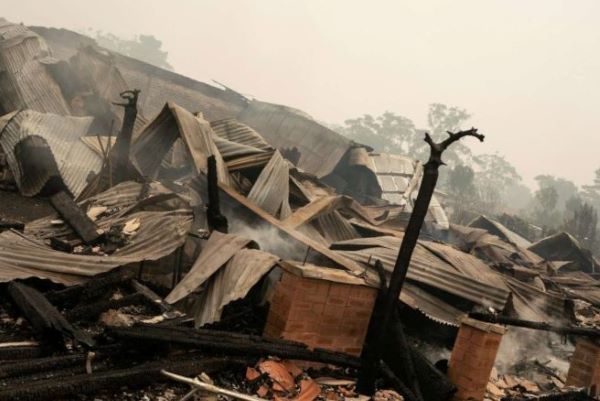

A year ago today, this project became toast, they say a picture speaks a thousand words, enough said !
Our sheds, my Gen 1, a couple of my husbands Jags and our 5th wheeler were cremated !

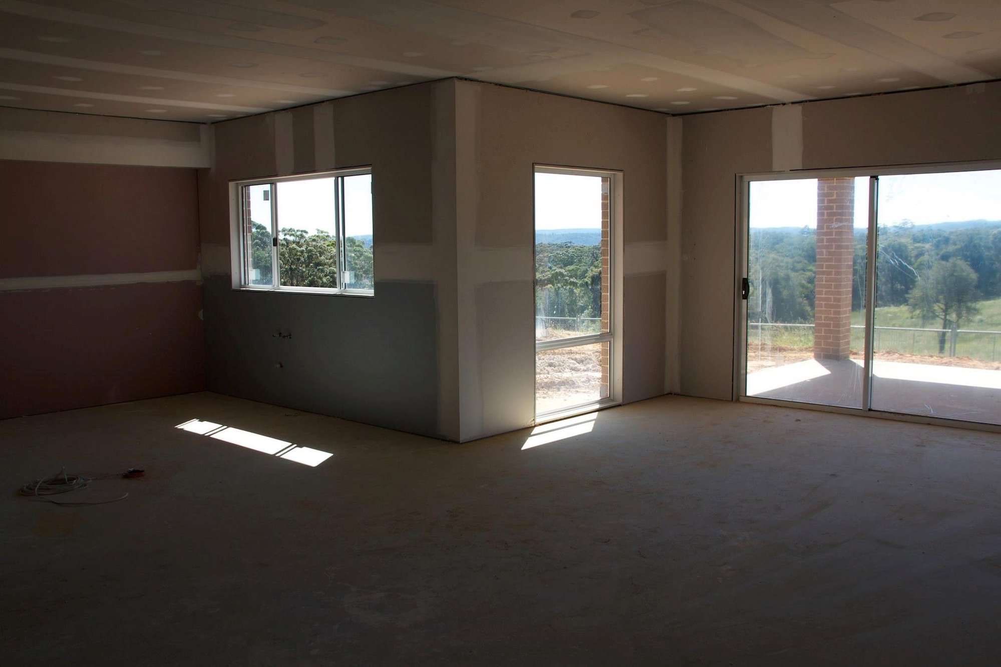

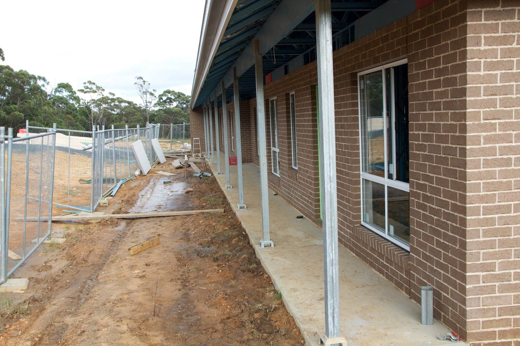

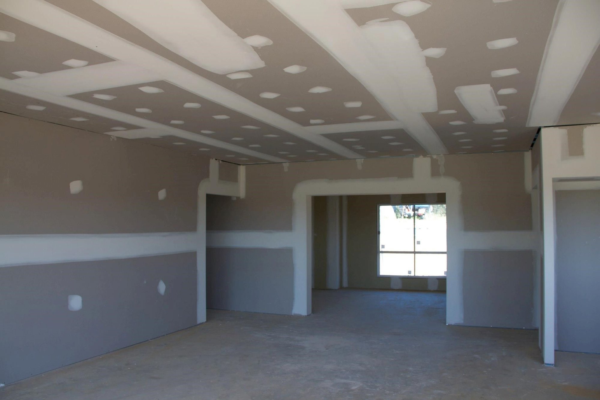

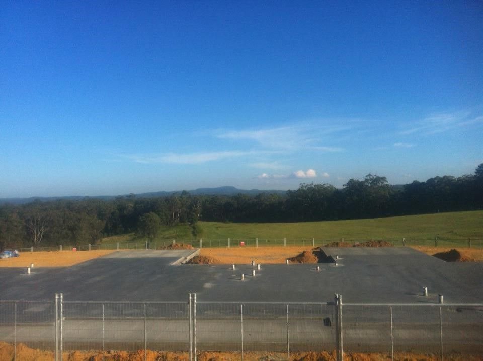

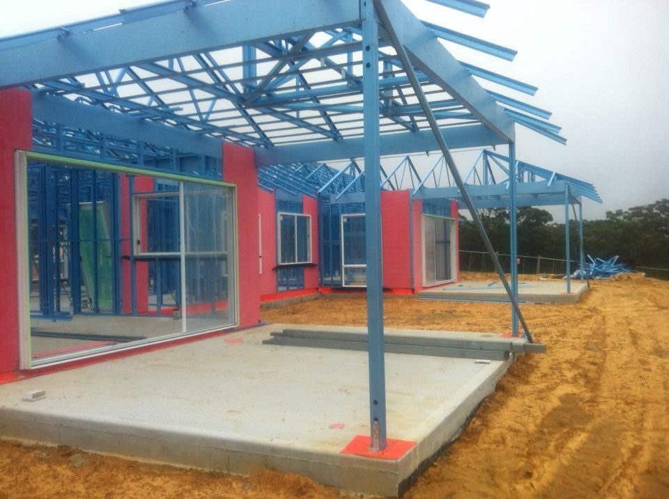

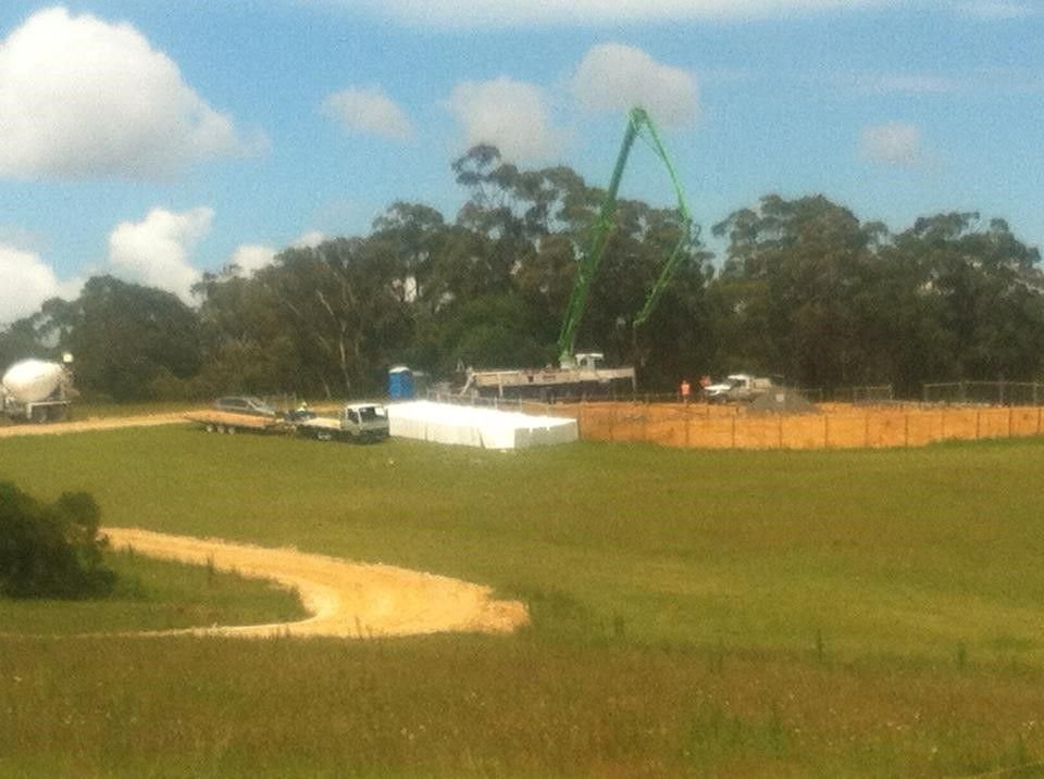

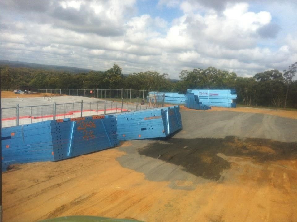

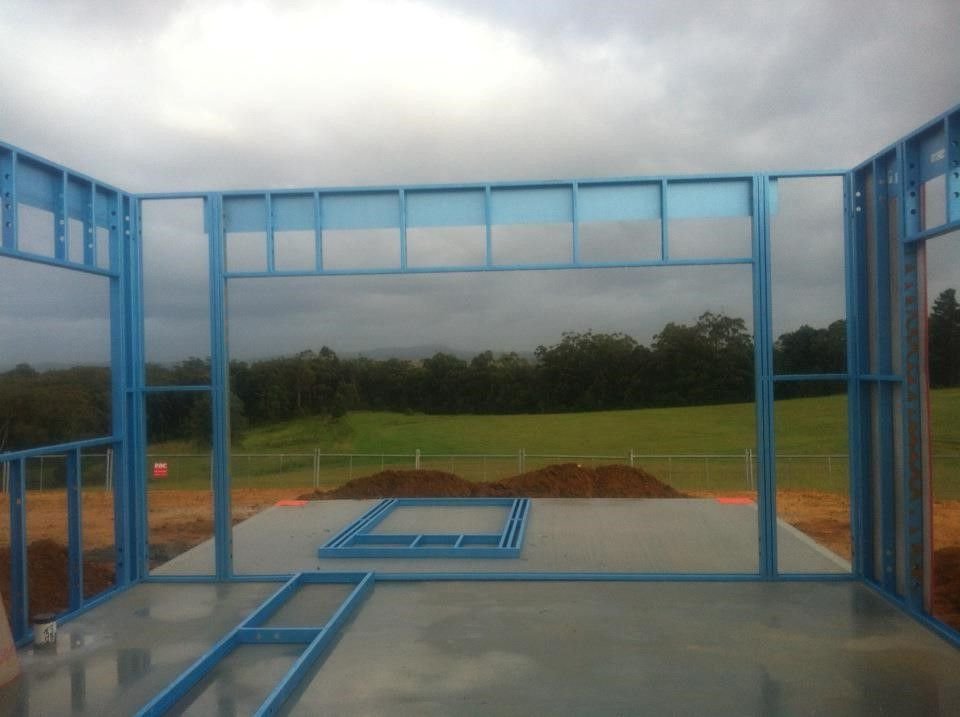

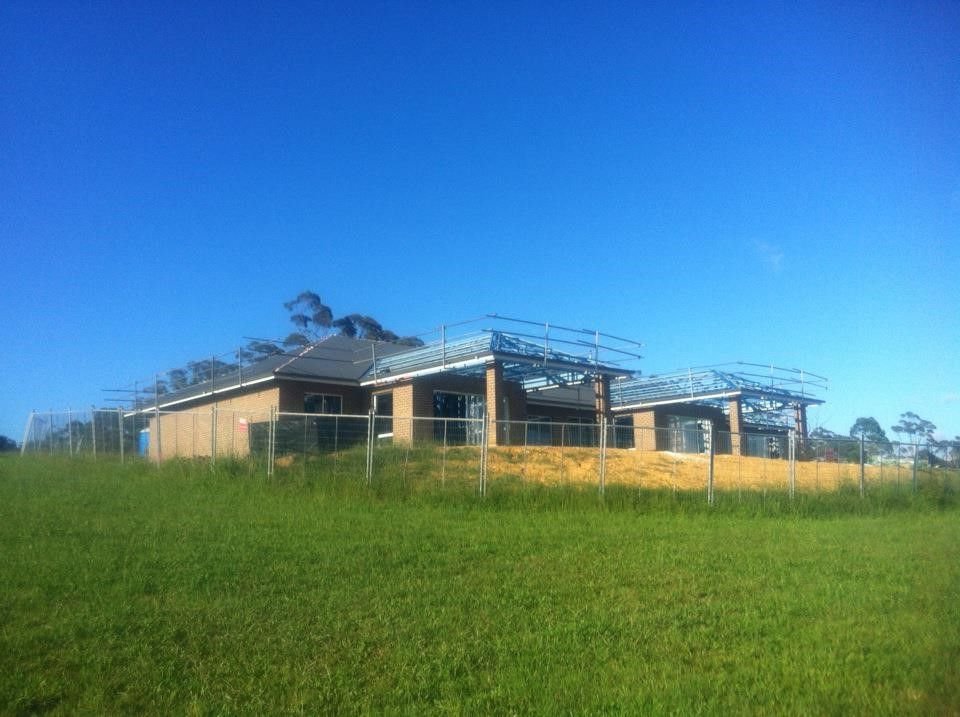

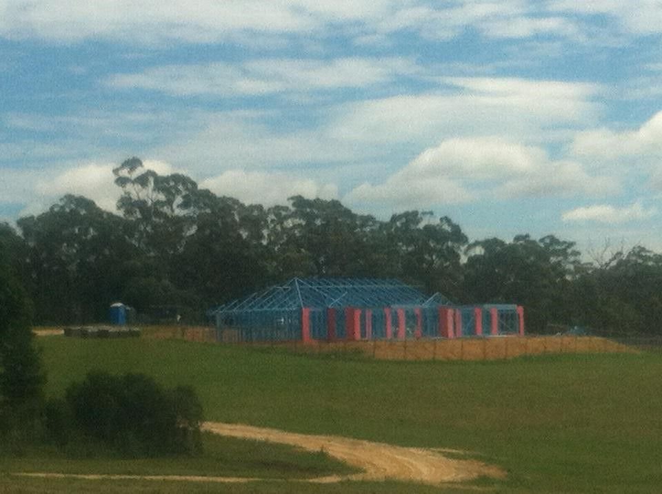

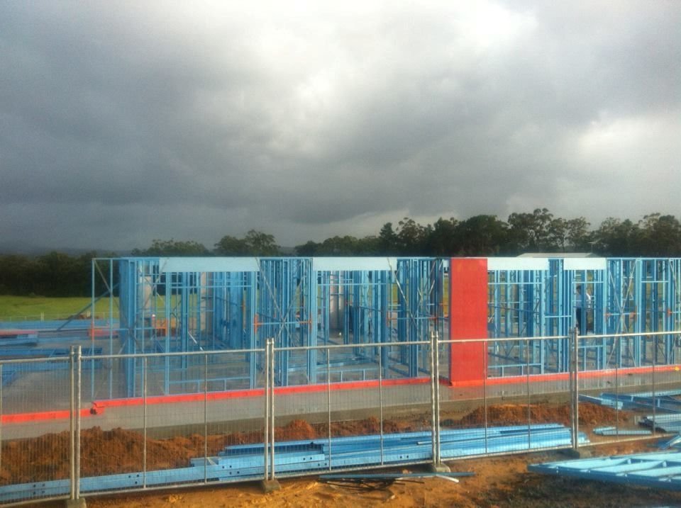

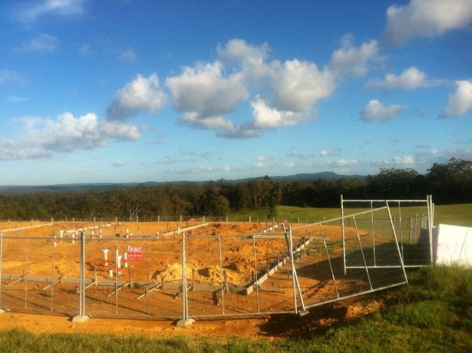

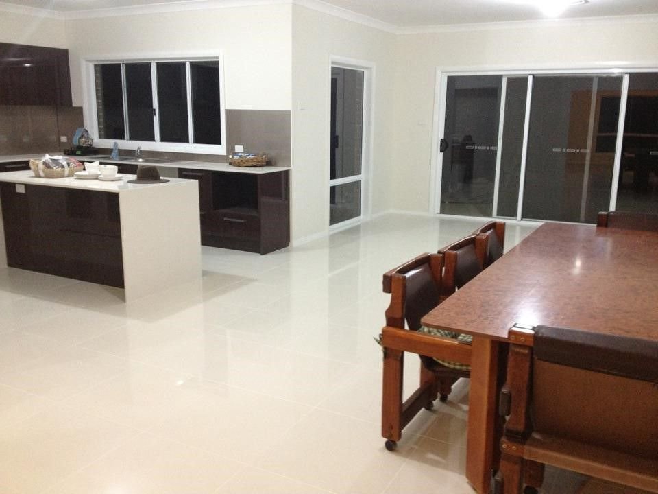

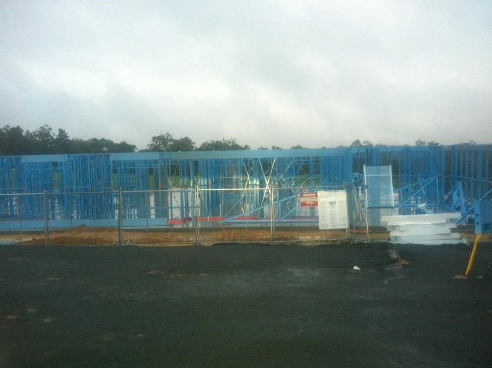

Crap happens, Misery is an option, the house, the sheds, the cars, everything can be replaced. We were out at our property protecting it when a lightening strike started the fires that destroyed our house, a couple of our neighbors/friends perished trying to save their homes, if we'd been home we'd have probably been in the same boat.
We've spent every spare moment in the last 12 months building a new home on our property, its almost finished.
A couple of bathrooms and bedrooms to finish, carpets and we'll be in. We had christmas lunch in the house, its so close now.
490Hectares, no neighbors, so things are definitely heading in the right direction, so give me a few more months and I'll start getting my Gen2 sorted.
