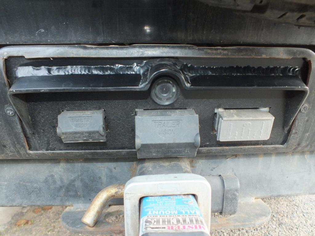

Seeing I'm held up on the Gen-1 runner with the rear axles, I did a little bit on my Gen-2 & an upgrade on my trailer today.
Electrical upgrade to rear bar, 50amp recessed Anderson Plug, 175amp recessed Anderson Plug, 7Pin Flat Trailer socket & Reversing Camera in a TIG'd powdercoated aluminium shroud, I installed this in the bumper a few weeks ago, but only got round to wiring it today..

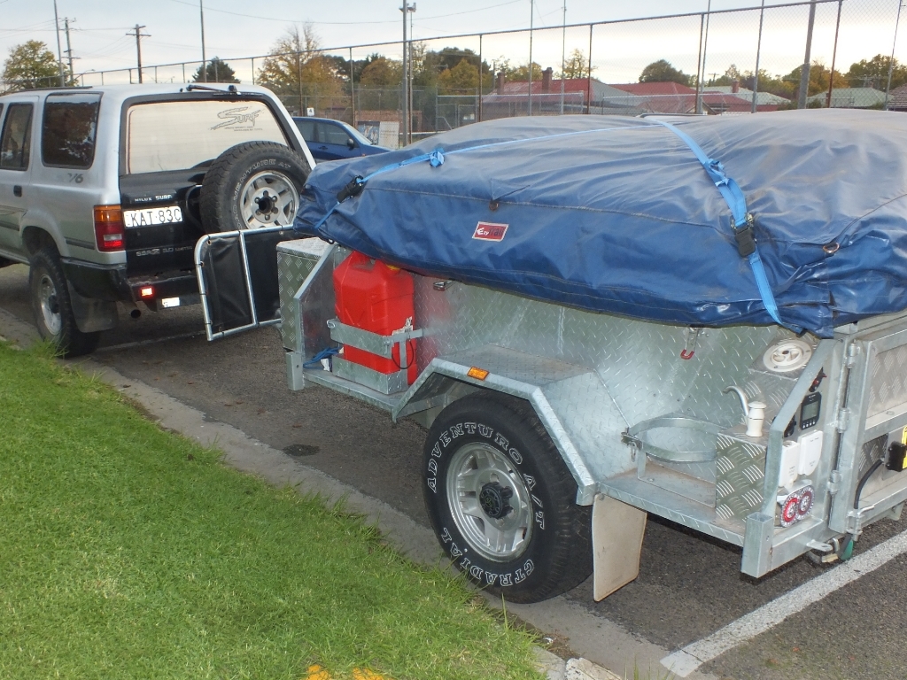

The last time we took the Camper Trailer away, had to transverse a creek that was a little deeper than I expected, consequently this fried my so-called trailer's waterproof LED taillights.
Old pic of the lights

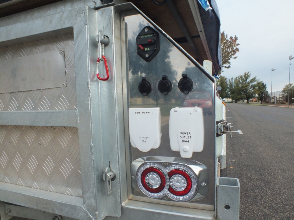

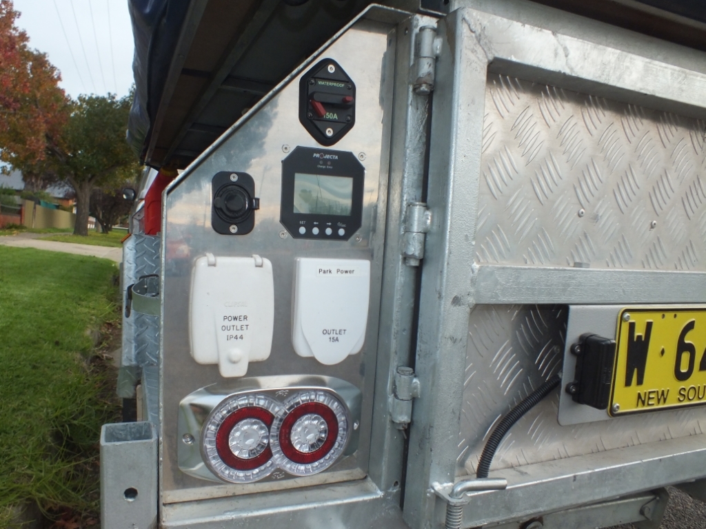

Upgraded Lights
As you can see I did a little more in the upgrade than just lights
Solar Charge Controller, 10 & 15 amp AC outlets (10amp from 6Kw onboard Inverter & 15amp Park sourced Power) 2x 2.1amp USB Sockets & 2x 12v Lighter Sockets & 150 & 30amp Circuit Breakers, all mounted on polished 5mm Aluminium Plates
