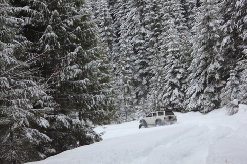

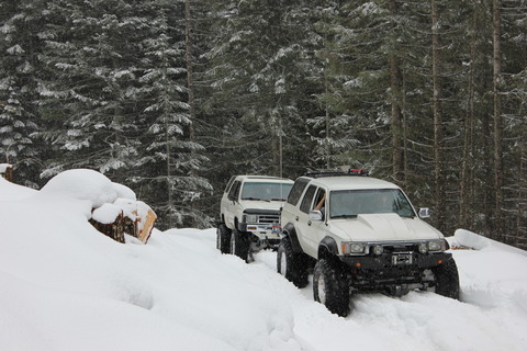

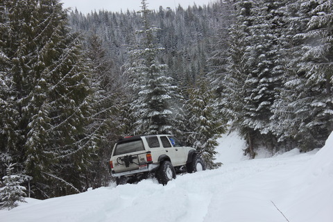

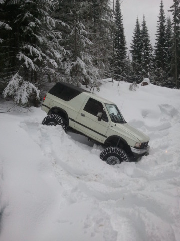

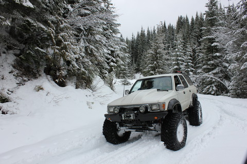

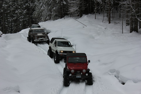

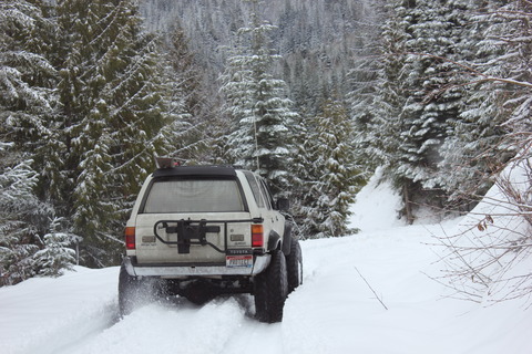

I thought I could share some more of my recent snow wheeling pictures with you guys.

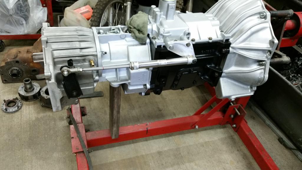

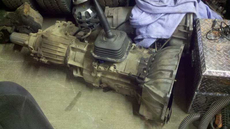

I also picked up a nv4500 5 speed that I will hopefully get put in soon. I just cant keep the automatic from getting too hot out snow wheeling. The Auto is a blast, but I don't know what else to do to keep it cool.

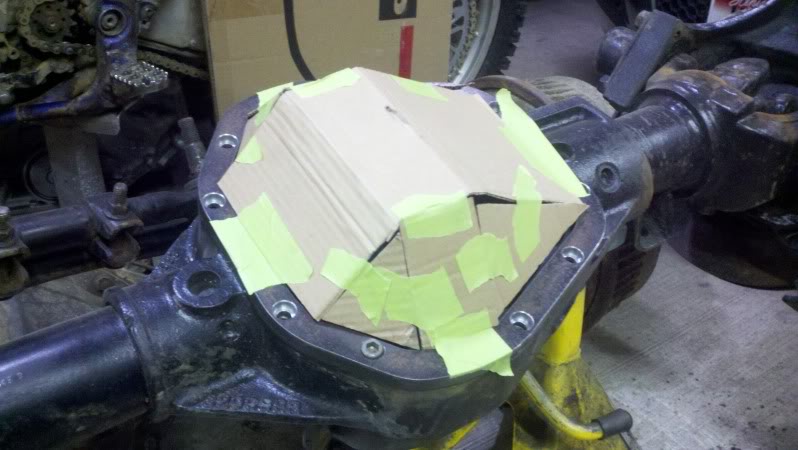

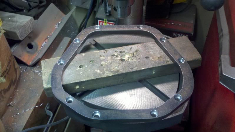

I started working on a front cover for my dana 60
(and no I didn't take my axle out to do that, it is my brothers axle sitting in our shop)

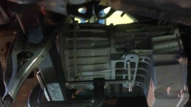

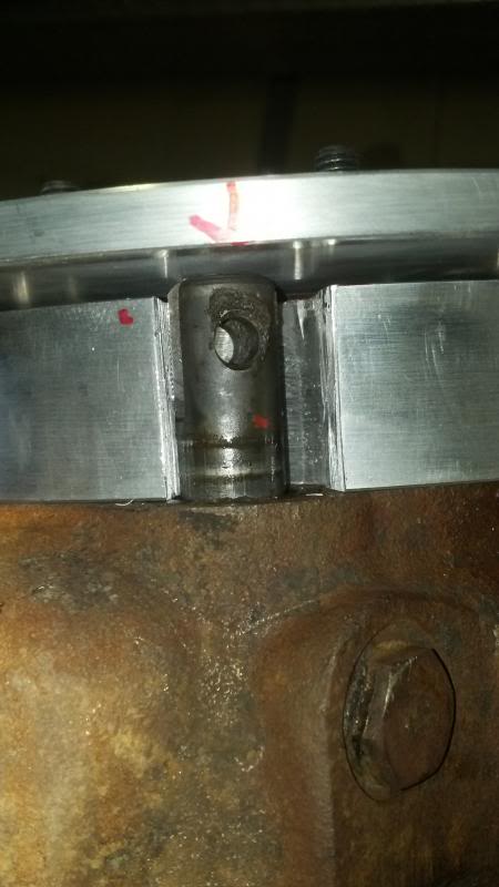

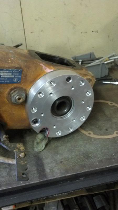

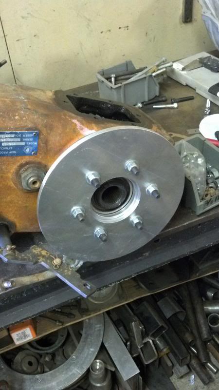

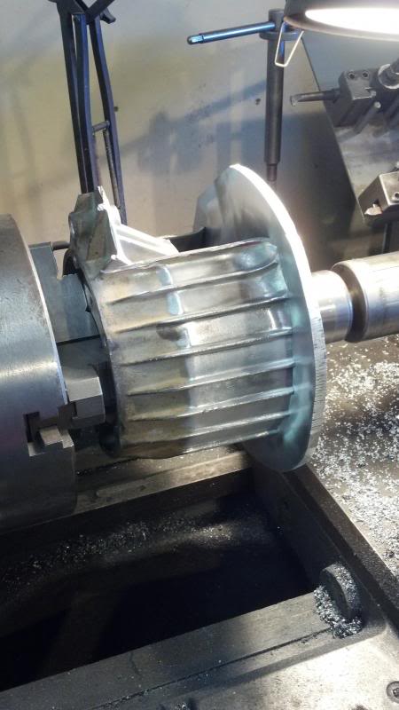

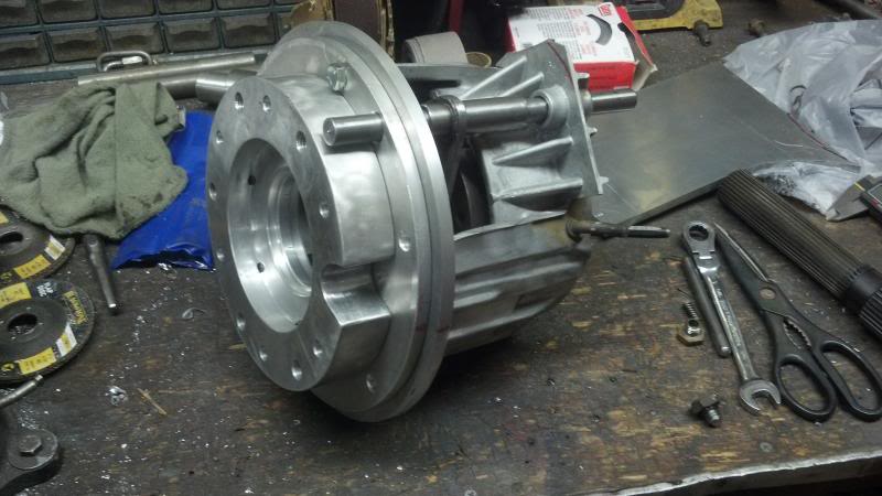

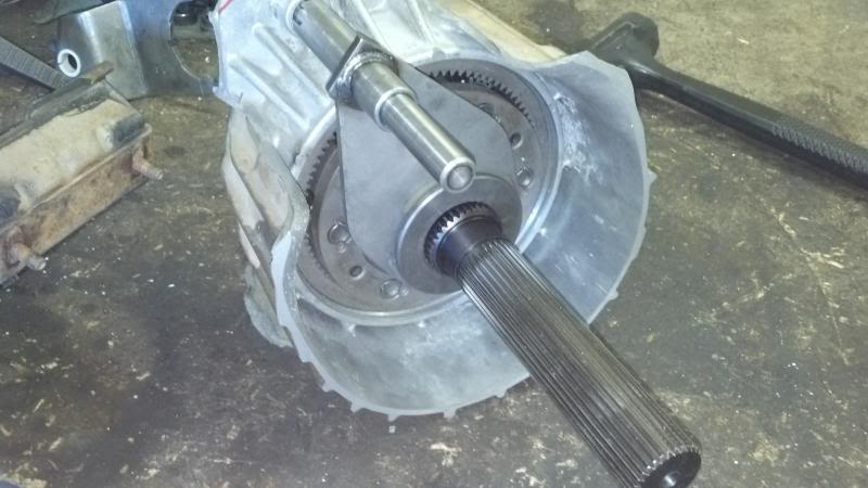

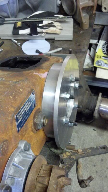

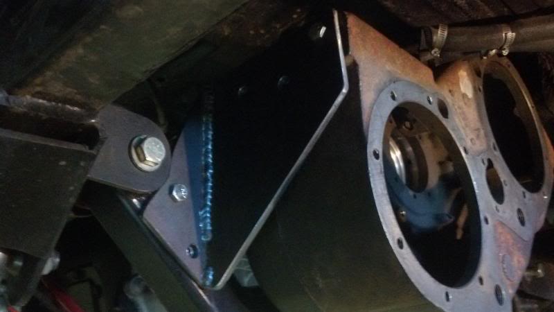

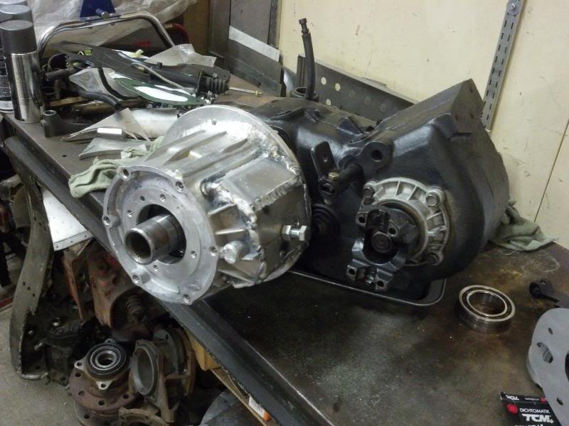

Built myself a np241 planetary gear range box to go in front of the 205 so i could take out the heavy 203.

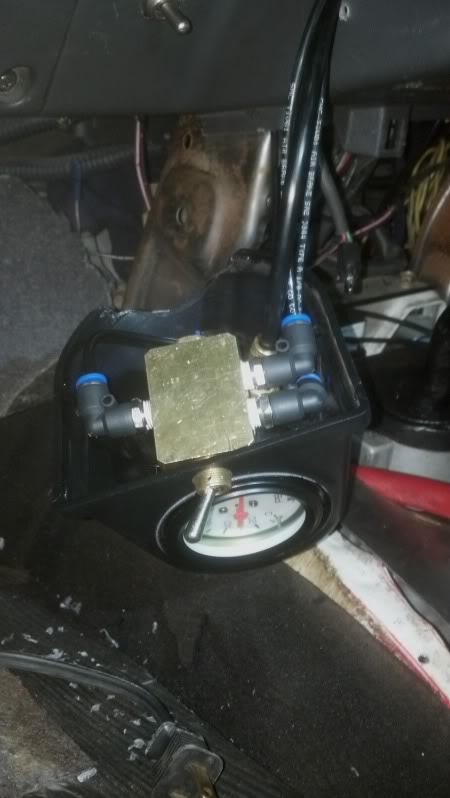

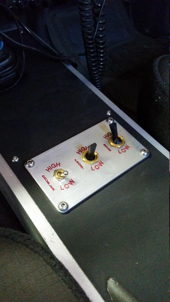

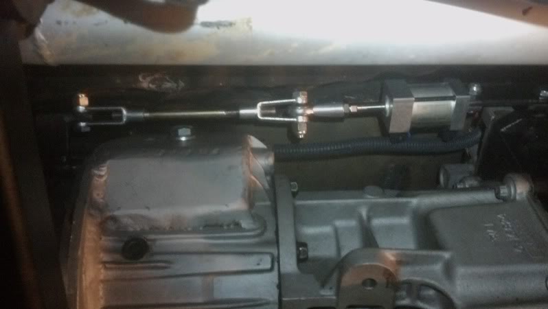

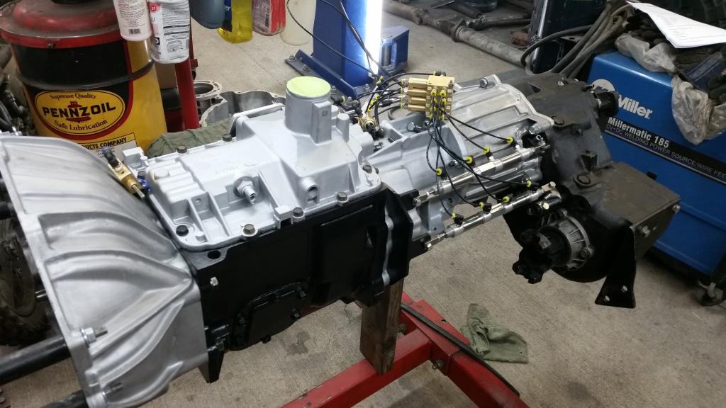

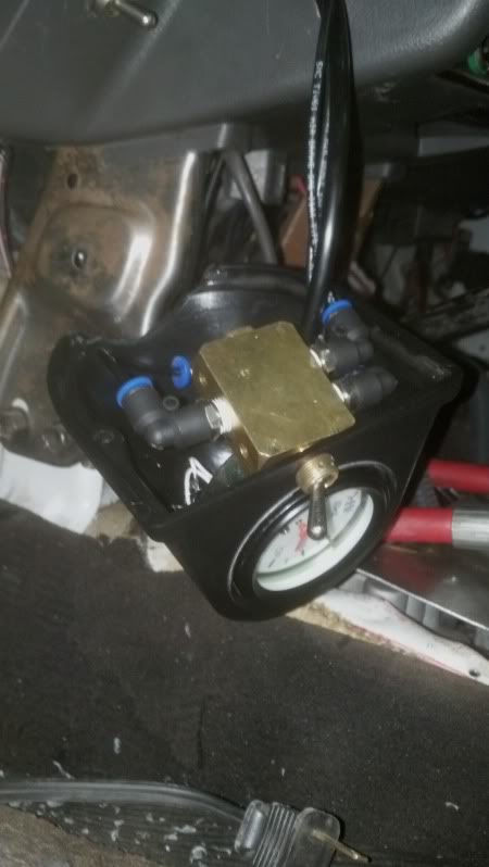

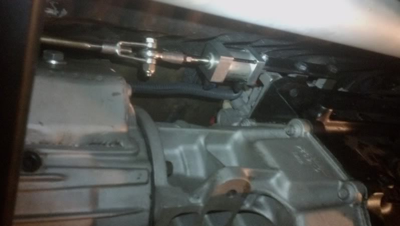

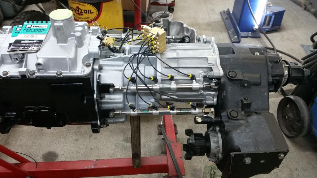

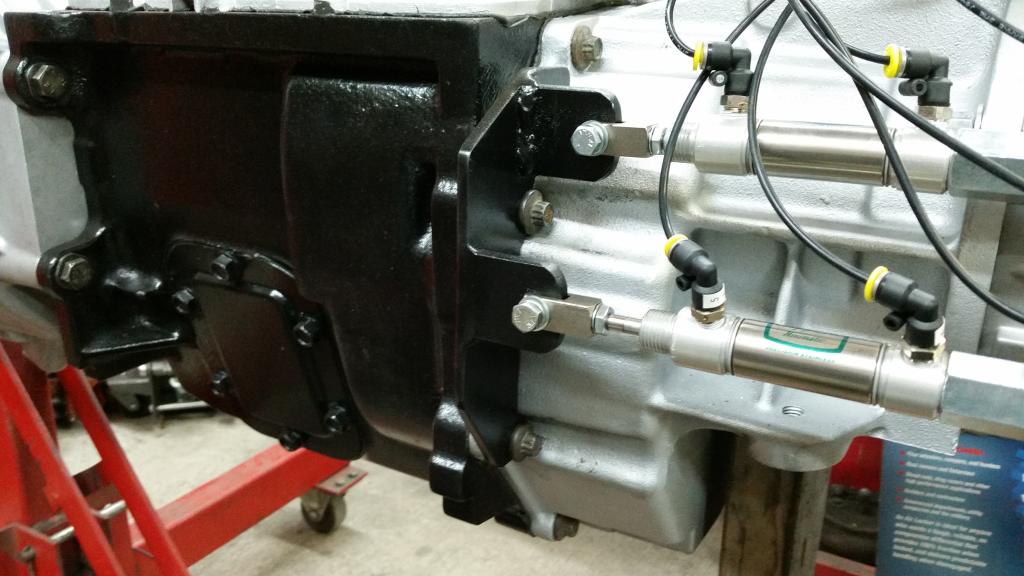

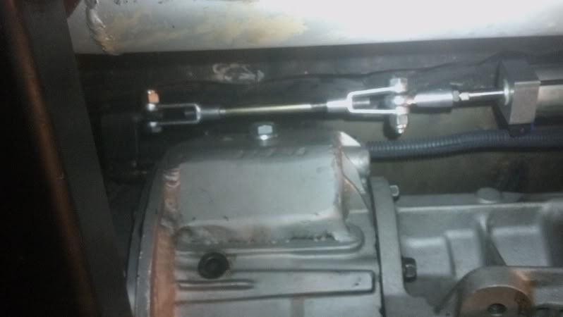

I ended up converting my 241 to air shifted. Here is a couple pictures of the air cylinder set up and my air switch

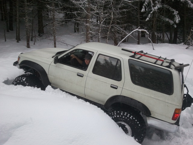

I got a couple action videos of my girlfriend using double low range to creep up a couple steep hill. The snow was horrible for wheeling. If the tires spun at all, it would break through the top crust and just sink down instead of going forward. This was at 2.5 psi in the tires. This was my girlfriends first wheeling trip and she did great. Oh ya and I lost a rear flare haha

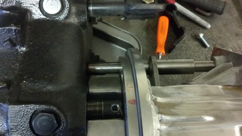

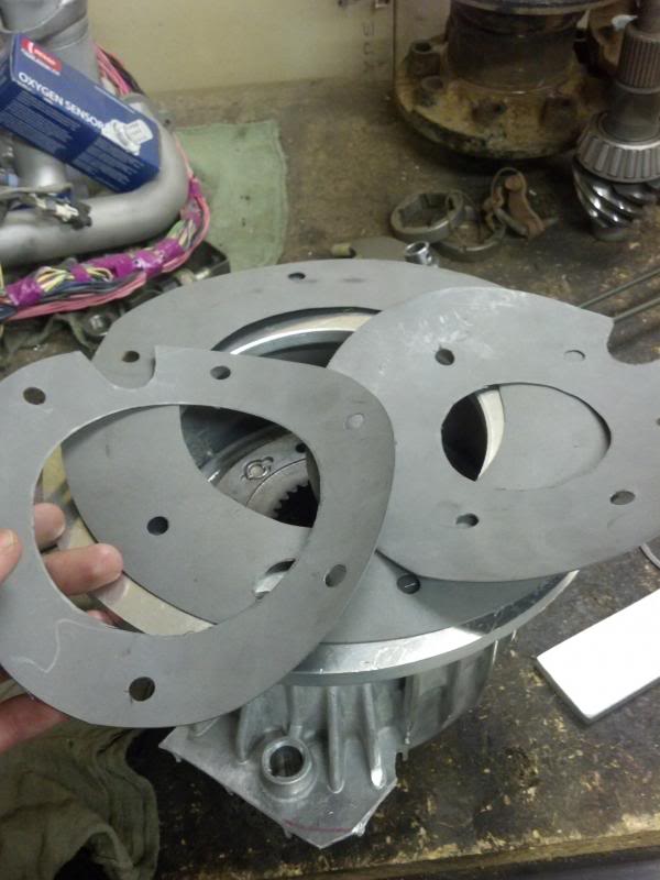

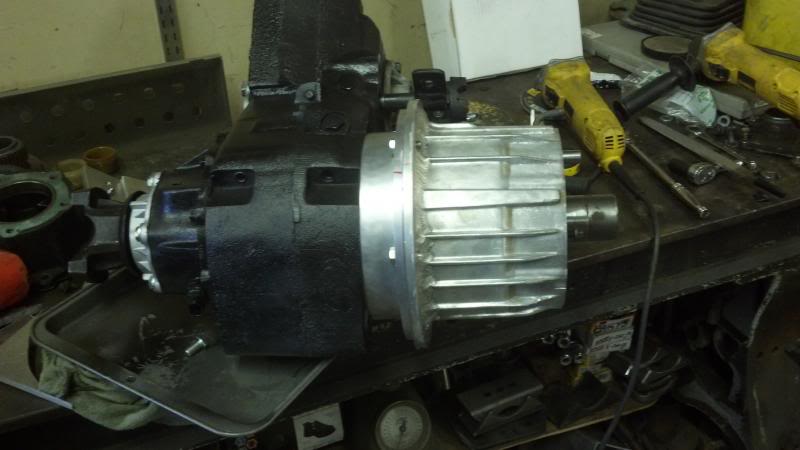

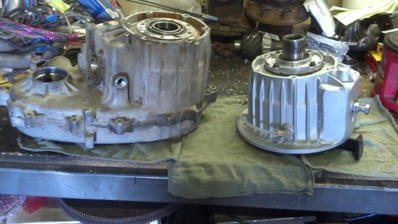

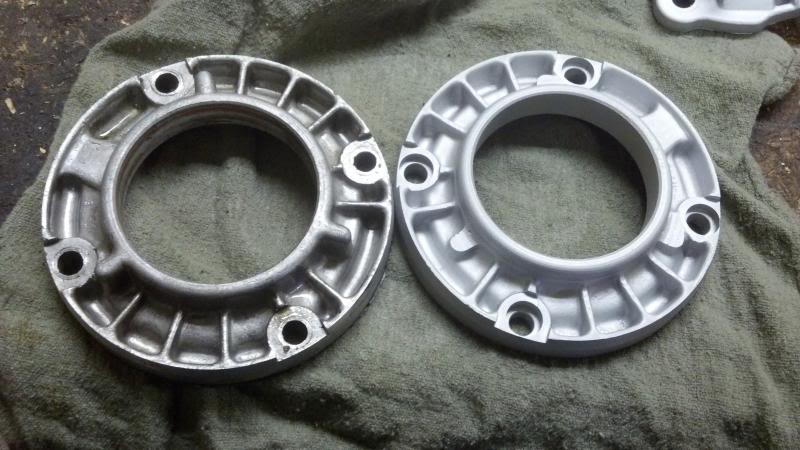

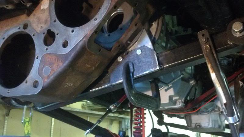

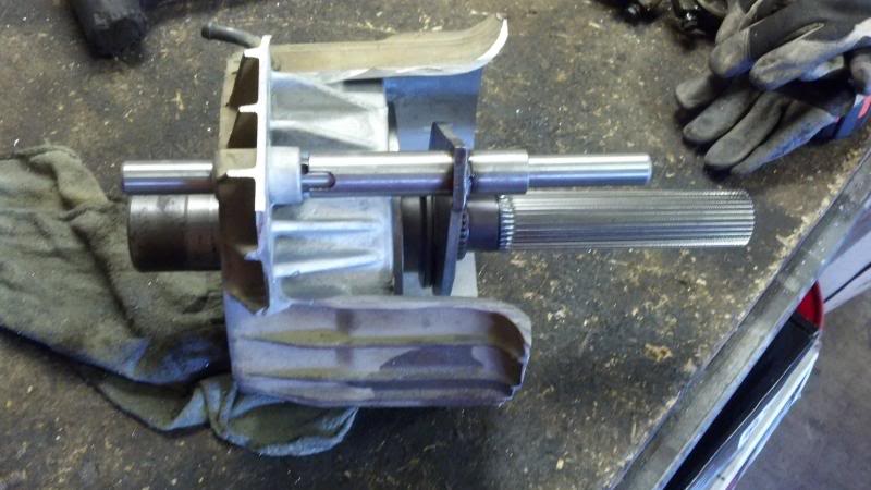

I pulled my transmission and transfercases because there were a couple oil leaks from them that were bothering me. While they are out, I rebuilt my doubler and made a new case for it that is slightly different and more simple. I made a new air shifter setup for the 241 crawl box and I ditched the cable shifters for np205 and went with air shifters on that as well. Each shift rail on the 205 has 2 air cylinders so I can still hit High, Nuetral, and Low. Now I will just have 3 toggle switches inside for my triple sticks . (Don't mind the mess of air lines. That was just set up for testing purposes.)

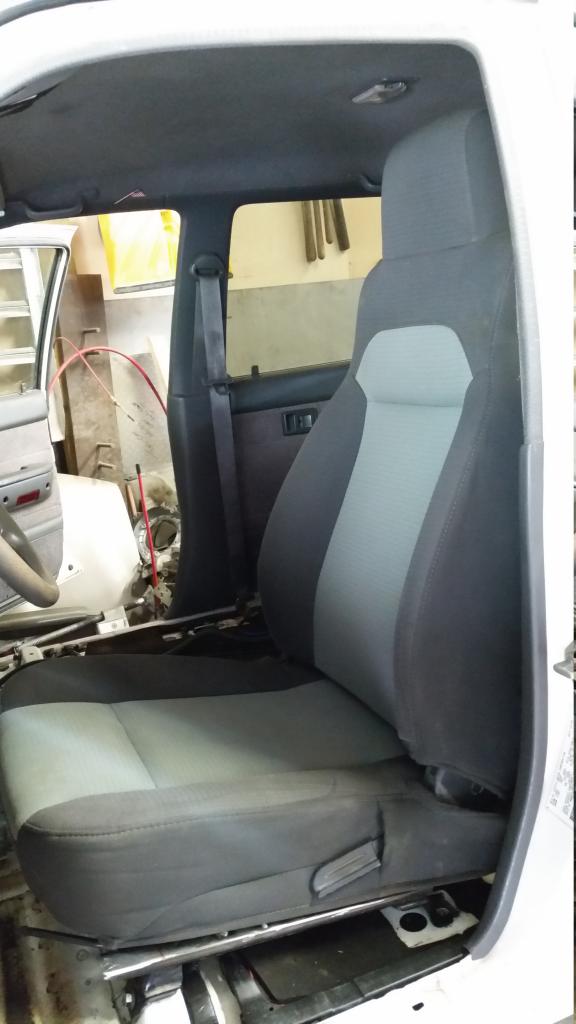

Also while I have the 4runner in the shop, I am putting in new carpet as well as new seats up front.

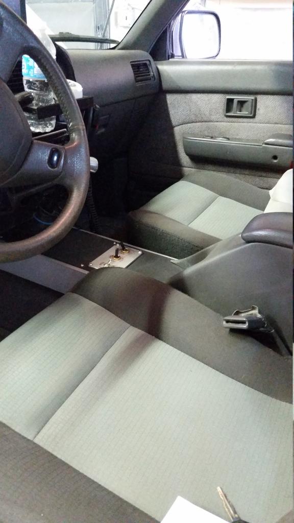

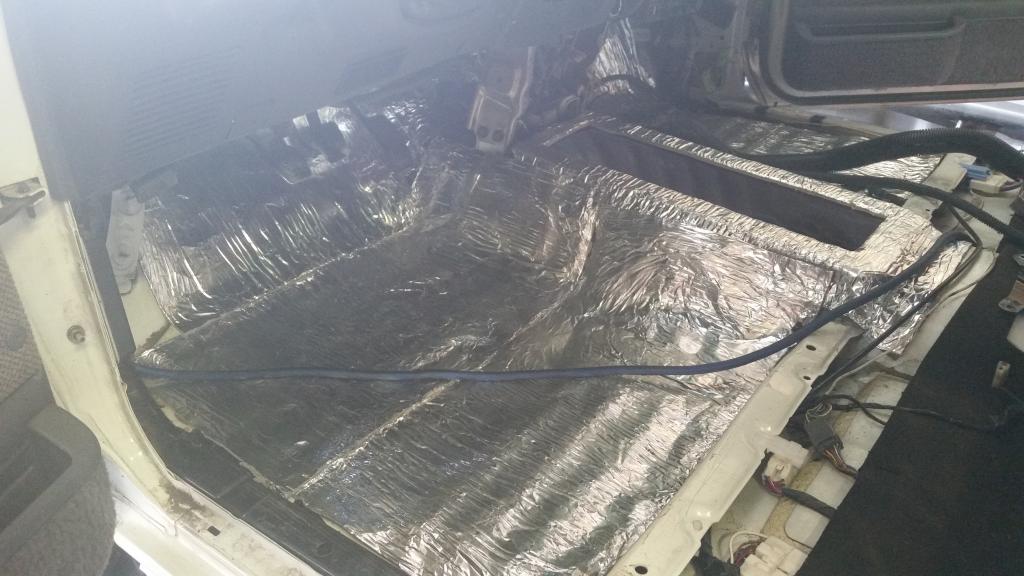

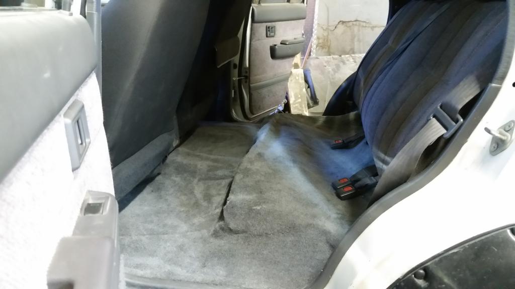

I got some heat/sound insulation put down on the floor up front as well my new carpet and seats. Not much for hardcore tech but I like having a nice looking interior for my daily driver.

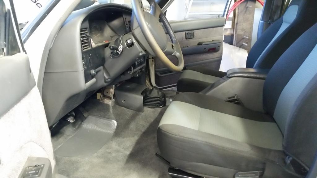

Here are some pictures after the carpet, seats and center console are finished.
