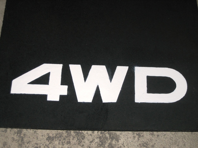

No, it was reasonable. I'm almost done fixing them and re-painting the "4WD" on the rears. I'll post a pic when I'm done.

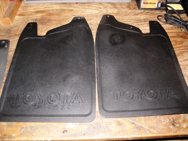

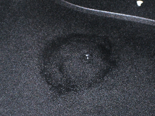

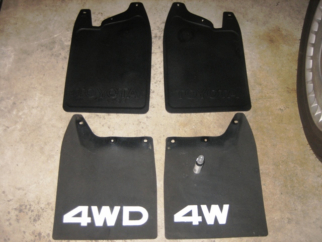

Here they are...came out pretty good I think.
Scrubbed them clean, small patch of fiberglass on the rear of the holes, a dab of FIPG to fill the hole a bit, then Rustoleum Bed Liner to try and hide it more. I think it will fade out fine.

Wow they look brand new

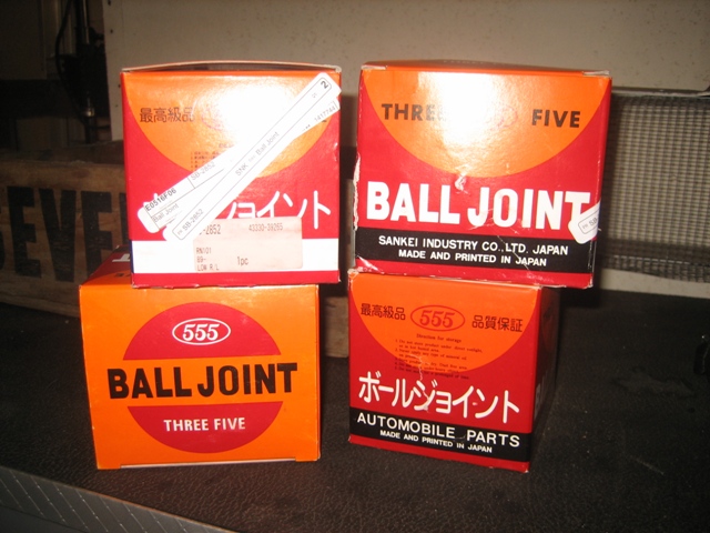

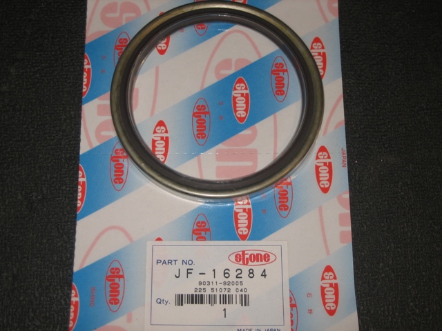

On another note, I went and ordered a full set of upper and lower Sankei 555 ball joints. The cheapest I found were on Amazon w/free shipping and they had a $50 instant credit if I got one of their credit cards that gives you 3x points when you use it at Amazon. I'm one of those guys that pays the card off every month so they don't make any money off of me and am a regular amazon customer so it was well worth it. So I got all 4 for around $175.
I now have a brand new still in boxes full set of upper and lower Moog ball joints for sale. Two were made in Japan, but don't have 555 stamped on them and the other two were made in the USA. If you're interested let me know, I think they would make great spares to have on hand for the trail!

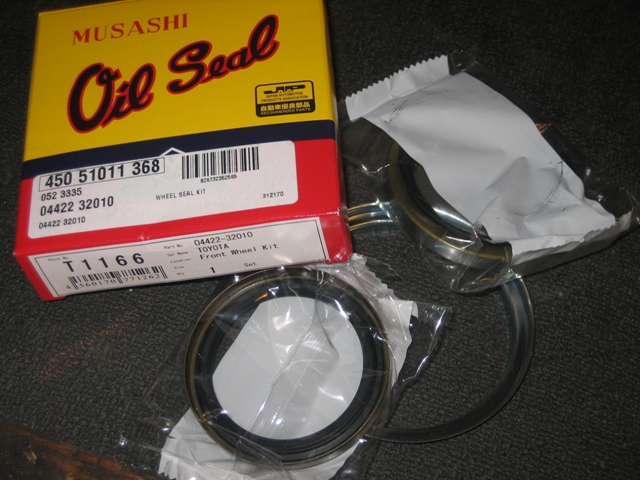

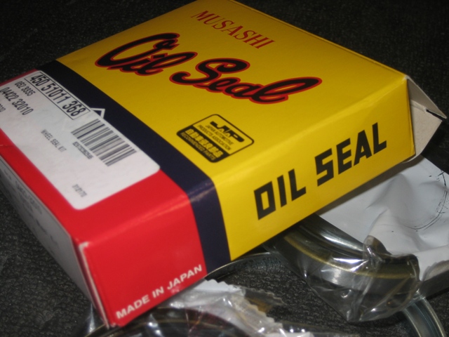

Also, to let you in on some good info and just as an FYI in case you didn't know. When I was in Japan I saw some gas station/repair shops with "Musashi" parts boxes. Didn't know about that company so looked them up and asked a friend to ask another friend about them and found out they are an OEM seal supplier. These wheel hub seal kits for my Camry cost half of what the cheapest online toyota dealer sells the same kits for. They even have the toyota part no. on them.
And I also found out at the same time that Stone is also an OEM supplier, they are a branch of Ishino gaskets. This rear main was also significantly cheaper than toyota and they also have the toyota part no. on them.
So save some money without sacrificing quality....In my book, Musashi and Stone have joined the ranks of Ishino, NOK, Aisin/Advics, Denso, NGK, Tokiko (TKK), Tokico, Koyo, Nachi, Bando, Sankei, Taiho, NPR, etc....as good manufacturers/oem suppliers.

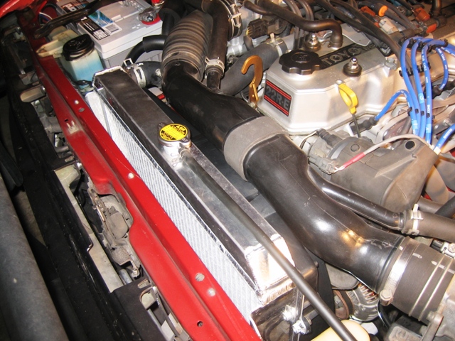

On Monday I took a short drive in the truck and parked it in the driveway. My neighbor tells me there's "red stuff" under my truck. Crap....leak in the seam at the bottom. I had this original radiator welded up twice so far to fix little leaks. This time I said it was time for a new one.
Decided to go with an all aluminum from ebay and received it today. Read a few threads from a few years ago where other guys purchased the same one and seemed to be ok, but someone had a leak and had to warranty it. Seller has been around since 2007 and sold over 8,000 items with a 99.8% positive rating.....so I went for it. Uyunira is the seller.
So far so good...nice and shiny!

Man, talk about a clean engine bay! new radiator looks great
