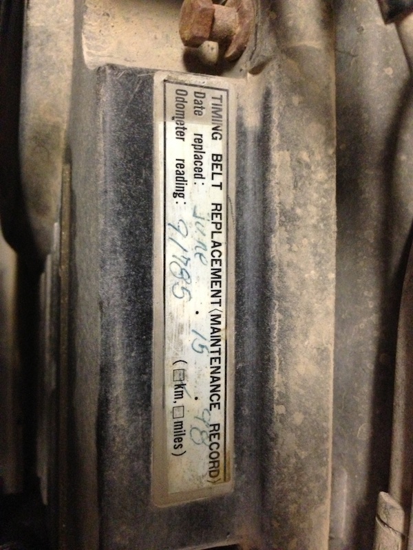

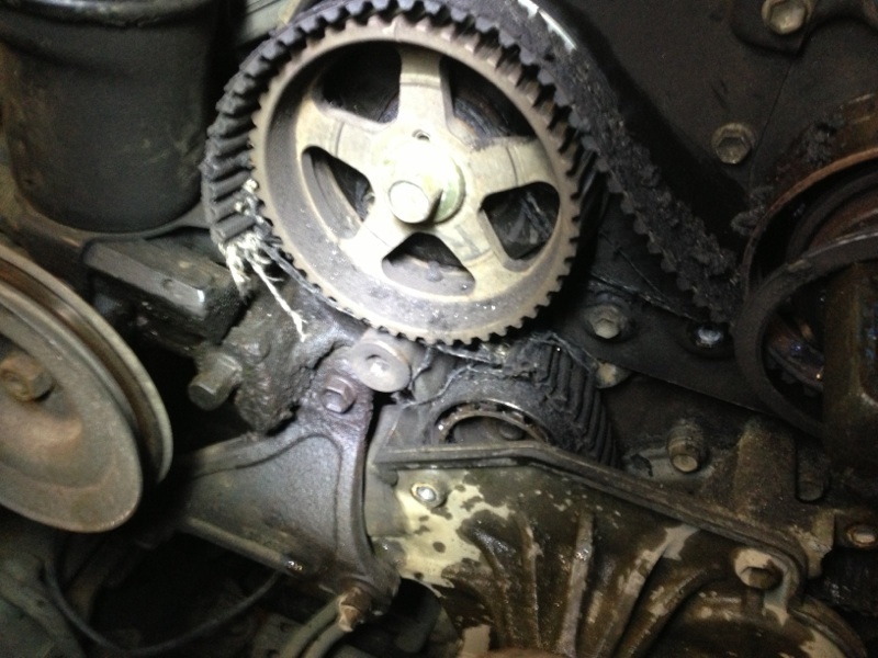

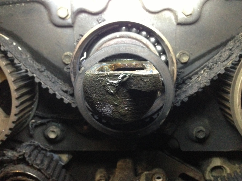

Hello everyone,
Truck has been out of comission since dec 1st. I was cruising along doing 80km when i heard a squealing noise, so i let off the throttle (noise went away) and then slowly brought it back up and started to squeal until sundenly she died. After popping the hood first thing i saw was smoke from behind the timing cover. So i can only assume the whining i heard this summer was my water pump and well.. I guess lead up to this.
So during my christmas holidays, starting now i will be removing the timing cover and anddressing whatever issues i find behind it. Timing cover was dated last changed 1997 i believe at 98xxx km. the truck now has 202xxxkm so i think its safe to say the belt has been well used.
Any tips or advice would be appreciated

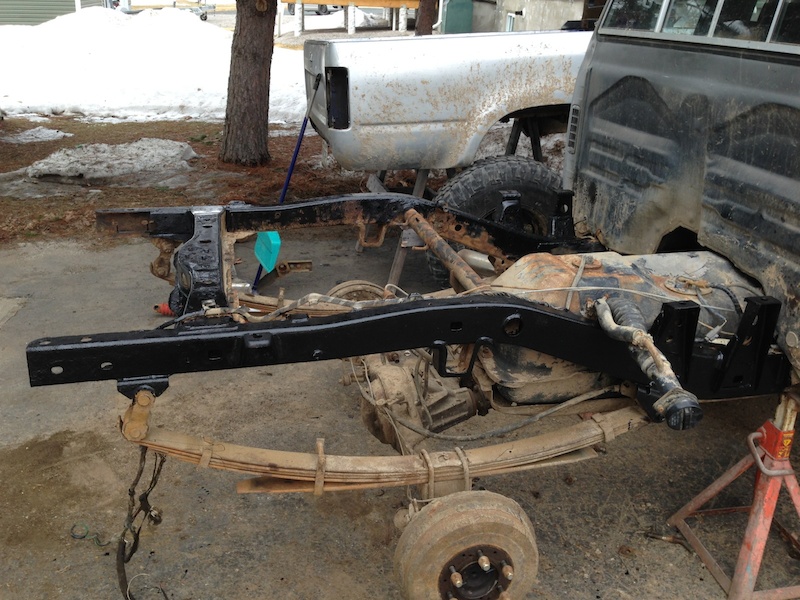

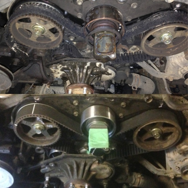

well got it all figured out and shes up and running again. ended up puncturing the rad while removing the crank pulley so had to chase that for a bit after she was rebuilt... but anyways heres the carnage:

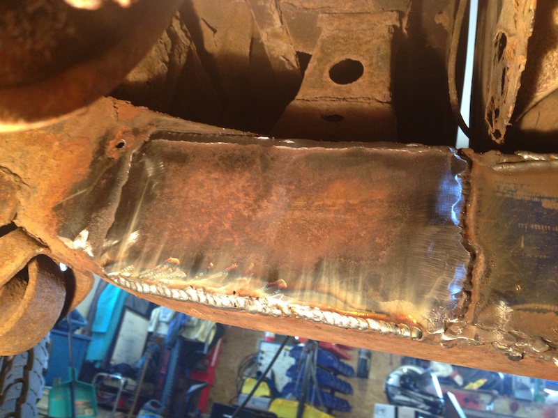

also repaired the hole/crack in the frame, no photos of the final repair at the moment. tie rod ends next, been welded together for a few hundred km too many

Hello to all been a little bit since ive been on the web but here we go with some updates,

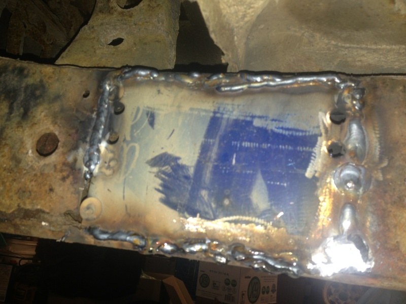

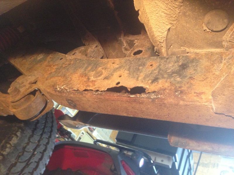

so finally got some photos from the welded area of the frame.
this is the initial hole we started off with:
my attempt... been a while since i been on the welder..
and later on what my buddy put in place to repair it all much happier with his welds on there. also the area was painted after this photo

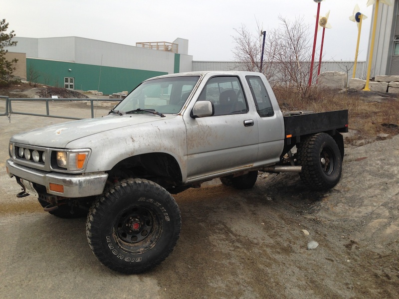

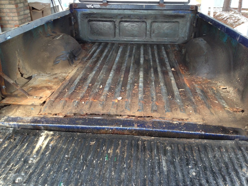

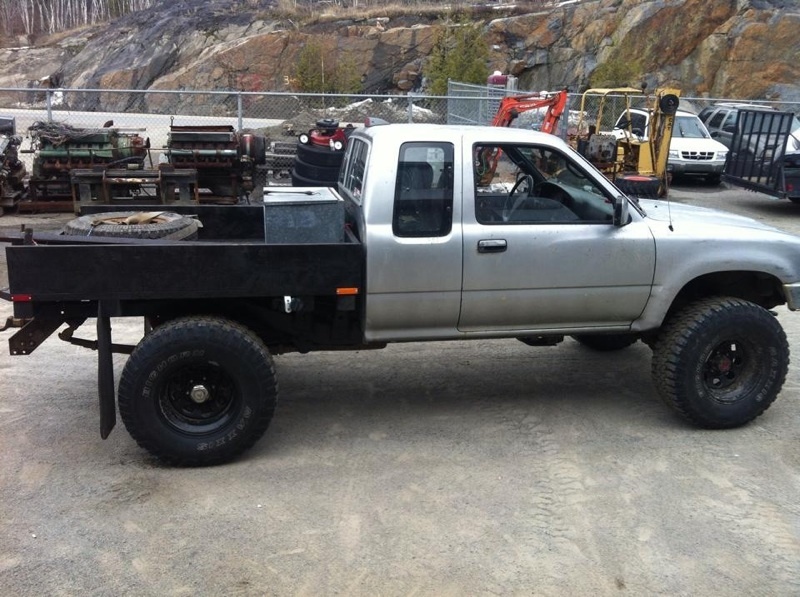

the flatbed update
so... the old box was shot. and disgustingly coated in grease and oil among other things.
the solution was simple, scrounge what i could for wood and flatbed. heres the outcome of the under 100$ investment
still need to clearance the deck in some places to allow full flex but shes a work in progress. Overall very happy with the outcome and the bed is functional again. Balljoints this weekend and shes ready for some summer wheeling

Flat bed looks really good!

Flatbed looks really nice. What did you use on your frame for undercoating. It looks really good too.

The frame was just painted with black tremclad and a brush, nothing special
