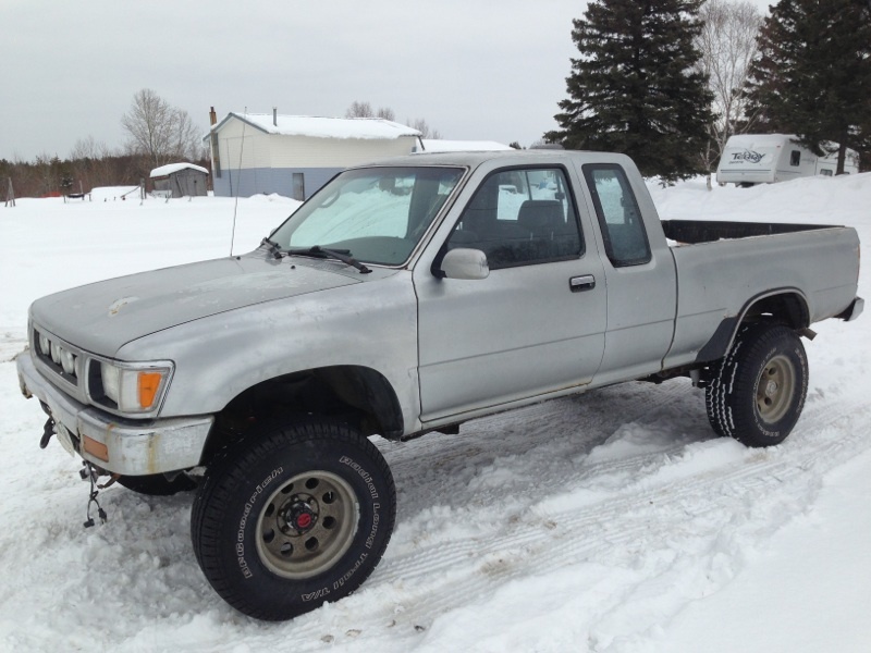

sorry for the photo delays, but here she is now after the bj spacers and rear block
Also i've been working on the fiberglass box, it turns out the underside (metal) is very rough, lots of rott. but its making progress day by day and i should have it painted and installed before spring

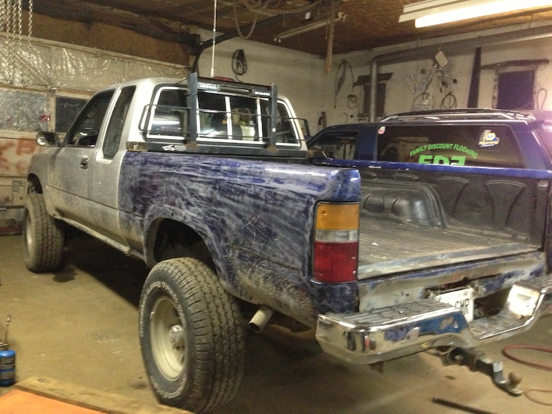

got this backrack for free

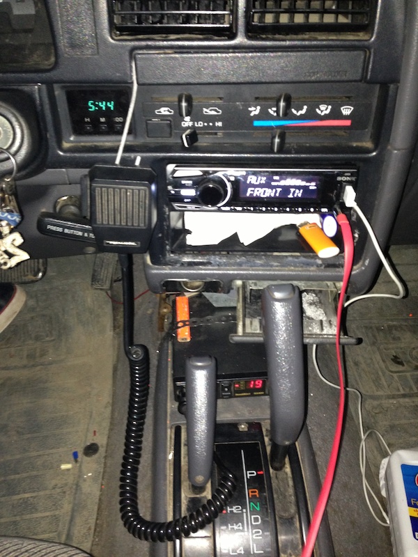

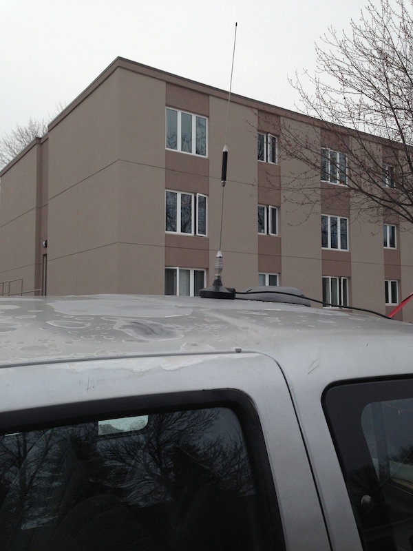

installed my CB

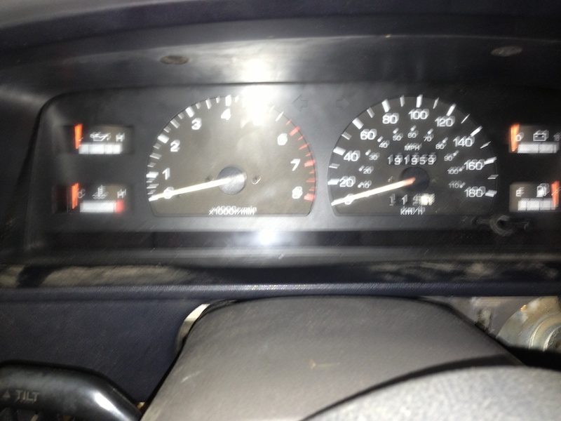

so most recent upgrade is the SR5 gauge cluster, wich i matched the mileage to my old cluster. unfortunately my trip wont work
OLD
NEW

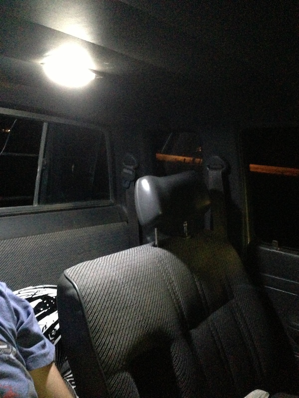

i also installed a very bright led dome light

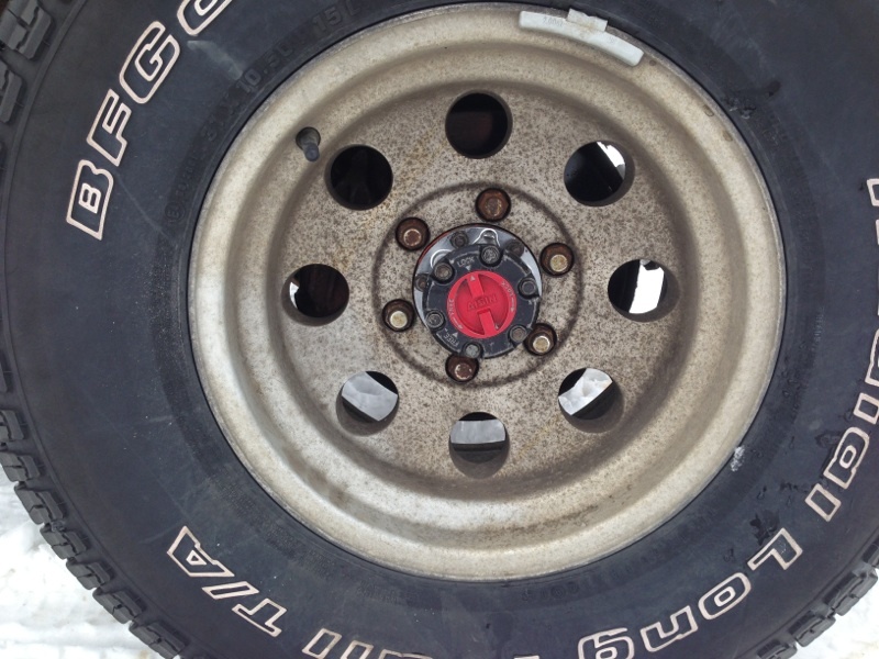

and i got around to painting my rims like i have been wanting to
all cleaned up
zinc primer
and here we go.... god i love how it looks now..

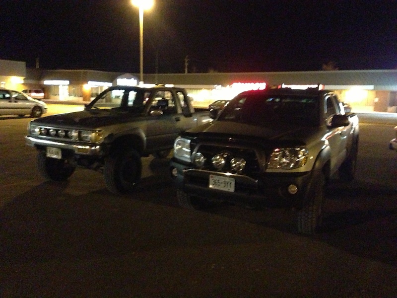

a friends 3.0 auto 33' no lift..
my first truck after i had installed unfunctional Ranger leafs.. shackle was against the frame...
and another friends new truck (i have no info on this one)

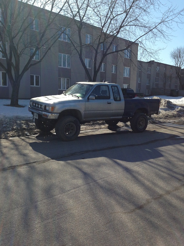

well, no luck finding tires guess im stuck on 31's until i can find a set or afford new. time to start on the bumpers

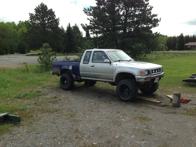

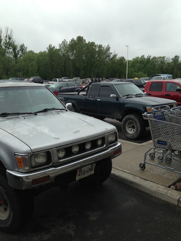

well some good news! painted the box finally and found a set of 305/70/16r maxxis Bighorns for 200$ ordering new rims probably pro comp 16x10 with 4" backspace
and a hill i tried to climb.. couldn't get traction with the long trails :/
anyways, bumpers are slowly being fabbed in my spare time. more update soon

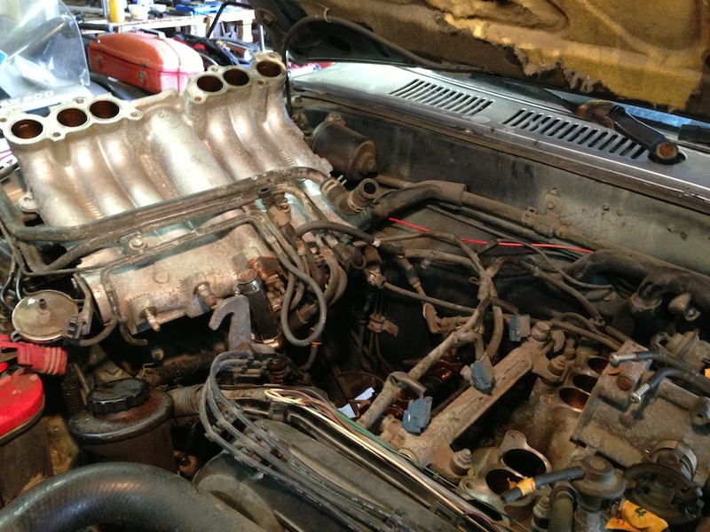

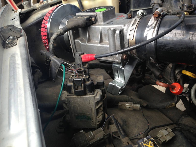

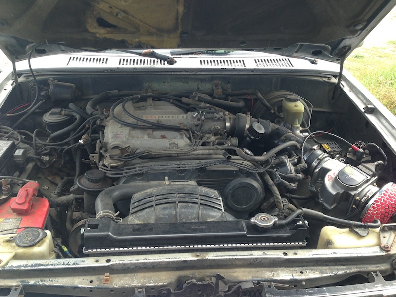

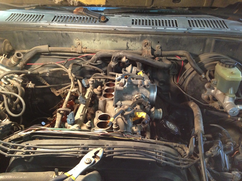

well here it is... 7mge vafm swap
cost me around 120$ and about an hour of tuning and testing
may not be a pretty looking setup but it is functional. this truck is now racekar.

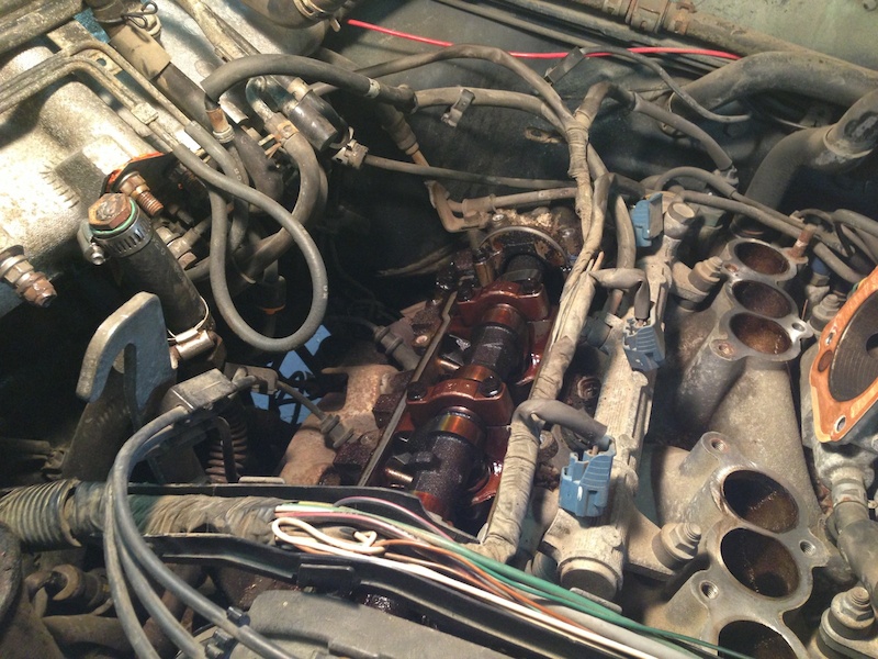

was also forced to change the valve cover gaskets this weekend, just leaking too much oil onto the exhaust manifolds. i was very intimidated to do this job at first but i took my time. could have been done sooner if my friend didnt snap one of the valve cover bolts into the head, D'Oh. 1/4" bit and a nut and bolt and we were back in action.
hope everyone is enjoying their summer! happy trails

Sweet AFM install. The 7mge afm swap is something I've really wanted to do, but I'm kinda afraid. I know nothing about tuning and timing.
Old Sep 1, 2013 | 05:10 PM
  #39
gilbert72's Avatar
Joined: Aug 2011
Posts: 81
From: blind river, ON
Originally Posted by 93Xtra-Cab
The truck looks sweet with those tires!
thanks a lot, I am pretty happy where shes at right now, but i have a lot planned for the future.
the afm was not all that difficult, I too was intimidated by tuning and timing and changing the mixture of the engine. but it is well worth the gains. 6 clicks left is what i ended up with on the fuel wheel ( although i had tried 5 clicks with no success. ) timing is at 15* or 16* and the by pass was screwed in roughly 2.5 turns. i adjusted it in until the truck began to idle rough and turned it out until it idled ok. Just remember to take note of your stock timing and keep your stock afm. switching it back if you have issues will be easy.
I strongly recommend this if you are looking for the best bang for their buck gain. my truck is much quicker now. could only imagine if i had a 5 speed... stupid auto..

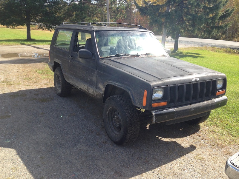

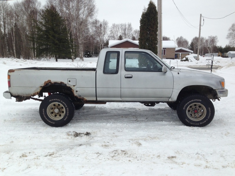

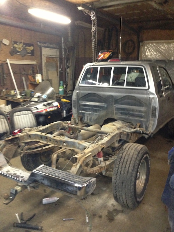

so here we go, bought this about a month back with some buddies for 250$
it's a 97 4.0l 5 speed with a welded rear. couldn't ask for more out of a beater vehicle.
now for some updates and goodies for my truck

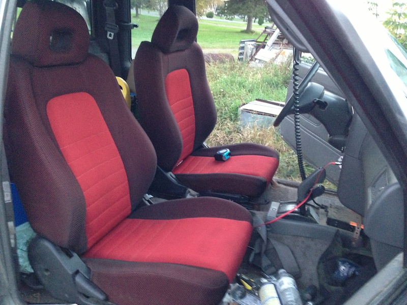

got these seats from my local yard 120$ for the pair.

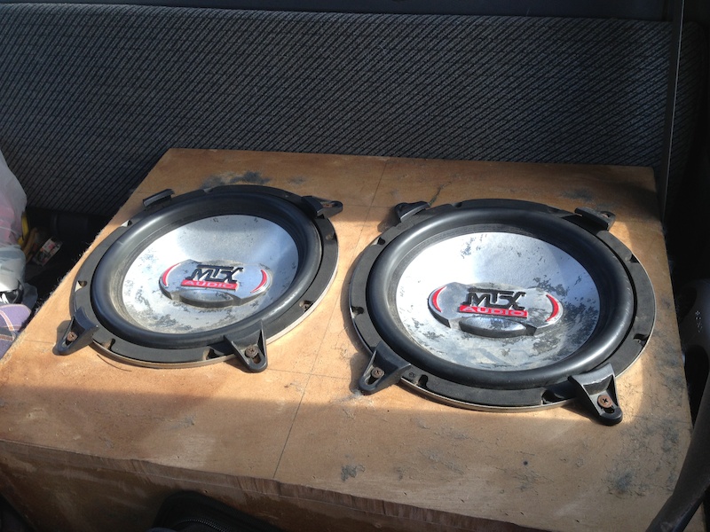

I also installed and modified the sub box from my 92 PU and was given these mtx jackhammer 10" and re-using the alpine 305 amp from the 92

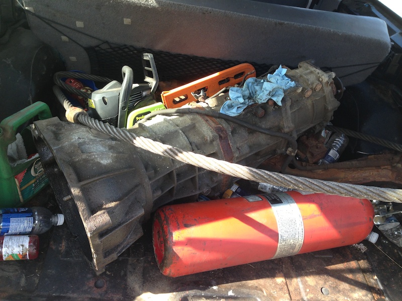

and my plans for this winter consist of... r150f and rebuilding my bed to be as functional and strong as possible.
i will be installing marlin HD shift seat aswell as new input seal and output seals, pilot bearing and release bearing. i have already sourced a new clutch wich i will be getting for free it's nice to know people.

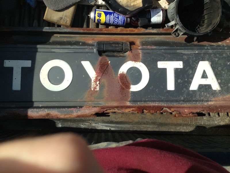

picked up this gate for my bed build this winter. I know shes rough but i plan on somehow integrating the stamped center section into either a custom gate or into my existing 3rd gen gate.
for the bed i will be building an inner structure out of 1" square tubing to assure it is rigid. with a 3/4" sheet of ply wood as the bed floor so that it can be replaced if need be. i will be bolting the fiberglass bed sides to the square tube inner frame so that i can have the best of both worlds IMO strong utility bed, yet still look normal on the outside. i plan to use stock tailights also.
if you have any comment or suggestions i would appreciate it!
