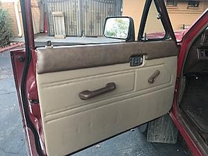

Sooooo, to keep some semblance of forward progress I moved to the interior. My 4Runner is a DLX model with the 3/4 door cards. They are in good shape, but the asshat PO put some sort of weird outdoor carpet additions that were tek screwed on. Plus the DS door is a replacement from a full door card SR5 that had a speaker cut out. Door cards on eBay are made of gold and bitcoin so I decided to make my own.
Here is the first one. It isn't perfect but not bad for a first stab. Details for the build can be found here.

Wow! Nice work on the door cards.
take it from somebody in the middle of a repaint, you could do it yourself with good results if you are patient and use quality materials.
and it’s less work if you don’t plan to change the color.

Thanks for the complement, I’m 1/2 way done on the PS door.
The only reason I don’t want to paint the 4Runner myself is time. I foresee it taking a full week or more if I devoted full time to it. In real world scheduling that becomes months. I still plan on doing it though, I just need a better place to work.

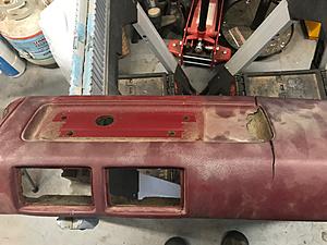

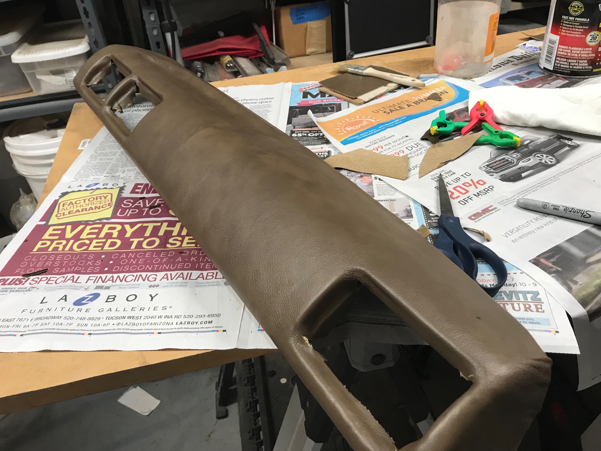

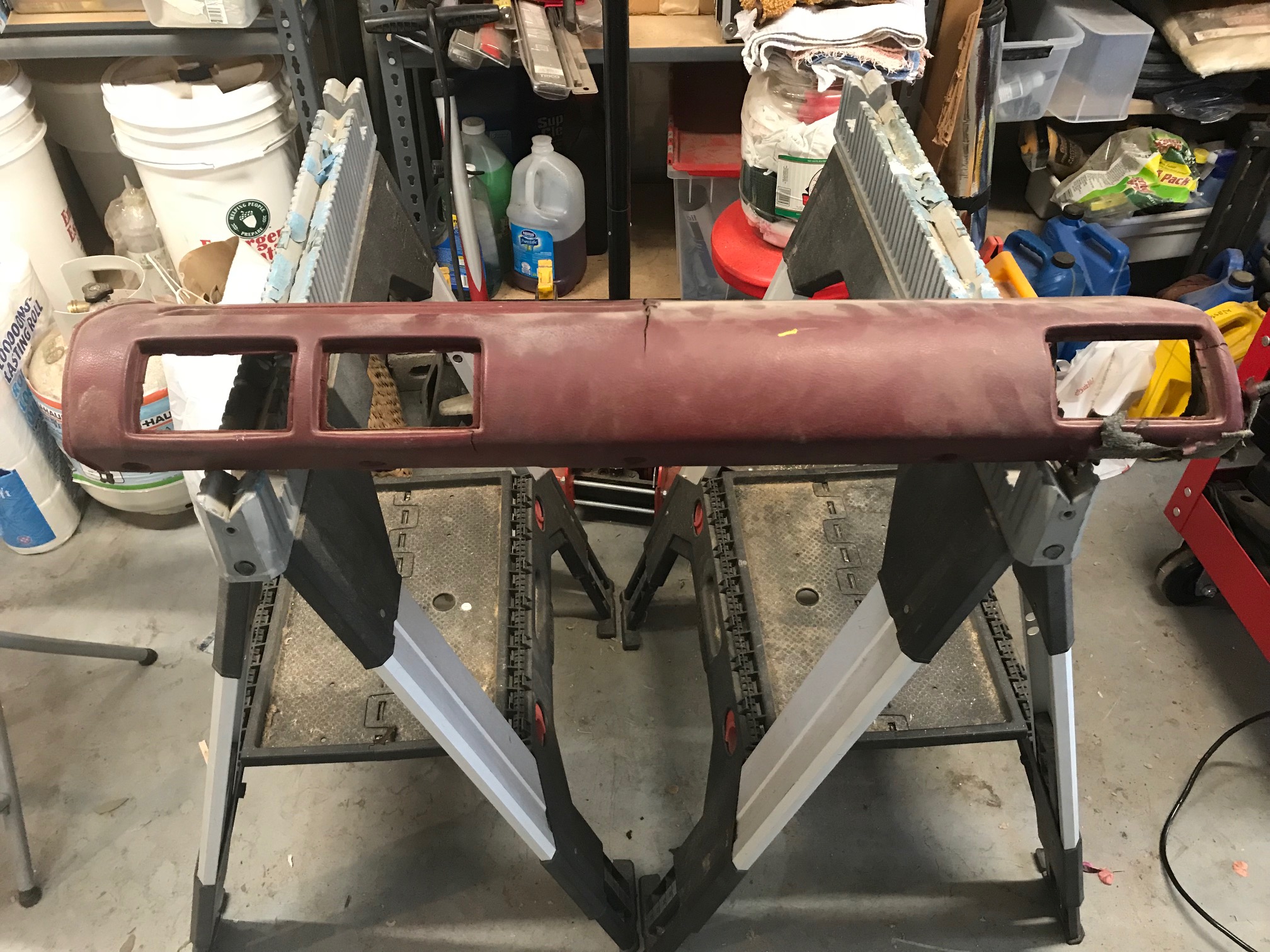

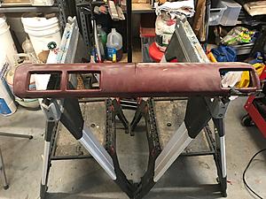

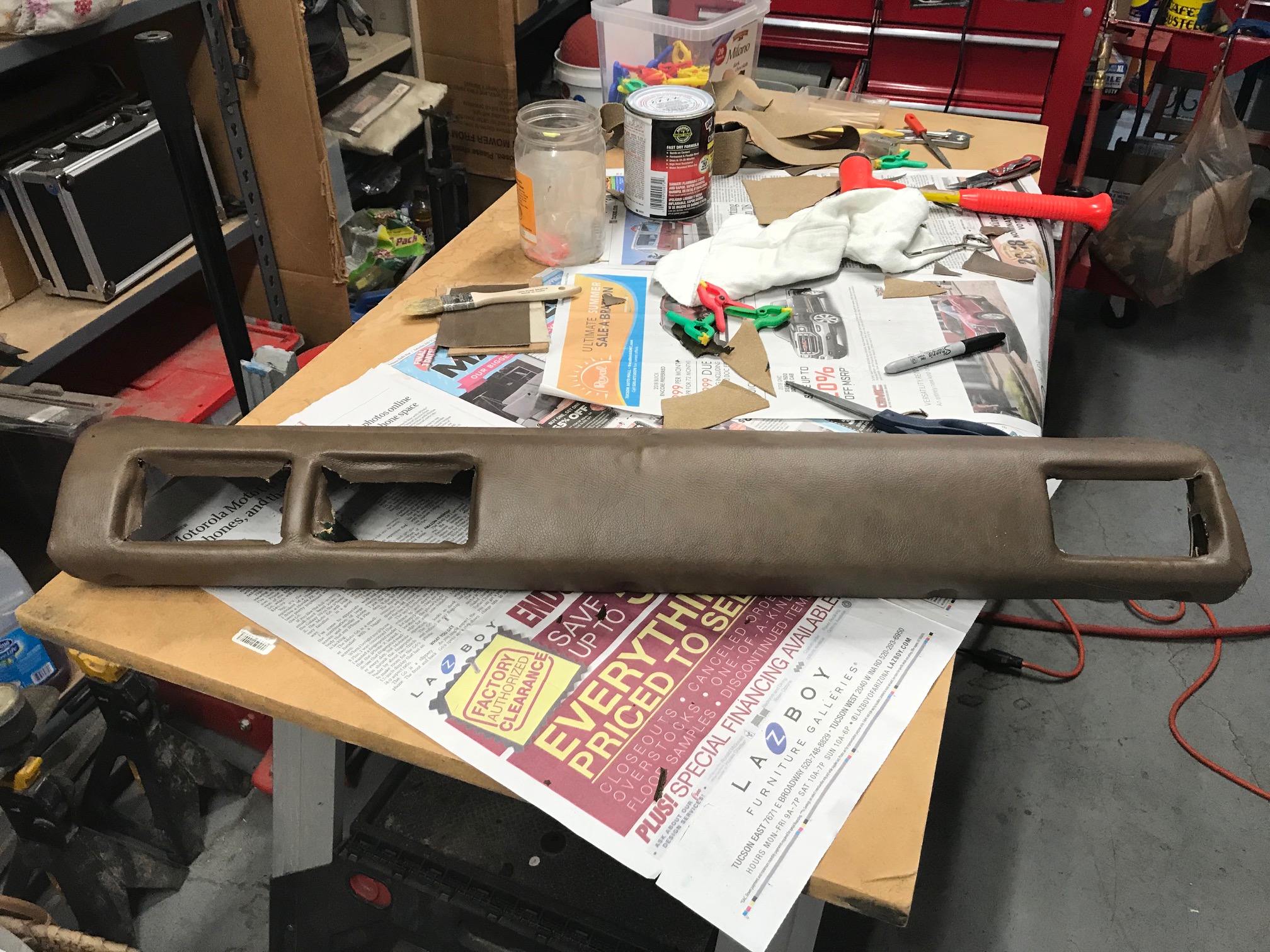

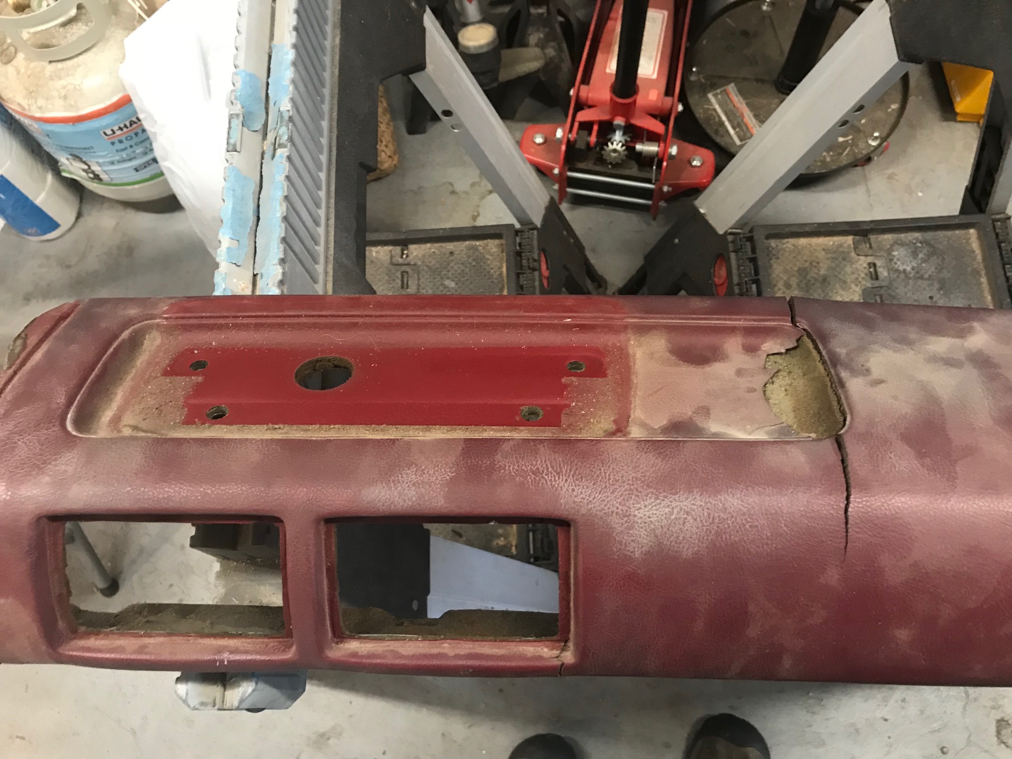

Attempt #1 at recovering the dash is done. I learned somethings and can do a better job. I don't know if I'll use what I have and try to camouflage my mistake or find another donor.
Here is what I started with and the results. Details can be found here.
Attached Thumbnails GeoRoss' 1986 4Runner Rehab-img_2471.jpg   GeoRoss' 1986 4Runner Rehab-img_2472.jpg   GeoRoss' 1986 4Runner Rehab-img_2484.jpg   GeoRoss' 1986 4Runner Rehab-img_2485.jpg

Not perfect but for a first attempt I'd say it looks pretty dang good! Better than I could do lol
Old Jul 25, 2018 | 12:04 PM
  #55
RAD4Runner's Avatar
Joined: Mar 2012
Posts: 7,125
Likes: 681
Looks good. That's how I plan to do mine as well. I'll be extra careful around the crack as learned from your experience.
