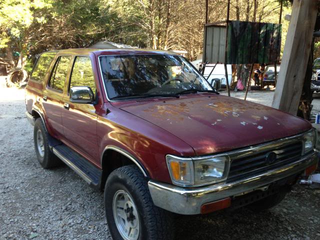

How I got it for $900 was the 4x4 would not engage and it would not rev up. If I stomped on the gas it'd choke out. Very doggy acceleration. Very choppy acceleration. I figured well its fuel or air so that ought to be fairly easy...I hope...Oh yah, 3VZE 6 cyl.
Rolled the dice and dropped the Bengy's.
Driving it home and everything works. Power windows work, sun roof, rear window, AC blows cold...freaking cruse control WORKS! I was ASTOUNDED! and quite pleased. I think I did well.
The Previous owner had a shop tune it up, cap rotor plugs wires air filter due to the choppy acceleration, no power... etc...
Drove it home babying it...and got it in the yard. Used the diagnosis port and it was throwing (I thin they were) codes 1 3 and 2 4 which were the air temp sensor in the VAF (Internal VAF component) and a VAF sending code error. so AH HA!
I checked all the stupid stuff like plug firing order, threw in a fuel filter for good measure and such anyway...Oh and it had a mess of Vacuum leaks I tracked down... but...the problem persisted...

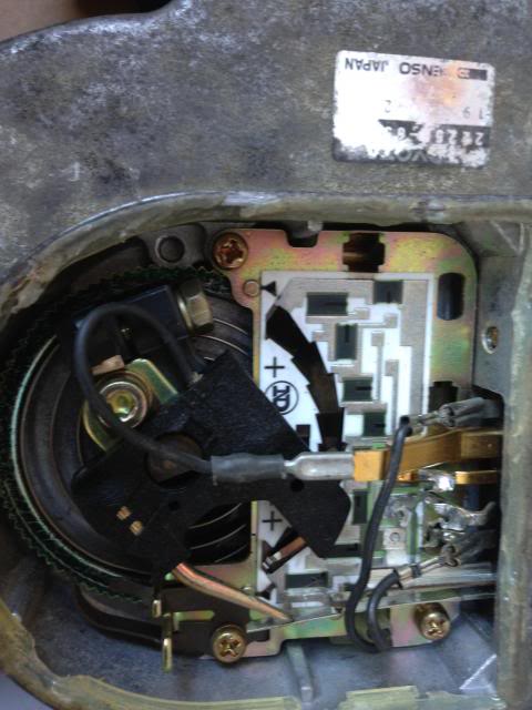

The VAF was fubared the connections had come off the circuit board. Here is an internal pic of the Vain (Vane?) Air Flow or as some call it the Mass air flow sensor.
You can see on the right side it the little circut board deals are toast where they were tacked to the circuit board. No idea how that would happen except I guess perhaps heat?...I'd love an explanation...I Dont know and can not formulate a educated guess. I could not find a internal pic of the Vane Air Flow Meter or the Mass Air Flow Meter for a 3VZE so I hope this helps someone...
After one look at this (with the codes I did not bother to pull out the multi meter) I knew the truck was starving so...I ordered one from O-rileys and that was the total of the day yesterday (I got it yesterday) around 9:30 then it was Miller Time...
So this morning I got into the 4x4 as the Vane Vain Air Flow thingamagig was not due in till 12:30...the guy said he had a new motor put in about 6 years ago and after that the 4x4 did not work and has not since. (Motor has 80k he says he seemed legit so I believe him. He had a ticket from some shop for it...) So I'm thinking that the vacuum is just not right to the front dif. (THANK YOU YOTA TECH!!!) Either a bad line or blocked or such...(I had dropped in to Low and Neutral and that worked so I knew the T case and linkage was probably good to go.
Pulled the check valve and tested it. worked fine. Installed it the correct direction (was backwards LOL) then switched the 2 lines (were backward) and VIOLA! 4x4 works. On and off. Internal Dash light works now. Good to go. Got lucky right there...
Went to get the VAF and installed it after a fine lunch, a visit to the beer store and the post office...Cranked her up and Boom. Good to go. Vroom Vroom good RPMS no hesitation and no dogging out.

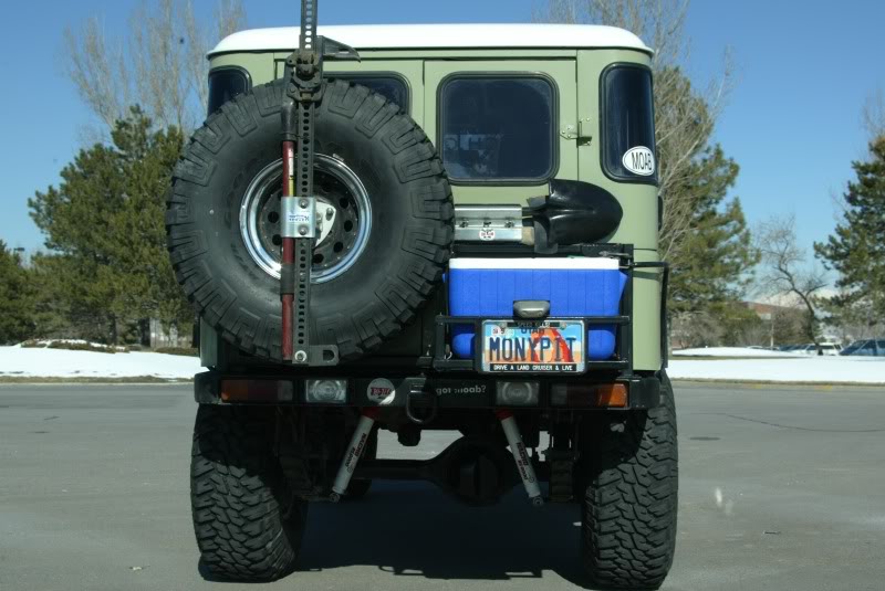

Here is the begining thoughts on the rear tire holder/tool holder...
I like storage spot with cooler on there. I'm thinking double swing rear tire holder. With multi use. You could haul gas water or a cooler depending on if I was going bird hunting with the dogs or just out to girdle some trees for the saw mill. I think my farm jack is going inside. I've seen what outside storage does to these things.
Hope the link works, looks funky in this box.
This is just a pic I found on the internet to get my head going in the right direction for my tube rear bumper and tire holder...
