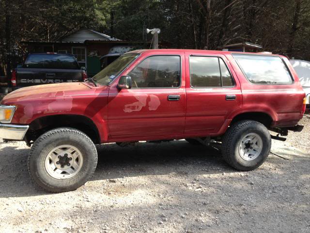

As requested, here is the 4runner with all the crap/rust making trim removed...

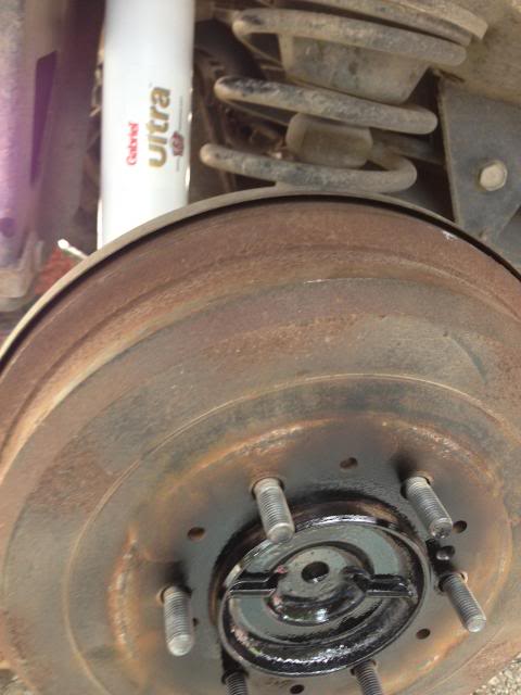

I squeezed in the rear shocks today. I went with Gabriel Ultra's. About $40 each. Same as the front but obviously of a different mount configuration. Still have a slight height difference from tire to fender on the passenger side rear, but I guess I will attribute that to either the gas tank, or to the fact the rear right shock was shot and I have spring fatigue.

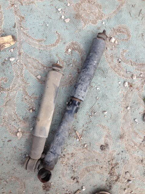

As stated the one thing here is different that the other. They are if not stock, I'd say they have been on there for a LOOOOONNNNG time. Drastic ride improvement.

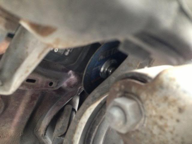

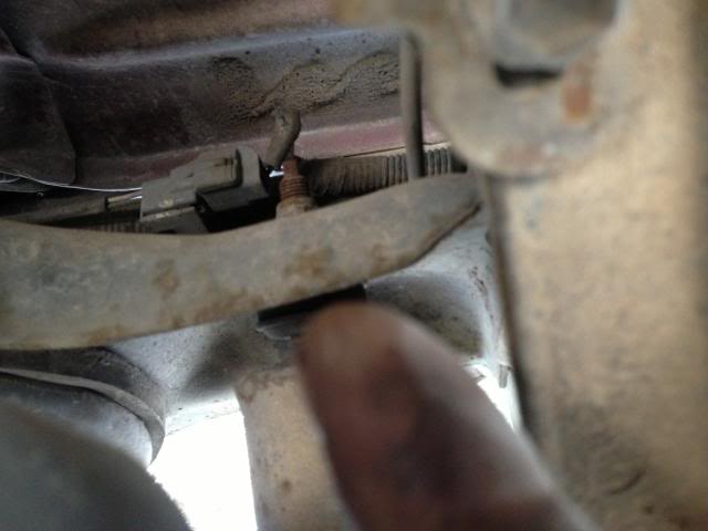

I would rate the SUCK factor of doing the rear shocks somewhere between a root canal and going to an ex NBA player gone proctologist... The drivers side was a pain until I did the pass side which was a REAL pain. I found the easiest way to remove (in fact the only way I was getting them out) was to cut the top nut off with an angle grinder. >NOTE!< if you use the same way to remove them, use EXTREME caution on the passenger side as it is surrounded by electrical wires and break lines. I had some one plug the grinder in after I turned it on and had it in place because there is so little room to get to it I could not even switch the grinder on. Top nun was a 14mm.
As I said, very little space, break lines and electrical lines and the 14mm nut was rusted in place.
insert angle grinder as so...

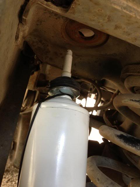

I found it easiest to mount the bottom bolt with the retainer still on the rear shock then line it up to the top hole with the bottom washer and grommet in place, then cut the retainer and guide it into the hole...

I found the entire job was left handed...meaning I had to use my left hand for everything. On the drivers side, because of clearance and angle, and on the passenger side I had to lay kind of on my stomach and side so my arm would bend in a manner as to reach the top nut on the shock.
