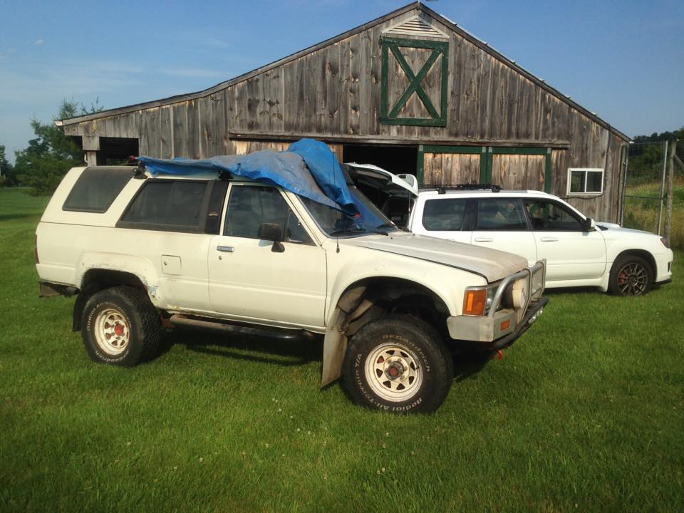

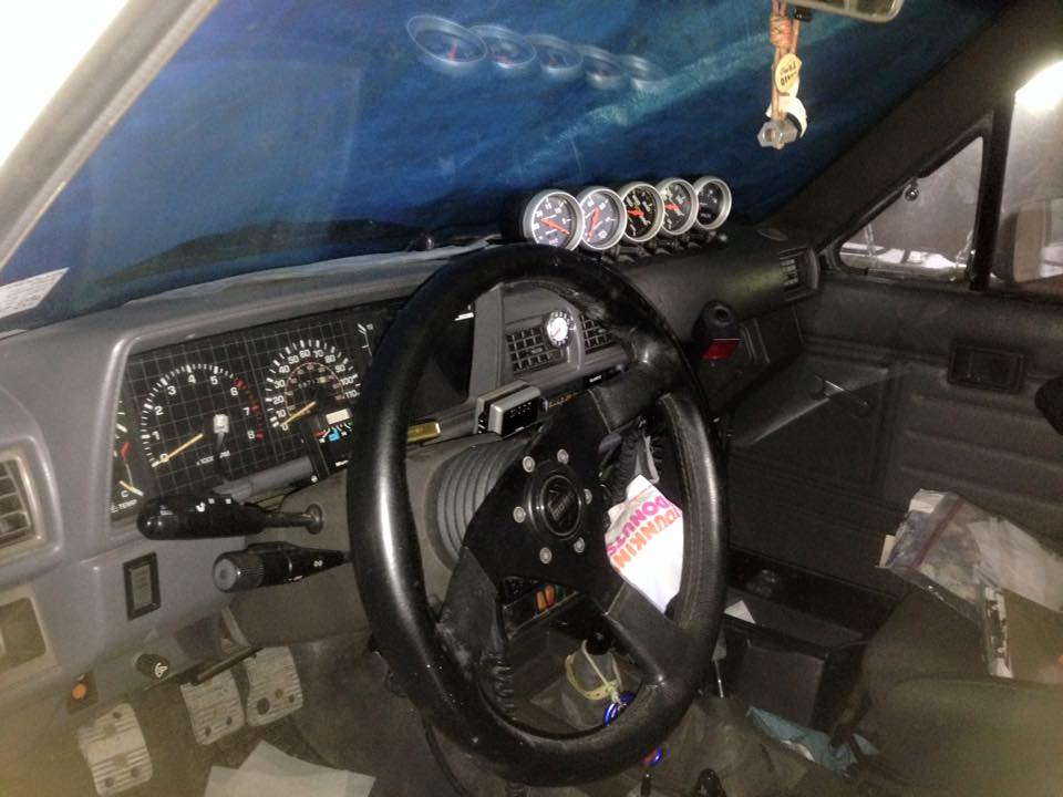

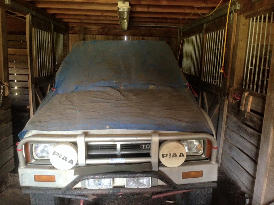

Truck has been in storage for several years.....
Going to get the truck rolling for weekend / occasional use
Attached Thumbnails Ed's getting the 4Runner back on the road-4runner-post-barn.jpg   Ed's getting the 4Runner back on the road-inside-cargo-area.jpg   Ed's getting the 4Runner back on the road-sleeping-4runner.jpg   Ed's getting the 4Runner back on the road-inside-4runner.jpg

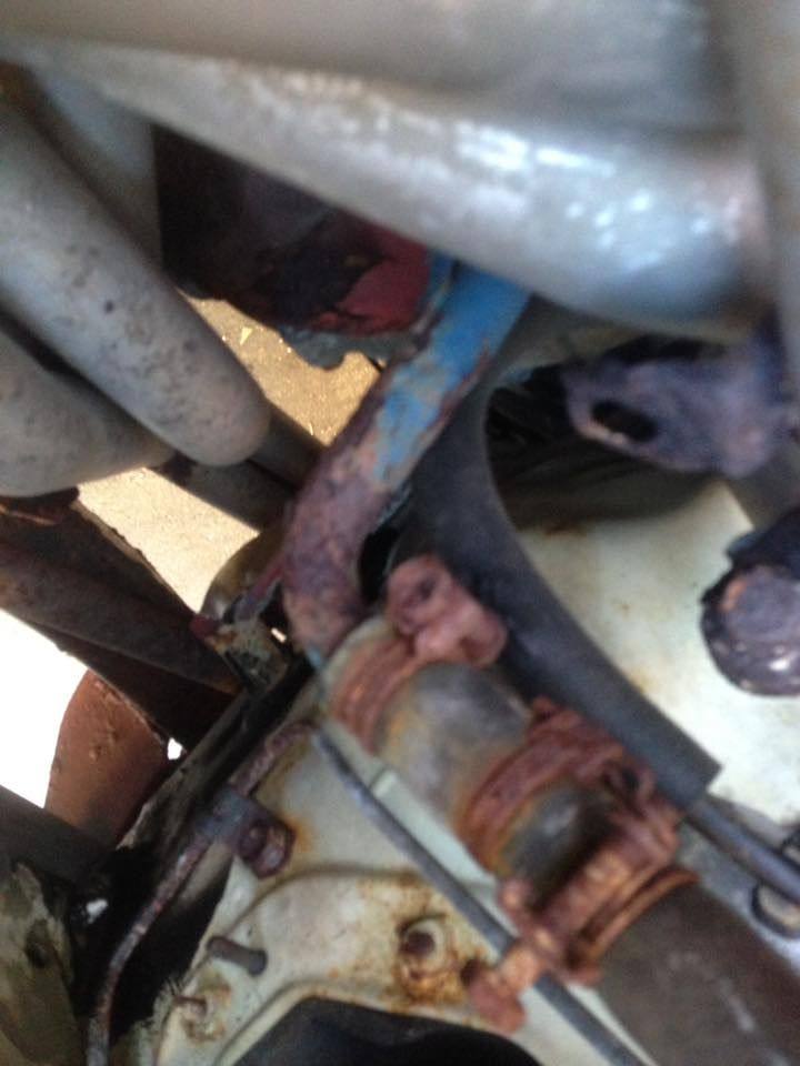

Called 22RE Performance for parts....
Ordered:
The hard line water pipe that goes under the header. - mine is rusted bad.
Some other heater hoses
the AC idler pulley
the PS tension pulley bearing
other misc parts (brake bleeder caps)
I need to rotate the pic
It shows how rusted the #2 pipe is

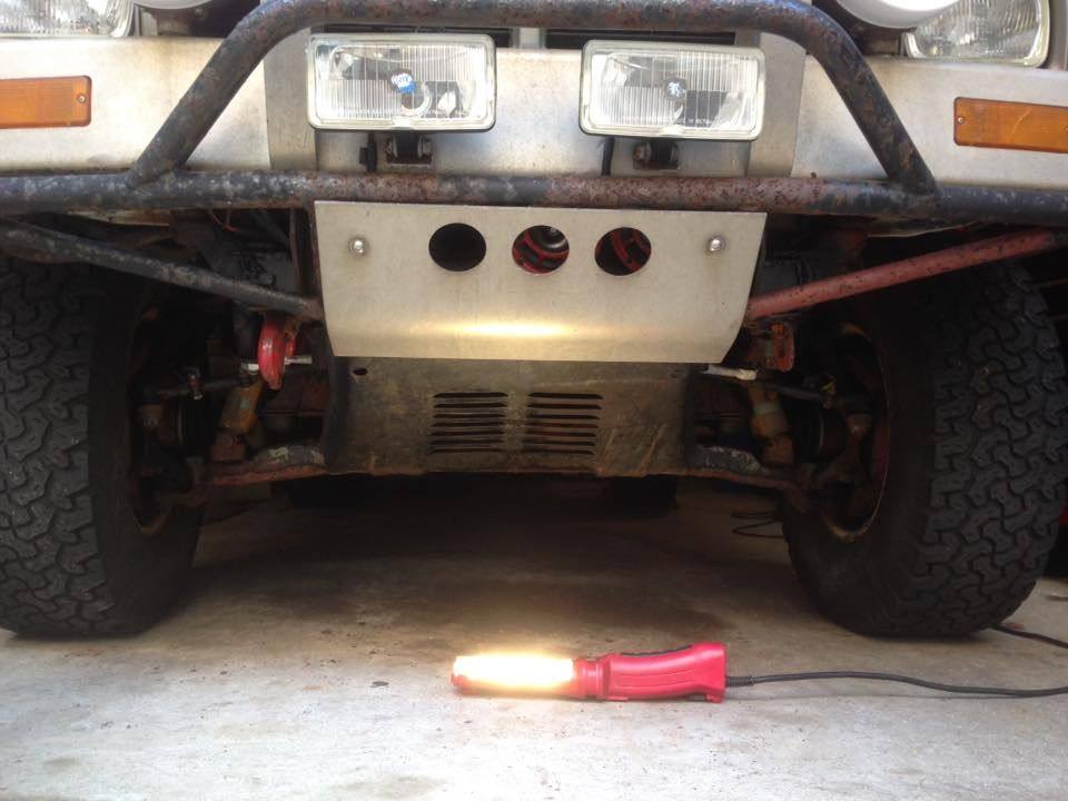

I cut down the former Downey IFS Skid plate.
The bar originally had 2 stringers running down to the lower A Arm front crossmember. It basically rusted apart.
I re- installed the stock splash shield and then cut the Downey skid plate so it sort of looks like a Pre Runner bash plate.
BTW - since the way that bar is mounted relies on two welds - that black bar is more for decoration than any real "protection"
Those rectangular Hella 550 sized lights are actually the much misunderstood Hella XL low beam fill in lights.
IMHO they are better than "fogs" as they run a tad higher.
Those massive PIAA 80 series racing H4 (yes - dual beam) lights are amazing.
Im running them with "ion" yellow bulbs. They are THE light to have in a blizzard headed up the highway.
Modified Downey Skid Plate
small garage

attempted to fix the water pipe
The LAST time I did this - I recall it was really easy
Then again, the last time I did this, I was replacing the Cyl head.
Its really easy when everything is apart!
The OEM hose had this oddball "middle section" thing.
The newer formed hose, does NOT.
BUT
The newer hose now has a bend in it...
Got to use the Harbor Freight arbor press
Broken Alt Bracket...second time
BUT
After market HiPo 140A Wrangler alternator
Cylinder Head markings
JM for Jess Miller Machine Shop of West Chester PA (now run by his sons)
009 shaved off (two passes)
New formed hose has a bend in it. No longer needs the funky insert metal thing
Got to use the crow foot
But the bolt hit the pulley
That was NOT the way to take it apart

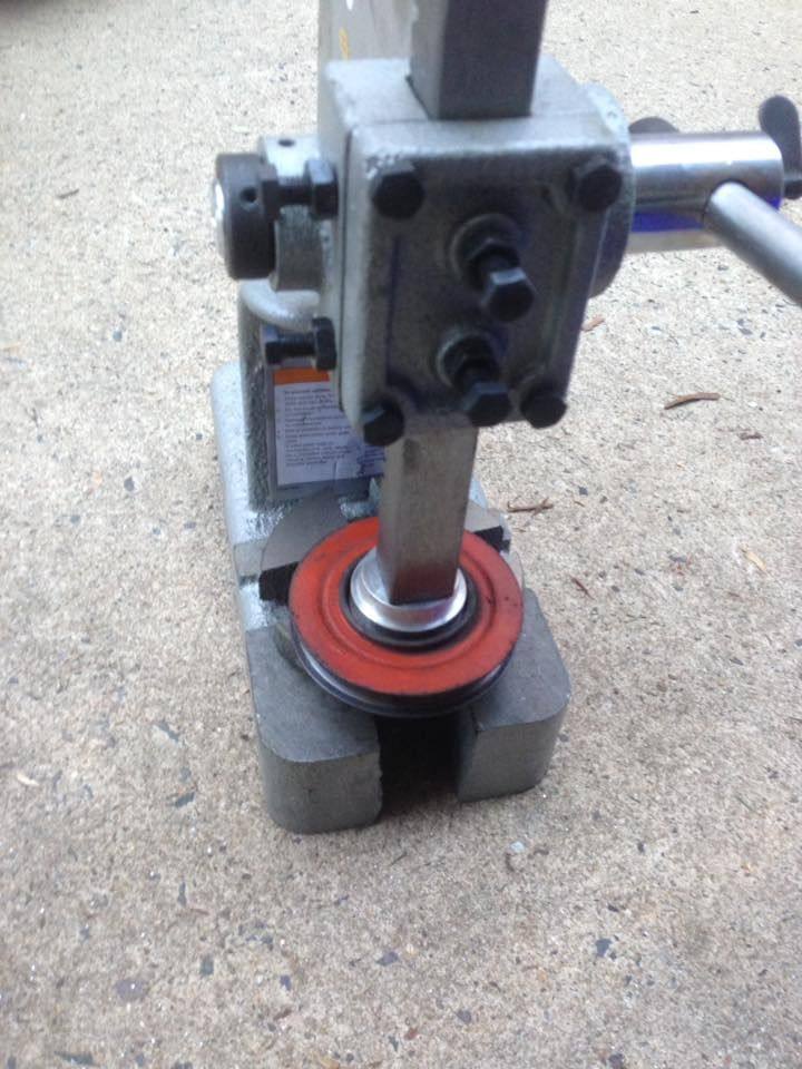

I put in a new PS adjuster pulley bearing.
The other one was making noise, then I soaked it it oil and it quieted down.
But at 360K, I think it deserves to be retired.
The AC adjuster pulley will be replaced as well
I just haven't gotten to that yet

New PS idler bearing and new AC idler bearing.
WOW - the engine is QUIET
