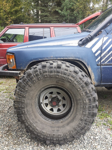

Tires
I managed to pick up some tires sooner than I expected. They are a used set but have a lot of life left. 36x12.5 TSL SX. They were previously run once a year on the sellers hunting Jeep, so there's not more than a few hundred miles on them. I'm going to see how they fit without any lift because I can't afford a good one like I want. Some fender trimming is in order. Before a lift I'll be regearing so I don't tear the drivetrain apart too quickly. Can't wait to get these shoes out in the dirt!
Attached Thumbnails Daniel's '86 p/u Build Up-new-tires.jpeg

I got the tires to fit, just barely, but they do fit. I have no problem cutting the body away because the bed is coming off someday anyways to make a flatbed and the front fenders don't look any rougher than they did at first. My plan for a lift is to do the 63" Chevy spring swap in the rear and 1.5" BJSpacers from 4crawler in the front, possibly wheel spacers. I would like to do more for the front but responsibility....
Attached Thumbnails Daniel's '86 p/u Build Up-darma.jpg

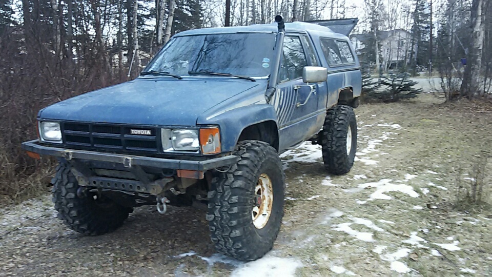

I finally pulled the trigger on the LCE header kit. Shipping to Alaska was $110, very discouraging. Luckily I work with some guys who come up every two weeks from the states, one lives in CA, $25 to ship it there and have him bring it on the plane as baggage for free.99. I ordered new studs with it and the install was smooth.
--Pull the old cast manifold.
--Used the double nut trick to get the old exhaust studs out, nothing broke!
--Cut my bailing wire exhaust hangars....
--Throw the old exhaust with cat and muffler attached, as far as humanly possible. Yell at it.
--Removed the bracket that is attached to the bell housing, *reinstall the 17mm bolt*
--Removed the heat shield opposite the afformentioned bracket.
--Smile while torquing down the header. And installing the new O2 sensor which I grounded to the t-case.
I chose to not get the Flowmaster that LCE sells as I am not into the noise. Just my preference. They recommended the Dynomax 17731 for a tamer sound. It's fine. Still a little louder than I wanted but I have excellent power gain from the new system, all 2.25". I also stacked it.
Ting ting ting
I got the idea for the stack and rain flapper from someone who lives in farm country Illinois, imagine that. But I like the way it turned out. I bent a bracket to secure it to the cab from some 1/8"x1" bar, drilled holes for a 2.25" exhaust bracket threads and it does what it's supposed to.
Using observation you will also notice that the bed is gone. At last I have begun the flatbed undertaking, I have the steel for the frame which will be 2"x3" exterior with 1.5" square cross members, leaving just the right depth to drop 2" (1.5" truly) boards for a deck. That's the bare bones plan for now.
Bed removal went surprisingly well, I used an abundance of PB blaster and Aerokroil to make sure I didn't break any bolts or gall threads. There are 8 studs, 4 in front of the rear tire and two behind. They have a steel tab welded to the head to keep them from spinning while you remove the 2 17mm nuts per bolt.
--Removed 16 nuts from 8 bolts--Removed tail lights and license plate lights--Remove a couple of plastic clips holding the tail light wiring in, only a couple and they are all behind the axle.
--Reinstalled 4 nuts to drive it to the dump and shove it off into the scrap pile.
What was left of the bed weighed 220# FYI.
