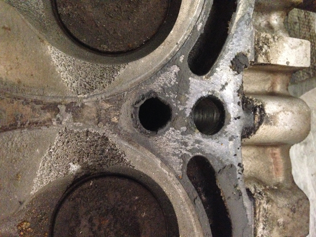

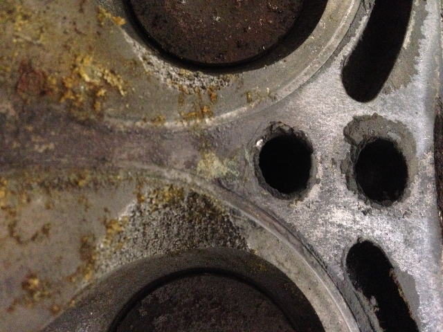

Here's the quick version of what has happened so far. Got the truck from a good friend who loved her but didn't have the time or money to take care of her. FREE TOYOTA!!! It was like Christmas. I realized doing a turbo was far from necessary and beyond my skill. So I just started tearing things apart to find out why she didn't have compression. (Never worked on a motor before) I found pitting in each combustion chamber on the exhaust side. I thought that's definitely it. Soon bought a new head with O/S valves from ENGNBLDR. Put it together and just cranked. Sad day.
I then did the right thing. Ran a compression test. Cylinders 1 & 2 were very low 10 & 30 ish psi. Pulled the motor, took her ALL apart and saw nasty things. (Picture is in my first thread mentioned earlier) #2 piston has ground itself against the cylinder wall near the top. So the block and crank are at the machine shop currently. Getting the block bored out and the crank checked out and ground if needed.
Attached Thumbnails Daniel's '86 p/u Build Up-forumrunner_20141129_110904.png   Daniel's '86 p/u Build Up-forumrunner_20141129_111129.png
