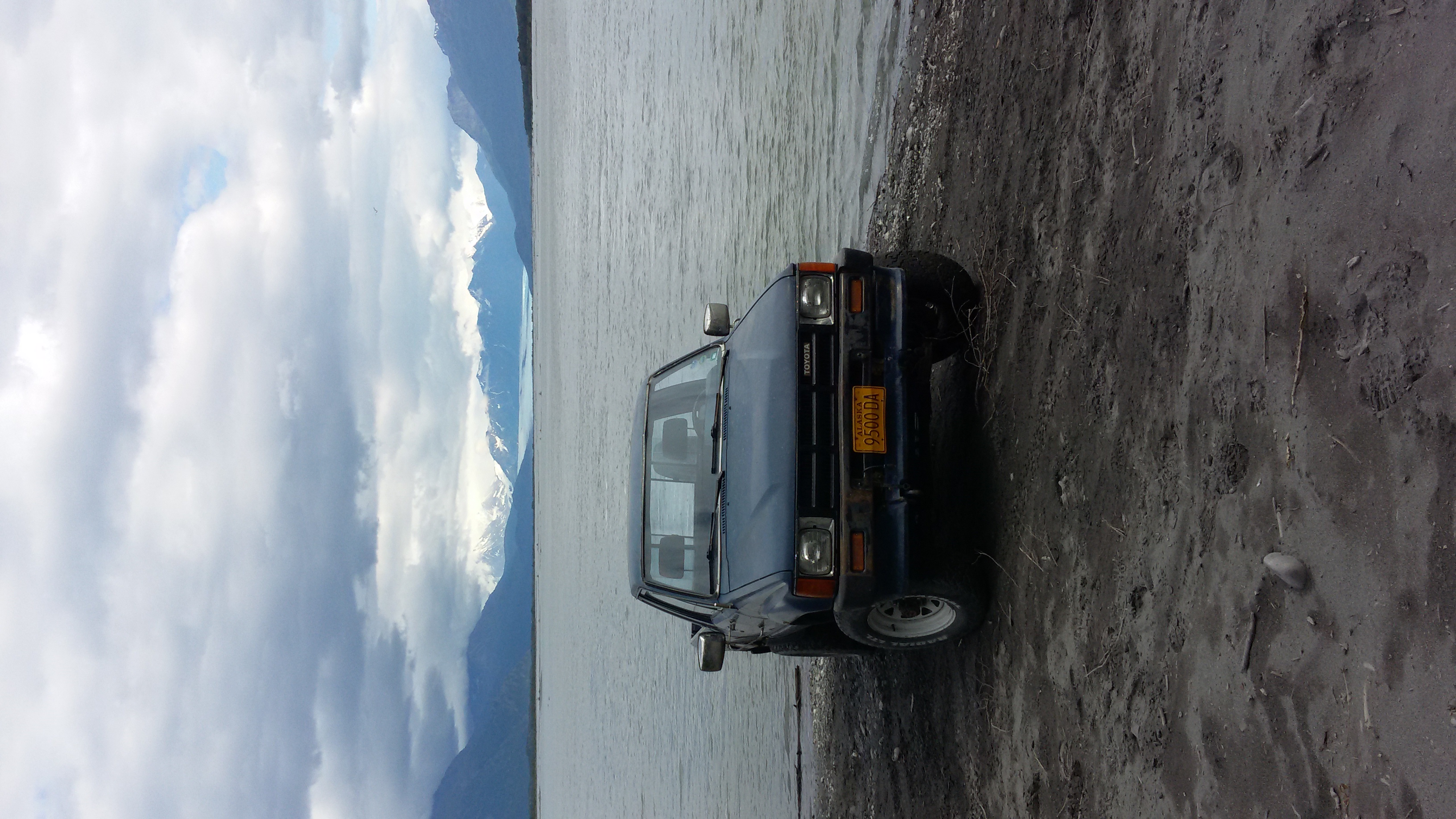

Also, I finally got it off the road....it was good for both of us. It also served as an encouragement to get some beefy tires. I can't wait!
Attached Thumbnails Daniel's '86 p/u Build Up-20150717_161505.jpg
