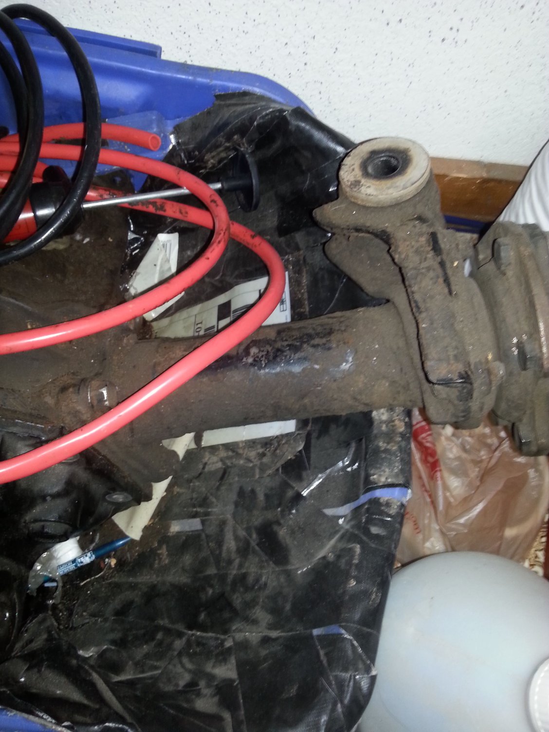

im going to combine these diffs the add one has a lockright and 4.56 gears, and i will use the long side axle on the other diff to replace the add stuff

i installed the add front diff with 4.56 gears and lockright locker, im thinking of putting a vaacuum actuator in so i can control the shift fork to unlock one side for a tighter turning radius. I still have the non add diff, im going to put 4.88 or 5.29 gears in it eventually if i dont decide to do a solid axle.
