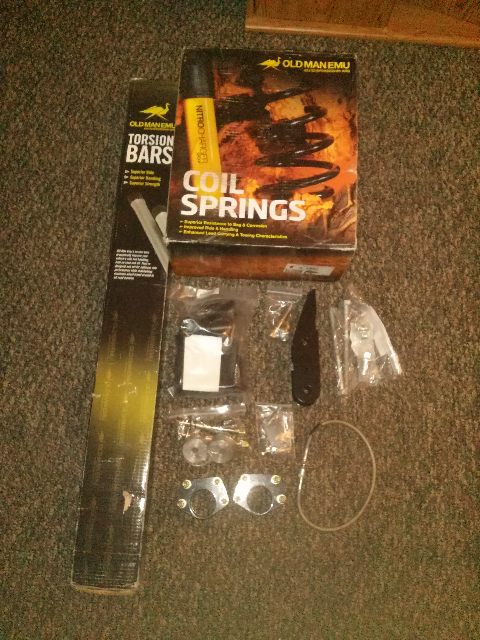

crazytoyota4x4's new 90 4runner build-up thread-forumrunner_20141108_160008.png
Lift components:
Ome 303003 torsion bars
Ome 2901 coil springs hd
4crawler 4" panhard drop
4crawler 2.5" lspv bracket
4crawler diff drop
Russell 4" rear brake line
Blazeland 18" stainless front brake lines
Blazeland diy weld up kit
Poly front control arm bushings
Skyjacker monotube f+r shocks
Moog ssd89 steering stabilizer
New torsion bolts/nuts

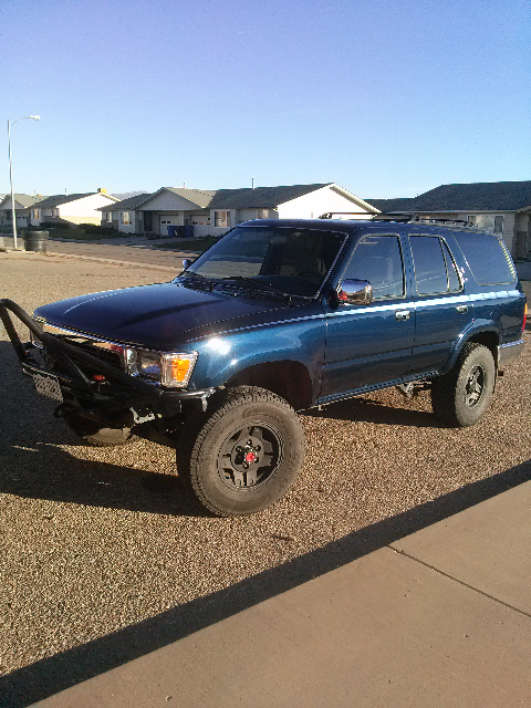

Current state<br/>

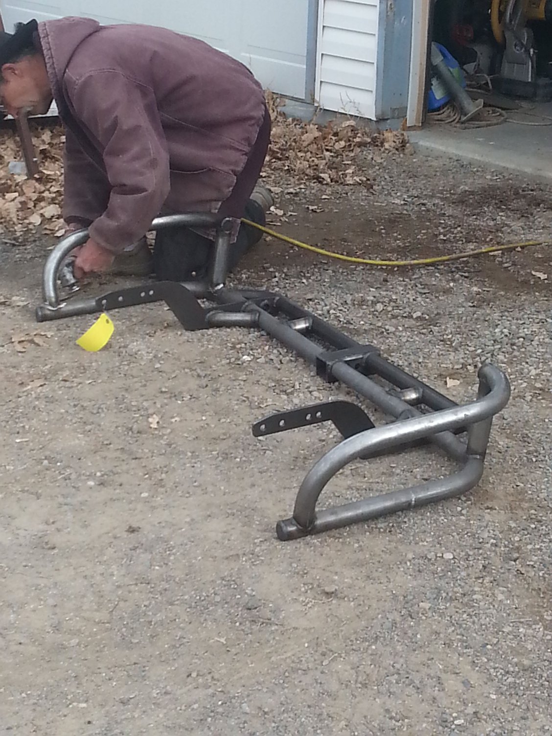

Today my friend and i modified the rear trail gear bumper to fit with the stock tire carrier
Trimming side gaurd before test fitting on truck
Removed
Lowered and re welded
Old 12-09-2015, 02:24 PM

Got the bumper primed and ready for paint, tomorrow i will put 3 coats of black chassis paint on it and hopefully get it installed friday. One bolt hole needs drilled out its a little small for the bolt to go through the other 3 lined up. I will also need to raise my license plate up out of the way of the lower bar.
The tire carrier isn't fully closed license plate needs raised about 1.5"

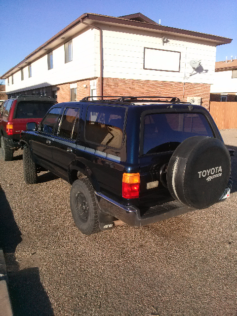

Got the rear bumper painted and installed

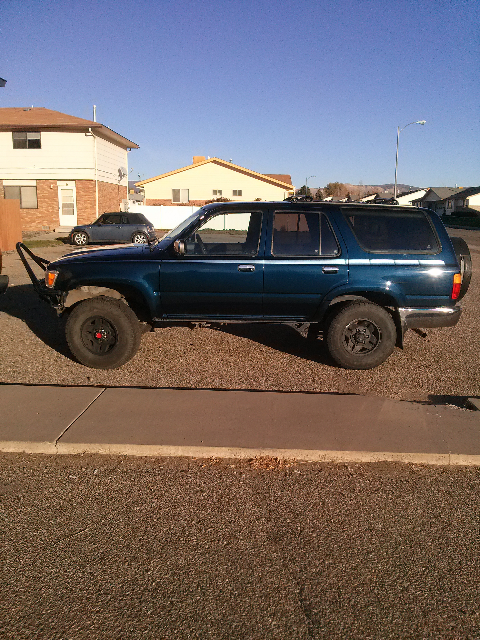

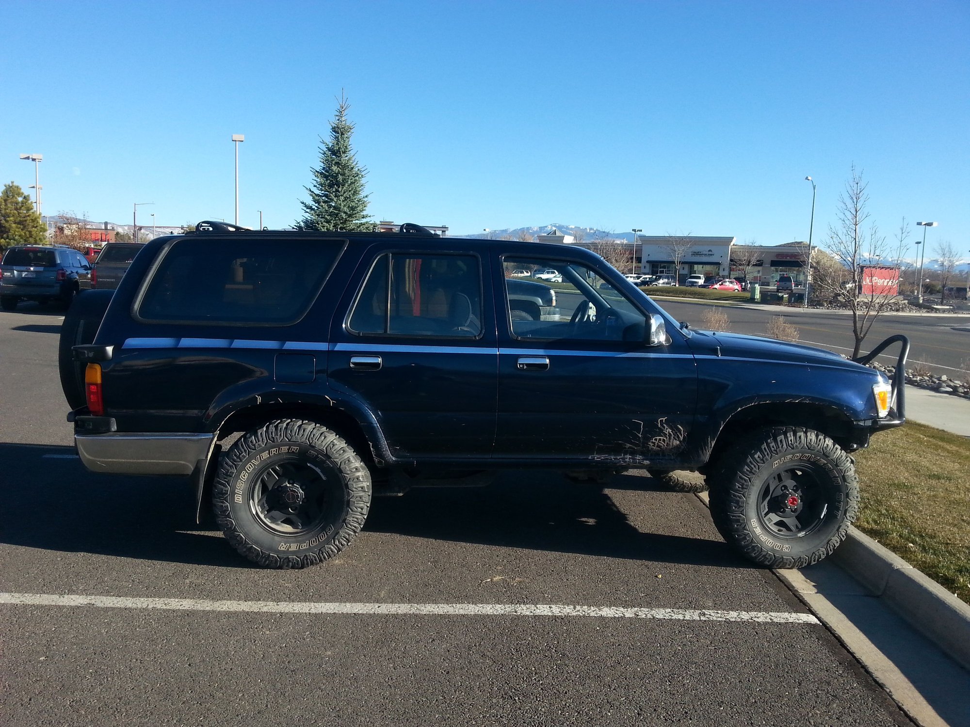

Just a couple pics
Still sitting stock height.

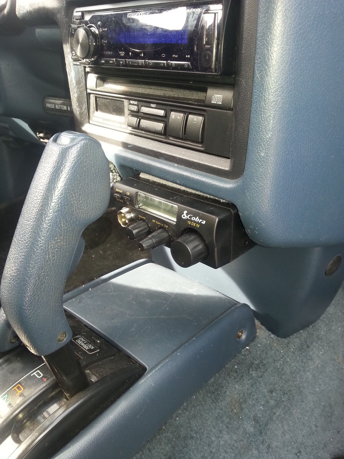

Cb installed in ashtray spot
