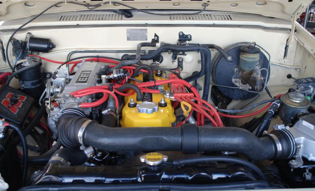

Ok it's running again and back on the road after 10 plus years. It runs great I am very happy with it I put 260 miles on it so far no problems yet. The last 2 months were very busy I have a lot of pics I will post later Iam going for another drive right now. Thanks for all the help from yotatech ChefYota4x4-rustEDyota83-Terrys87-drew303 and all the others Thanks !!!!
