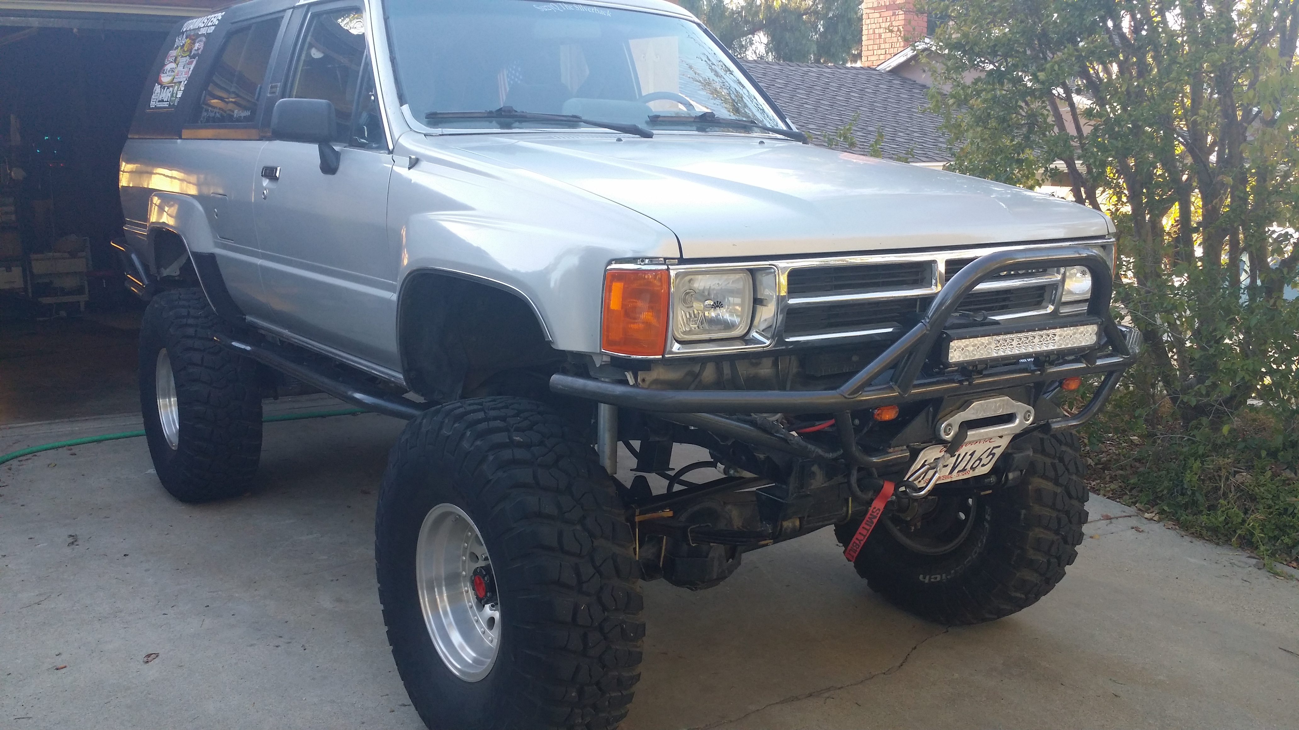

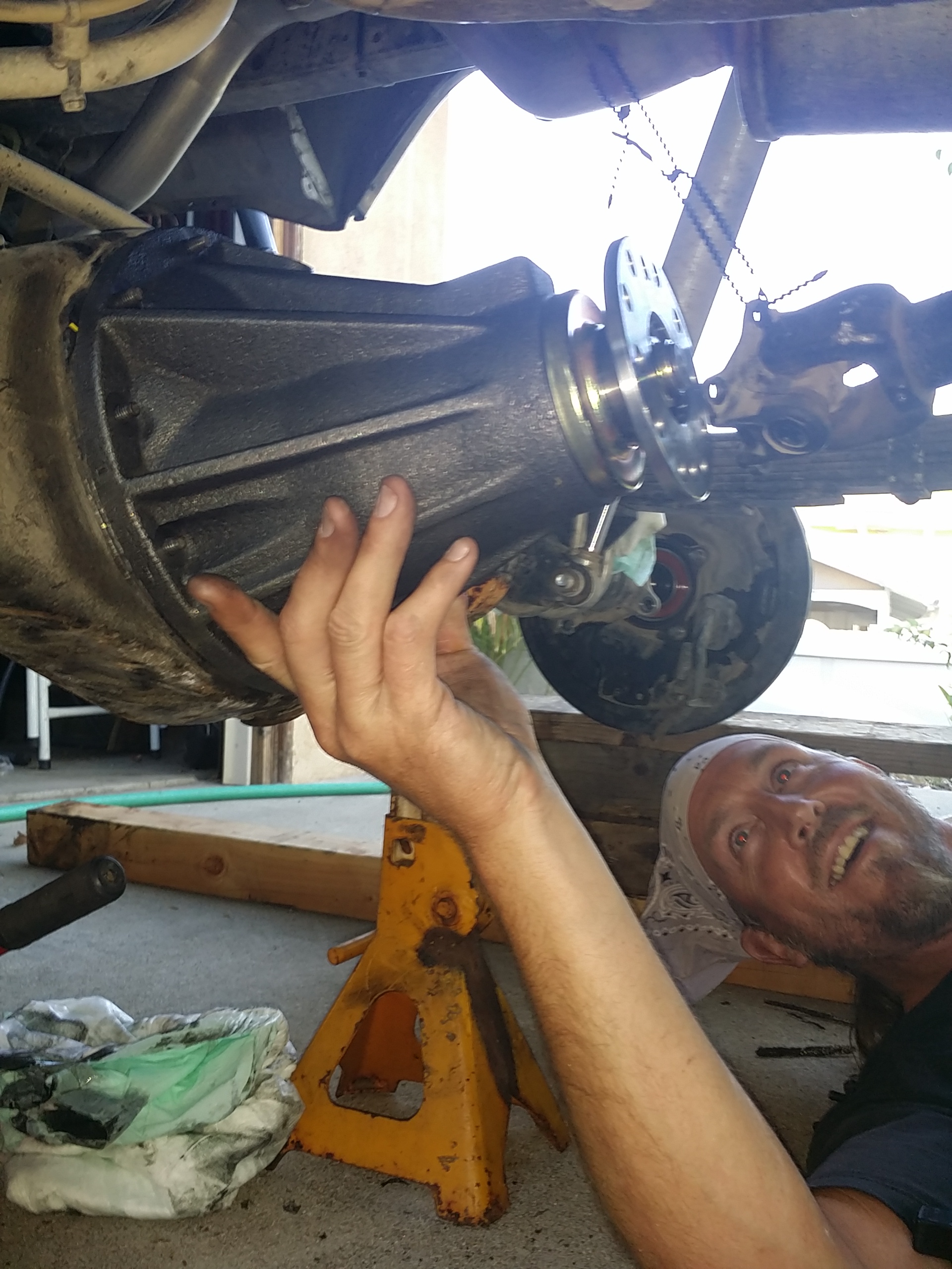

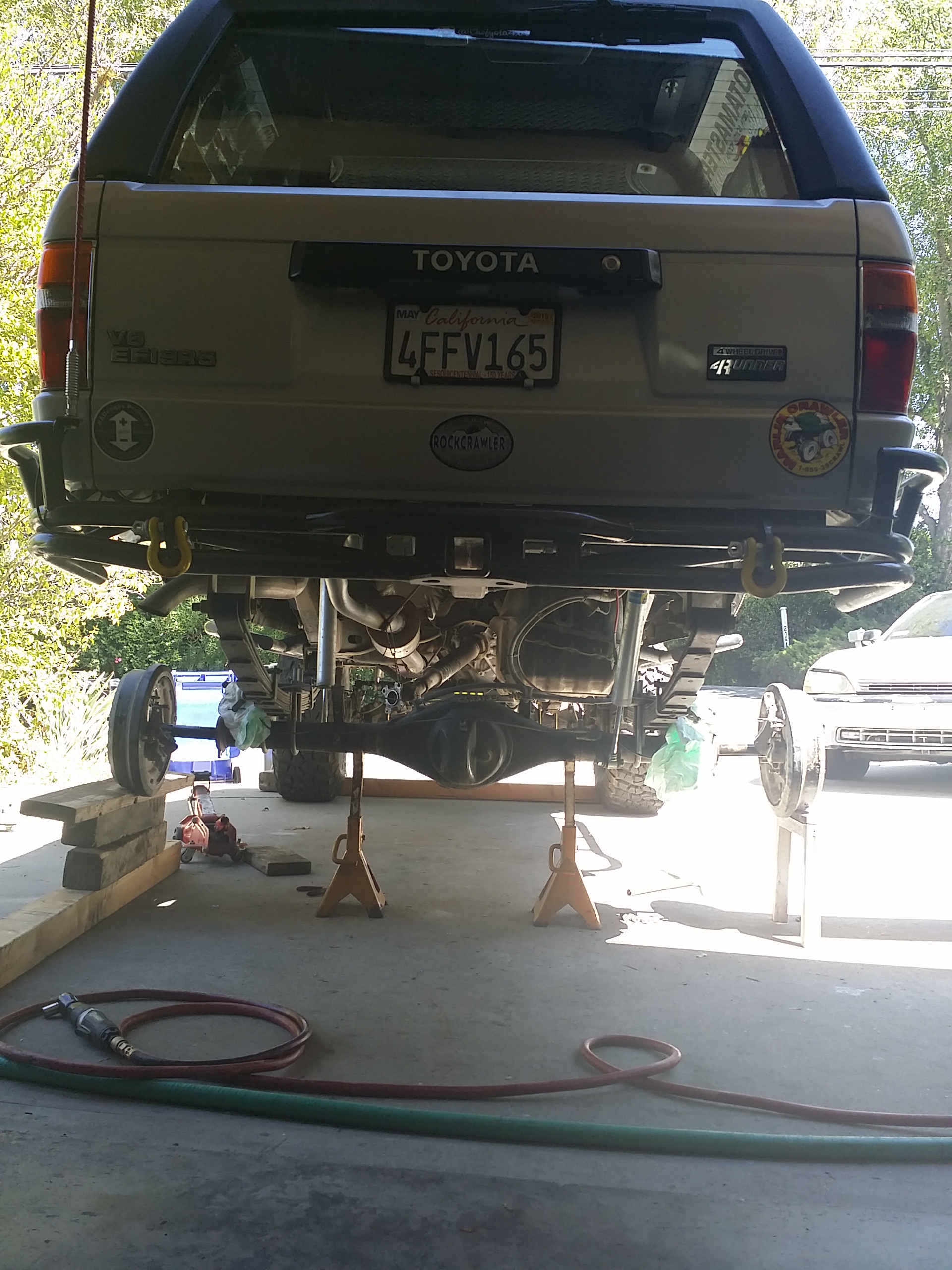

Well, got the brand new V6 w/Detroit diff in the rear....
Local couple guys I have seen around here, yet never met in person, saw my request on Instagram for help and came over and spent hours just hanging out and talking truck and helping me hump this much heavier differential up in there. SO COOL OF THEM!

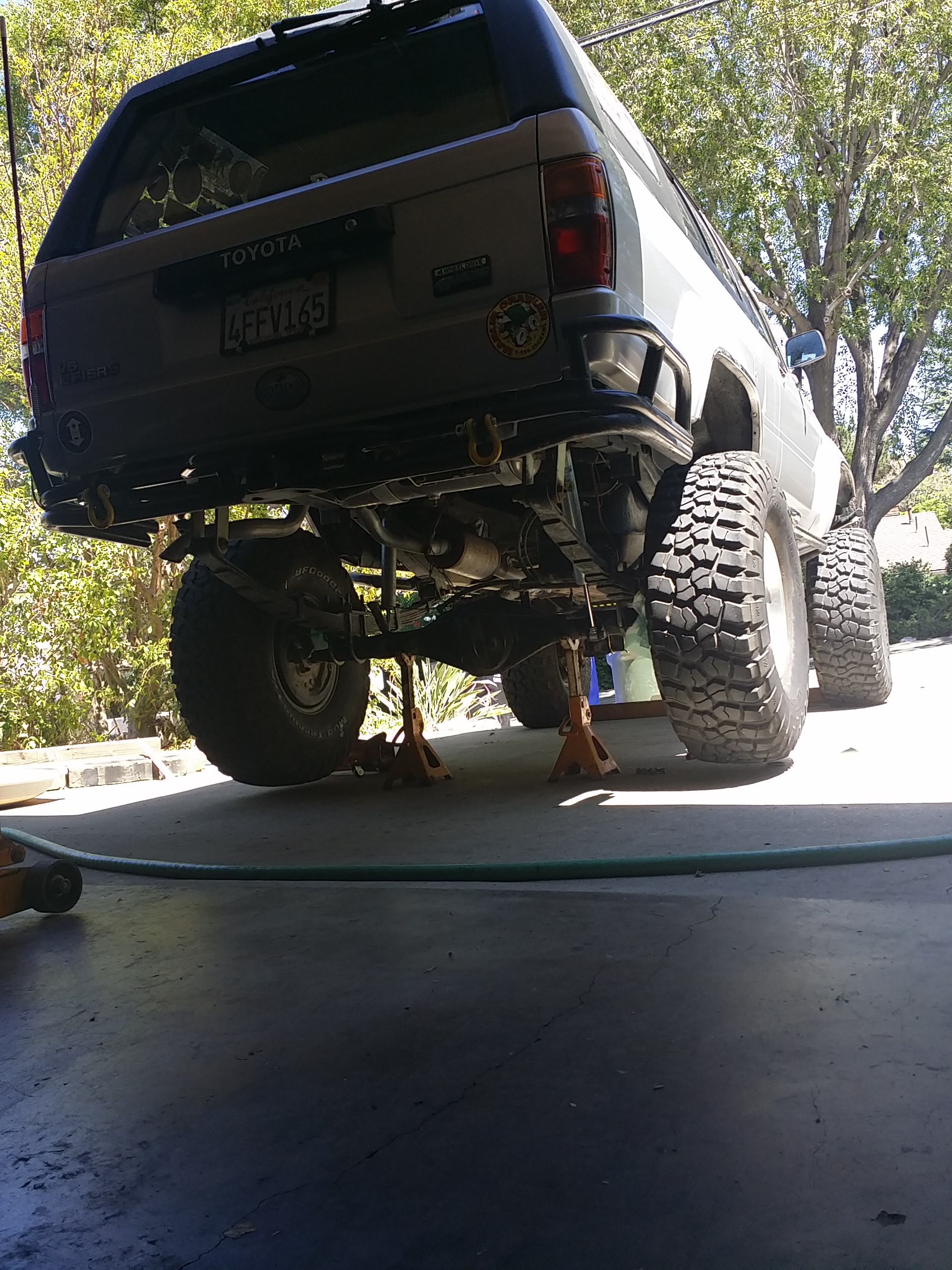

Pulled her out of the garage to prep for surgery! Lol.....
Got her up on stands.....
Yoinked the axles out....

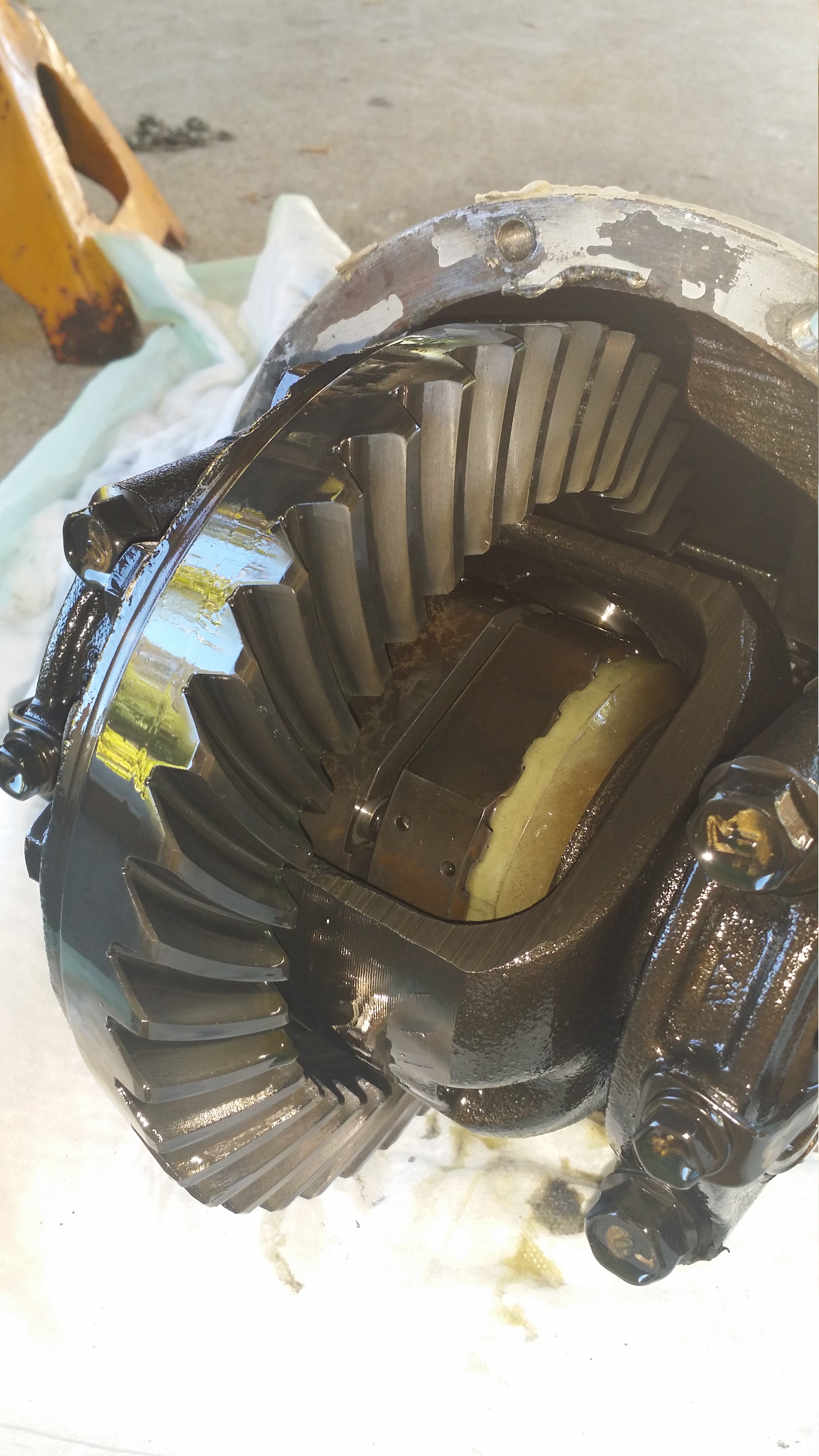

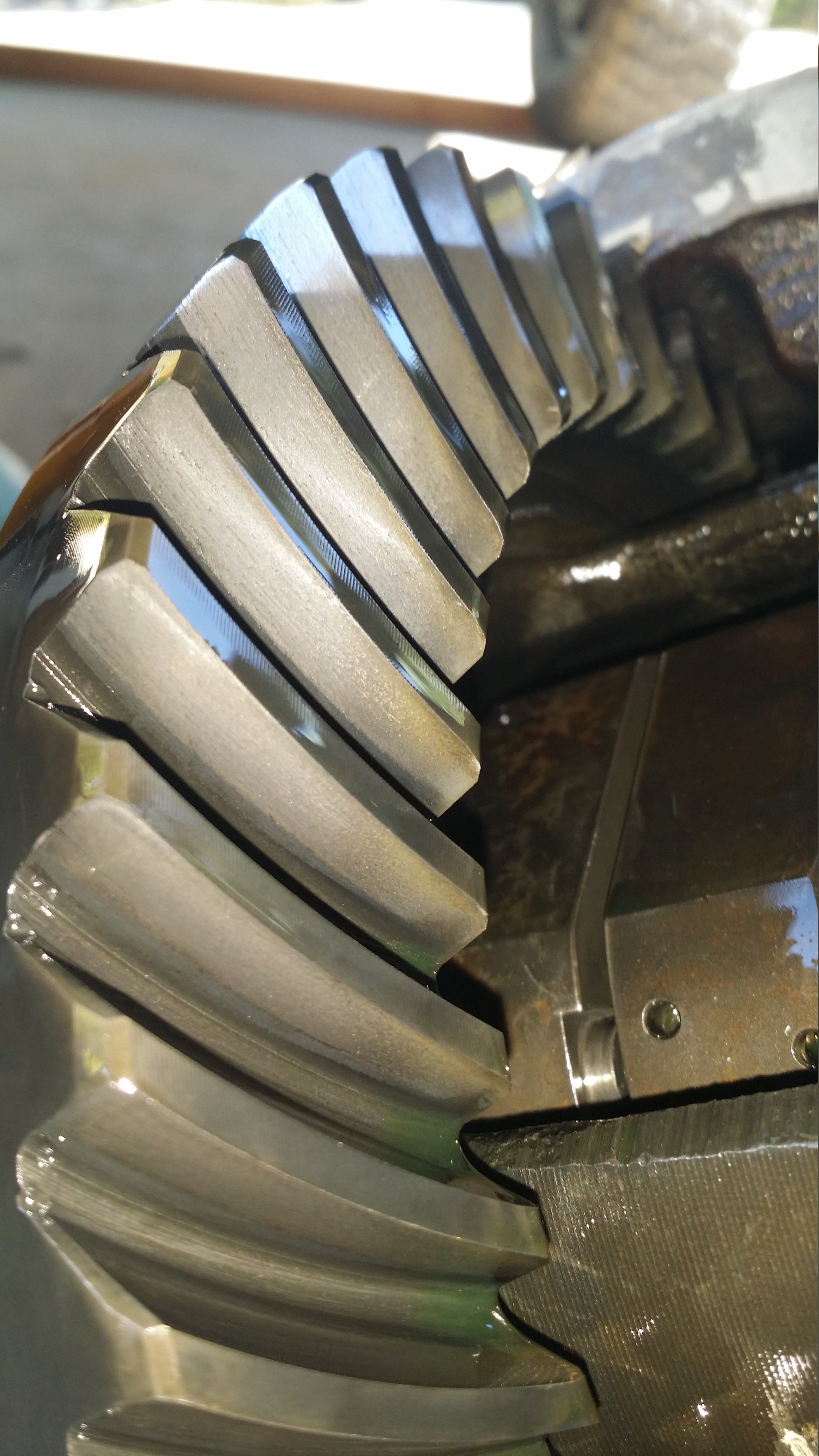

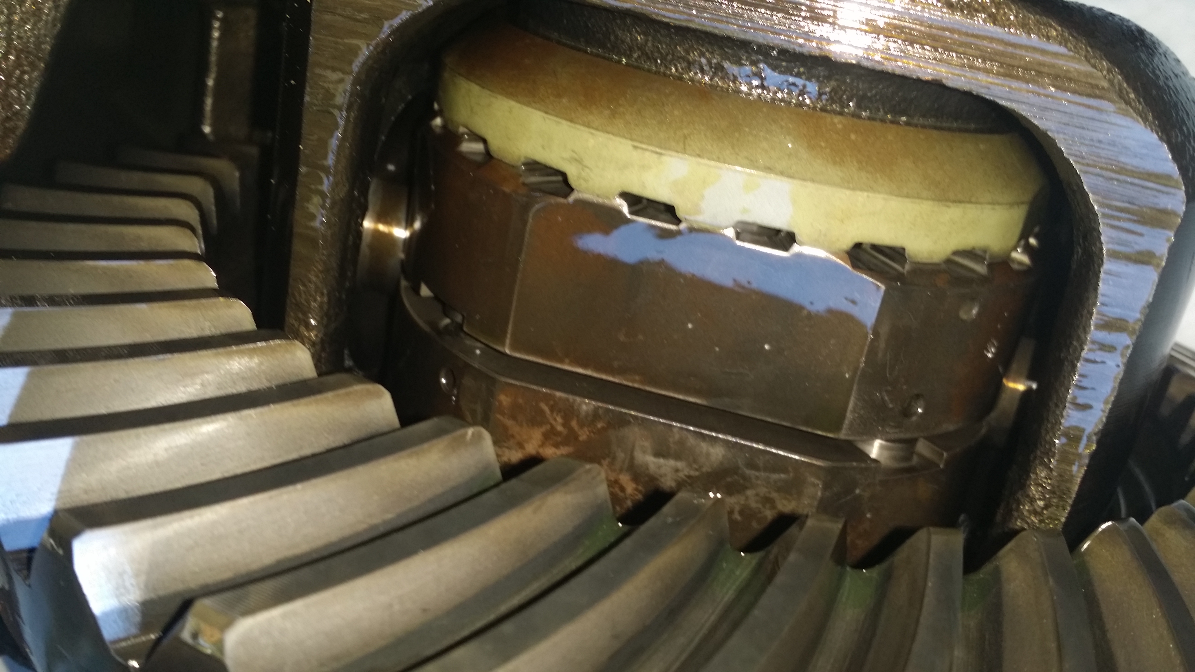

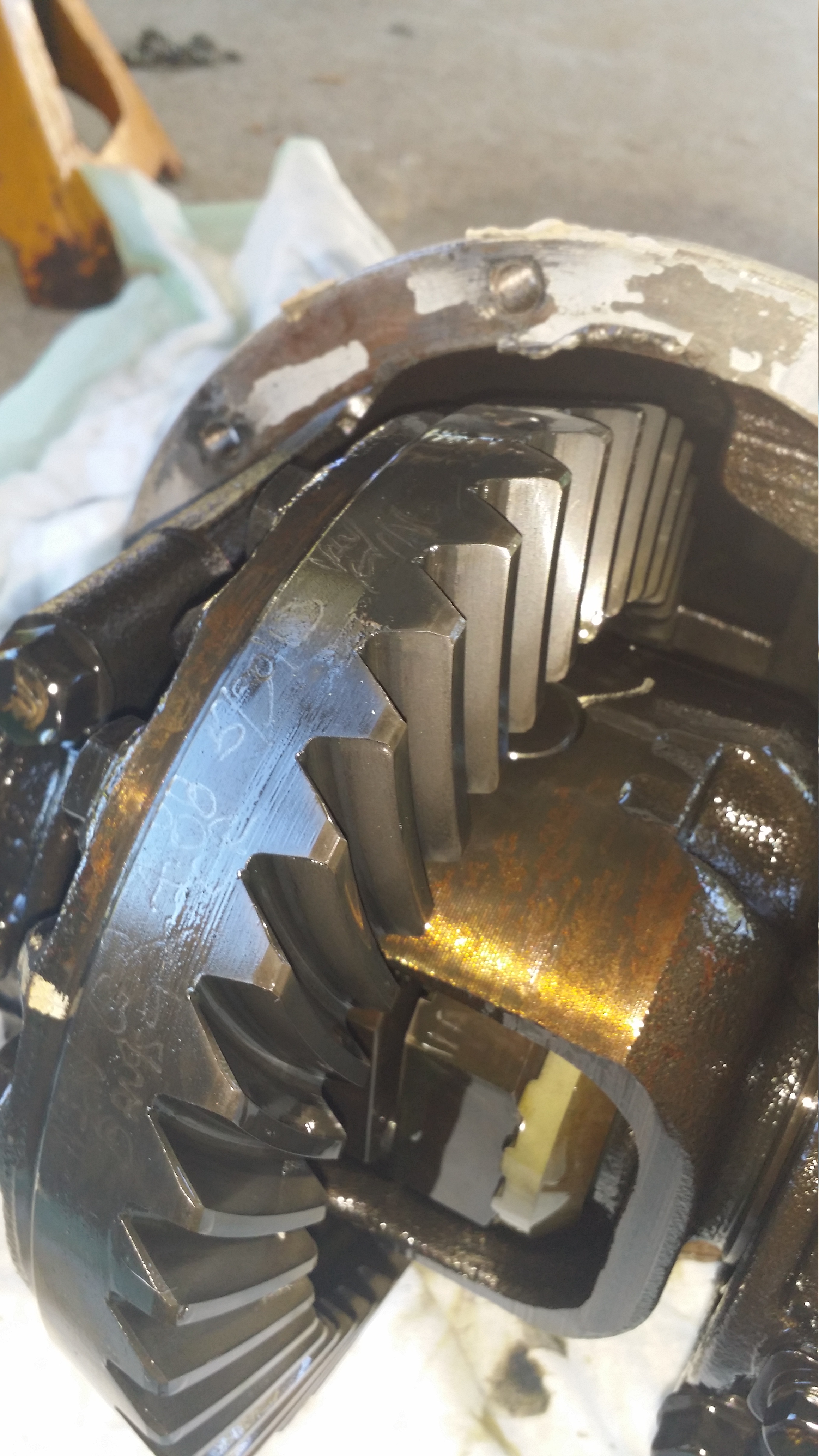

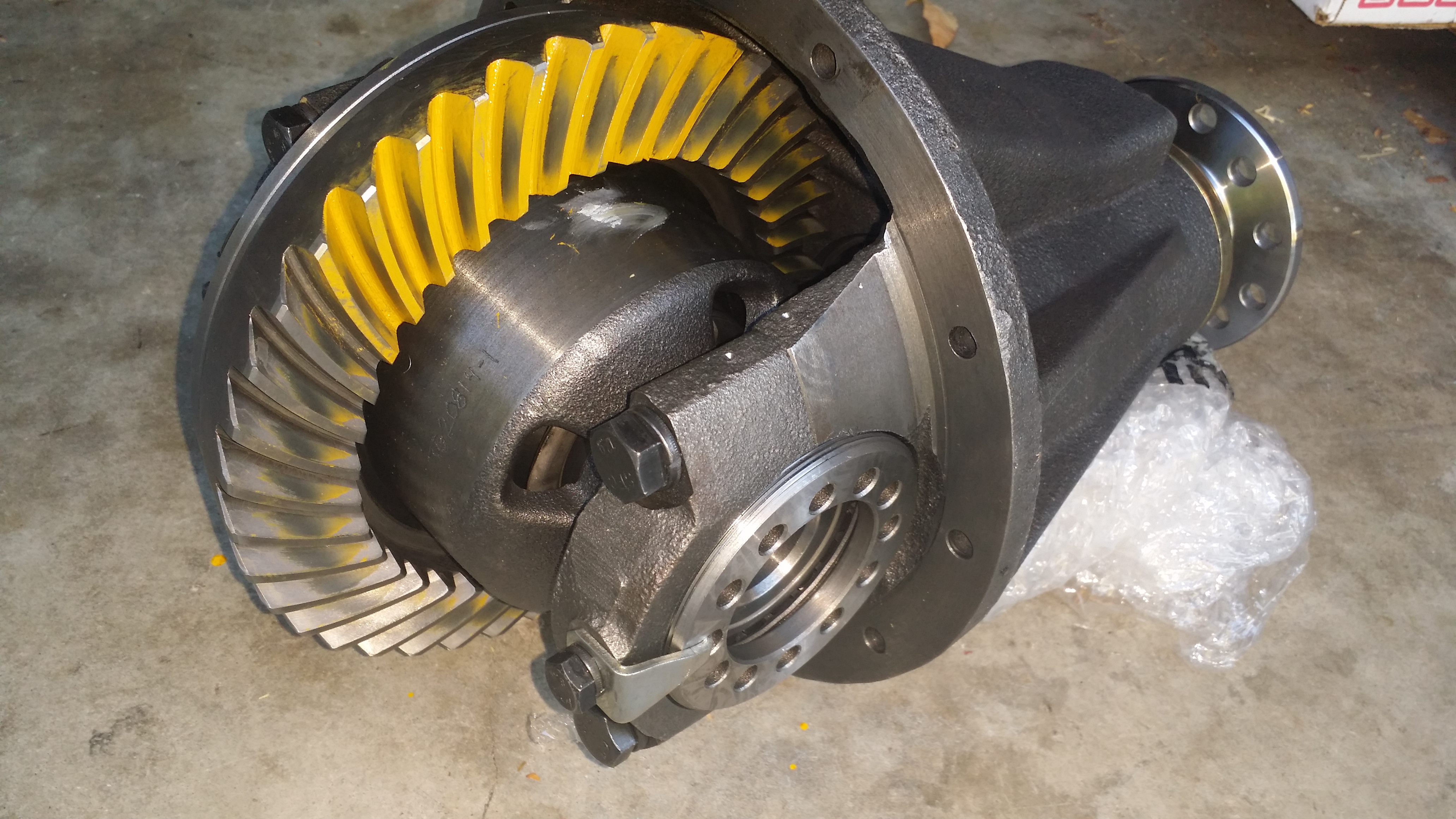

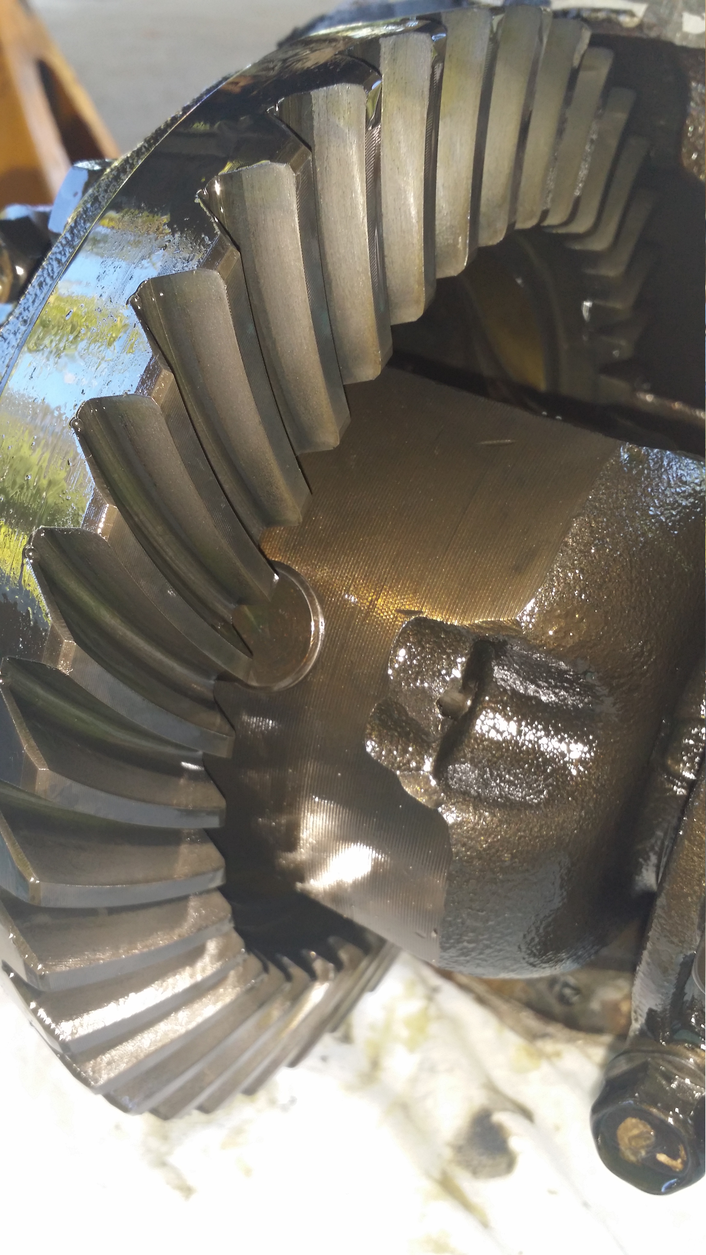

Pulled the very recently done 4 cylinder differential with new / broken in G2 4.88's and premium install kit set up by Jay King at Yotamasters....
Pulled it with the Spartan in mid ratchet on purpose,.....
, and within a quarter inch turn of the pinion it popped right in.... ....

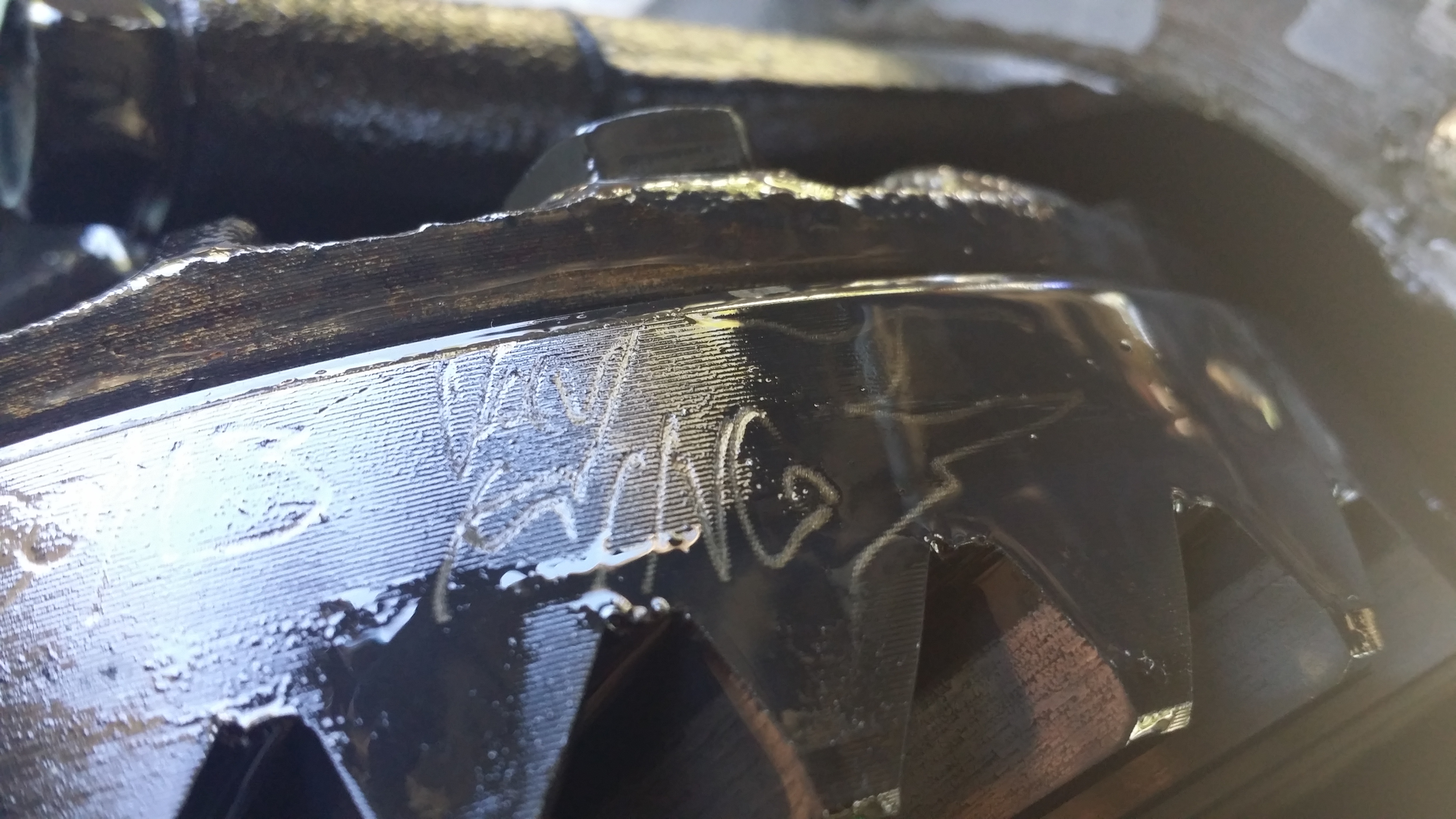

These are so quiet, the gears, and in mint broken in condition.... Going to sell with the Spartan, with the disclaimer that the spartan could be annoying... I would recommend just basically disassembling it reassembling it , which would allow to see if something is out of specs, because it was put together by a member on here a couple years ago, when I grabbed the 430 geared diff with this locker in it..... Honestly think what it is is that the springs are worn out in the Spartans, which makes it ratchet more often. As you can see from the pictures nothing is coming apart and there are no obvious signs of the pin being way out or something like that....
MINT! ....

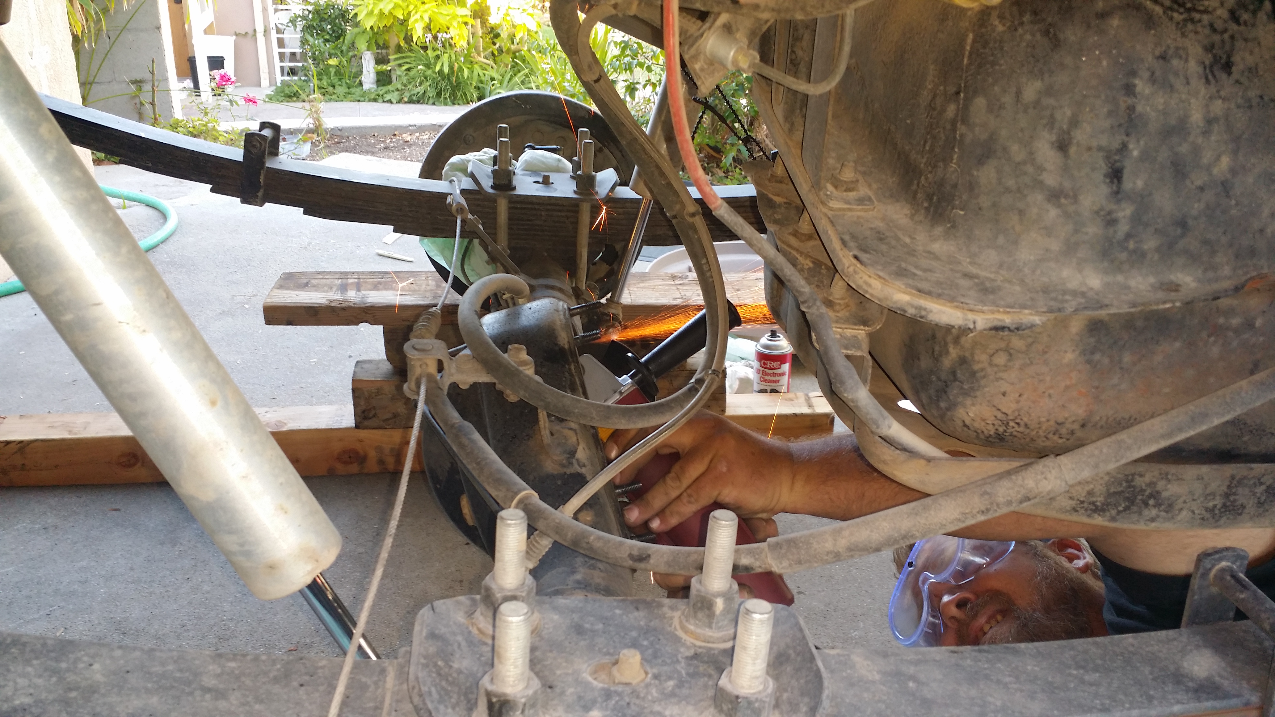

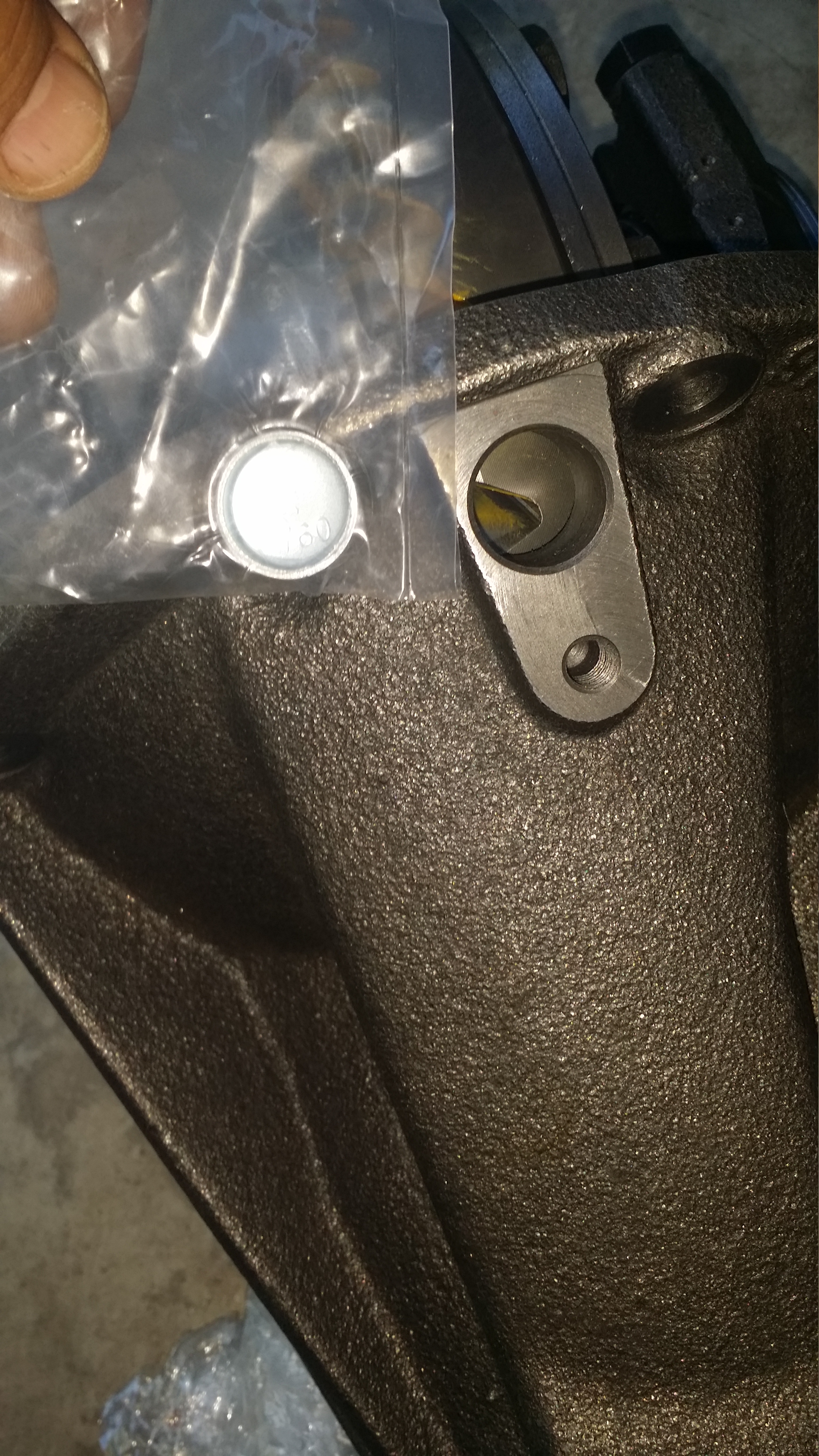

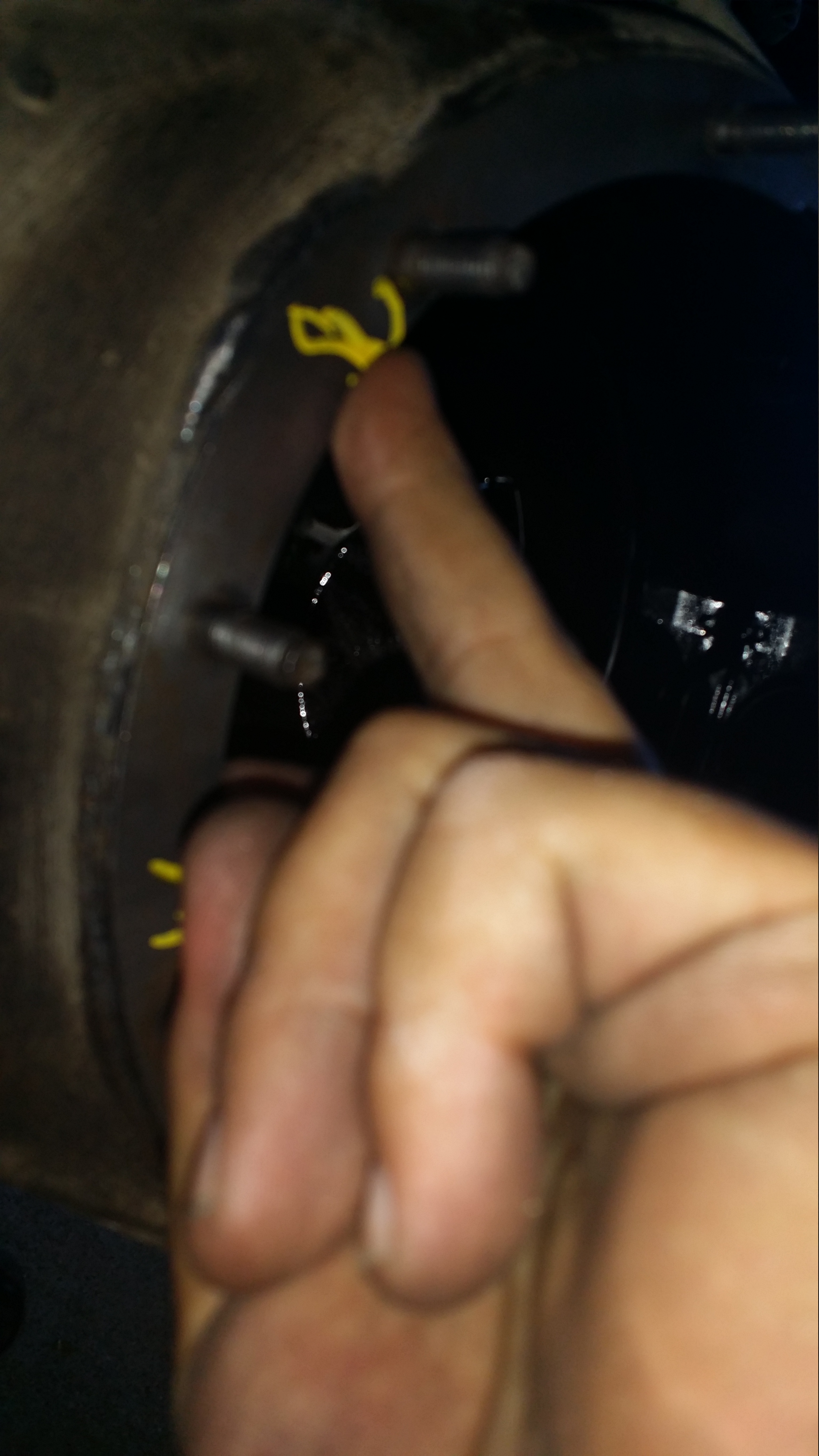

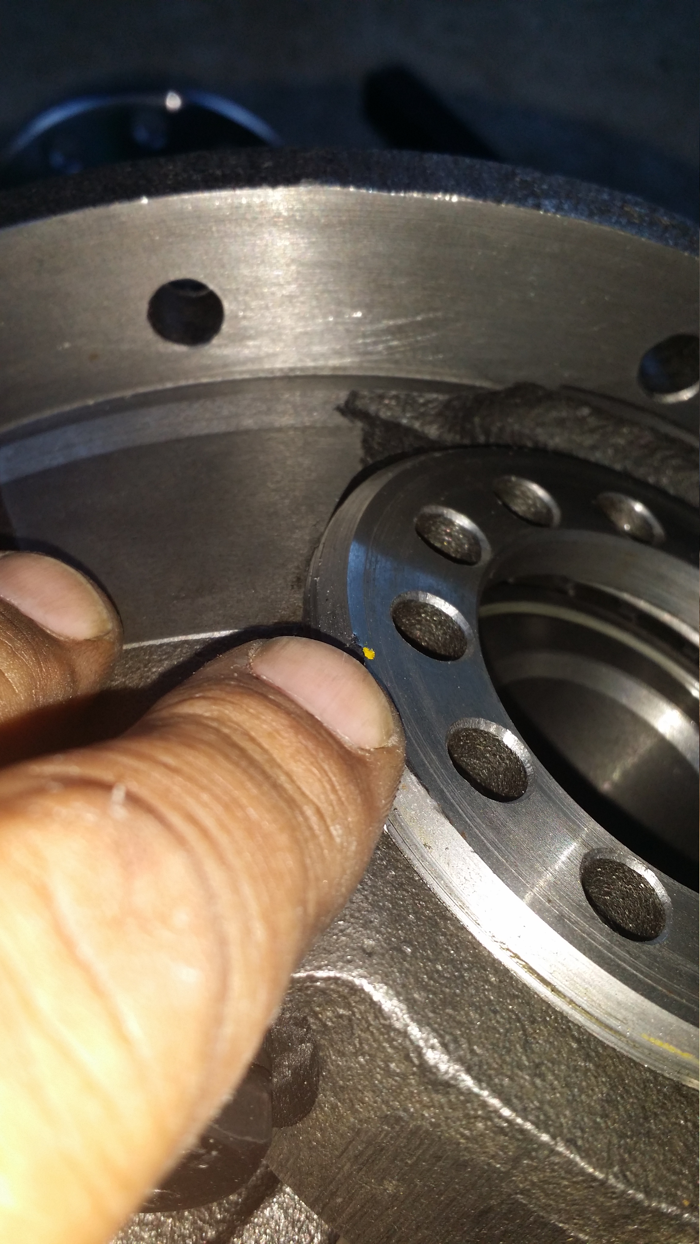

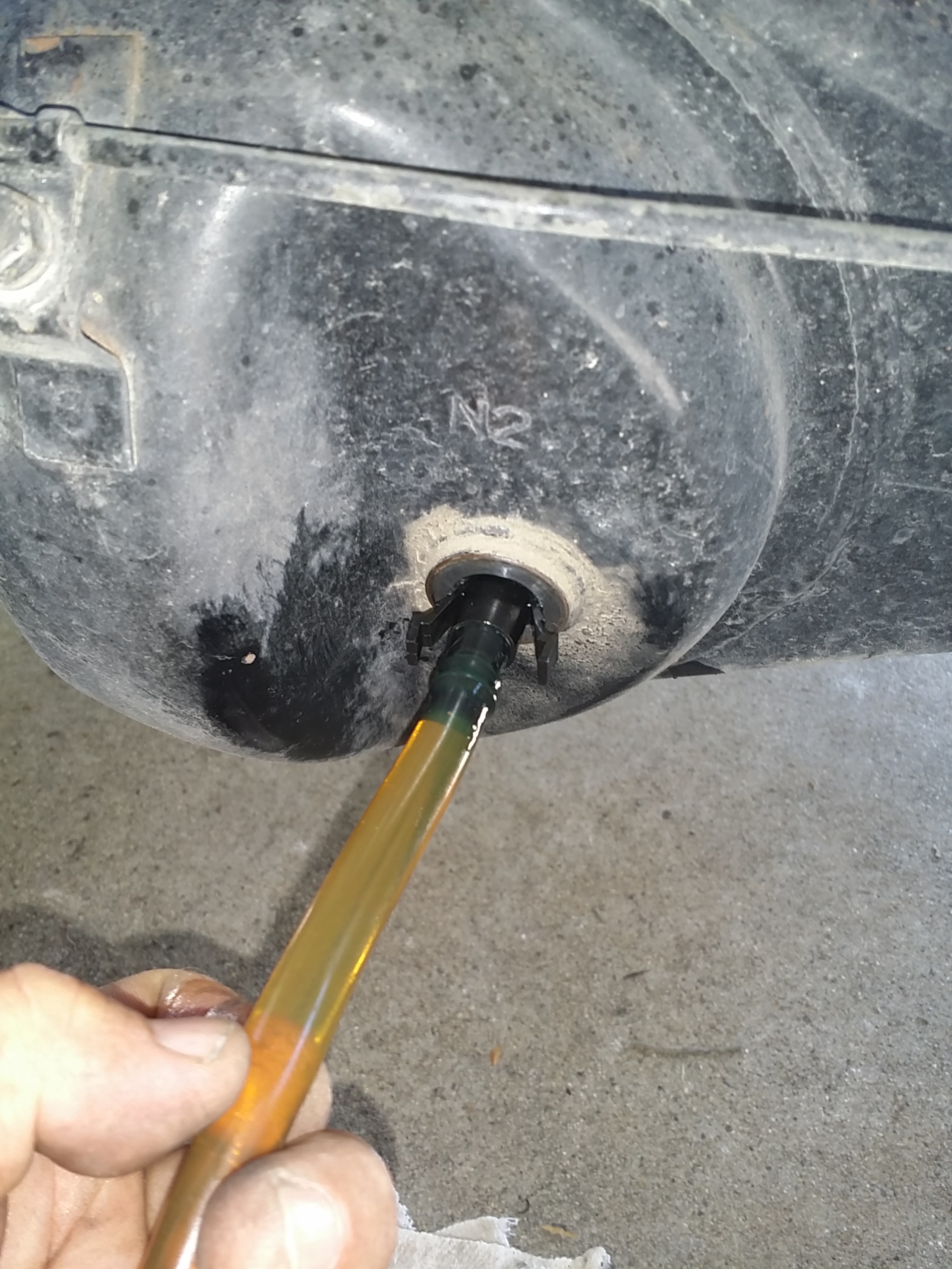

First, I realized I had hamburger D one of the two longer studs, the one on the bottom around 5:29 on the clock.... Solved!
Draining before swap(4) Hamburgered stud:
Also, I had to do a little bit of filing in order to get socket over the drain bolt.... Got it!
Draining before swap(1):
Draining before swap(2):

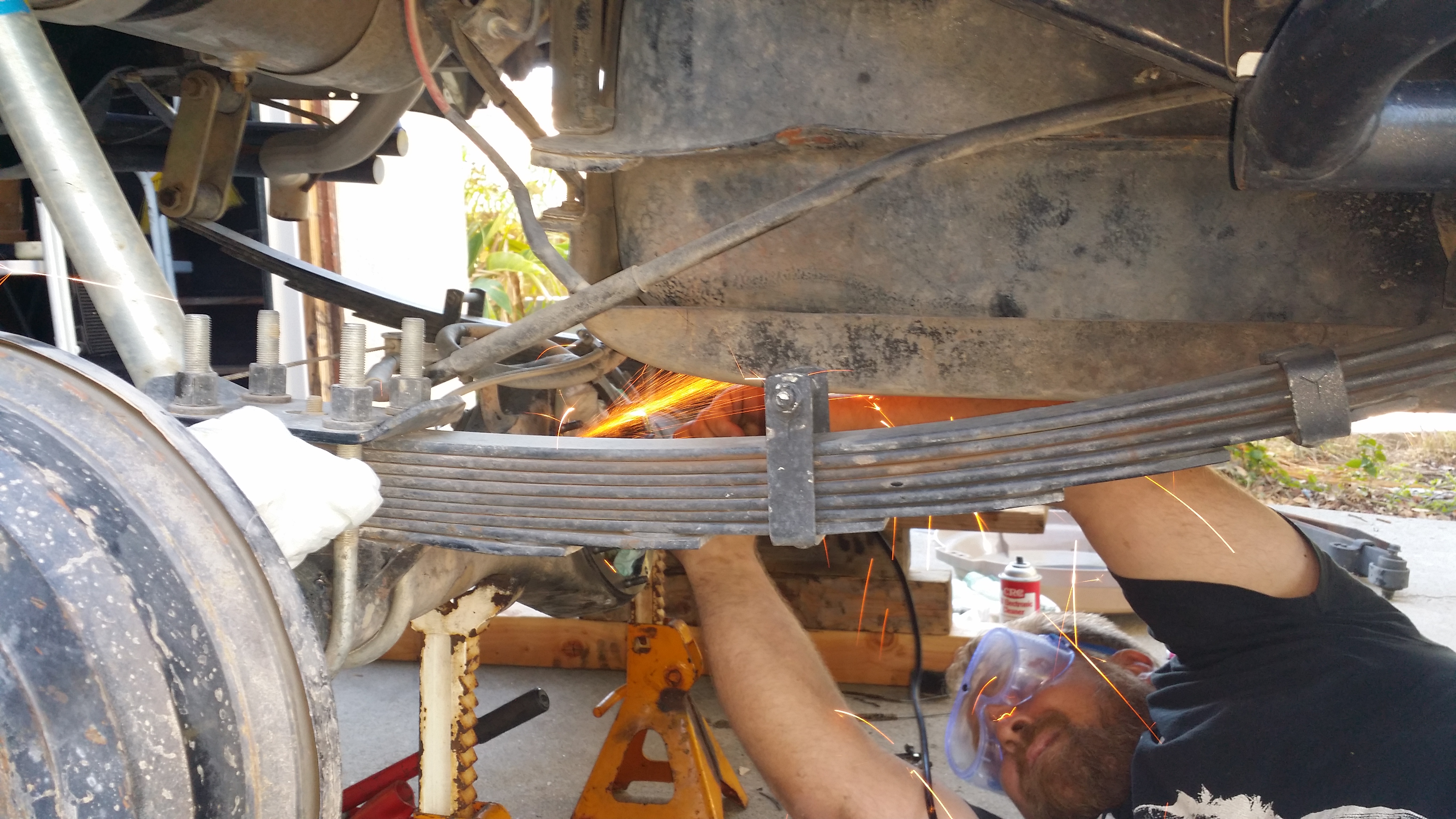

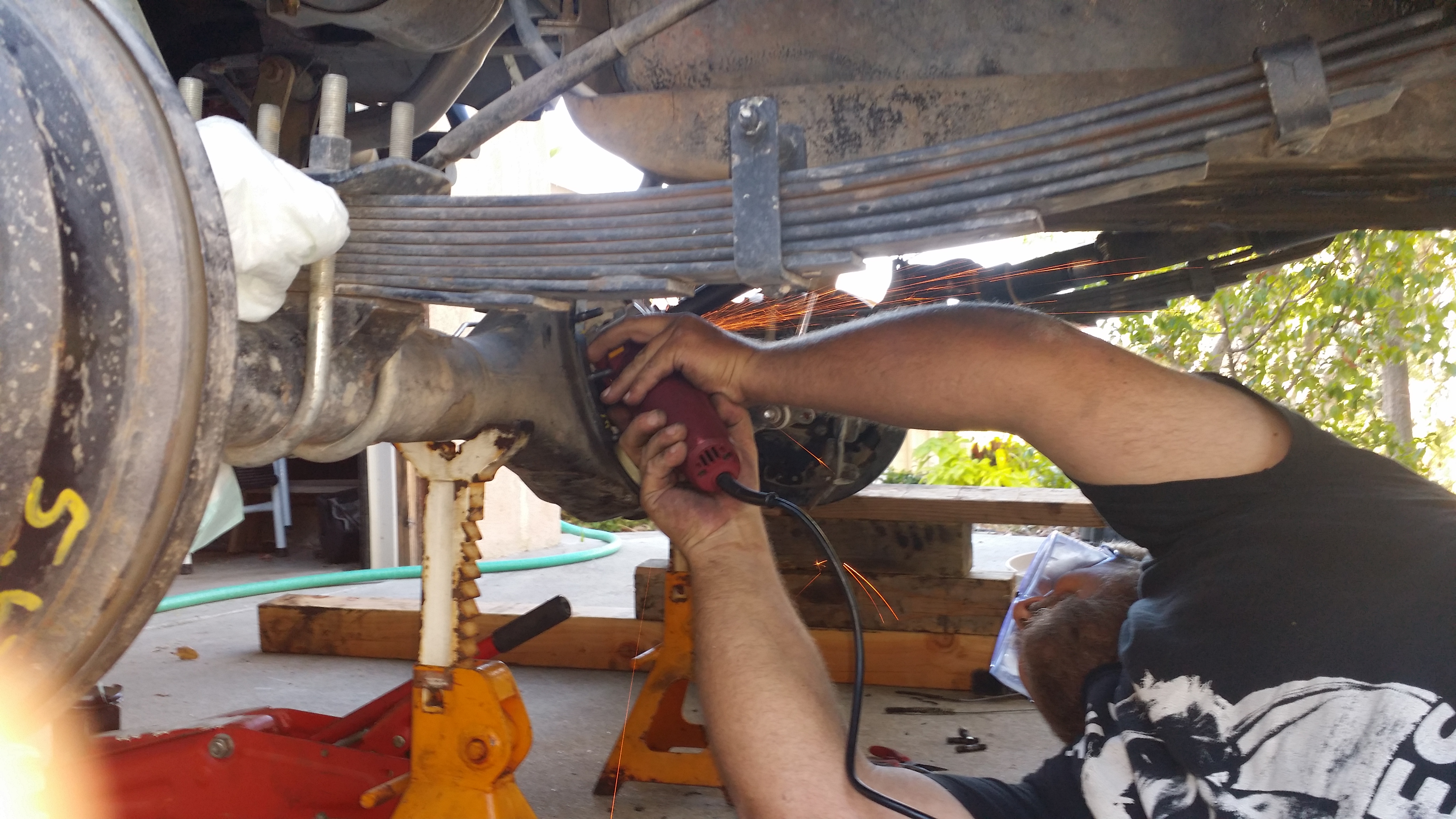

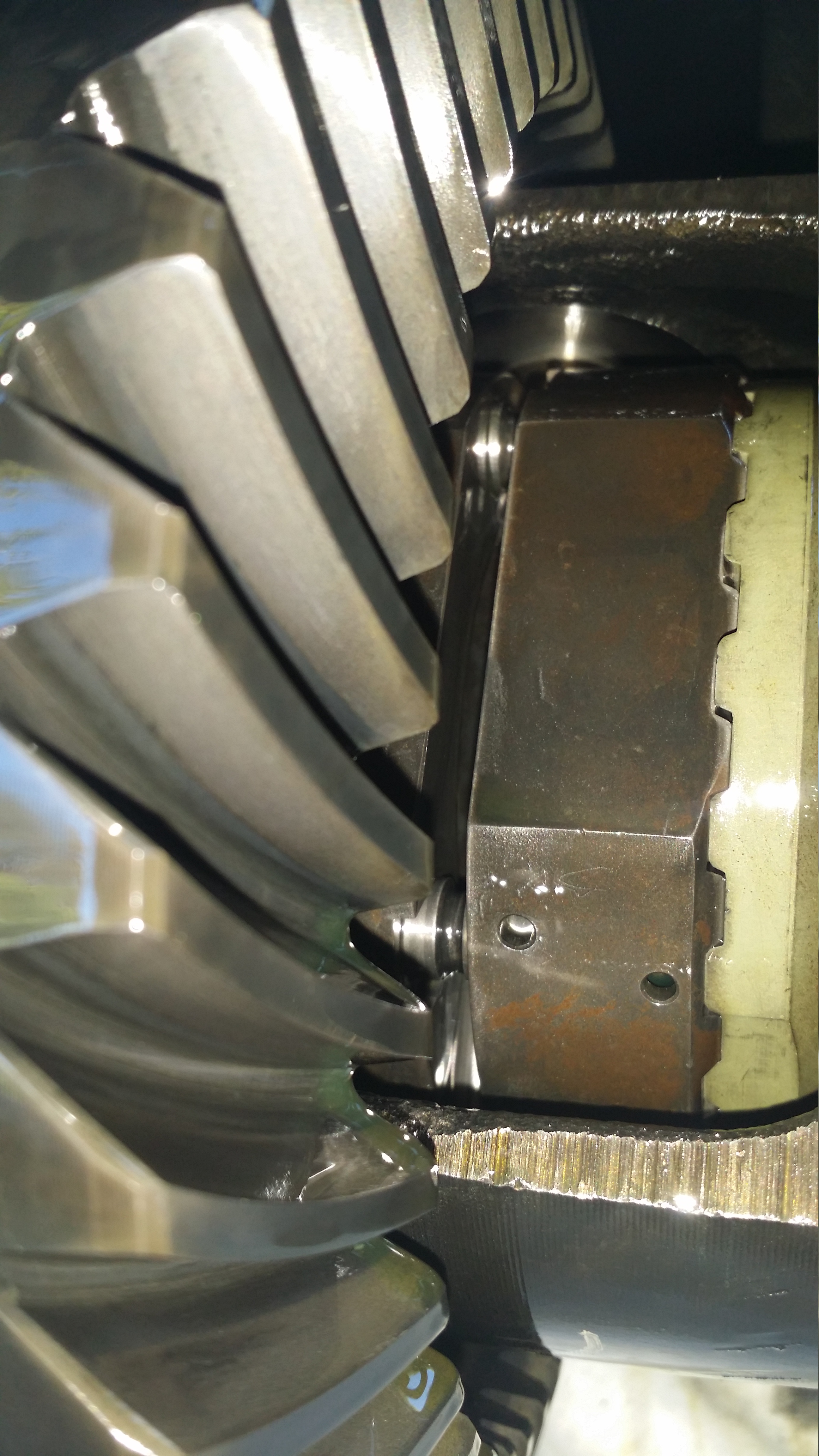

I had to do quite a bit of grinding, meaning in four different spots(1:30, 4:30, 7:30 and 10:30) on the proverbial axle to differential meeting point clock! Haha, just to clear the outer bearing adjustment nuts...
Not the friendliest ABS PLUG! Pita, grrr LOL....
New Homie helping me that day, big_bad64 on IG.... And his cousin was there as well....
Hahaha, dude was freaking hilarious, and he cracked me up all day! Lol... I just finished grinding and he insisted to help lift the diff and have me mark stuff as I was grinding after two test fits ( he didn't want me to blow out my back )... VERY cool ppl!

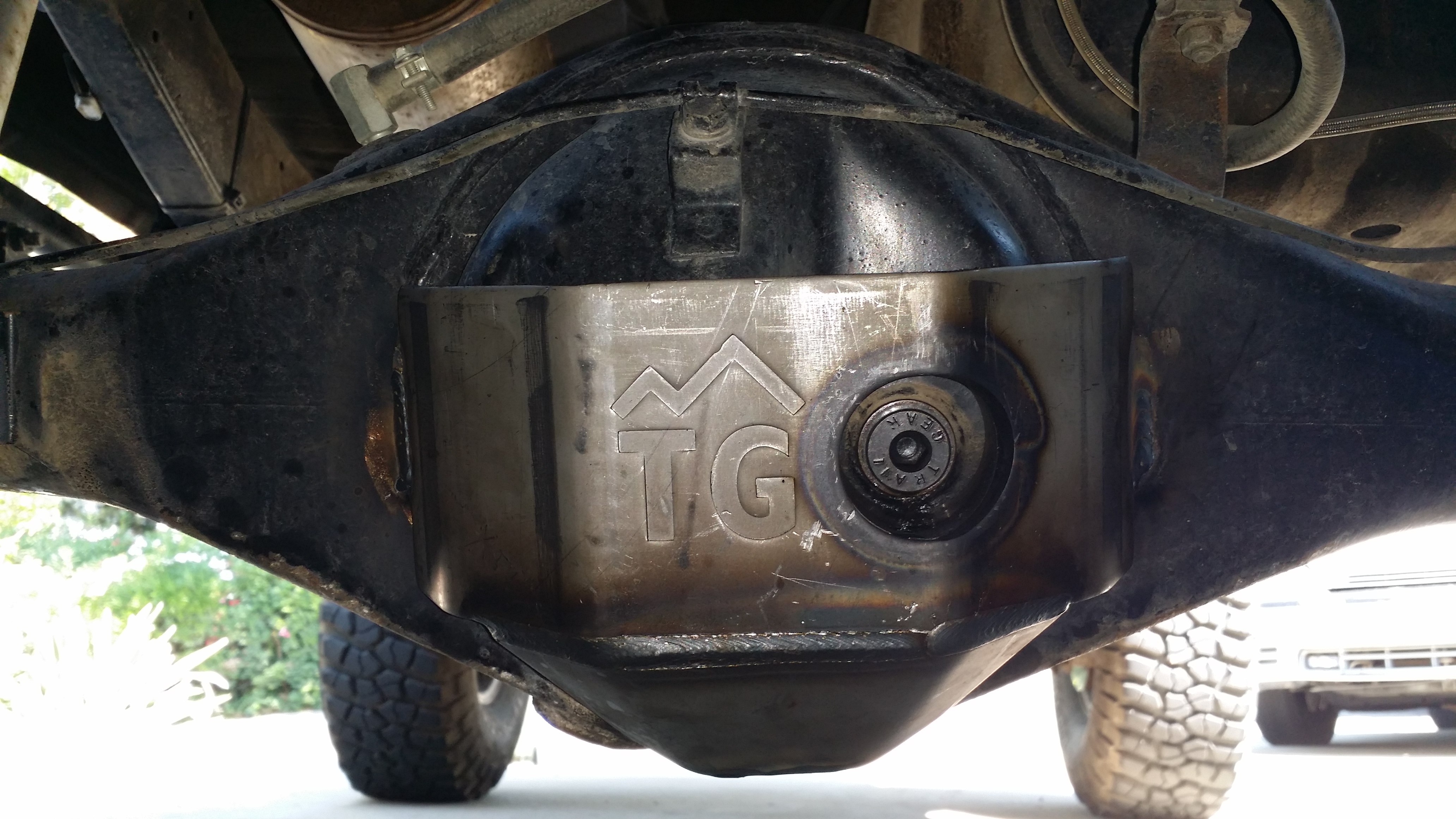

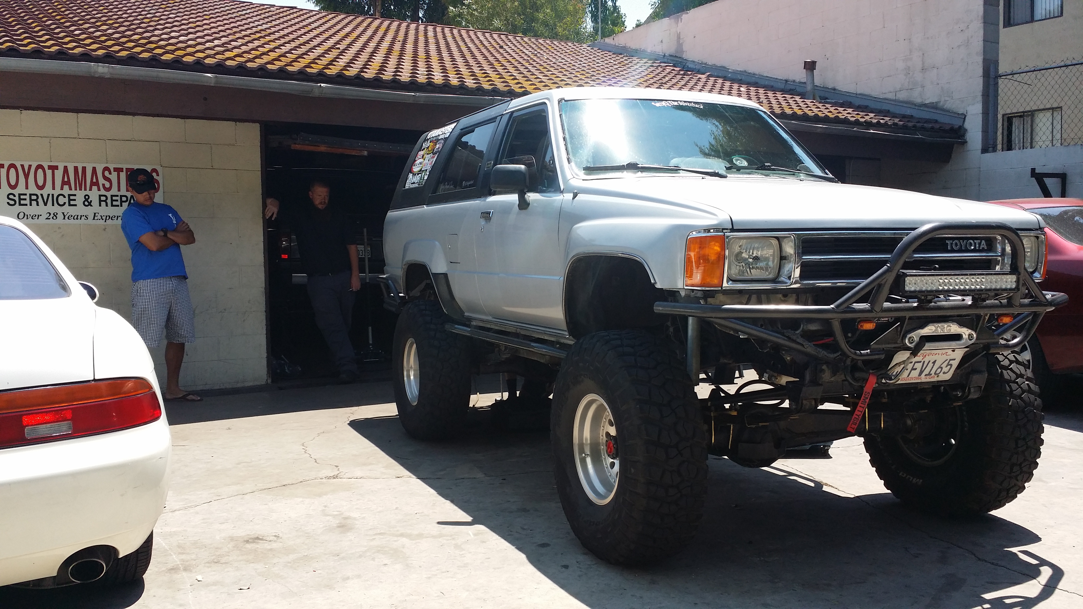

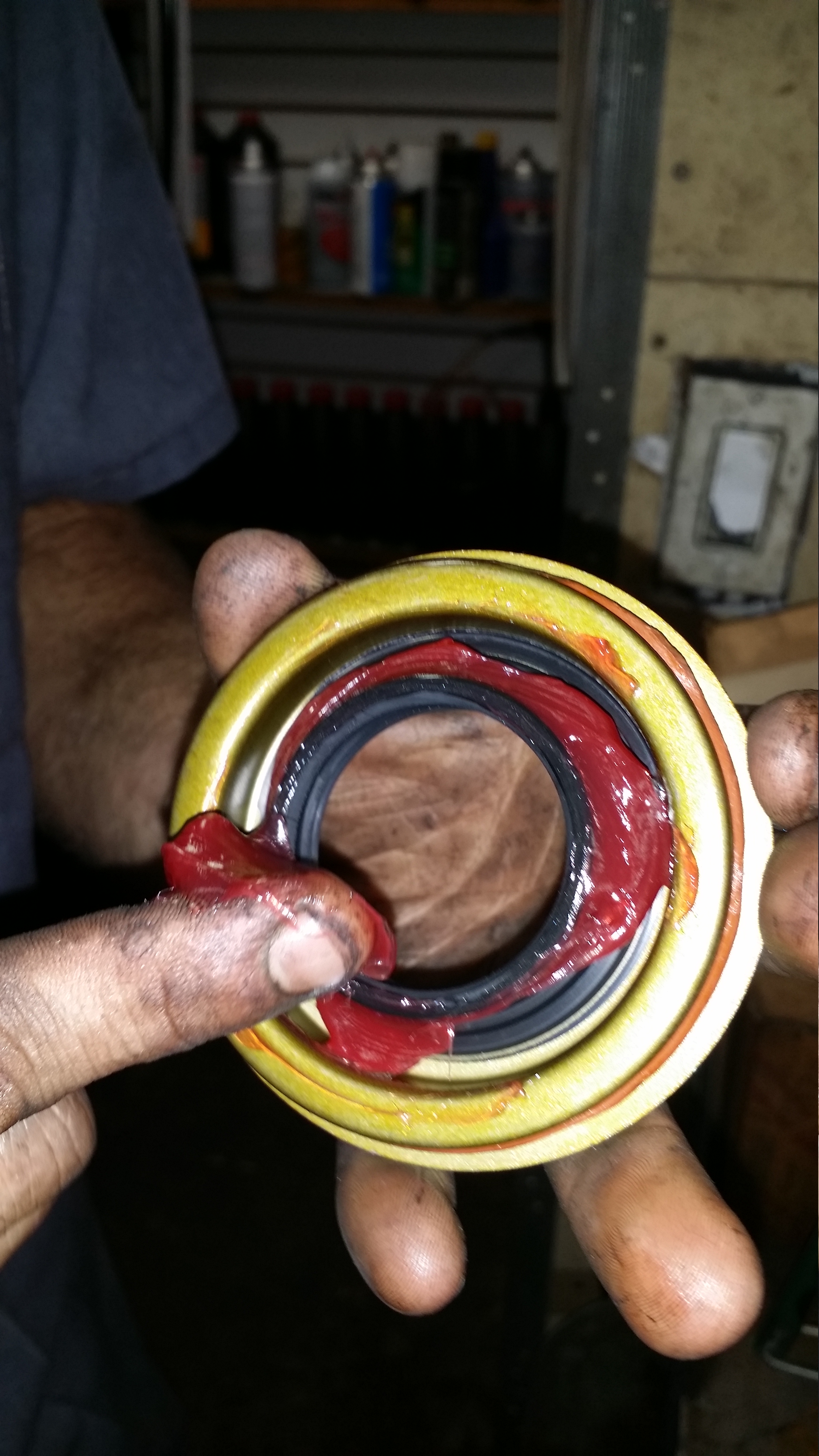

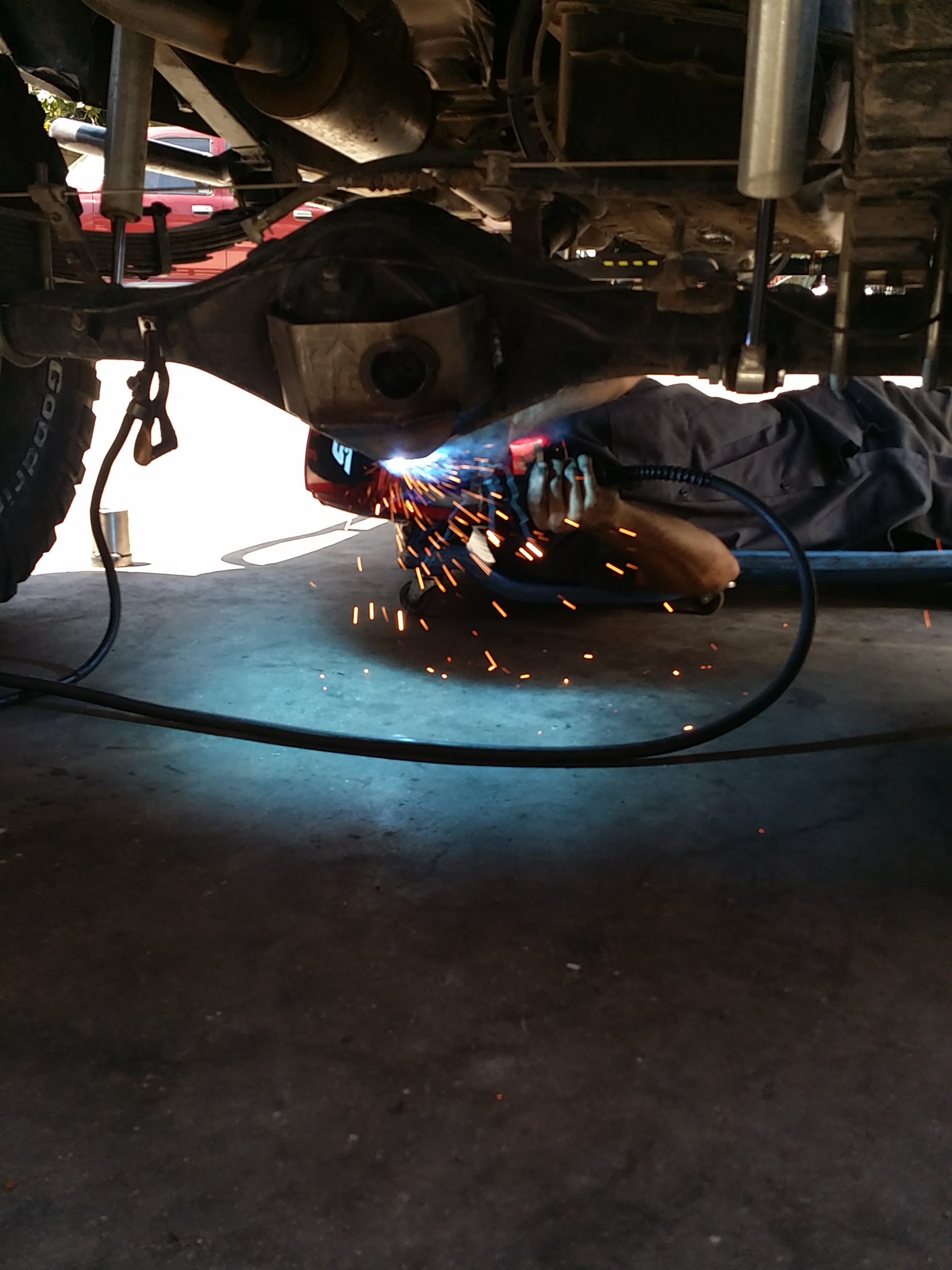

Stopped by Yotamasters trying to put some miles on the new diff, and cuz the pinion seal must have been damaged during install(Eric said to just come out and they'd slap a new marlin eco-seal)....
Also had the new larger diameter fill plug Journal trail-gear rear armor slapped on....

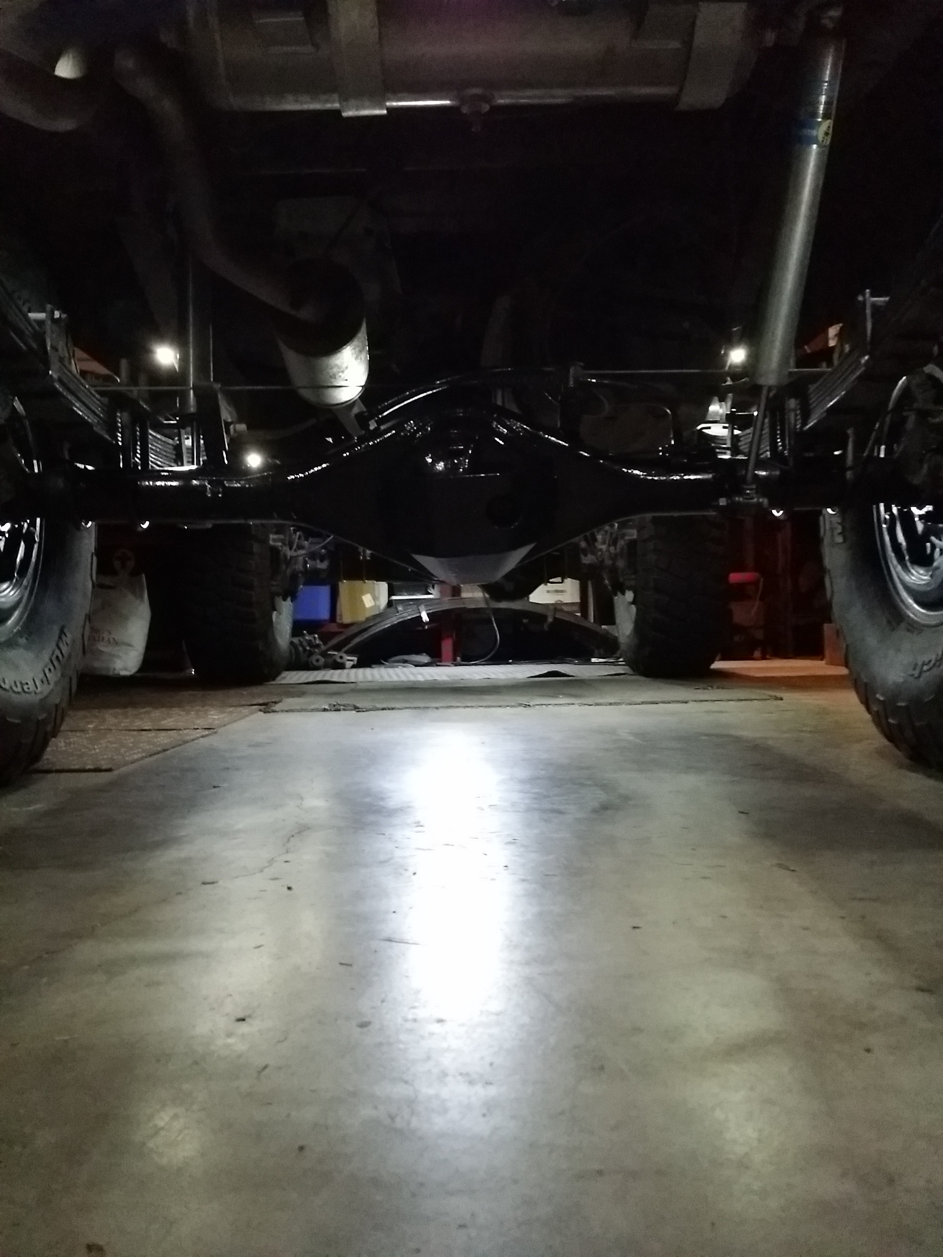

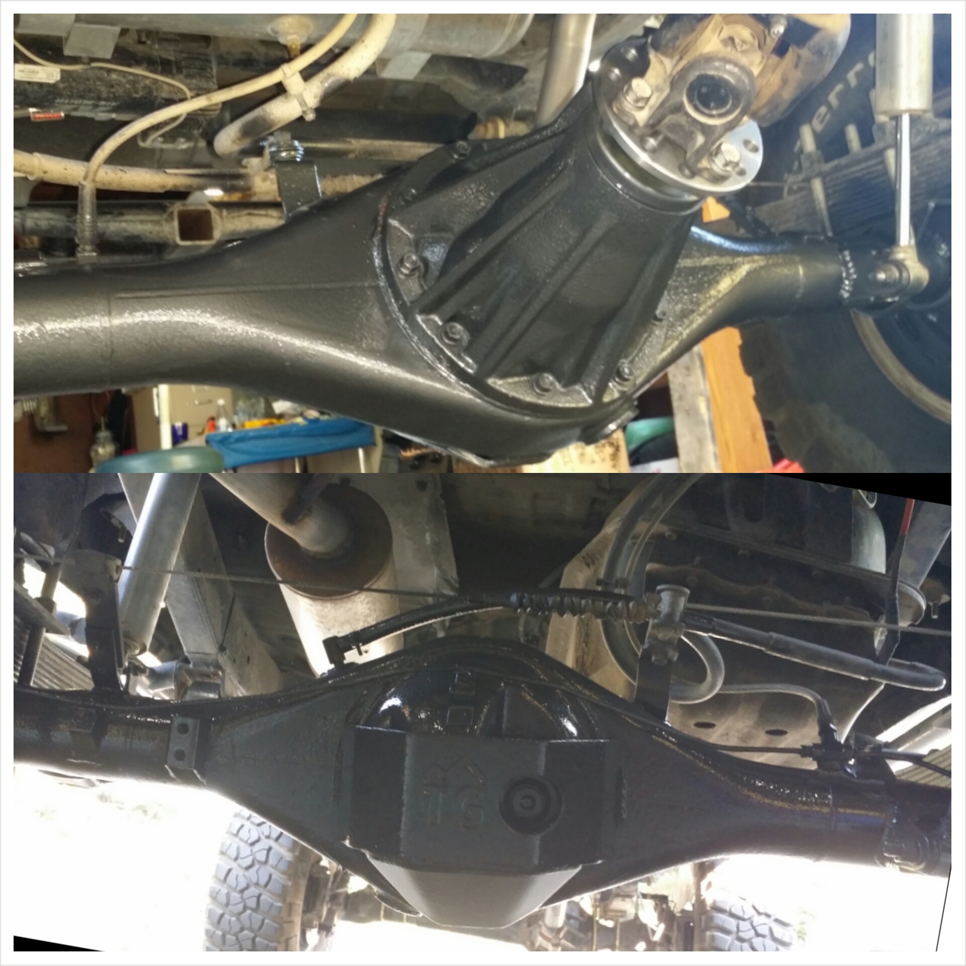

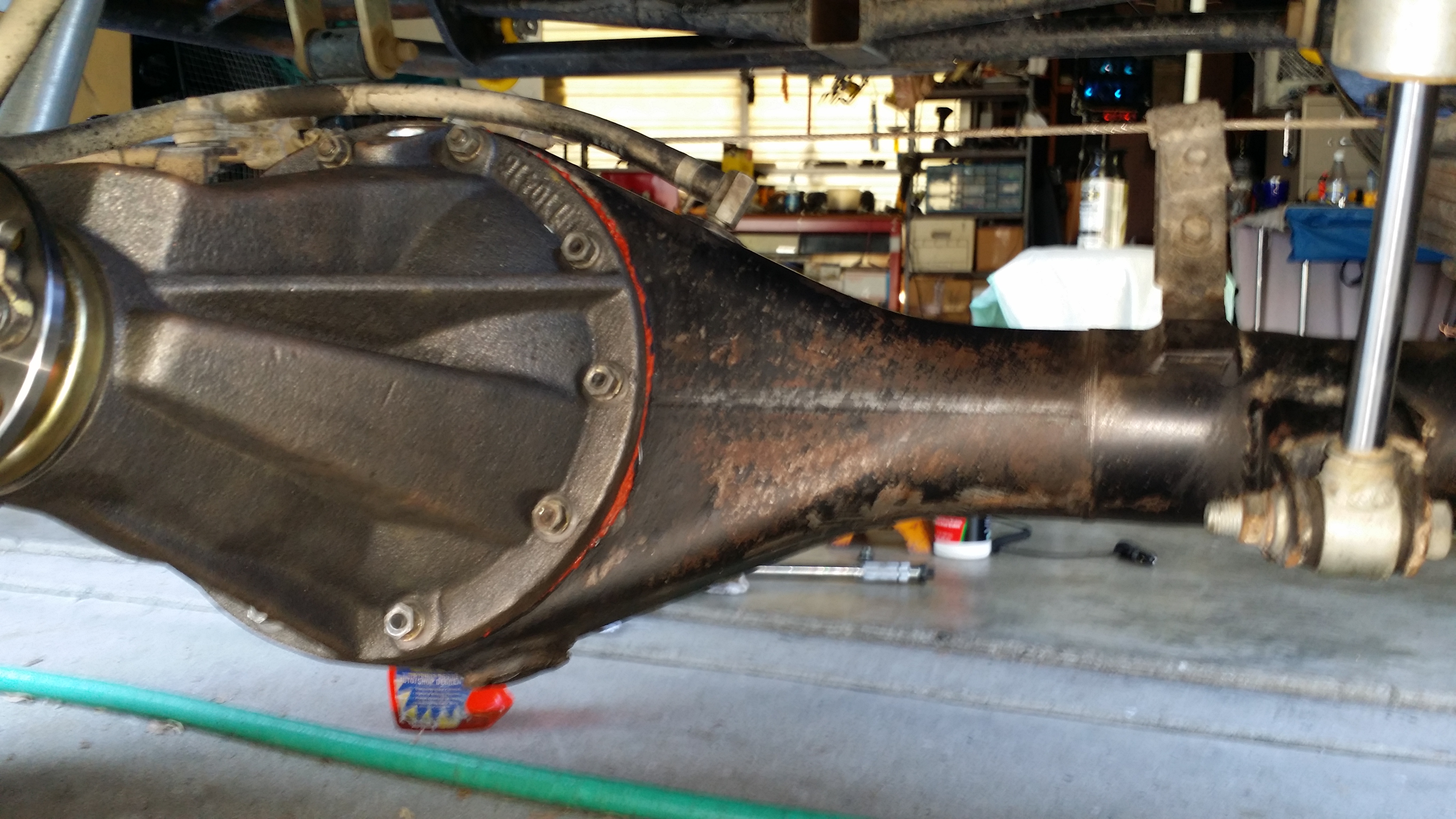

Thoroughly cleaned up the axle and new v6 differential......
Then, went all hammered black with it all! Lol

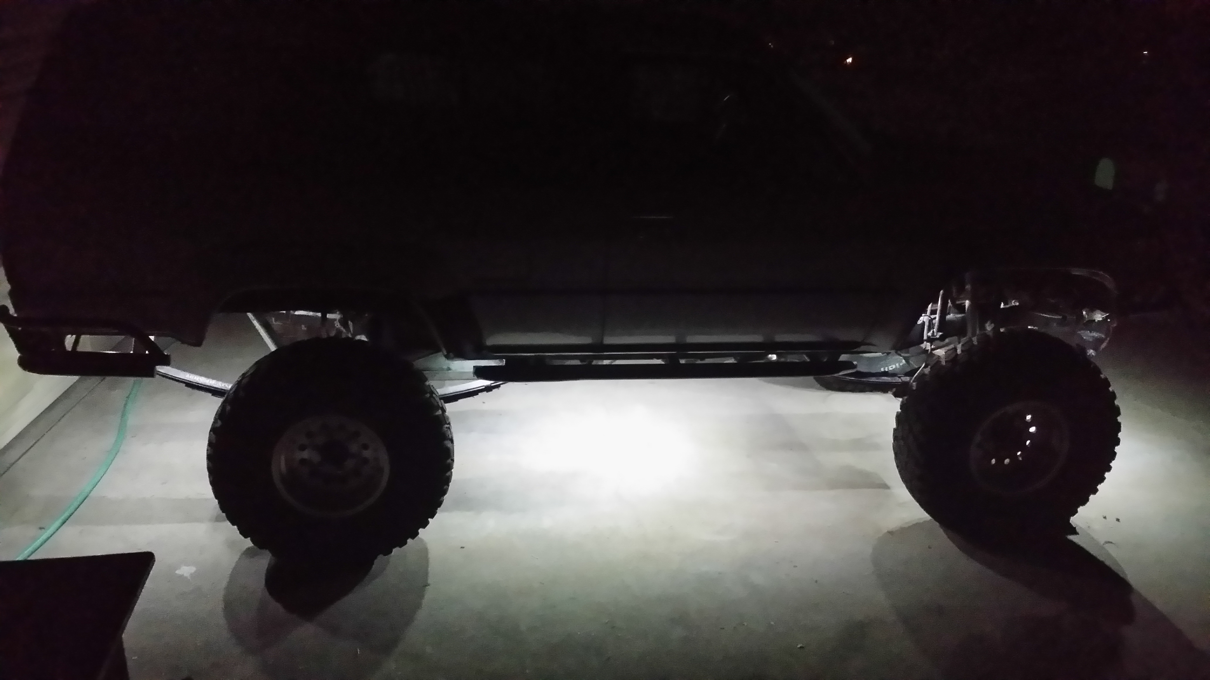

NOW, onto the tunnel mod/fabbing, to clear things after removing the body lift!.....PRAY ON THIS! Lol
