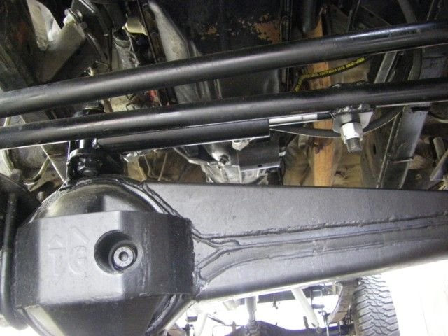

well its been over a year since i have posted in here on my truck. it had been on hold due to other projects taking priority. last year I did my SAS and my rear F150 spring swap. I couldnt use 4x4 because I had to get a front driveline and regear the rear. The front axle is sitting on ruf springs with a couple f150 leafs mixed in, I have an Elocker in front with tg high steer and a surplus center hydro assist setup. I have installed my dual cases with 2 stock 2.28 cases and tg twin sticks on the rear case. I had a front driveshaft made using a tg long spline kit. For the rear I have a grizzly locker and rotated the spring purches to point the diff up at the transfer case output. I made a custom transfer case cross member. lastly i made a custom rear bumper witch i am planning to add a tire carrier in the next week or 2. I just installed some new 35inch at tires with new rims. cant wait to do some crawling this season. Here are a couple pics I took.
new rear bumper
dual cases with twin sticks
front axle with armor and hydro assist
steering box with hydro assist fittings

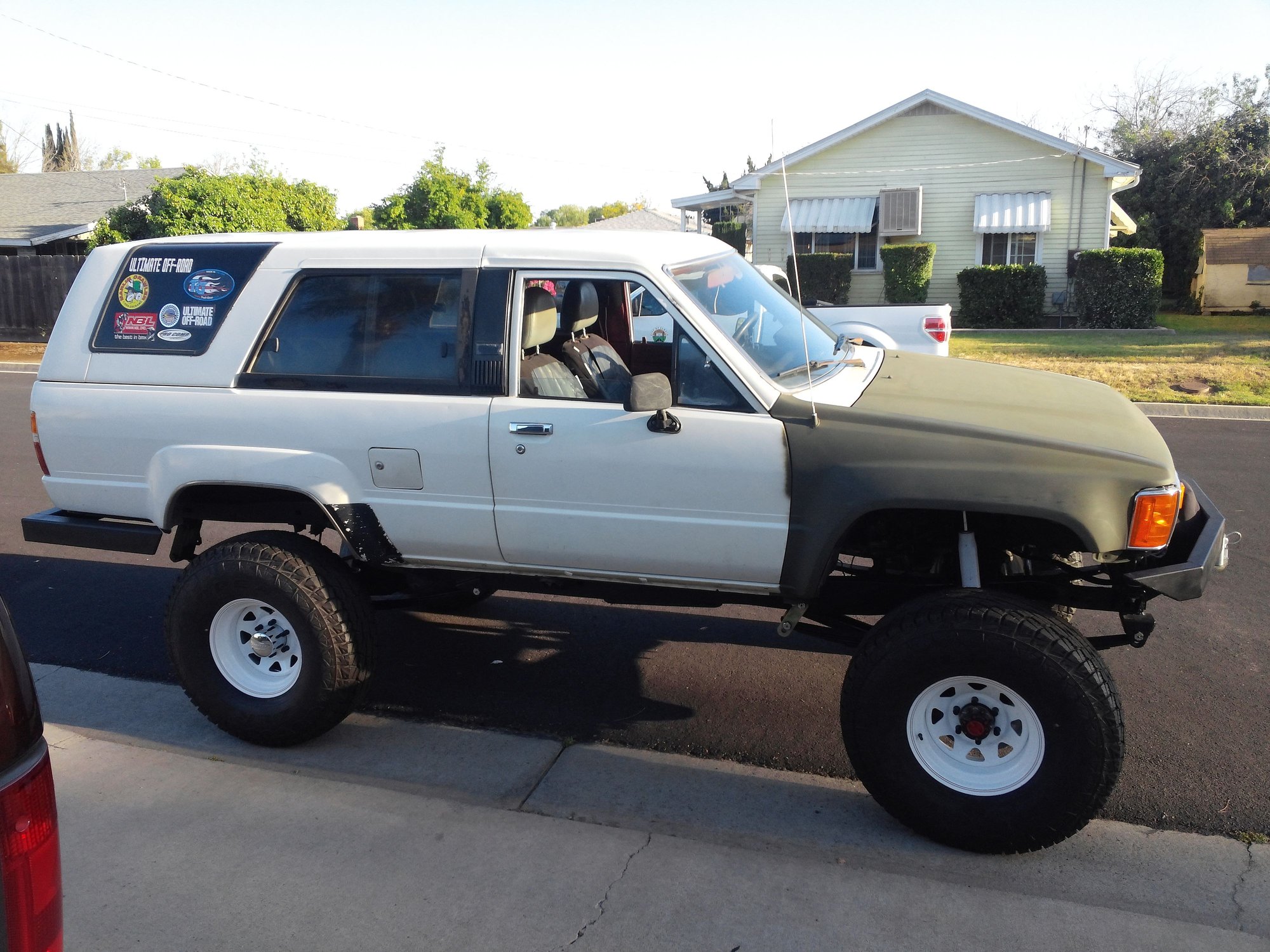

Here is a current pic of my truck with my new tires.
