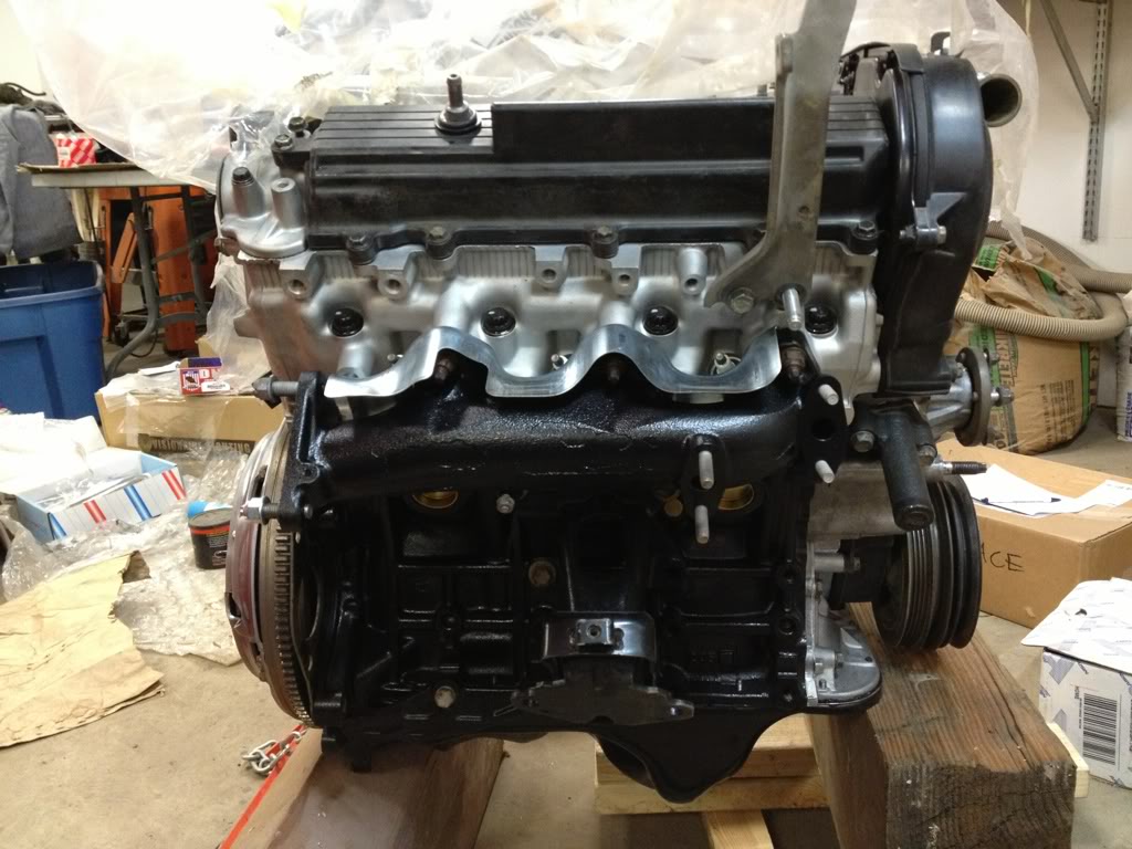

I haven't got to do much work on my truck in awhile due to family issues. This is where it sits now. As soon as I get a free weekend, I will drop it into the truck.

Motor looks good!!! I plan on doin the exhaust crossover mod soon just to keep extra heat away from the #6 cylinder. but thats just me. good luck on the build. cant wait to hear it run!

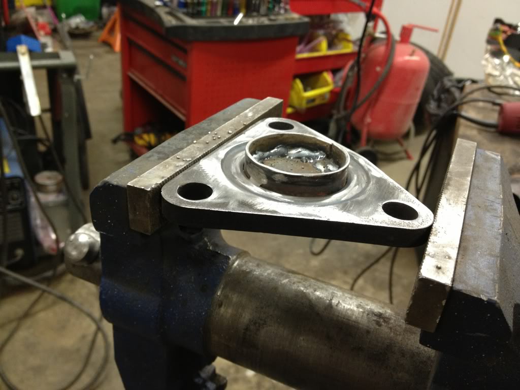

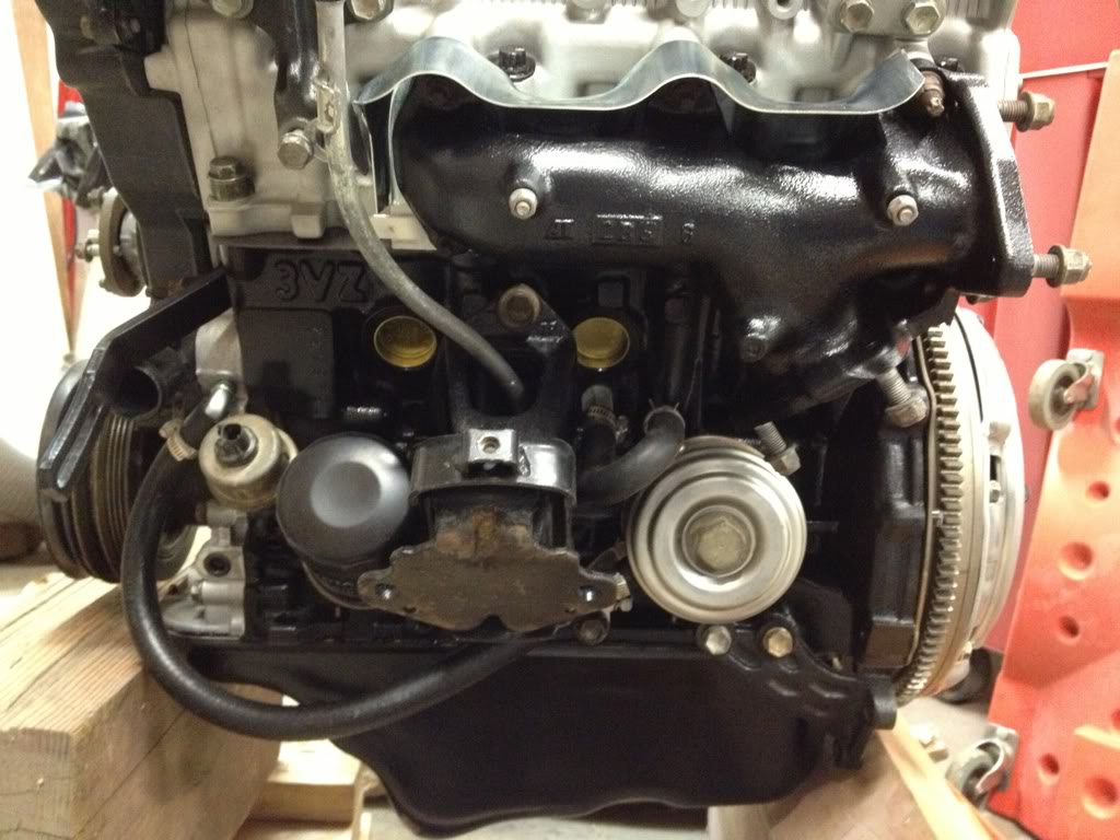

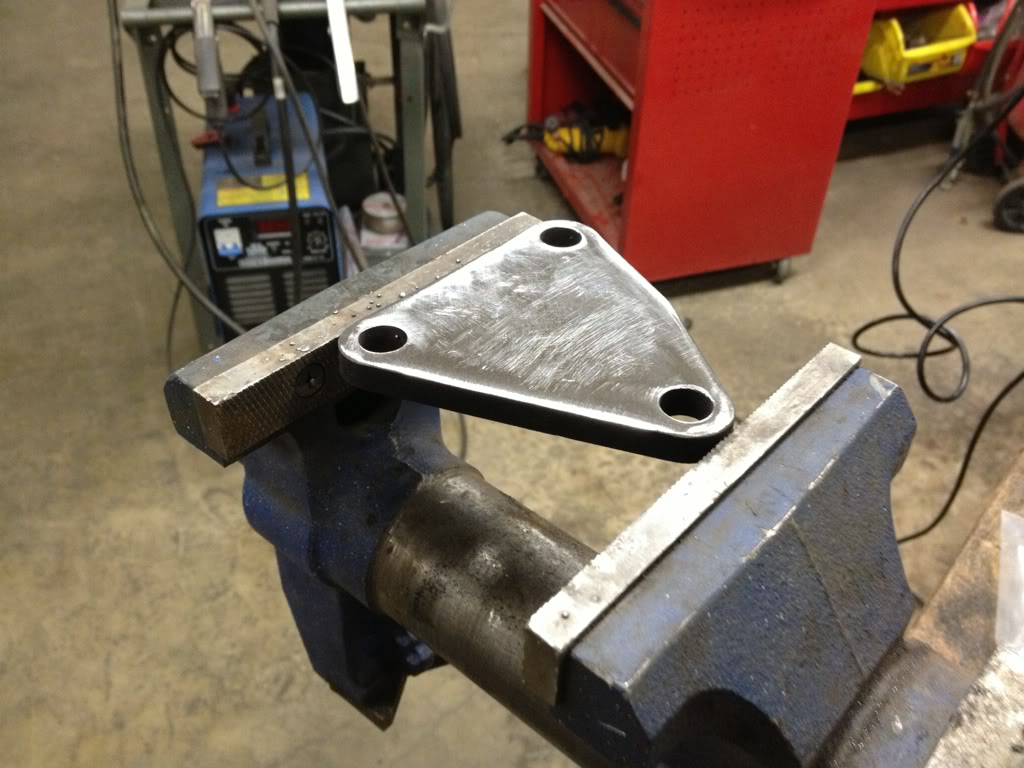

Well, now I'm commited to the exhaust crossover elim. mod

Coming along nice man! I think the crossover elimination will go good for you. Keep the pics coming!

Looks like its coming along nicely. I'm just browsing the build threads trying to get myself inspired for my own.
One problem I noticed. In your pics you have the knock sensor plug sticking out at the back of the engine. There is a square shaped knock out on the drivers side head that this should have gone through(between the head and intake manifold). I'm sure it will still work the way you have it but I don't think the factory wiring will be long enough. Will the knock sensor work correctly if you made up a wiring extension?
Just a heads up, it's those little things at the end that get frustrating.

Green93 - you probably just saved my whole project. My old engine had the sensor wire coming out the back but someone had extended it by a foot or more. I was kind of worried it would not reach now. I will look into where you say it should be. Thanks!

Curses on the previous owner! I did some searches and found where the knock sensor wire SHOULD have been. Now I have to pull the intake off and try to not mess up my timing. Thanks for catching it for me before I got any further.

That was where it was plugged in before? Has the wiring harness been modified to reach? If it has you could just leave it. I just wanted to make sure you were aware.
