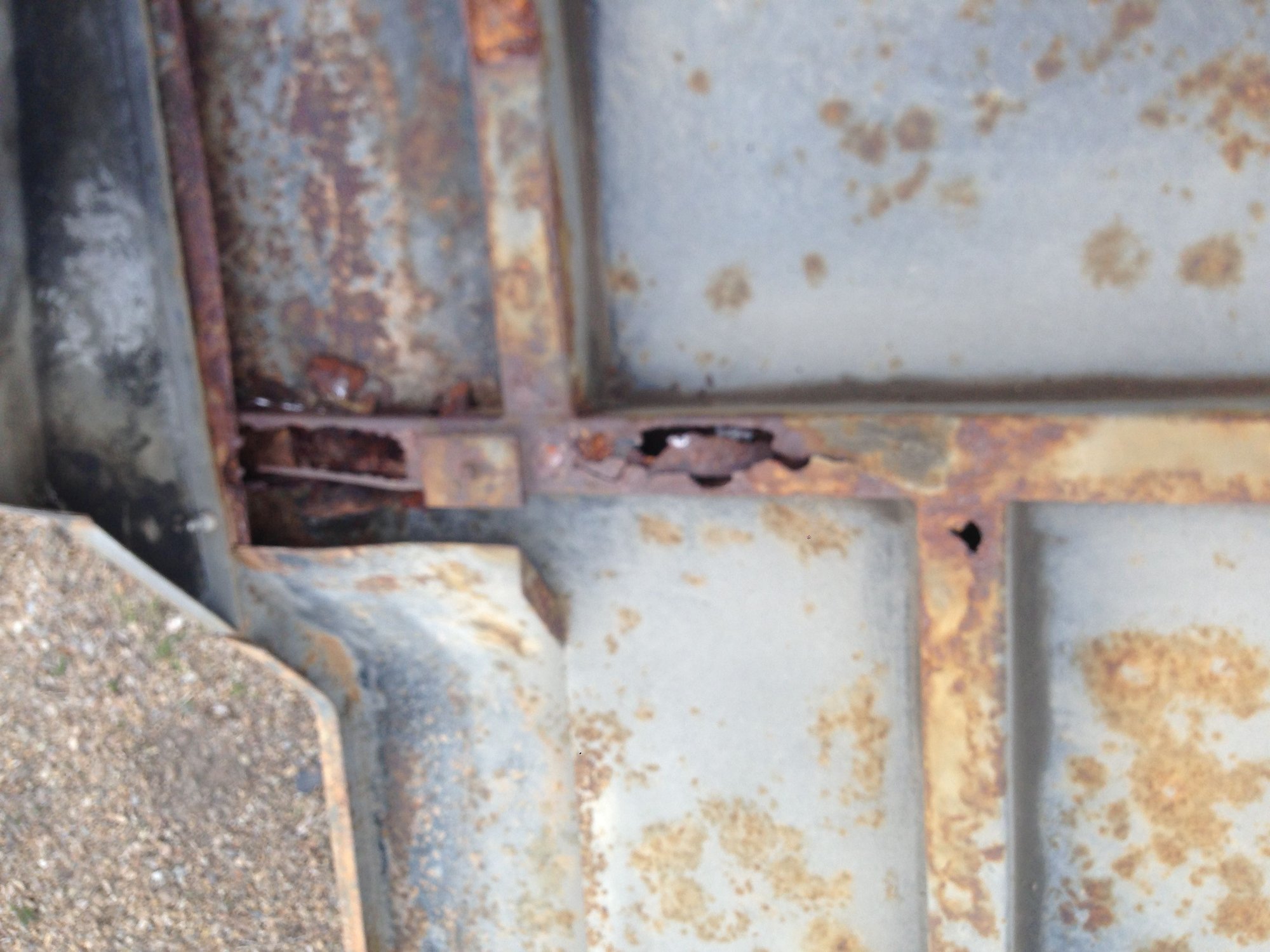

I got started on the repairs to the box this weekend. As you can see the whole sub frame was either rotten, or very thin, so I cut it all off.
I had a lot of 1-1/16x2-3/8 tube so I uses that instead of the 2x2 the bed originally had.
The inner beams are just laying there, not welded in. I ran out of gas for the welder.

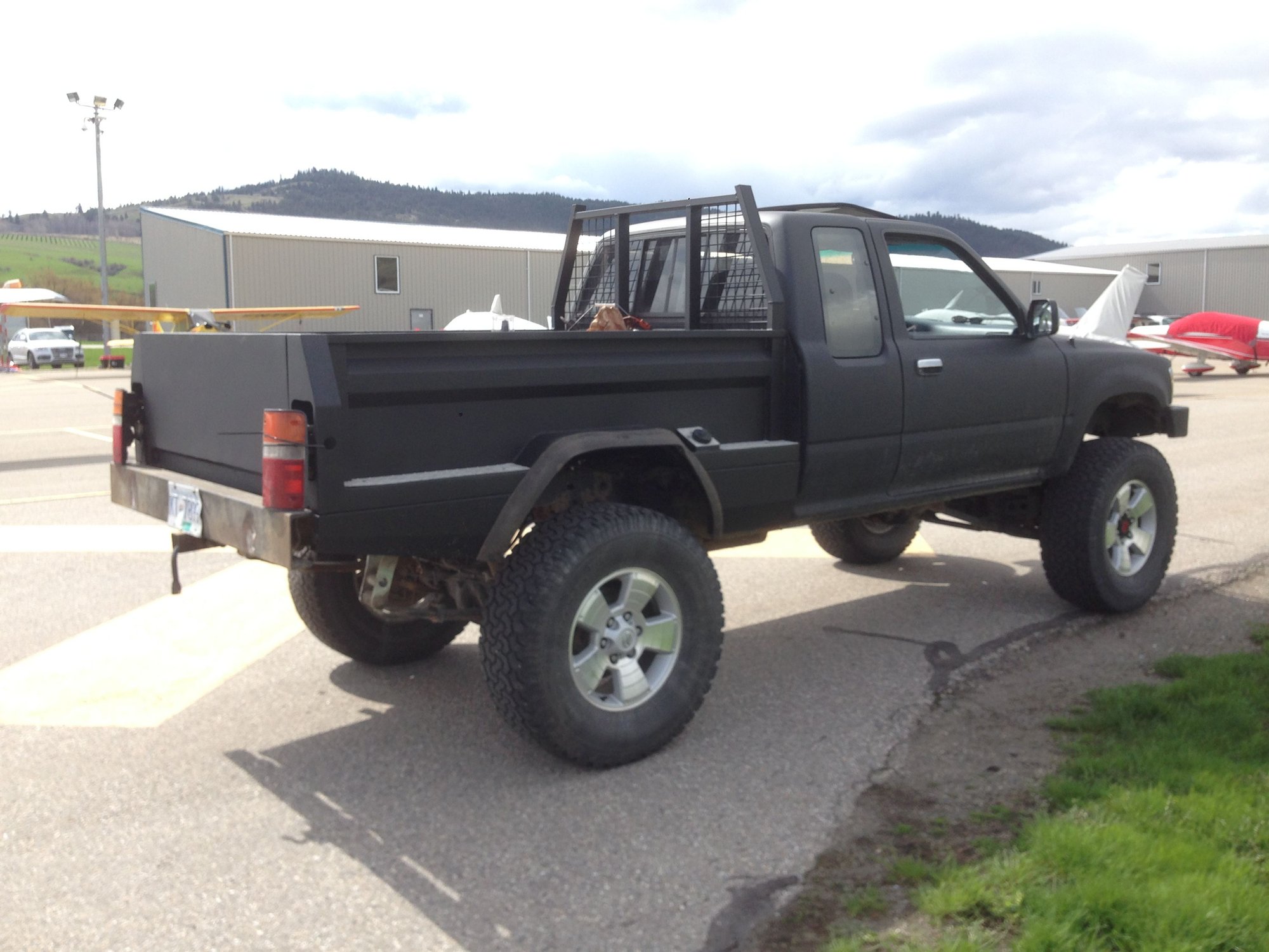

It's on!
Ran out of time, still have to modify the wiring for the lights, so I just zip-tied the factory ones on for the day.
Still need to build mud flaps, but the rear flares are on. Used the rubber flares off a Kenworth hood from the local truck salvage yard.
