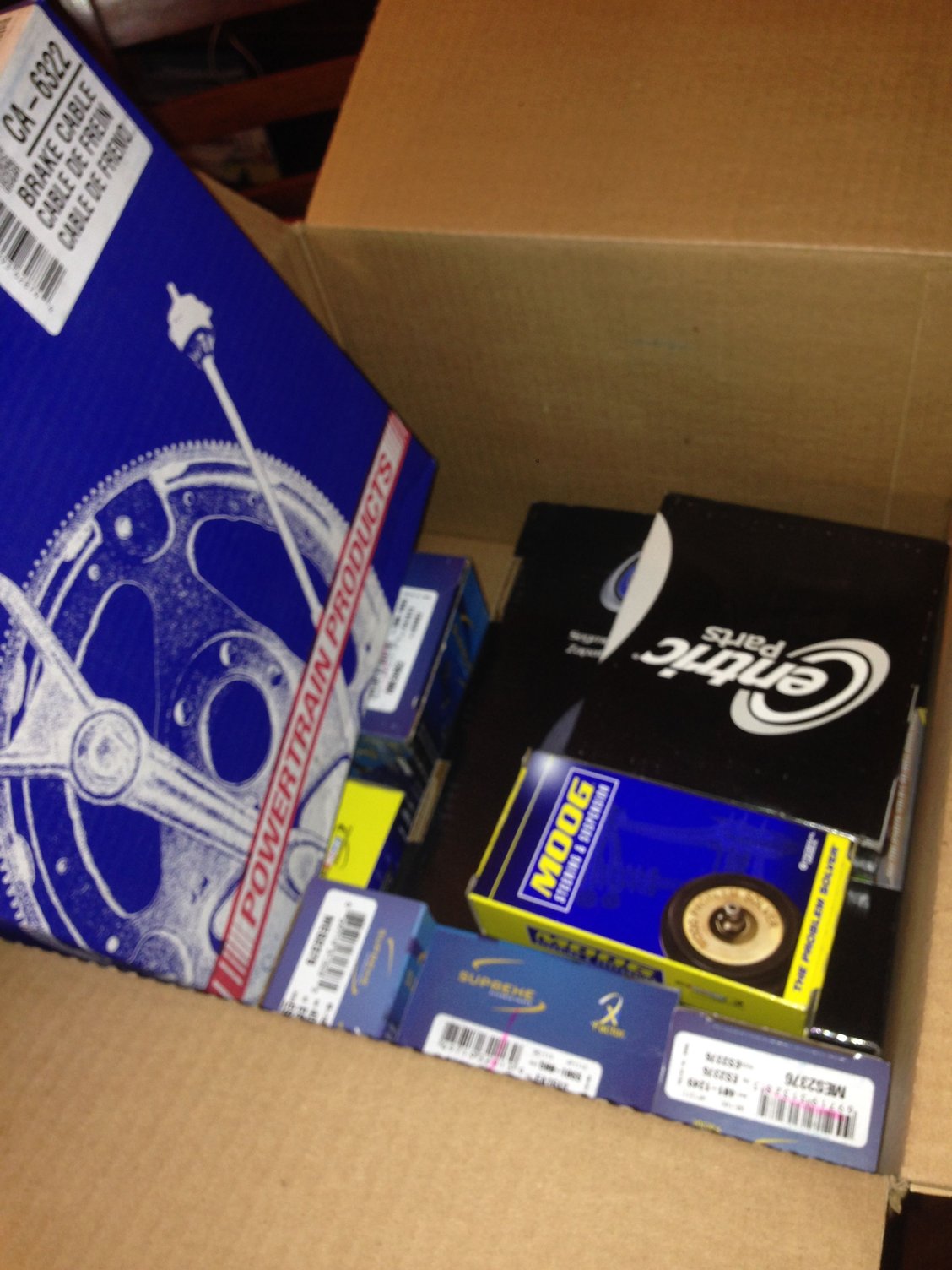

Thanks! Found a nice surprise at the door after work today!
Thanks Rockauto!
It's like Christmas all over!
Hopefully I can get some time this weekend.
Upper ball joints, tie rod ends and adjusters, rear e-brake cable, and rear brakes!
