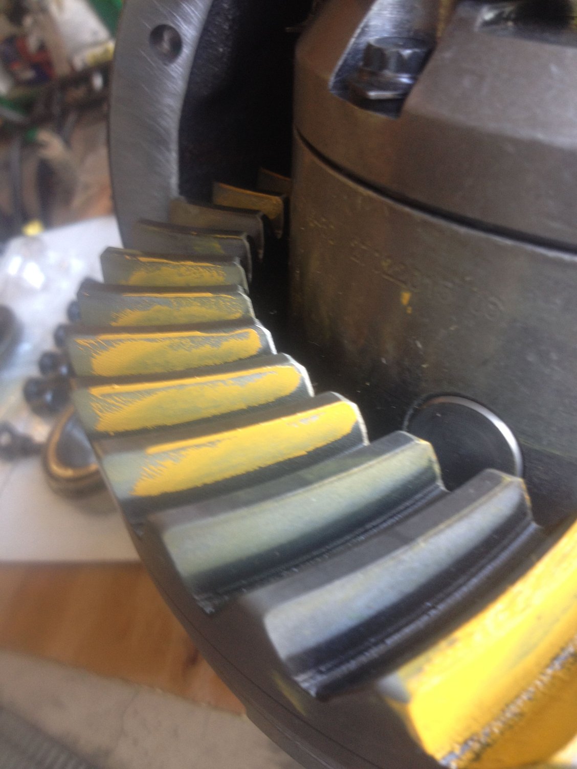

New update, I got the used differential housing and started to set up the locker and gears. It's only been 20 years since I did a differential rebuild. I ground down the inside of the old pinion bearings so I could use them as setup bearings trying multiple combinations of pinion shims and remind myself what a good pattern is supposed to look like. here is what I settled on. Any thoughts?

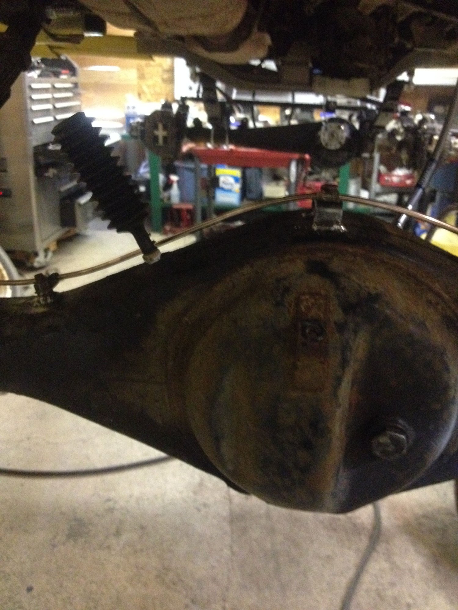

New brake lines, creeper breather
welded tabs and hand bent lines
got some 37 inch boggers on new wheels from a friend, only about a 400 mile round trip but a good price.
I thought this showed up well in primer, and no, I'm not the greatest welder. should hold though

What was rational for running brake lines over housing and spring plates? I'm rerunning mine soon.
had to reach the center of the rear axle, I wasn't going to run it underneath anything, I run through brush and mud when I'm hunting. I went around the back of the spring plates so I can still set up bump stops.
