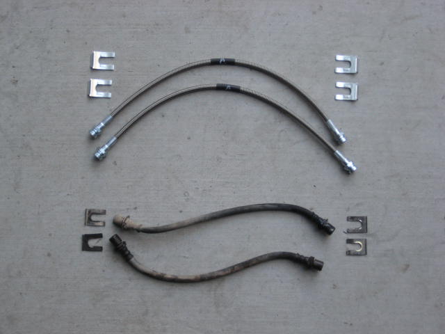

Brake lines
Brake line removal is pretty easy. I happened to have a 10mm line wrench. To get the clips out is a little tricky. I used a set of needle nose vice grips and a flat blade screwdriver with the widest blade i could find. Be sure to have something big enough to catch all the brake fluid that drips out. Quite a bit comes out both sides total and a beer can cut in half didn't do the trick...oops.
