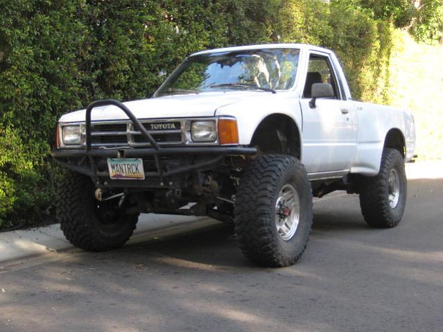

Here are some before pics...

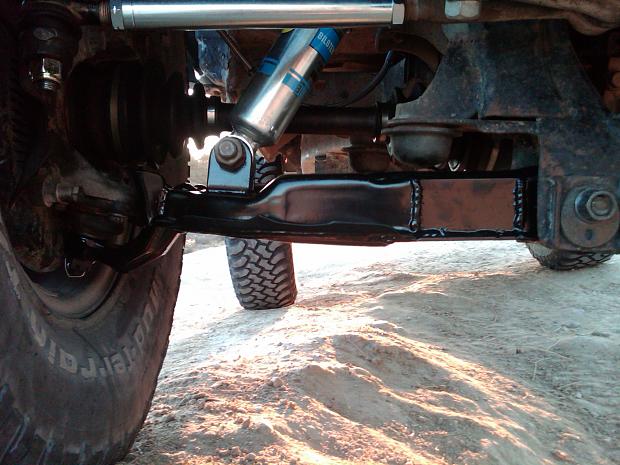

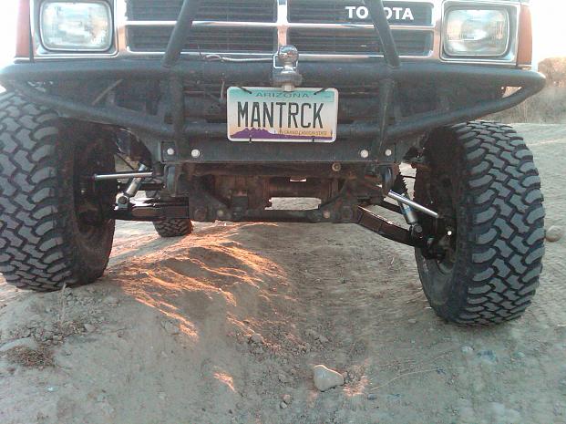

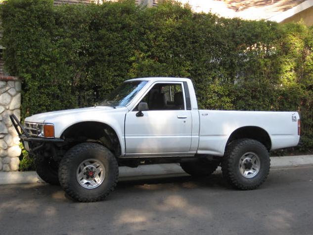

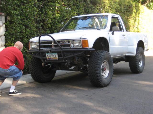

After installation
flexed..
Attached Thumbnails aalba92691's 1988 Pickup Build-Up Thread-img00021-20091116-1623.jpg   aalba92691's 1988 Pickup Build-Up Thread-img00022-20091116-1623.jpg   aalba92691's 1988 Pickup Build-Up Thread-img00023-20091116-1624.jpg
Old Nov 21, 2009 | 06:48 PM
  #167
93YotaMonster's Avatar
Posts: 283
From: Mocksville NC
dam that looks good

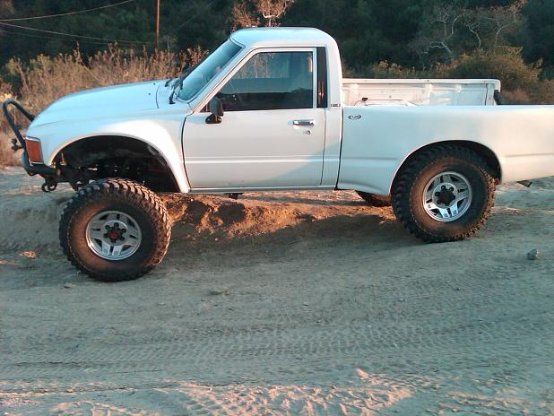

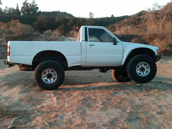

more after pics
more pics
Attached Thumbnails aalba92691's 1988 Pickup Build-Up Thread-img00024-20091116-1624.jpg   aalba92691's 1988 Pickup Build-Up Thread-img00025-20091116-1625.jpg

looks sick! wicked flex for ifs lol you should post that pic in the ifs flex thread haha.

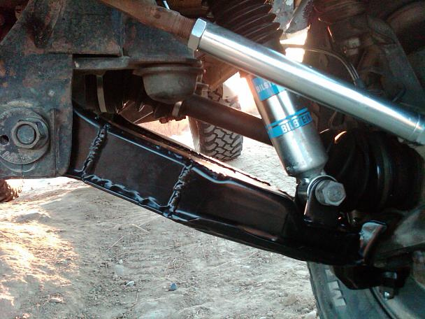

more pics
my frickin internet took a dump... i had to restart my computer and reset my modem.....aaaaahhhhhhhhh..... anyways
Attached Thumbnails aalba92691's 1988 Pickup Build-Up Thread-img_0950.jpg   aalba92691's 1988 Pickup Build-Up Thread-img_0953.jpg   aalba92691's 1988 Pickup Build-Up Thread-img_0954.jpg

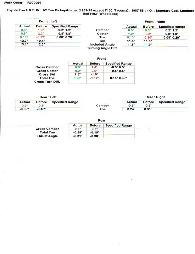

alignment specs
here is a scan of the before and after alignment angles..... as you can see it was able to be adjusted to within factory specs......what more can you ask for!
