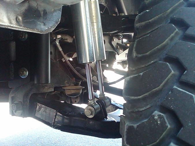

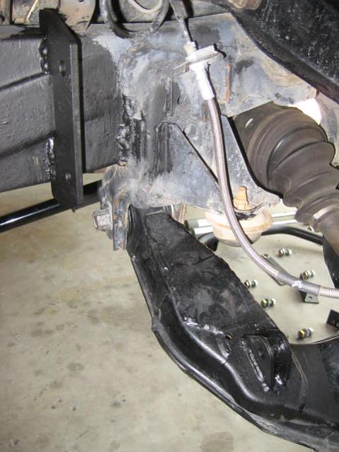

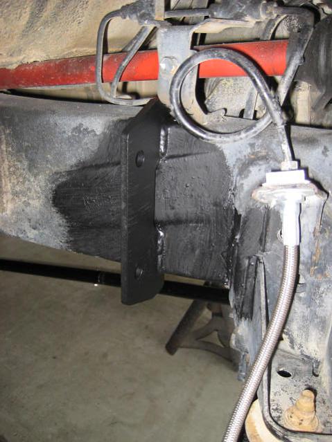

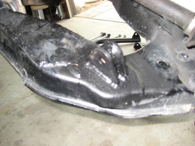

These are the shock tabs and frame tabs welded on and painted with some rustoleum brush paint. Positioning of the frame tabs was quite simple. The tabs were simply bolted onto the hoop assembly and attached with the front mounts using the same bolts as the idler arm. The rear was then positioned perfectly where it needed to be on the frame then clamped and welded.
The shock tabs required some measurements and lines drawn at right angles over the LCA to get positioned properly. Once they were in position it was a matter of tacking and finishing the welds.
Attached Thumbnails aalba92691's 1988 Pickup Build-Up Thread-img_1830.jpg   aalba92691's 1988 Pickup Build-Up Thread-img_1829.jpg   aalba92691's 1988 Pickup Build-Up Thread-img_1828.jpg

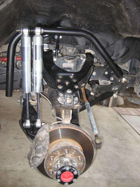

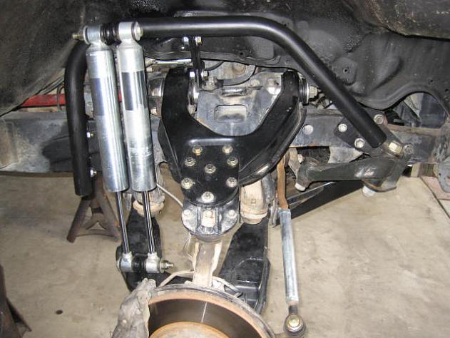

After all tabs were welded and painted, the top brace and bracket assembly was installed using the existing bolts from the UCA shafts. The rest of the hoop simply bolted on, shocks were installed and here are the pics....
Attached Thumbnails aalba92691's 1988 Pickup Build-Up Thread-img_1845.jpg   aalba92691's 1988 Pickup Build-Up Thread-img_1848.jpg

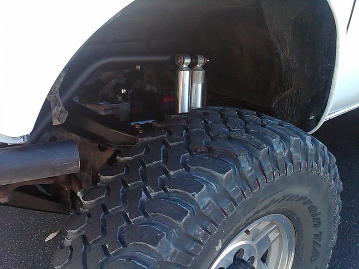

some pics of the kit installed
Attached Thumbnails aalba92691's 1988 Pickup Build-Up Thread-img00010-20100426-2231.jpg   aalba92691's 1988 Pickup Build-Up Thread-img00018-20100511-0842.jpg   aalba92691's 1988 Pickup Build-Up Thread-img00017-20100511-0842.jpg

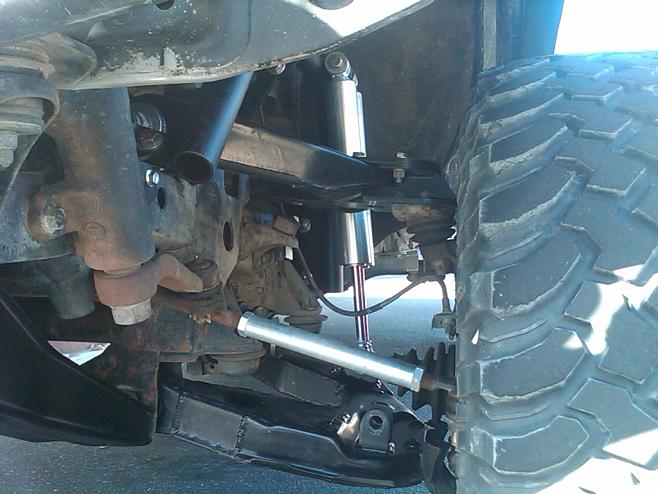

More final install pics............ After this kit was bolted on, of course I went out and beat on it. One of the major differences I noted was even smoother operation of the front suspension. Before the install the Blazeland kit worked great, but I had noticed that bumps and dips were felt a lot more then after the install. for me actually the difference was night and day !! Let me know what you all think.. comments and questions anyone?
Attached Thumbnails aalba92691's 1988 Pickup Build-Up Thread-img00019-20100511-0842.jpg   aalba92691's 1988 Pickup Build-Up Thread-img00024-20100511-0845.jpg   aalba92691's 1988 Pickup Build-Up Thread-img00016-20100511-0841.jpg

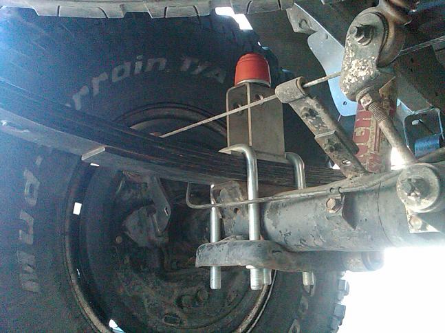

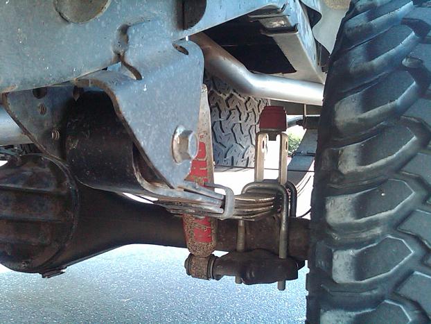

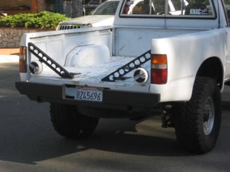

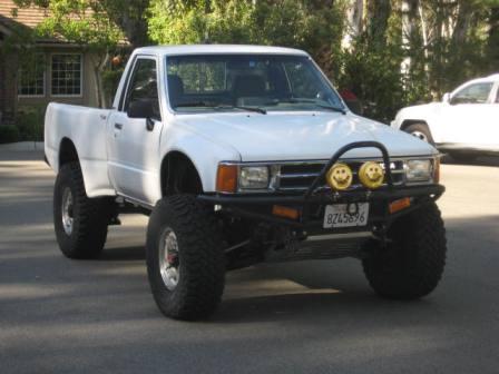

Blazeland Modified stock Shock Mounting/Leaf spring plates
So, whats up everyone?? Its been a while since I've posted any updates on my Blazeland equipped rig... Last mods I did to my rig were downey lift springs with the deaver mini pack. I had 8 inch travel rancho shocks dampening my rear end, but they were limiting my droop travel. I couldn't use longer shocks with the stock mounting hardware because longer shocks would solve the droop problem, but instead would bottom on themselves. Since then I have been in touch with Nate from Blazeland. I explained to him the issue and asked him if he had any Ideas. Well some time later he got back to me and came up with some modified stock spring u-bolt plates. They allowed me to use a longer bilstein shock, and gave my rig some more rear travel. I also added some longer shackles and some progressive bumpstops. Nate supplied some spacers as a safety so the shocks wouldn't bottom out. What do you guys thinK??? (By the way, I'm still planning on doing a deaver F55 spring under setup, but no fundage yet!!!)
Attached Thumbnails aalba92691's 1988 Pickup Build-Up Thread-c-4.jpg   aalba92691's 1988 Pickup Build-Up Thread-c-5.jpg   aalba92691's 1988 Pickup Build-Up Thread-c-extended_shackle.jpg
Old May 16, 2012 | 07:07 AM
  #336
YotaWoRx's Avatar
Joined: Dec 2005
Posts: 360
From: BFE
some updated photos
I also added some backup lights and offroad lights.

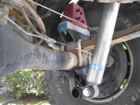

The way these bumpstops are mounted are a fix for a modification that the prevous owner performed, as I had done on my truck pictured below. We had both cut off a bracket from the frame that limited the compression. Without that bracket the factory leaf springs will go into negative arch which is damaging to the spring. In some way this turned out well as now the bumpstops have much more cushion. The 4.5" bumpstops we both used are designed to compress 2" Its nice to be able to bolt in some shims to adjust travel limits. You could also weld a bracket onto the frame to mount the bumpstops hanging down. When I converted to the Chevy 63's not having the factory configuration was good because the spring didn't go into negative arch and I got extra up travel. For this I needed a 2" body lift and fiberglass bedsides or the tires slammed into the fenders.

Back to those below the axle U-bolt mounted shock plates, they do hang down 3-1/2" inches so they may present clearence issues. The 1985 extra cab vintage race truck I co-owned with Albert had some similar configuration shock plates that gave me the idea. That setup has been on the truck for a long time and the loss of clearence for desert wheeling doesn't seem to be a problem.
When it comes down to ease of installation and budget, bolting on modified shock plates is supper easy. You don't even need to jack up the rig. The shocks are off the shelf Bilsteins (for a 4" lifted truck or SUV) (part number 24-185752) that are correctly valved and and direct fit that will bolt in without modification. I am thinking this could be a weld on kit that you gys weld to your shock plates. Anyway here are some photos.
