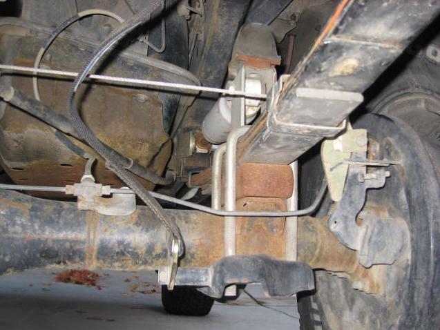

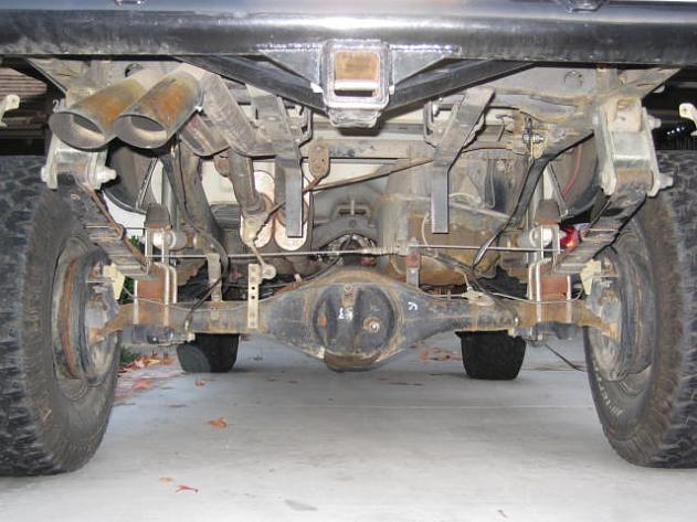

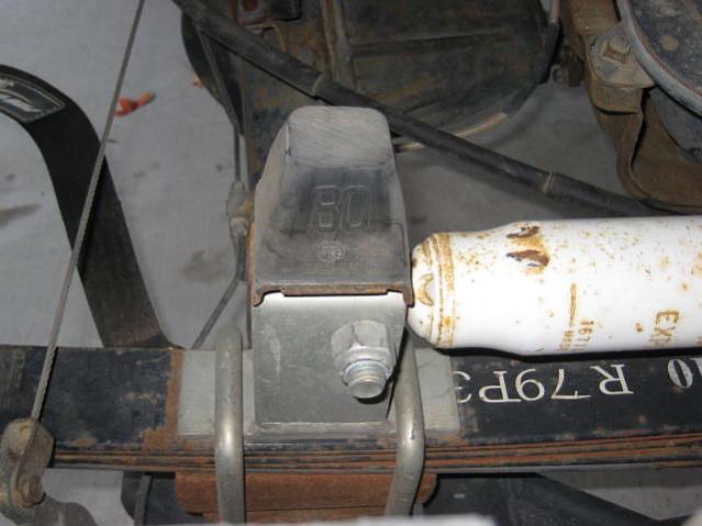

Thanks for the awsome write up on the Blazeland LT. Great job on the install. I like the time frame- installed and aligned on a Saturday, hitting the trail on a Sunday, Sweet! Looks like you had fun with the install too. So, how many Beers did it take?

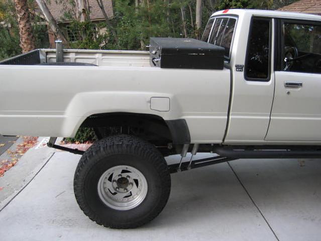

I know you and some of the readers are now pondering the rear suspension options. There are too many to list but I am sure you'll be able to figure out what best suits you needs. Look for about 3-4" of lift.
I wouldn't recommend going this route but here is what I did on the Fordota. Keep in mind I was looking to stablize the rear end, under V8 power loads, as much as gaining wheel travel. I made some trade-offs you probably don't need to do!

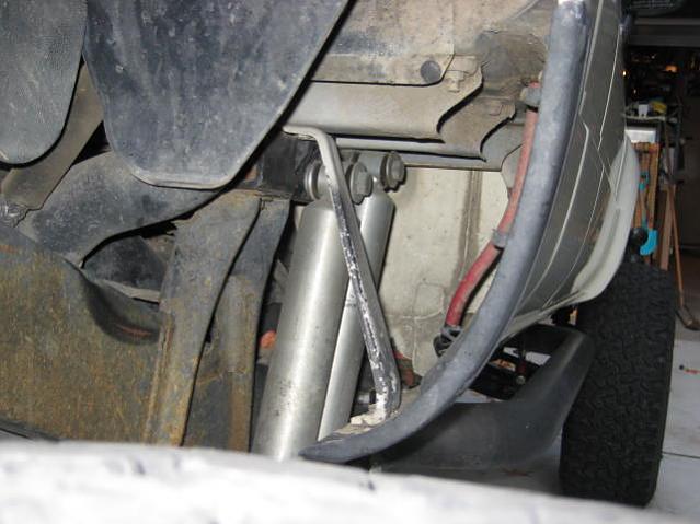

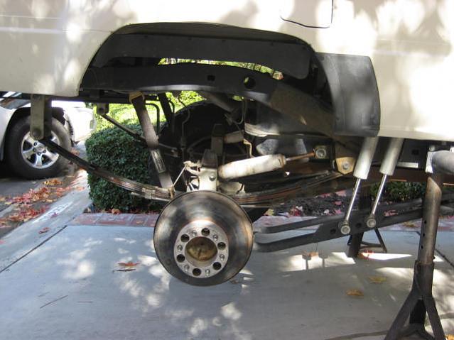

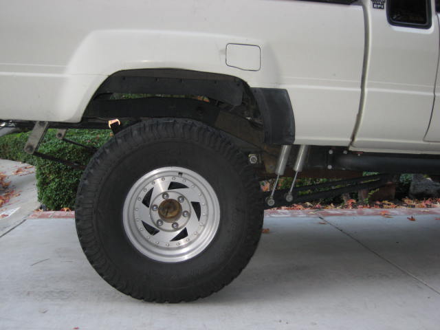

Photo:1 Side View
Photo:2 Pan in closer
Photo:3 Wheel Off View
Attached Thumbnails aalba92691's 1988 Pickup Build-Up Thread-1.jpg   aalba92691's 1988 Pickup Build-Up Thread-2.jpg   aalba92691's 1988 Pickup Build-Up Thread-3.jpg

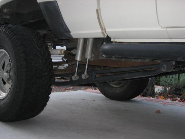

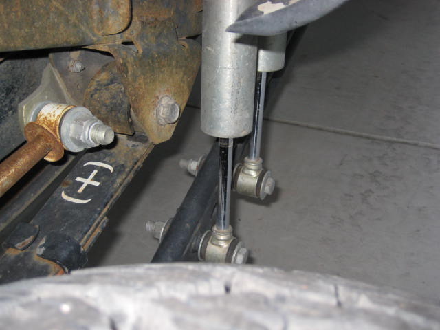

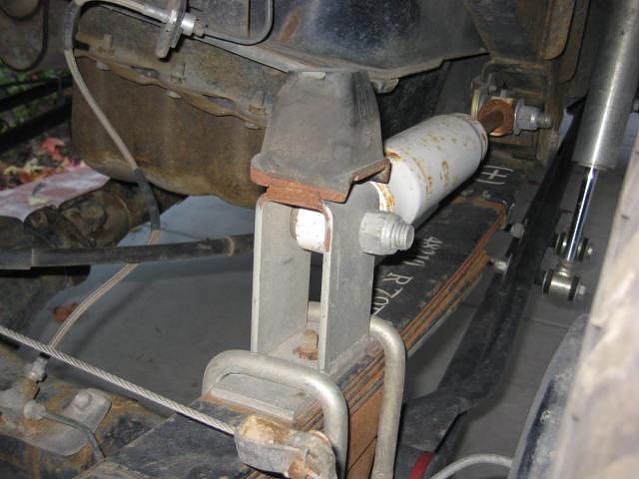

This is the Pro Comp Traction Bars with Optional Double shock. The Pro Comp Shocks were way too short and I wanted more performance so I went with Bilsteins. They were 5100 series with 9" travel. The lower shock mount is prety much Pro Comp but with some gusset work. The Pro Comp bracket for the upper mount didn't allow long enough shocks. I took out the (4) 2" body lift blocks at the front of the bed and replaced them with a 2x2 square tube about 12" long. I then drilled through the tube to insert 1/2" bolts 6" long to cantilever mount the upper shocks.
Photo:4 Side View
Photo:5 Lower shock mount
Photo:6 Upper Shock Mount (modified)
Attached Thumbnails aalba92691's 1988 Pickup Build-Up Thread-4.jpg   aalba92691's 1988 Pickup Build-Up Thread-5.jpg   aalba92691's 1988 Pickup Build-Up Thread-6.jpg

The Traction Bars helped control wheel hop under hard acceleration. I also added some Downey Kicker Shocks for additional stabilization. This combination has some hints of a four link!
The rest of the rear is from Downey. The rear leaf spring pack is Downey 3" Lift Leafs. I removed the factory overloads and replaced with Downey Pre-Runner Leafs. The rear extended length shackle is Downey's as well. The 1-1/2" Blocks are from Superlift. It came in kit form with the blocks, new u-bolts, and brake brackets.

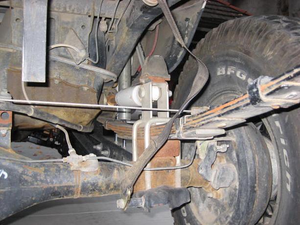

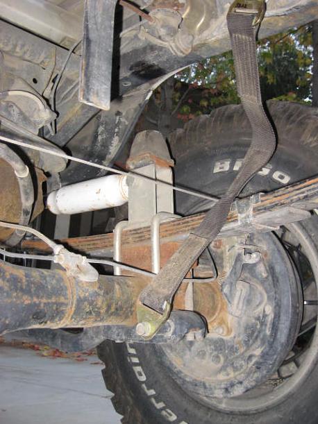

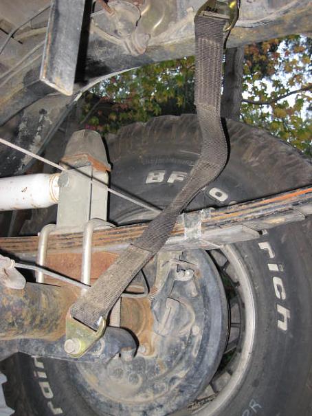

When the suspension drooped out, the shocks on the traction bars eventually topped out. I wasn't using the factory shock mounts at the frame or on the U-bolt plates so that looked like an easy location to attach the limiting straps. I took some measurements then bolted the proper length limiting straps. From the top of the bump stop to the bottom of the frame at full droop the distance is 8-1/2" Factor in bump stop compression and limit strap stretching and the travel for the rear is about 12"
Photo:10 Limit Strap A
Photo:11 Limit Strap B
Photo:12 Limit Strap C
Attached Thumbnails aalba92691's 1988 Pickup Build-Up Thread-10.jpg   aalba92691's 1988 Pickup Build-Up Thread-11.jpg   aalba92691's 1988 Pickup Build-Up Thread-12.jpg
