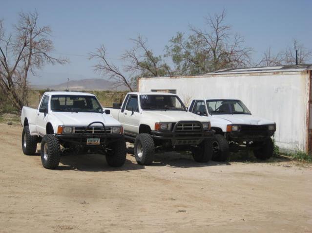

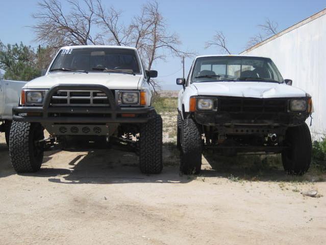

Two weeks Mantruck and I met up in Ocotillo for some desert wheeling. It was a good time. We also pulled some LCA, UCA cores off some of the junkers in the yota graveyard. There is a sweet 1985 P/U extra cab awaiting an IFS swap. Gonna put a Blazeland LT on this rig soon so it can keep up with us.

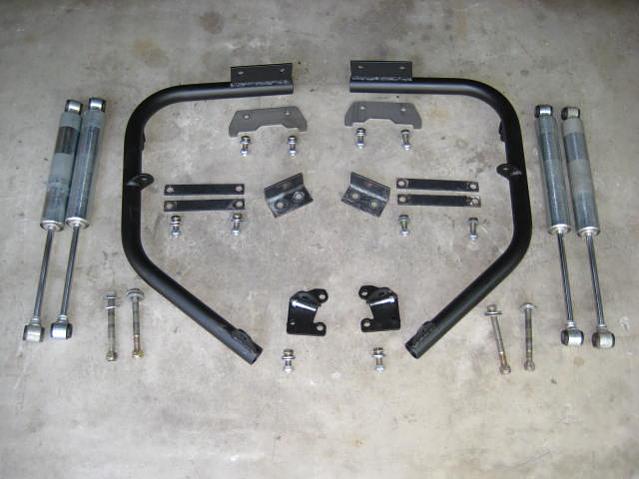

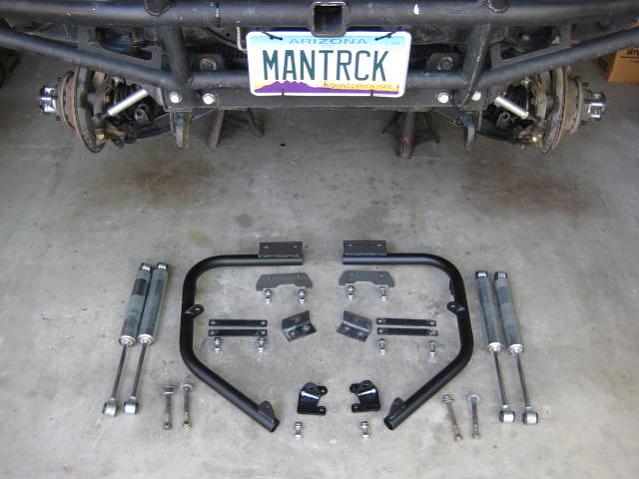

Blazeland Shock hoop conversion
well as blazeland n8 mentioned earlier, he and I met up at ocotillo wells ca. The Mantruck blasted through the washes and soaked up the whoops very well. However after hitting some of the bigger whoops I decided that I needed some more dampening in the front. Nate and I talked and decided that the Blazeland shock hoops should be the next upgrade. The thing I liked about the hoops was that I could go with a double bilstein shock or go with a coilover if I decided to later on down the road. for now i'm going to go with the double bilstein.. I will post before and after pics as well as a report on how the new addition works.....

This is the Blazeland shock hoop setup. Take note that this is not a production kit. It is only a prototype, and if Nate from Blazeland finds that their is enough interest in the kit.. he will go from there. He and I just used my rig to experiment with... This kit is totally bolt on which is really cool.. only some minor welding was needed to attach the shock tabs on the LCA's and rear hoop mounts to the frame..
