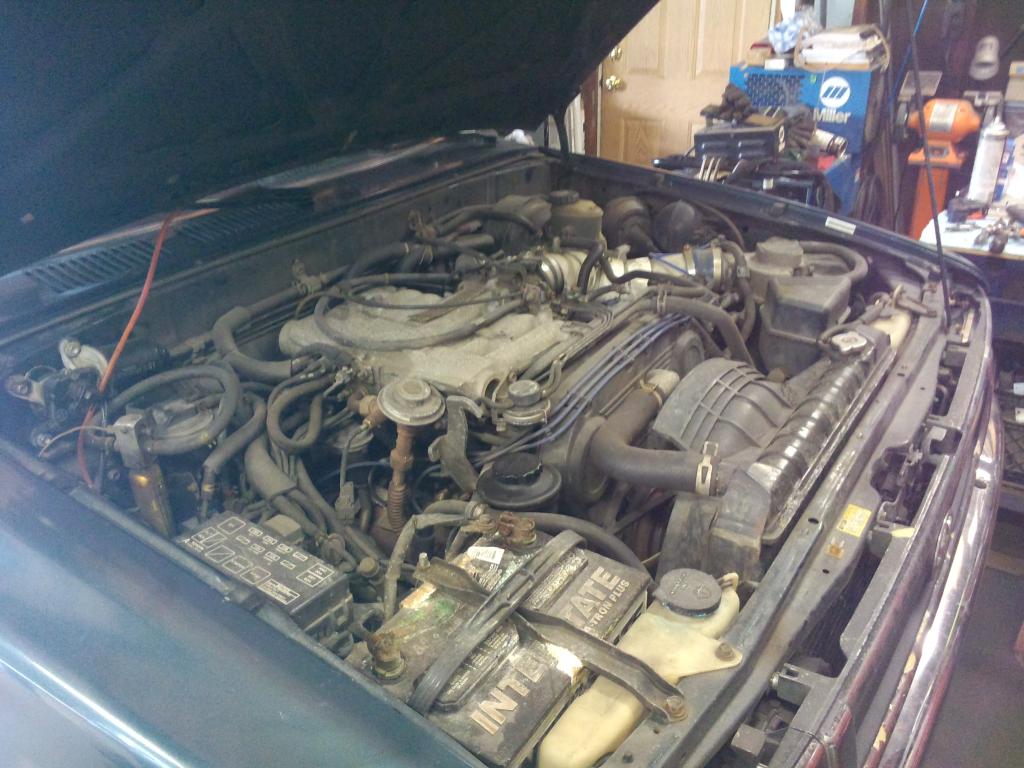

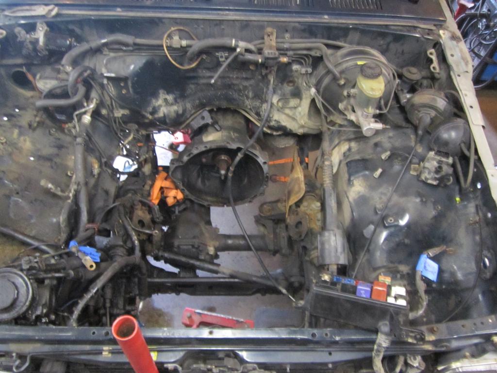

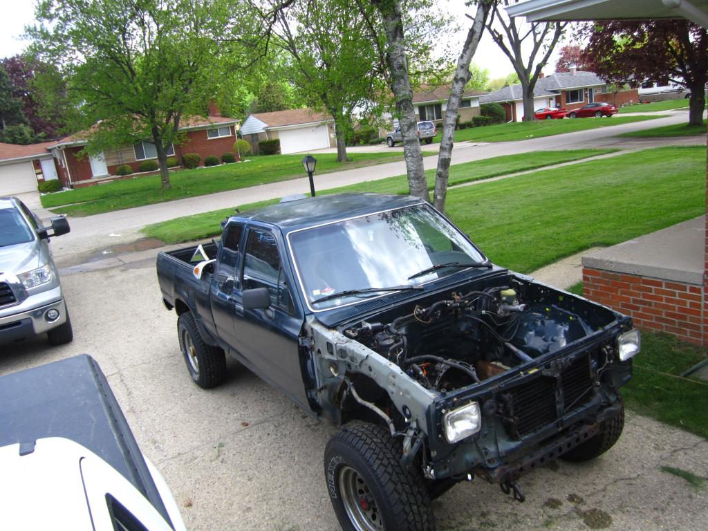

Worked on the truck a bit this weekend. got the old 3.0 out of the engine bay and started to remove everything else out of the fender wells. Lots of rusted bolts snapping off ....

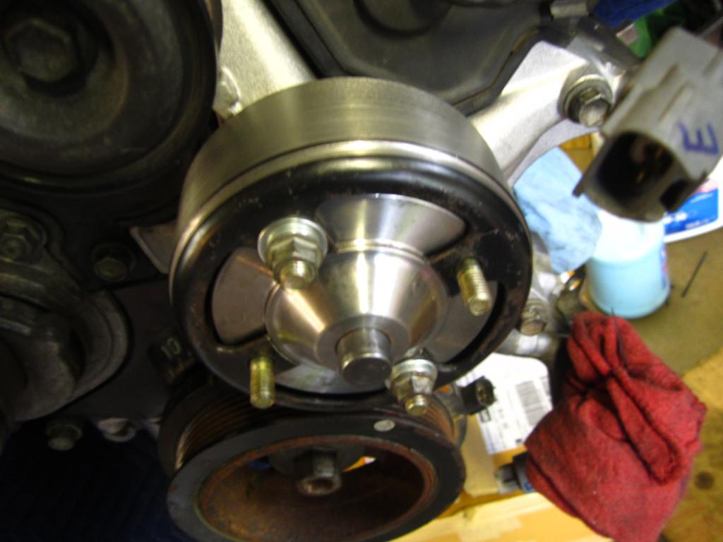

a little custom machining to the hydralic pulley to make it fit on the idler bracket.

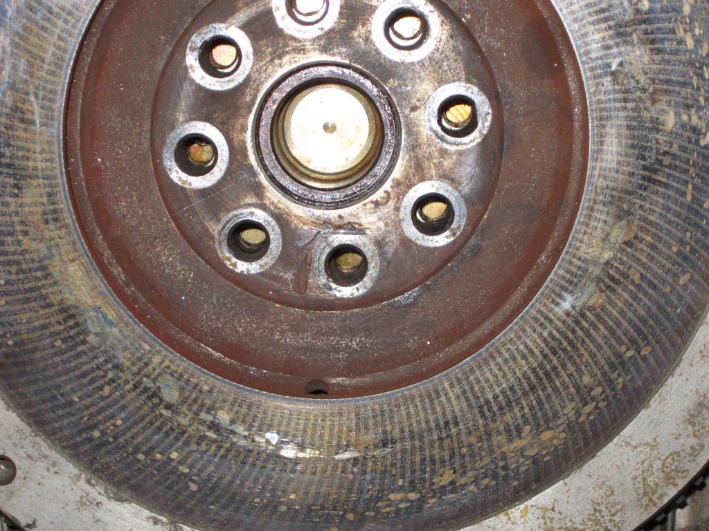

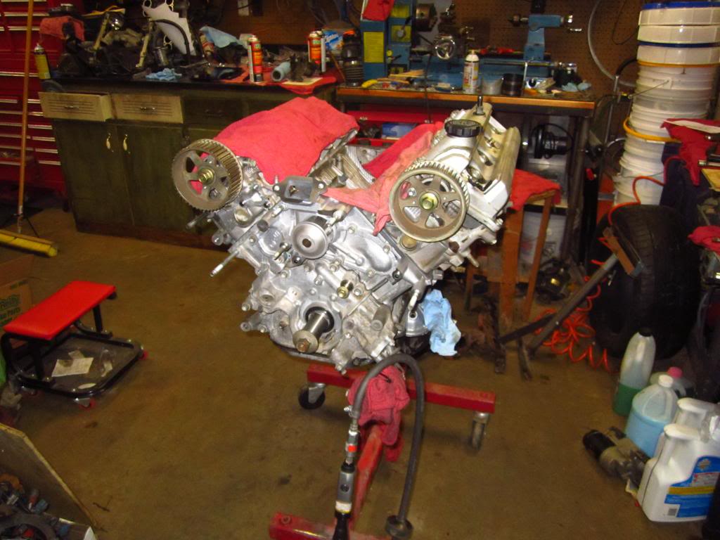

The 3,0 flywheel on the 1uz, they are truly close. I am getting this machined down.

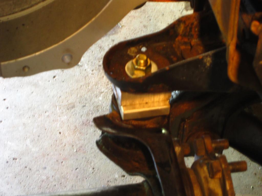

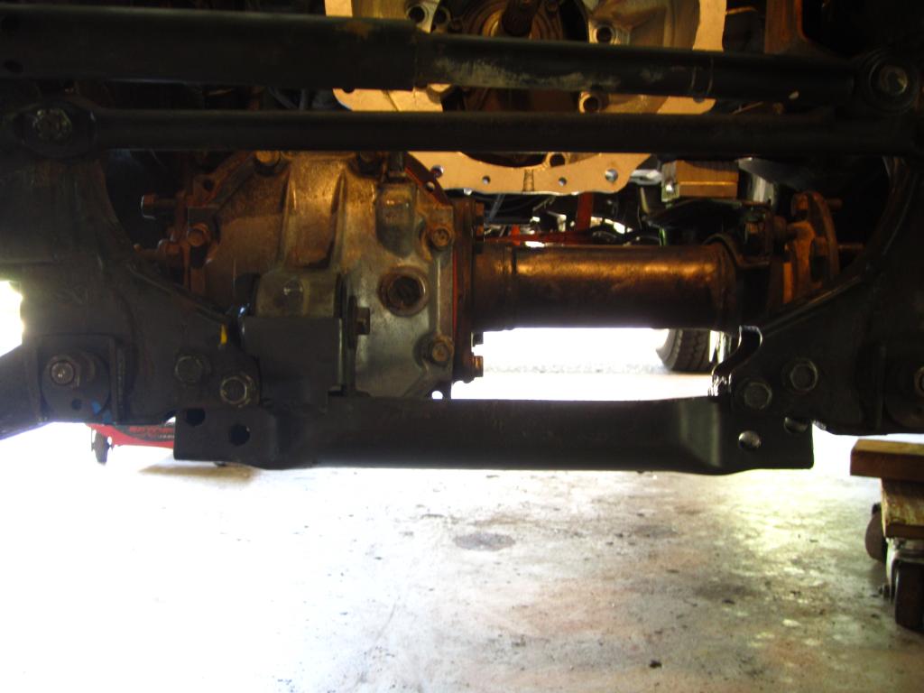

front diff drop
Here are some pictures of the front diff lowering. it is lowered 1.25" to make room for the rear sump I have.

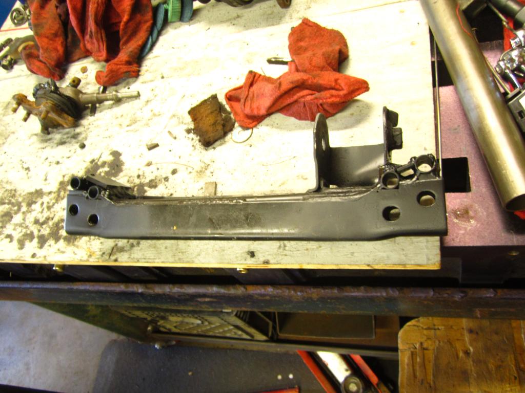

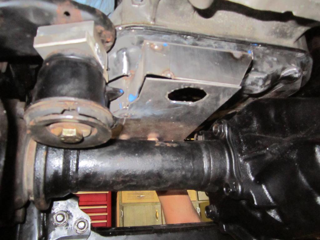

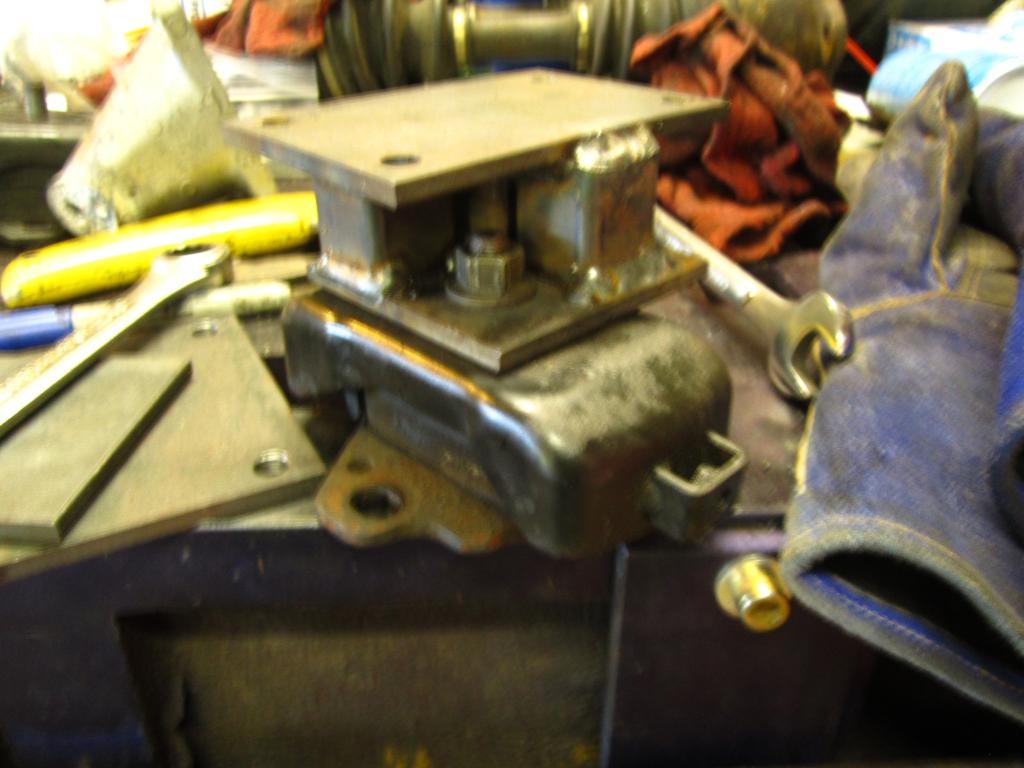

1uz motor mounts
Some fabricating of motor mounts, I utilized the old 3.0 rubber mounts and the original mounts that are on the truck frame.

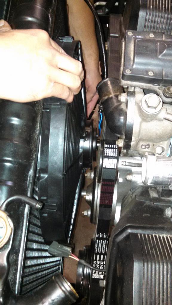

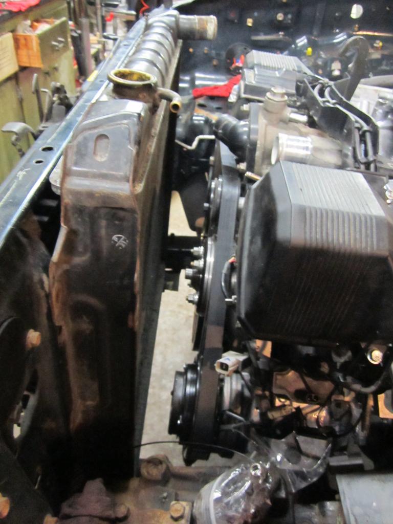

Here is the engine in, looks to be a bit tight with the stock radiator. I will be searching for a thinner aluminum one.

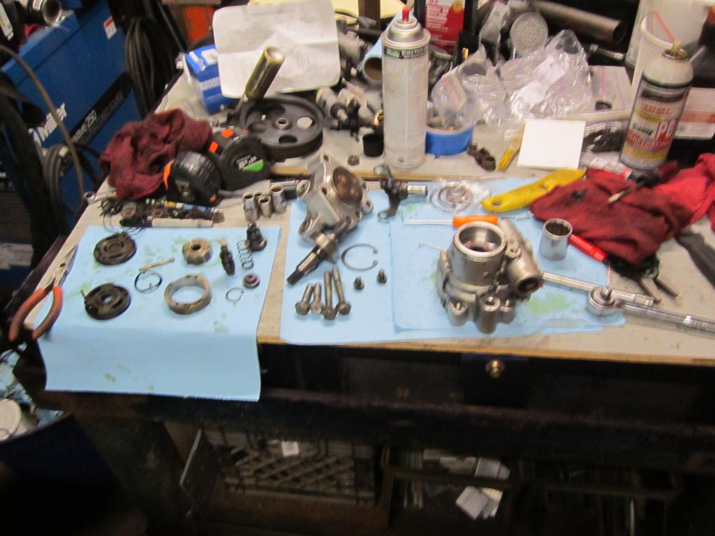

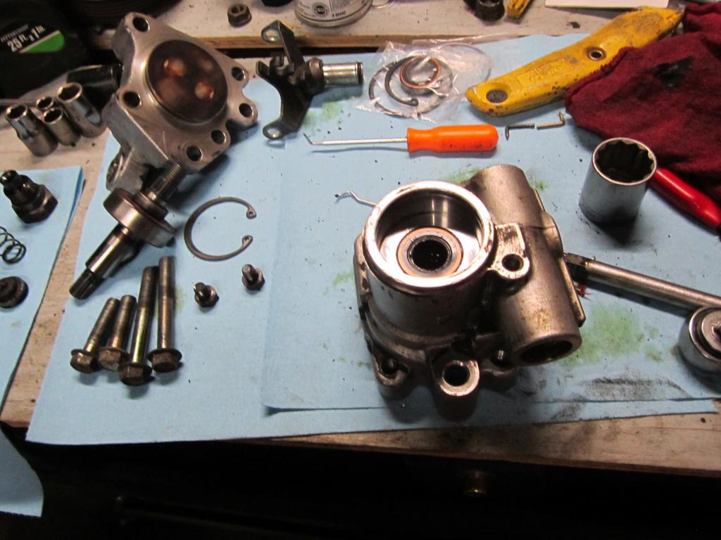

power steering rebuild
A couple shots of the power steering pump rebuild using the lextreme kit.

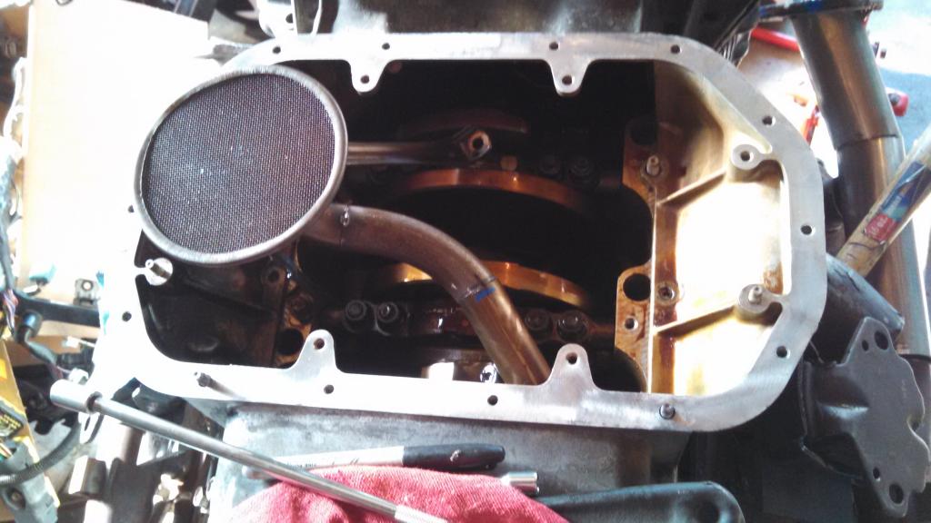

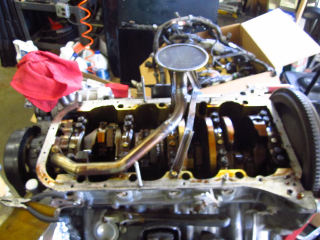

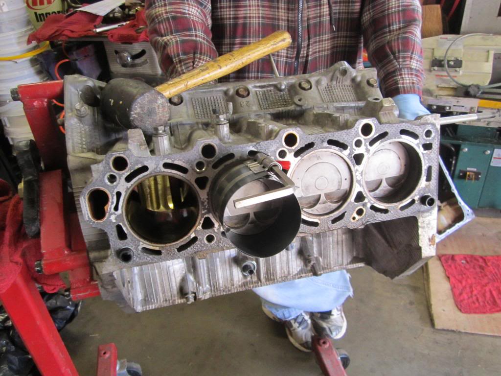

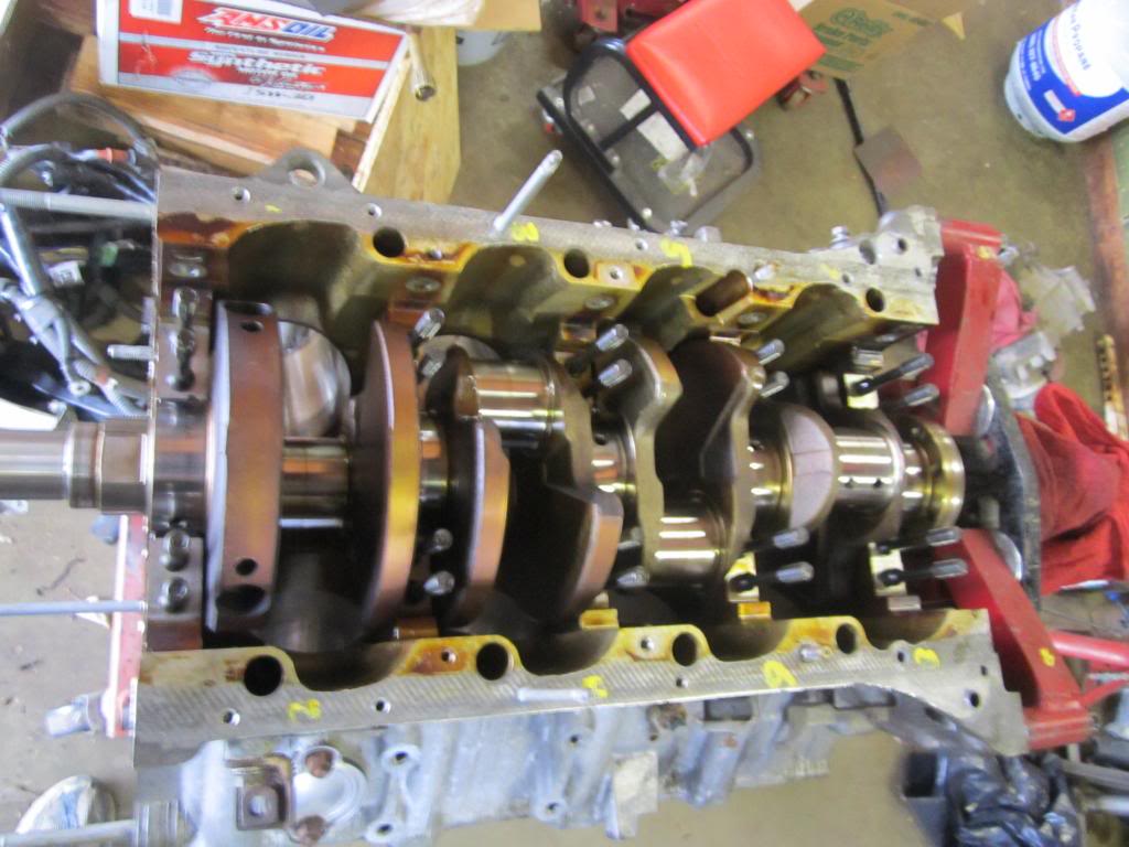

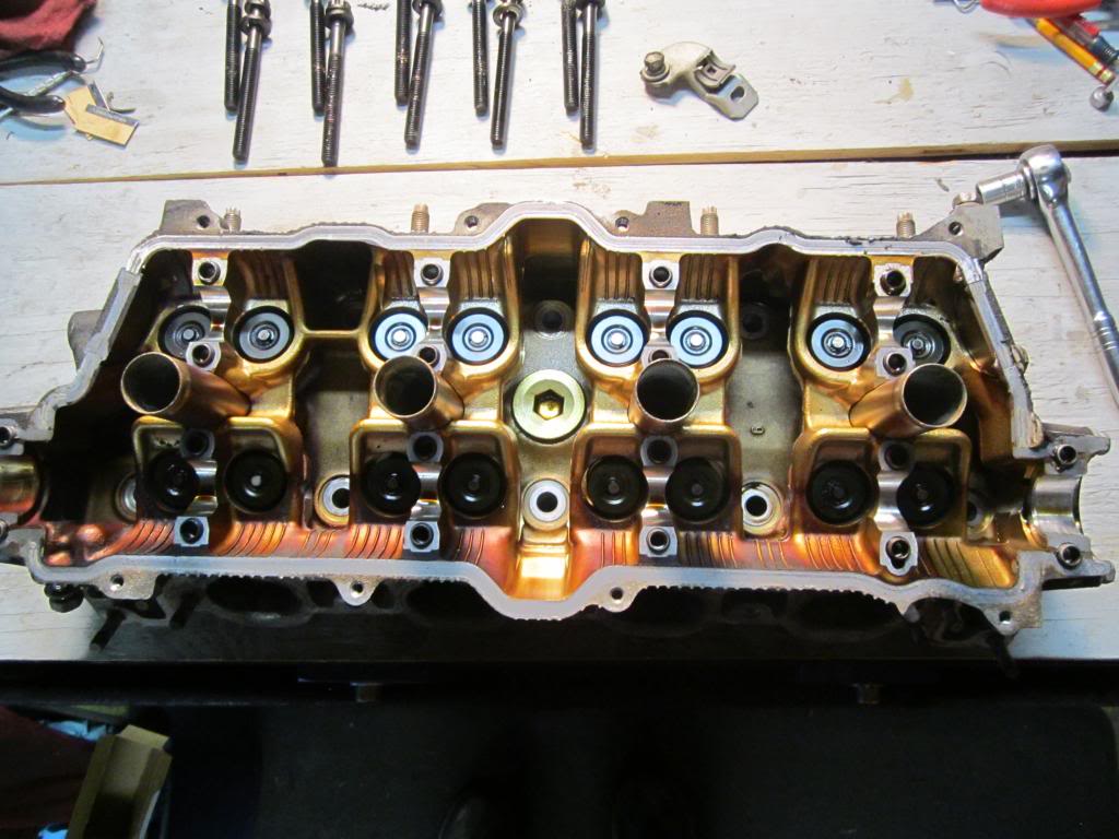

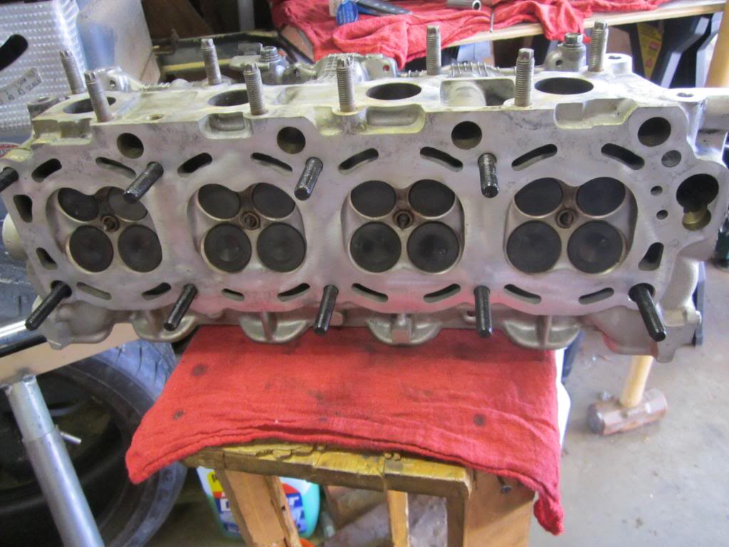

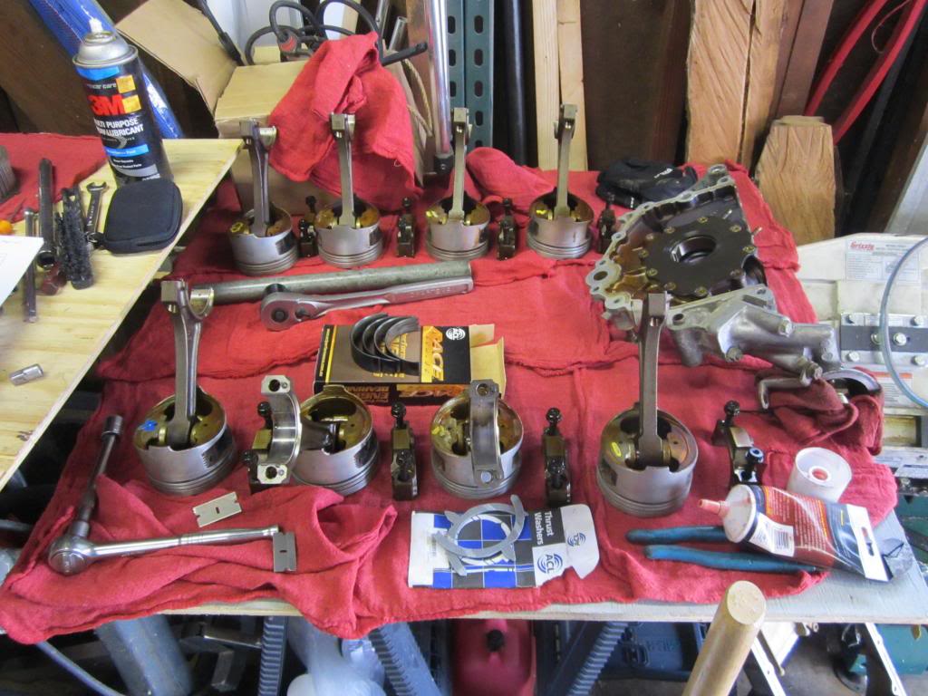

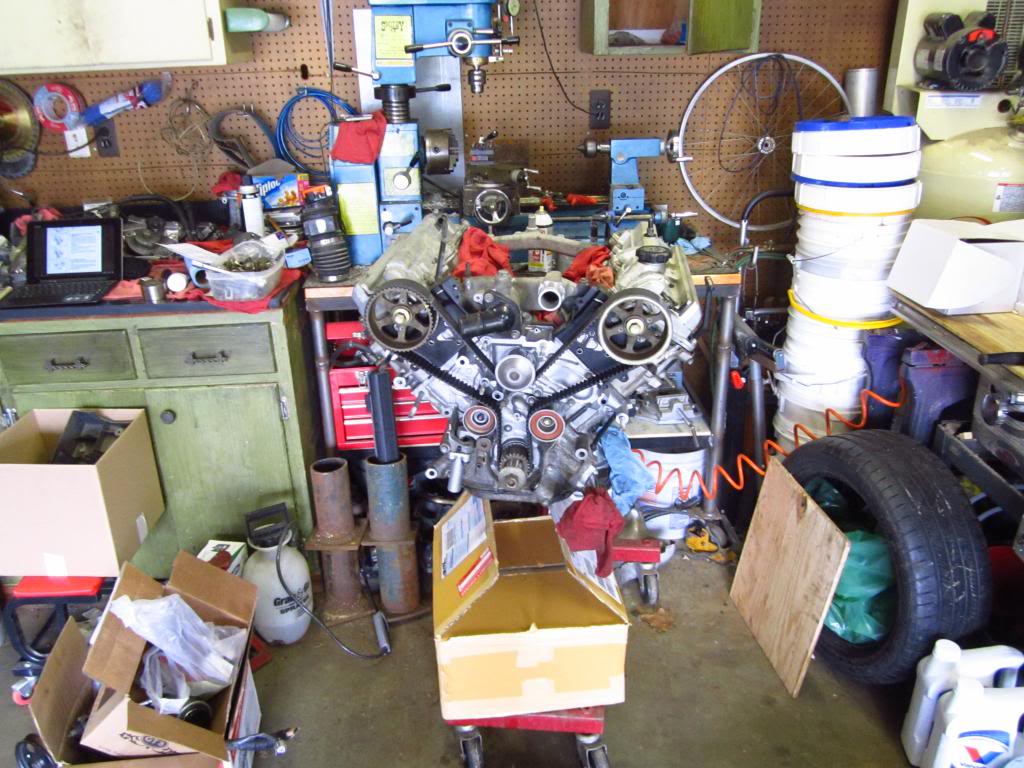

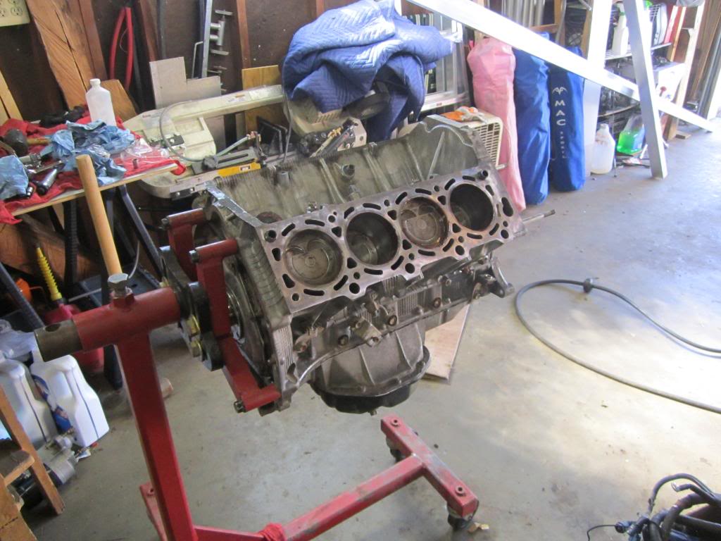

1UZ rebuild
I know this is out of order but I just found these pictures of the engine rebuild and thought I would share.

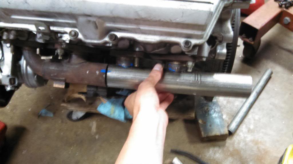

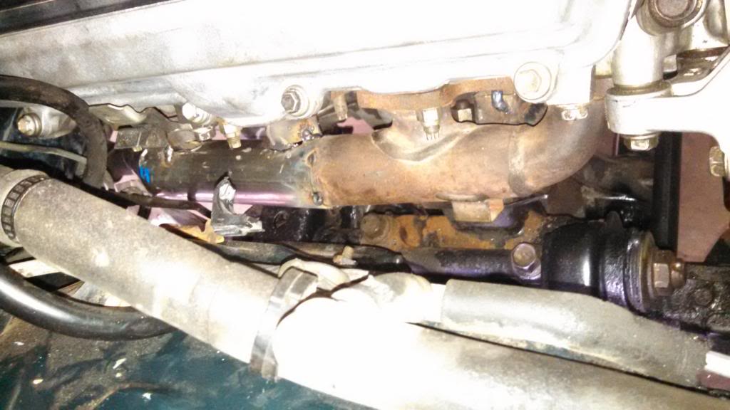

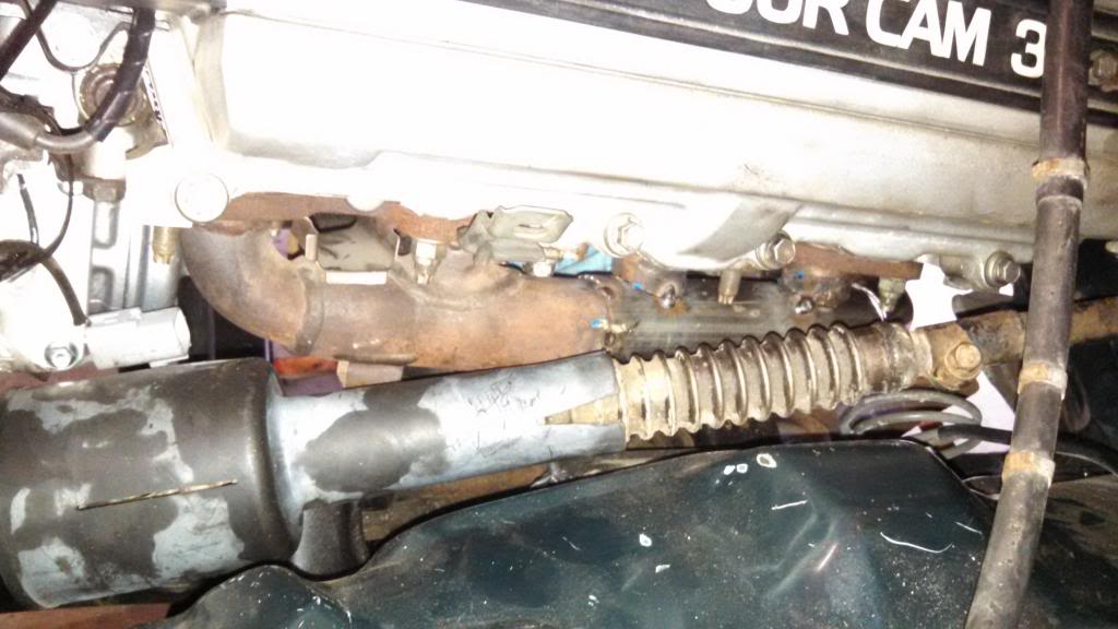

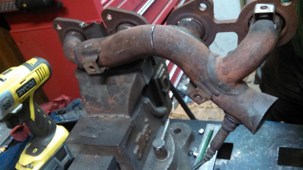

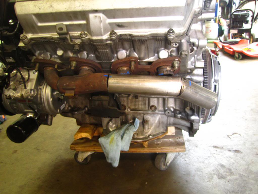

Exhaust manifold as it was from the SC400
Modified to mock the tundra 4.7 ones because I couldn't find any local

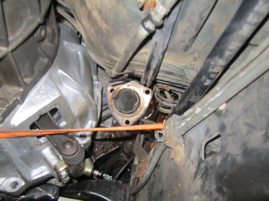

Exhaust mounted and in the truck
Exhaust underneath the truck

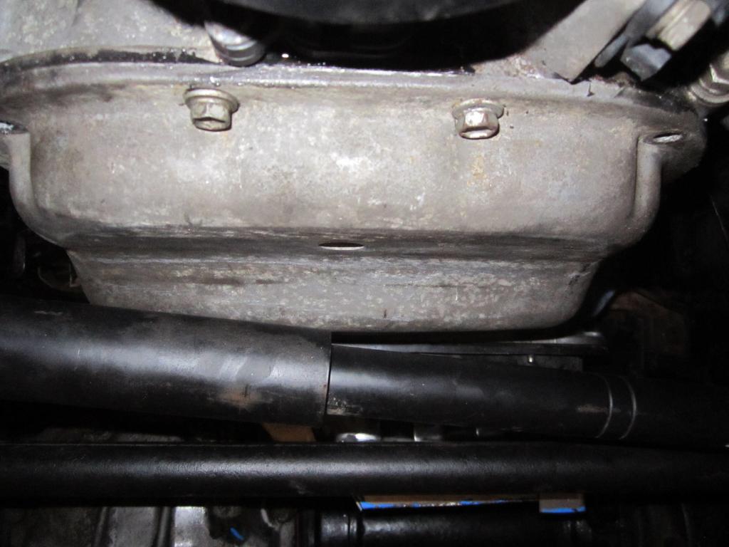

stock location of the sump with the modified oil pan

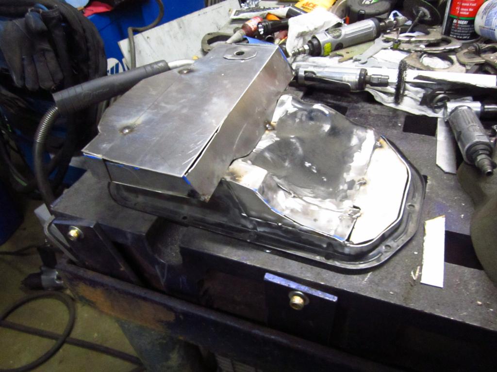

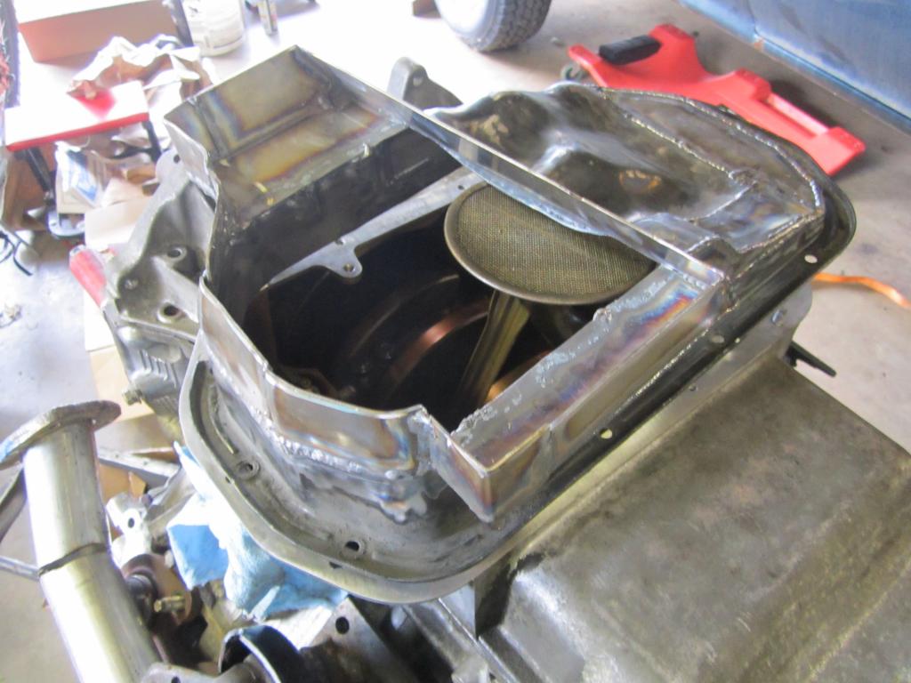

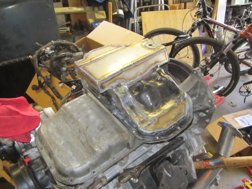

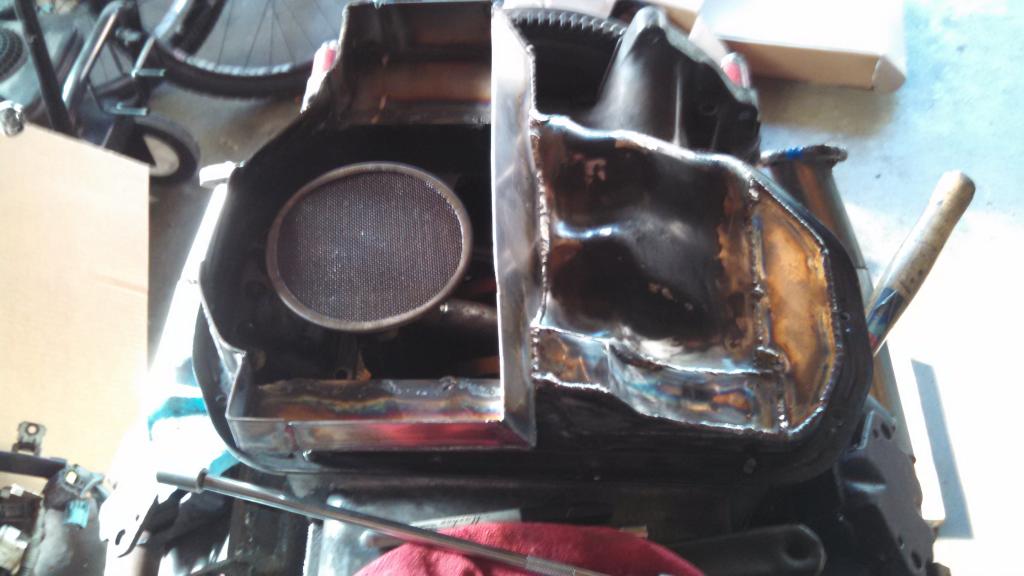

Here are the sump modifications

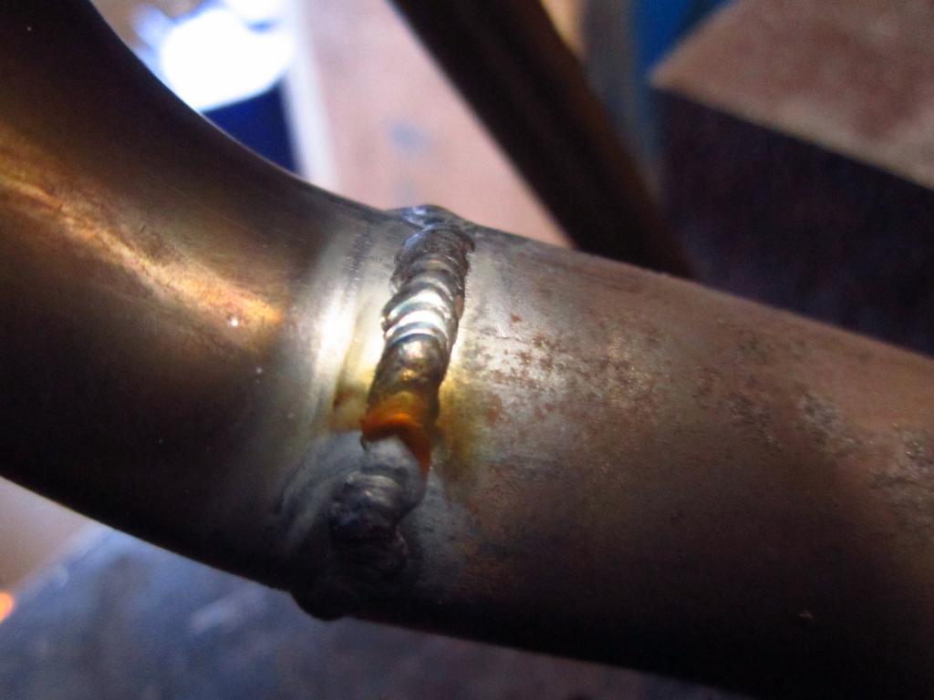

some tig welding

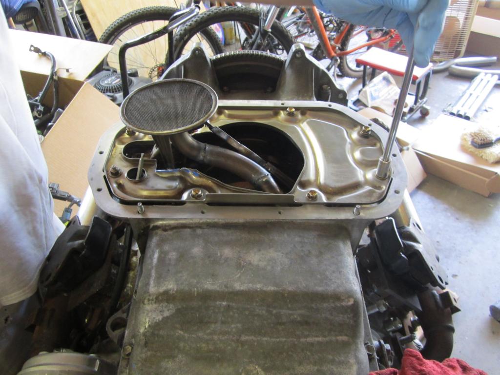

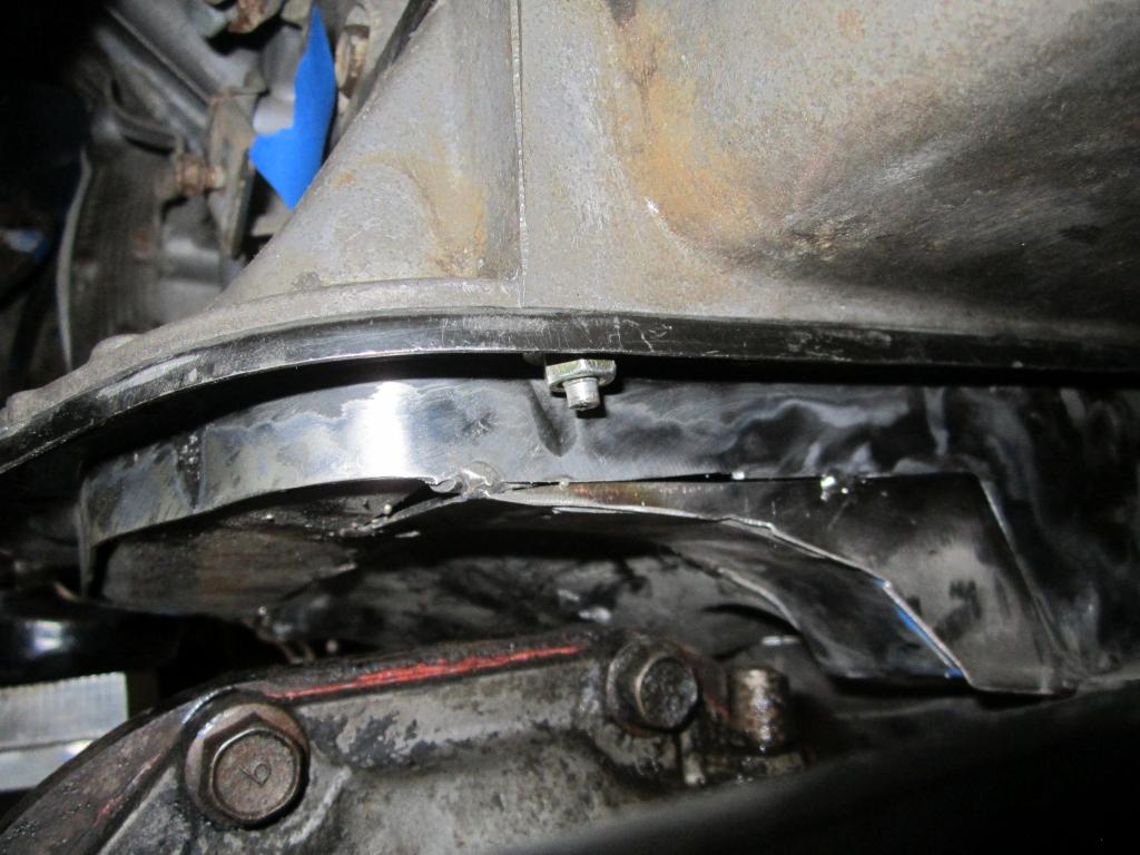

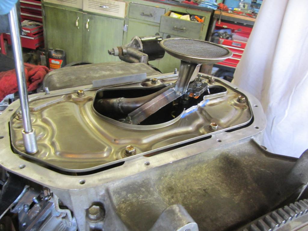

Oil pan modifications, I used an extra 3.0 oil pan and the sc oil pan to make one that fit around the front differential

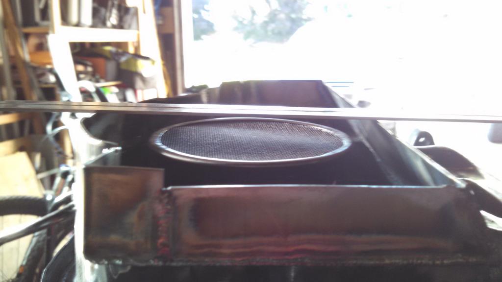

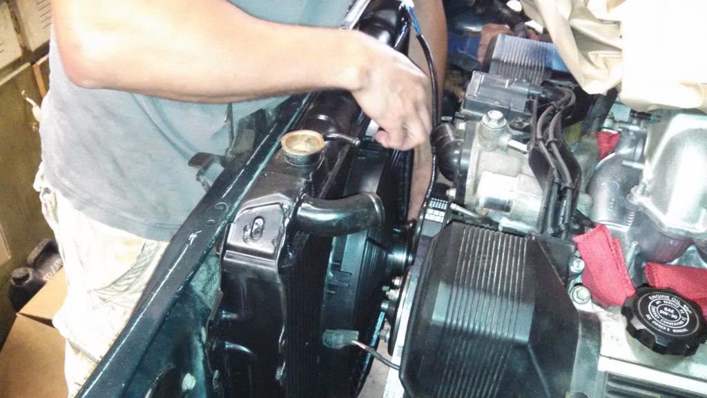

Radiator mounting and clearance

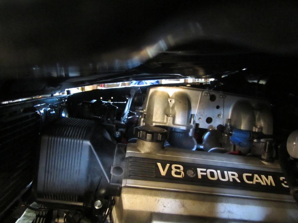

Engine hood clearance

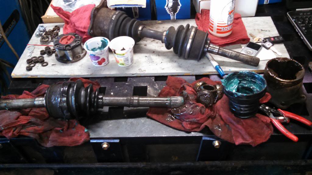

Front CV shaft, putting new boots on

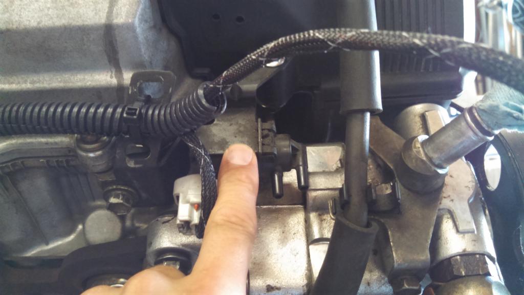

Mystery VSV
Hello everyone, I am hoping that someone can help me out here. below is a picture of a VSV behind the power steering pump of the 1UZ and I do not know what it is for or where the vacuum lines are supposed to go. any help would be greatly appriciated.

mystery vsv solved
I came across this layout online, it shows what I was looking for. This vsv is for the evap system

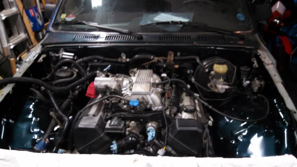

Just one shoot of the engine back in the bay. The bay was painted with the engine out.
Motor mounts are complete
Exhaust manifolds are welded and wrapped in fiberglass
Clutch is in and functioning. I will do a separate post on the clutch setup.

-3.0 flywheel modified, between 1/4" and 5/16" was removed from the backside to make the starter engagement correct.
-used the 3.0 flywheel bolts, had to cut them down as they were to long
-Purchased the marlin crawler clutch kit
- used the input shaft adapter that came with the bell housing
- used the pilot bearing that came with the bell housing
- I tried the 3.0 throw out bearing with 1/4" spacer behind the pivot point, and that did not work. Currently I have the 3.4 throw out bearing with 1 washer behind the pivot point and the clutch now works at least with me turning the output shaft of the trans with my dad pushing the clutch in and out. time will tell if it will work under power, but I am pretty confident that this combination will do the trick.
- to make the slave clutch mounting work, i had to remove about 3/4" off the casting of the bell housing. I had to drill the mounting holes deeper and while i was at it I put heli coils in there.
