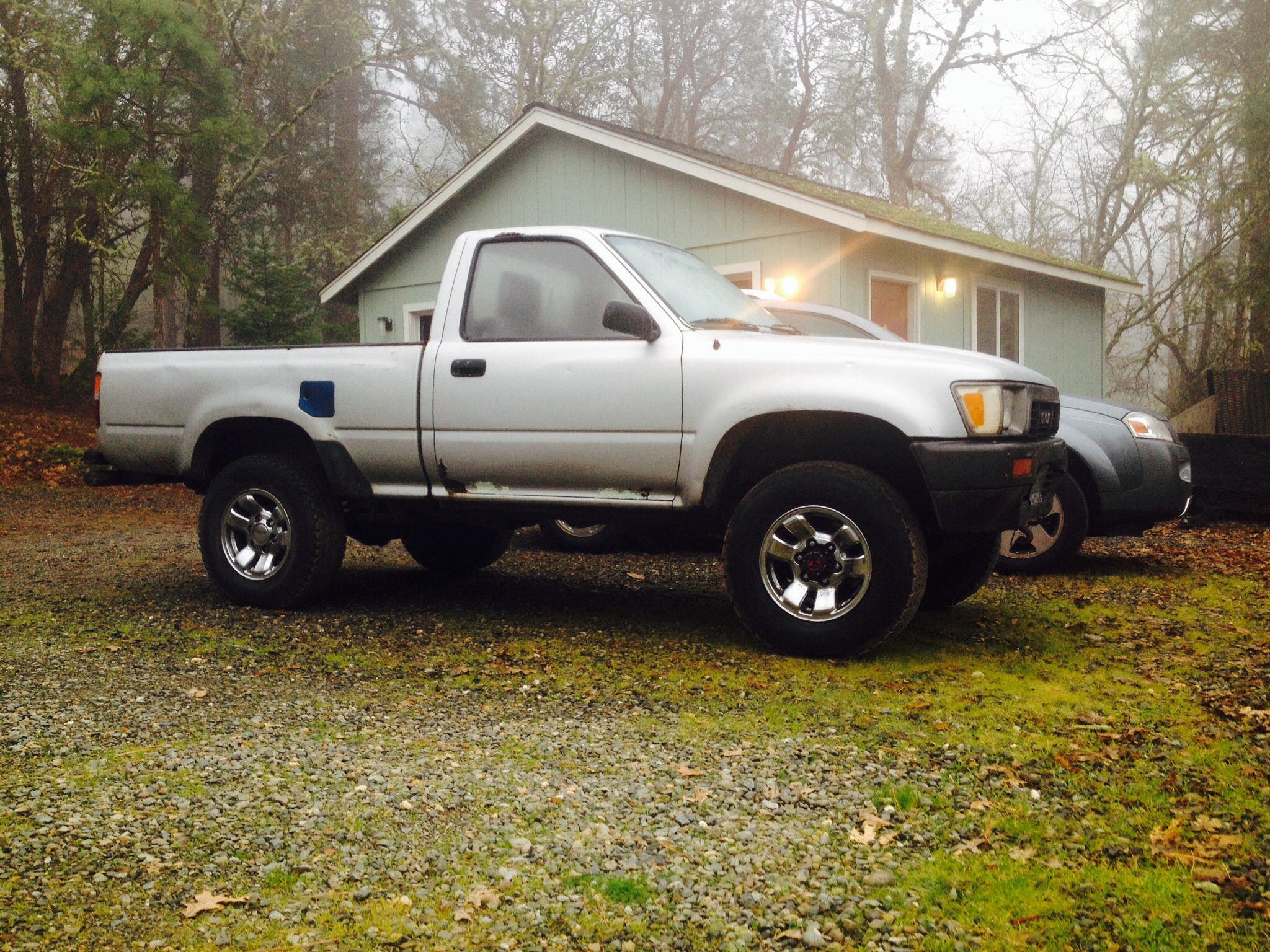

How it sits for now, no lift and sittin' on 30 inch radials

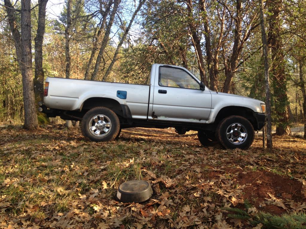

Project update
Not much going on right now, but I'm going to pull my heads when I get the shop built.

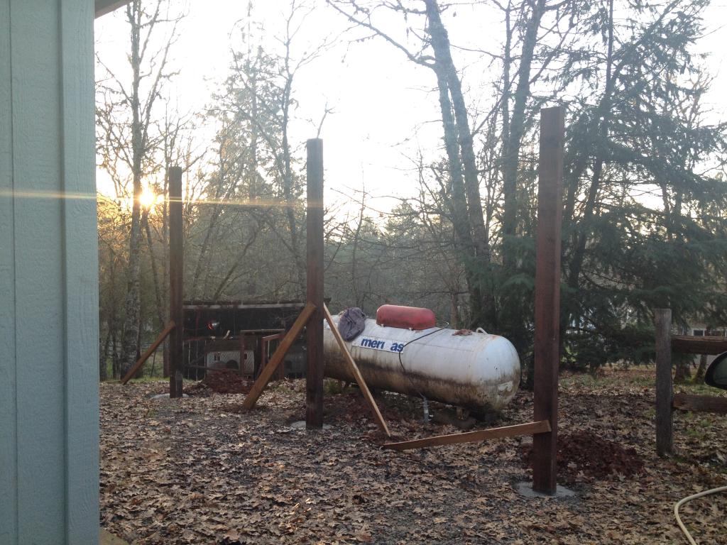

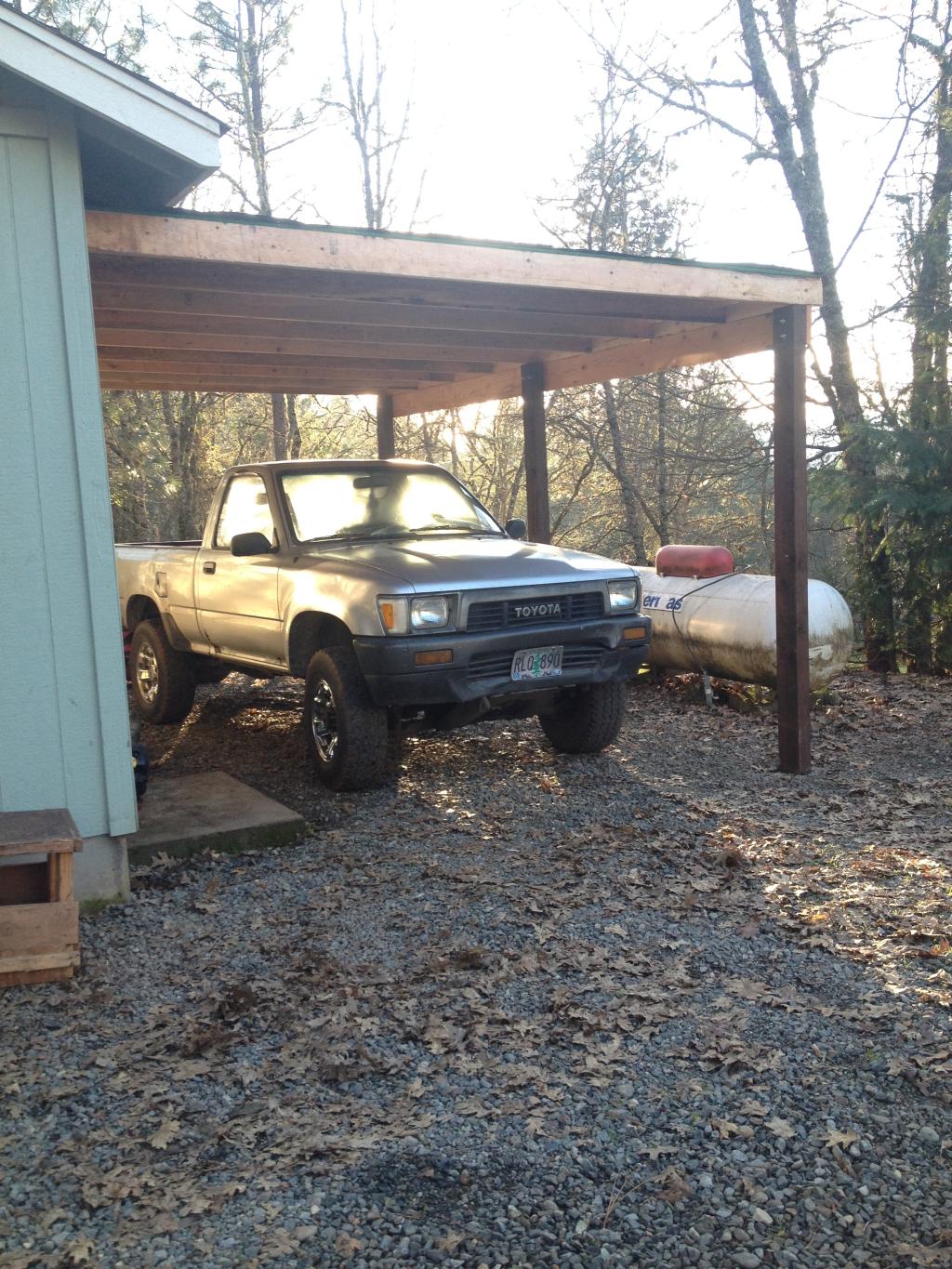

Got the shop built only took a day.

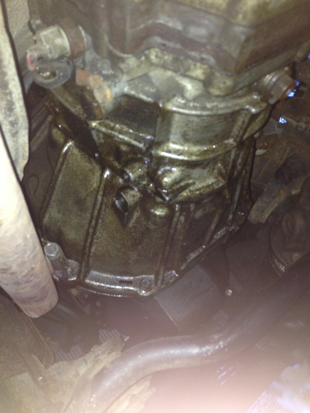

Hopefully going to break open the motor soon, I found a significant amount of oil dripping off the tranny so sometime or another I'm going to need to drop my tranny to reseal all the mating surfaces.

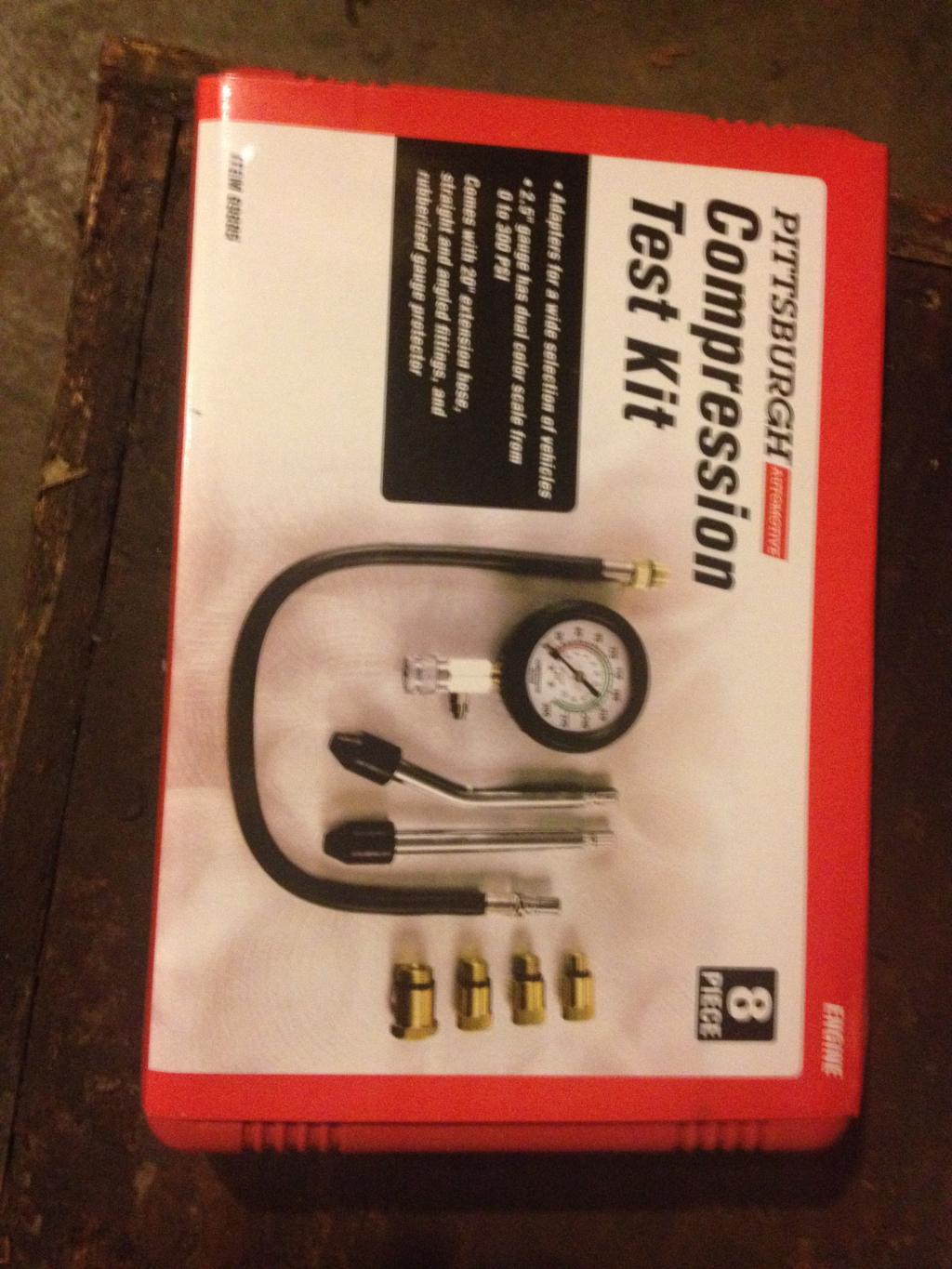

Update
Today I went and got a compression tester because I'm dying to know what the problem is and we got some good and some bad news. Cylinder 1,2, and 3 have 160 psi which is good, but 4 has 55😭. I put a little oil down that cylinder and it upped the compression by about 15psi so it looks like I'm going to need rings on #4. Do you guys think I should just do rings on 4 or do a complete top and bottom end rebuild?

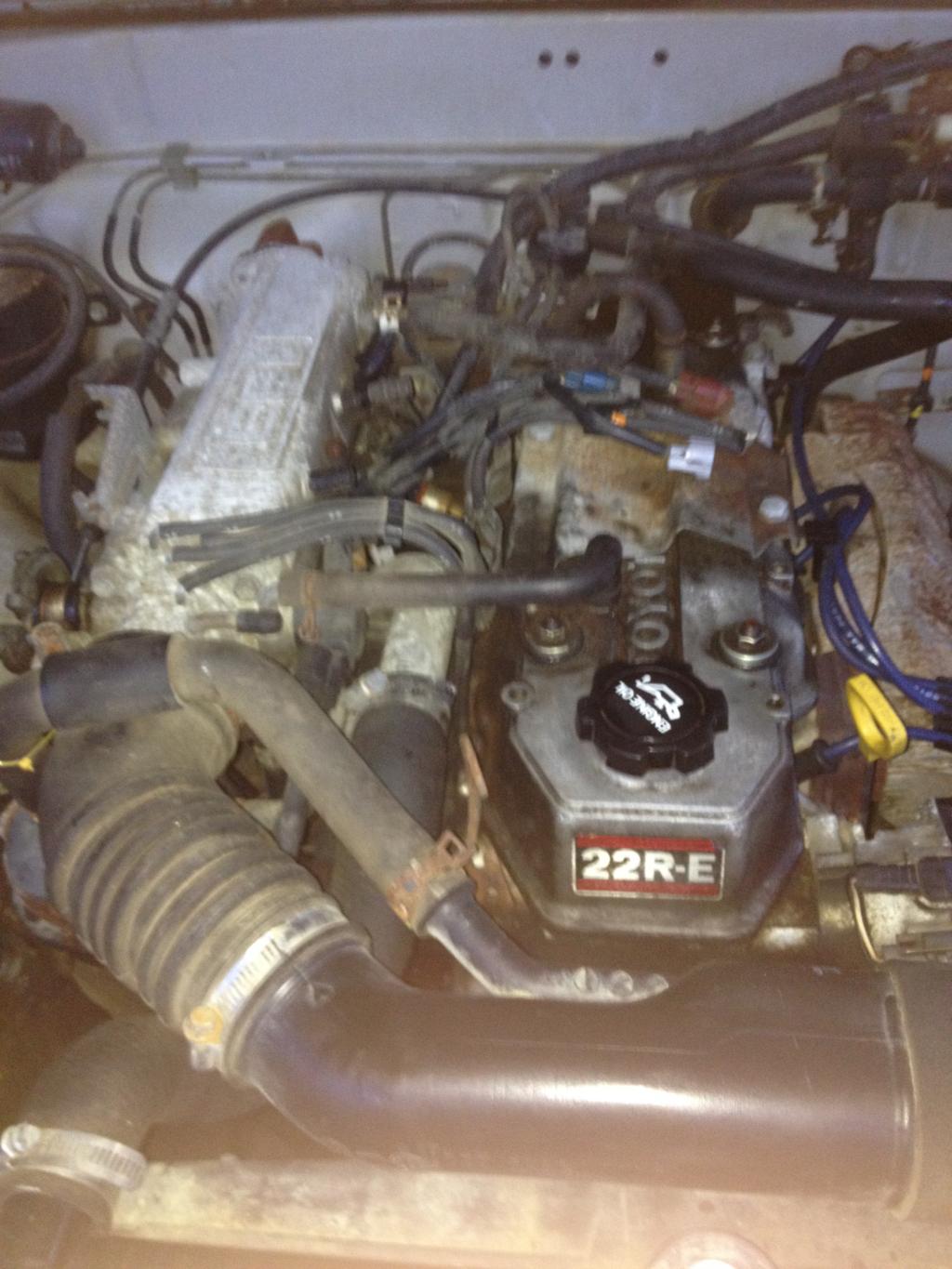

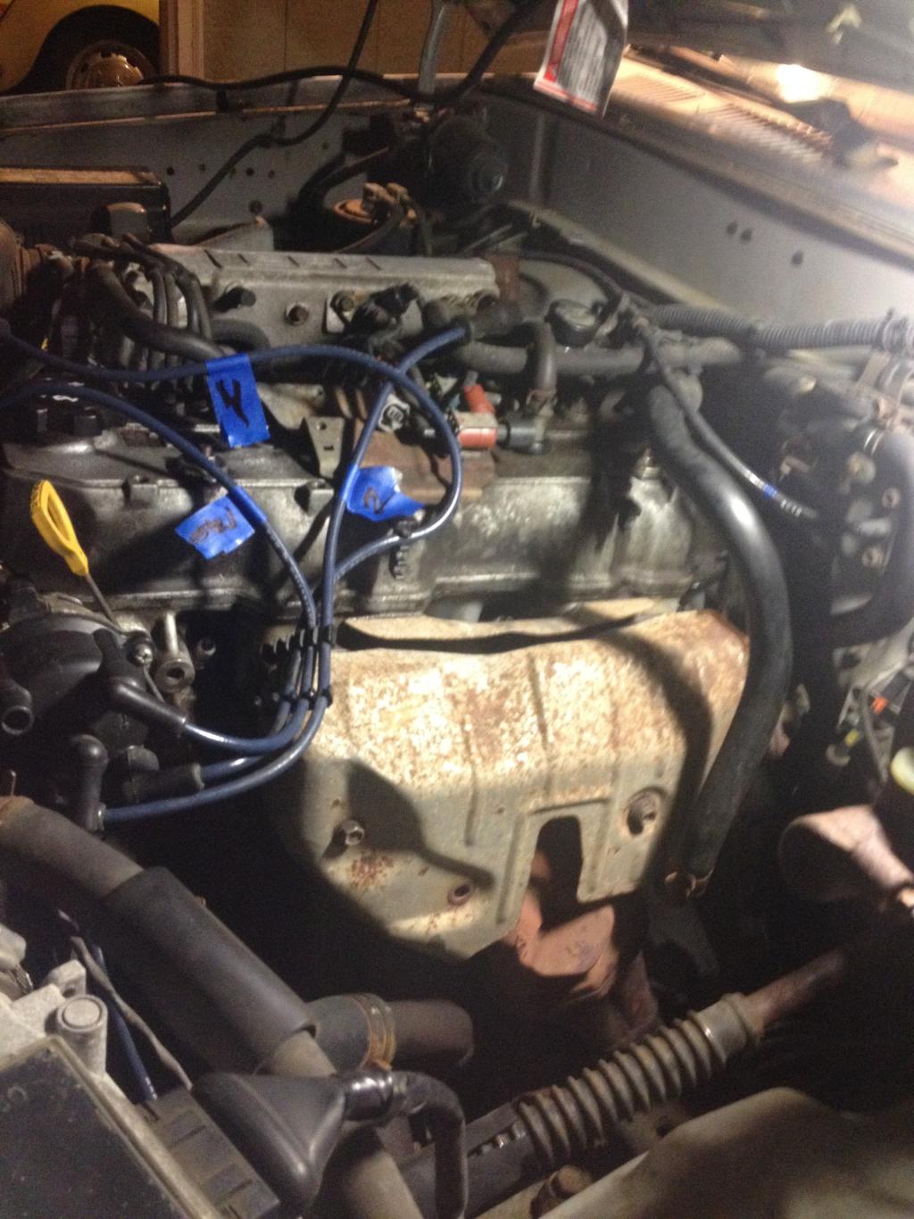

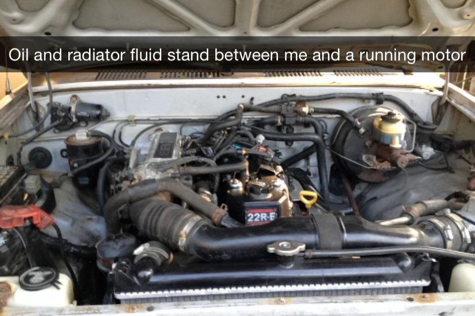

2 month update
Well got some good news and some bad news. Good news is the motor looks great, has all new gaskets, and a new exhaust system. I took the head to a mechanic and he said it looks like the head gasket was leaking, so together the motor went. Now it runs but still has 55psi in cylinder 4 and now #1 injector is spraying gas everywhere so it needs new seals. But at least it runs. Next step is to adjust the valves and hope for the best because there is a possibility that the valves are too tight. So keep your fingers crossed until my next update.

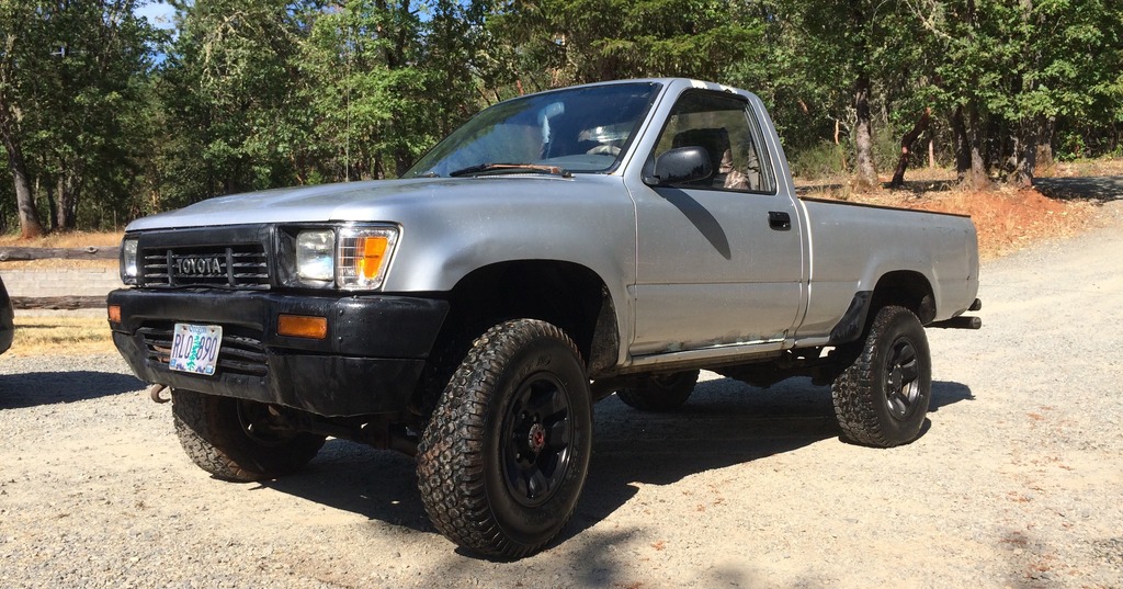

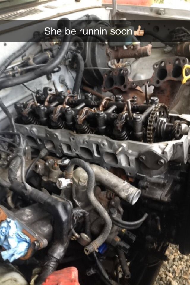

Long awaited update
Today was a good day. Finally ran on 4, the #4 exhaust rocker arm was adjusted about 1 turn too tight causing the valve to stay open all the time. It may have burned that valve and/or the valve may be worn but I don't care, she's a runner!
