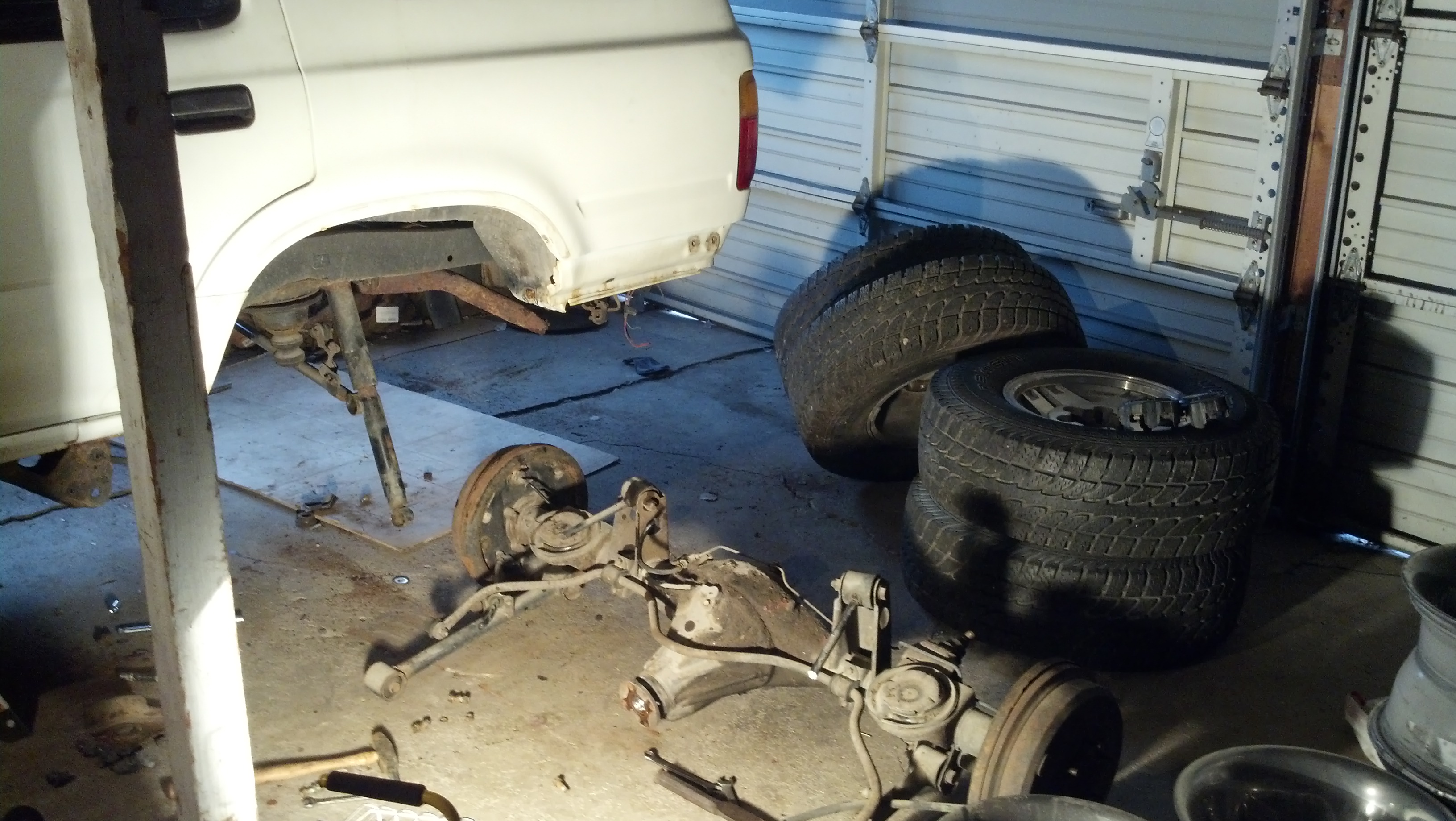

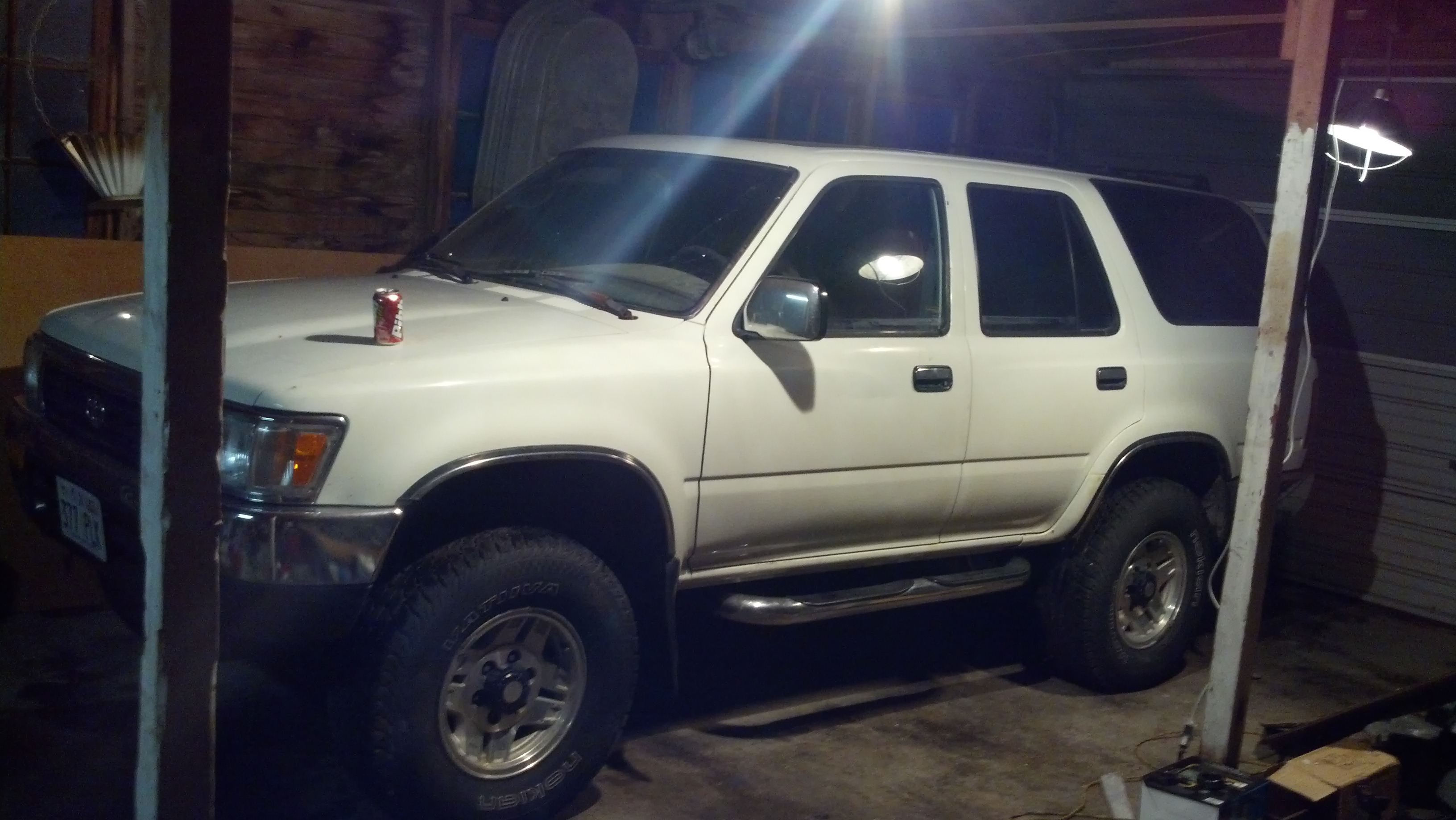

I decided to finally make a build thread for my 4runner. It has been built for a little while so its going to be mostly pictures until i get caught up with how it sits currently.
Attached Thumbnails 91 chopped 4runner 1uz-2013-01-10_17-41-51_885.jpg   91 chopped 4runner 1uz-2013-01-17_16-58-26_183.jpg

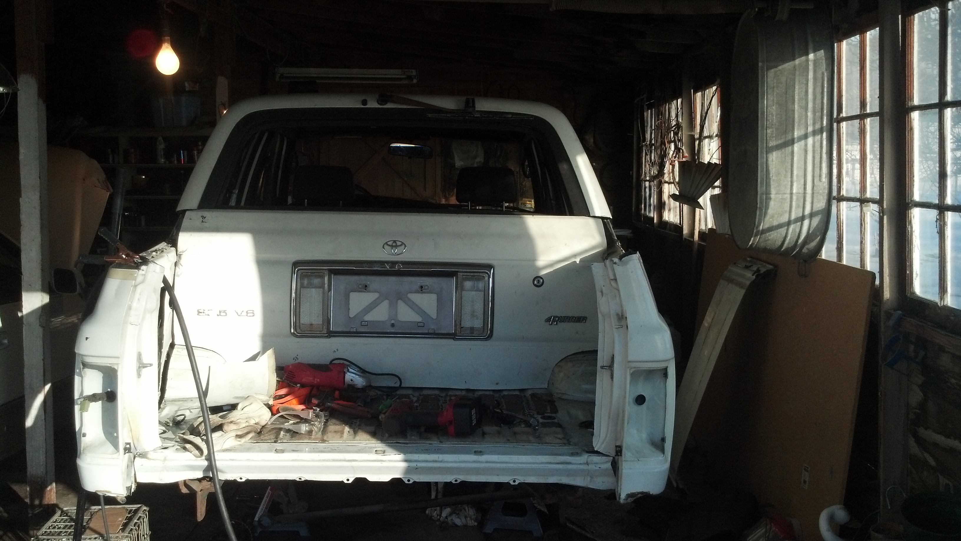

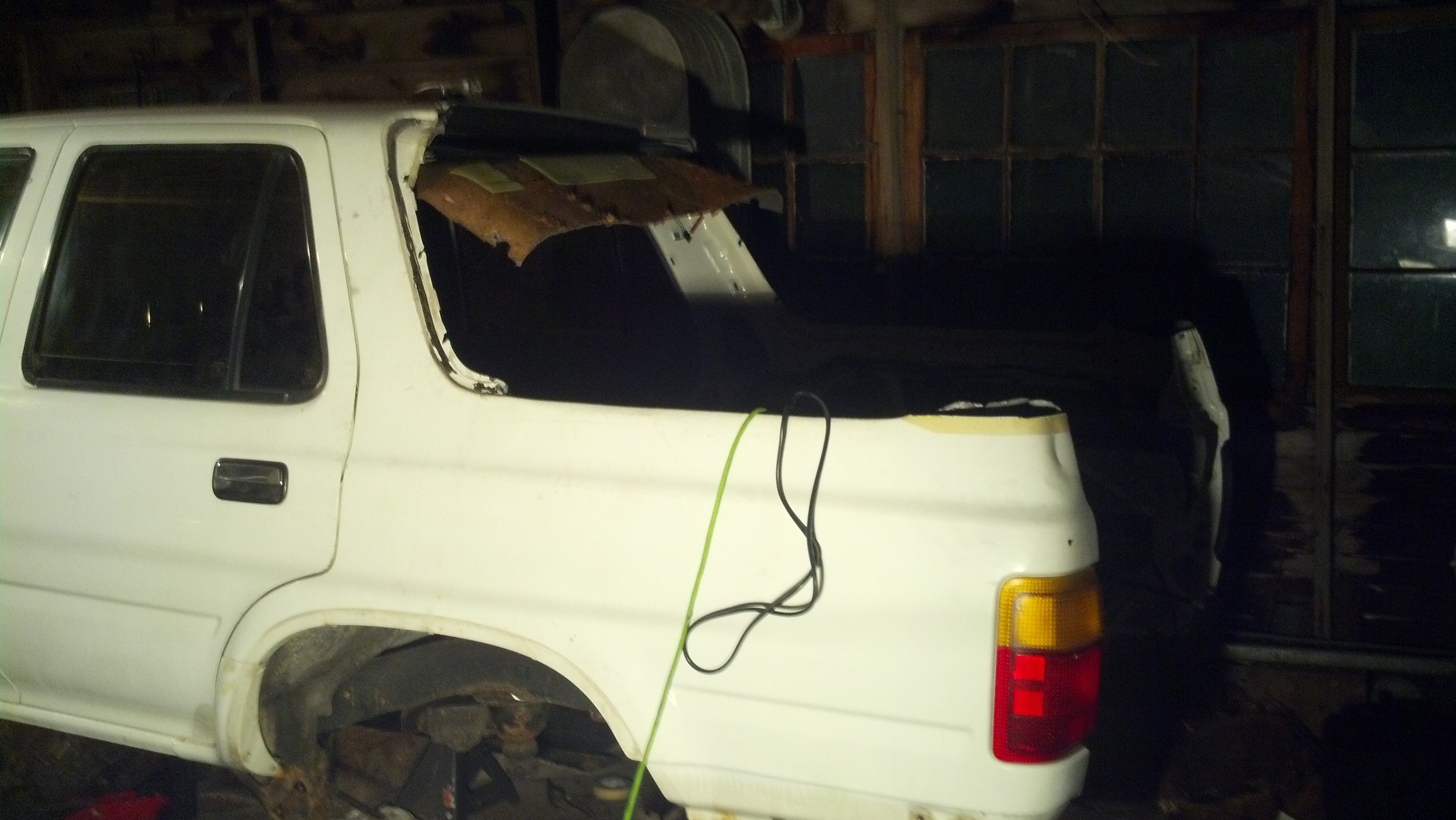

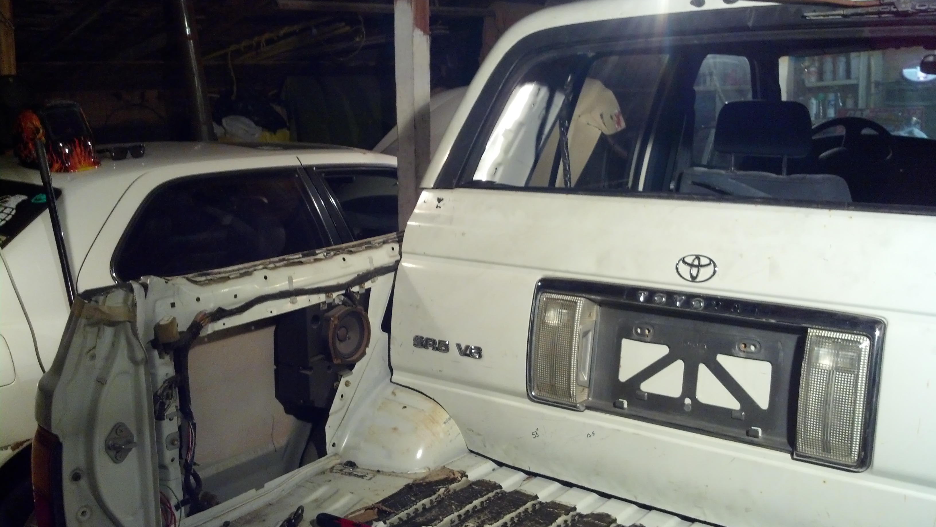

As soon as i pulled it into my shop I pulled the 3.0 and started taking a saw to the top.
Attached Thumbnails 91 chopped 4runner 1uz-2013-01-24_19-57-08_909.jpg   91 chopped 4runner 1uz-2013-01-25_20-01-21_988.jpg

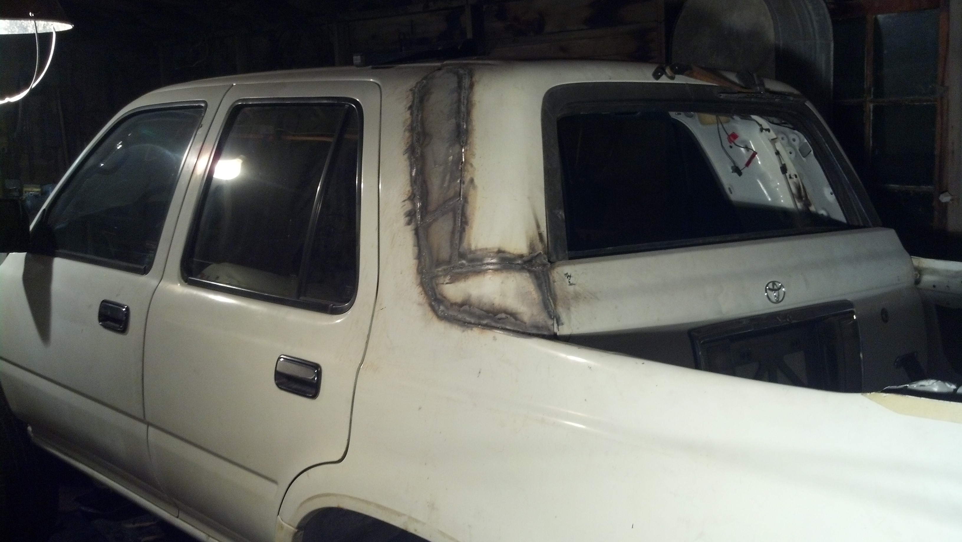

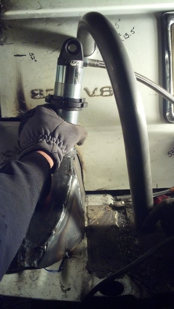

finished welding the top
Attached Thumbnails 91 chopped 4runner 1uz-2013-01-28_16-08-55_506.jpg   91 chopped 4runner 1uz-2013-01-28_18-43-42_517.jpg

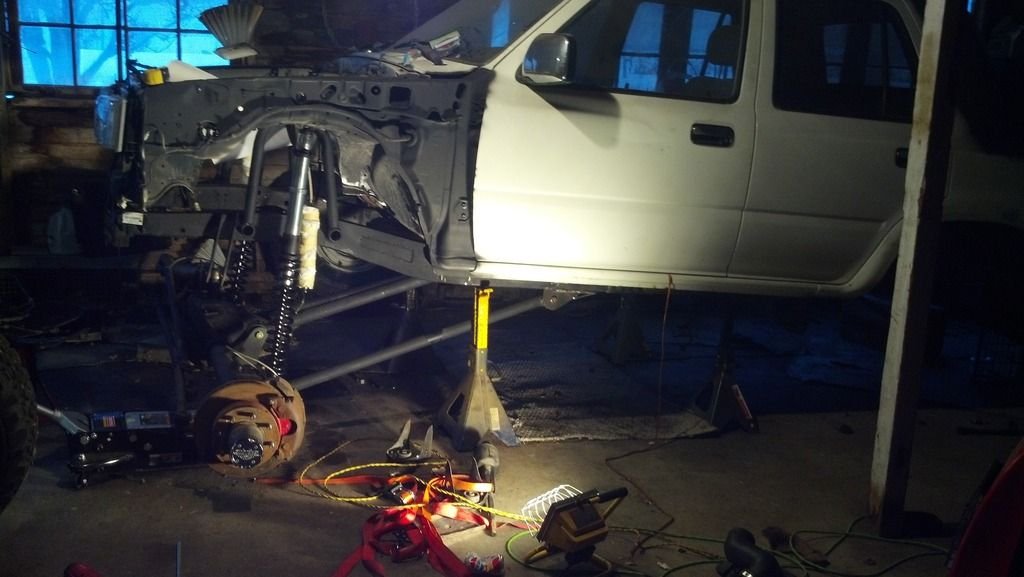

ifs was gone in two cuts

Awesome! Is the new front frame section higher than the stock frame?

yeah just slightly higher and a little wider for the 1uz
