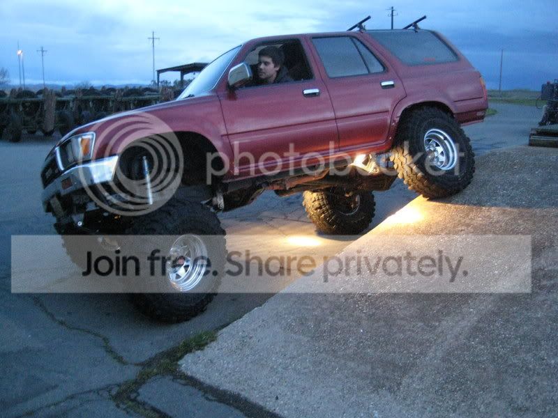

Okay the SAS has been done for a while now. I am COMPLETELY happy with it sooo far..
Rides better than ifs IMO and flexs better too.
My next purchase is going to be a TG front bumper i believe.
Almost got my sliders welded on, but ran outta time.

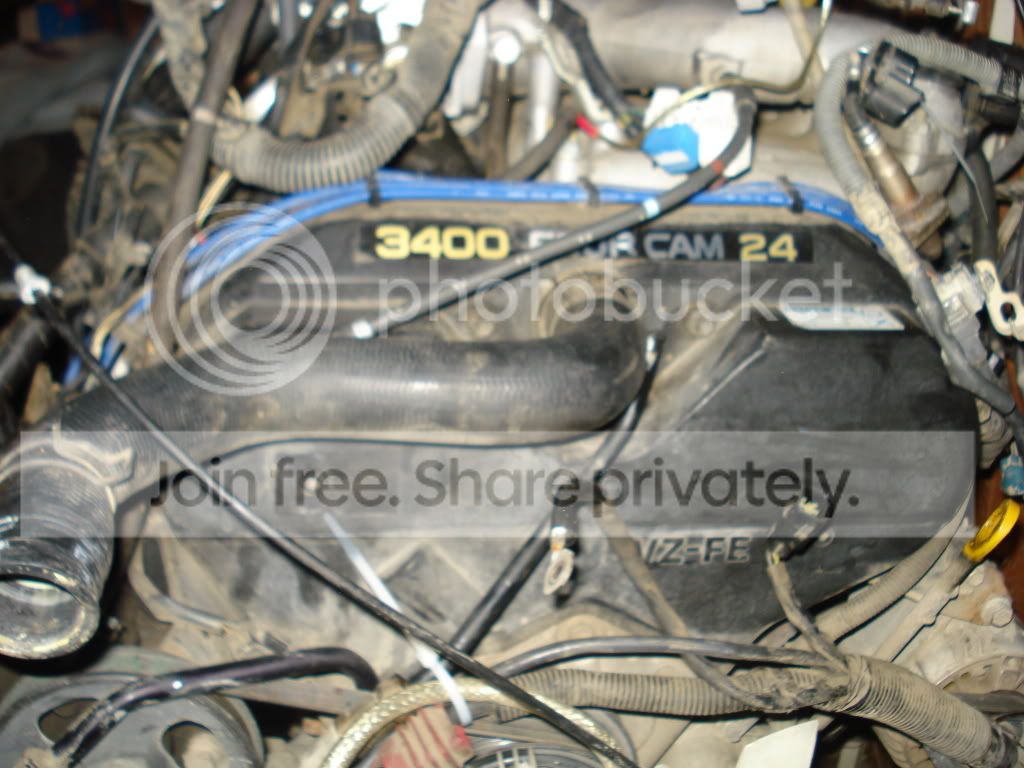

Picked up my 3.4 yesterday.
