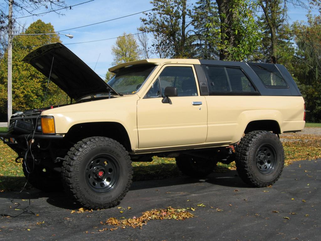

I bought this 89 4Runner off the classifieds on this board so I figured this would be a good place to do a build thread. I will be using this truck for some daily driving and light wheeling. I really have not done much except collect parts while I wait for it to get a little warmer in the shop... I built it last summer but didnt get the mechanicals done before the deep freeze. Here's the listing....
https://www.yotatech.com/forums/f108...4600-a-275672/
All I've done so far is throw and Interstate battery in it, the one it came with was complete junk since the ignition tumbler would not go to the "off" position.
Things that need attention...
* Battery Tray. It appears that there is a bigger MAF installled that required moving the battery to the driver side. And that's where it ended. It needs a tray and a hold down.
* Header gasket.... no explanation necessary. Using a copper one from Summit.
*cold air valve... it seems to idle high when cold.
*Push Button start. Using a Joe's racing switch plate kit.
*when it was painted, the tailgate jams were overlooked... so gotta paint those.
*fix the cracked dash. Probably just fiberglass it....
*I'll be using 1/4" thick textured ABS for all the interior panels
*The rear seat and carpet kit will be replaced by a continuous aluminum diamond plate floor, and hopefully i can get the vinyl diamond plate sheeting to work for the front seating area if i can get it to lay flat.
*install CanBack soft top
*I need a rear bumper of some sort... and maybe some rock sliders.
I would like to install the solid front axle someday but I'm still gathering those parts. I would love to hear some thoughts and advice on my build. This is my first Yota build.
